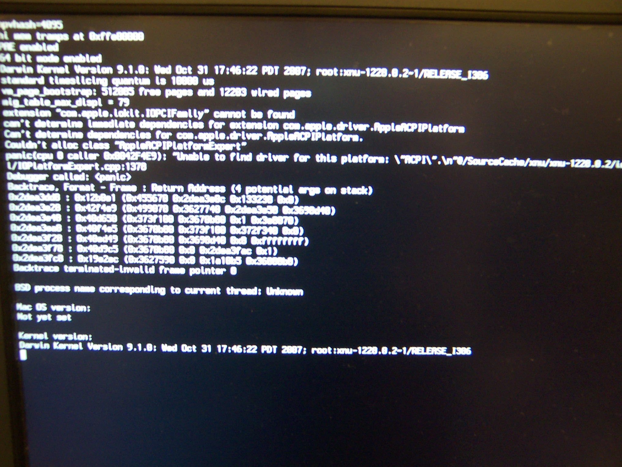

a2000rick Posted January 29, 2008 Share Posted January 29, 2008 I get a panic when I try to use REV6. Any Ideas of what can be done? I get this error even if I replace them with the original ones. I could boot with -x with the REV6 drivers, but once I replaced the original ones back I can't even boot with -x always stops on /System/Library/CoreServices/ManagedClient,app.Contents/MacOS/ManagedClient[110]: ODUEthernetAddress(): GetEthernetAddress()==5 and in -s I can't do much because for some reason everything is read only. Attached pic of what I get if I use -v Link to comment https://www.insanelymac.com/forum/topic/81036-cardbuspcmcia-pc-cards-for-leopard/page/10/#findComment-599558 Share on other sites More sharing options...
cloudrainstar Posted January 29, 2008 Share Posted January 29, 2008 I get a panic when I try to use REV6. Any Ideas of what can be done?I get this error even if I replace them with the original ones. I could boot with -x with the REV6 drivers, but once I replaced the original ones back I can't even boot with -x always stops on /System/Library/CoreServices/ManagedClient,app.Contents/MacOS/ManagedClient[110]: ODUEthernetAddress(): GetEthernetAddress()==5 and in -s I can't do much because for some reason everything is read only. Attached pic of what I get if I use -v I had the same panic as you, so i used the IOPCCardFaimly from rev6, and the original IOPCIFamily, and it booted. Link to comment https://www.insanelymac.com/forum/topic/81036-cardbuspcmcia-pc-cards-for-leopard/page/10/#findComment-599646 Share on other sites More sharing options...
Rubel Posted January 29, 2008 Share Posted January 29, 2008 Hi, - kernel panic after replacing iopccardfamily.kext and iopcifamily.kext from rev6 - take the original iopcicard leo is booting. but no PCCard Support. Greets, Rubel Link to comment https://www.insanelymac.com/forum/topic/81036-cardbuspcmcia-pc-cards-for-leopard/page/10/#findComment-599662 Share on other sites More sharing options...
~Eureka Posted January 29, 2008 Author Share Posted January 29, 2008 Hi Rubel, cloudrainstar, a2000rick, pumbaster, and Felipe Viegas, It will cause kernel panic with rev6 and AGPGart installed..... I am still trying to find the solutions to it..... Chun-Nan I get a panic when I try to use REV6. Any Ideas of what can be done?I get this error even if I replace them with the original ones.I could boot with -x with the REV6 drivers, but once I replaced the original ones back I can't even boot with -xalways stops on /System/Library/CoreServices/ManagedClient,app.Contents/MacOS/ManagedClient[110]: ODUEthernetAddress(): GetEthernetAddress()==5and in -s I can't do much because for some reason everything is read only.Attached pic of what I get if I use -v Hi a2000rick, You probably need to check the permissions to see if it is set correctly. If you have replaced AppleACPIPlatform.kext before, you need to restore it to the original AppleACPIPlatform.kext file. Chun-Nan Link to comment https://www.insanelymac.com/forum/topic/81036-cardbuspcmcia-pc-cards-for-leopard/page/10/#findComment-599673 Share on other sites More sharing options...

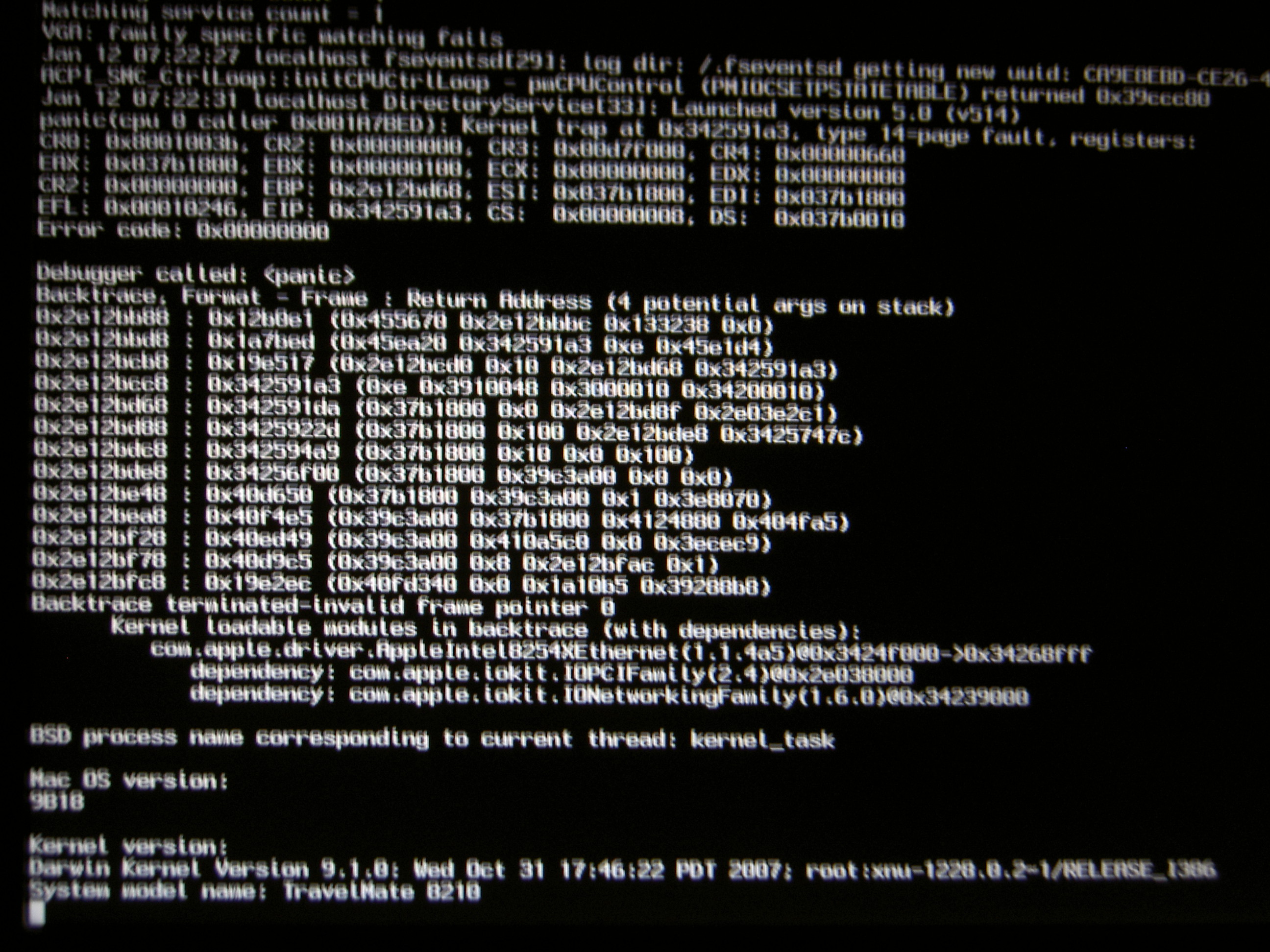

snam11 Posted January 30, 2008 Share Posted January 30, 2008 installed rev7. same issues of rev6: Found mouse PNP device AppleACPIPS2Nub startup complete mbinit: done Security auditing service present BSM auditing present Extension "com.apple.driver.AppleACPIPlatform" has immediate dependencies on both com.apple.kernel and com.apple.kpi components; use only one style. From path: "uuid", Waiting for boot volume with UUID F4EDFD34-C9E7-3FF1-A157-8A7E8C92493B Waiting on <dict ID="0"><key>IOProviderClass</key><string ID="1">IOResources</string><key>IOResourceMatch</key><string ID="2">boot-uuid-media</string></dict> PCI configuration changed (BUS free=1 needed=1 added=0) PCI configuration changed (BUS free=1 needed=2 added=1) PCI configuration changed (bridge=0 device=1 yenta=2) IOPCCard info: Intel PCIC probe: O2Micro OZ711MP1/MS1 rev 21 IOPCCard info: Intel PCIC probe: , O2Micro OZ711MP1/MS1 rev 21 FireWire (OHCI) VendorID 1217 ID f7 PCI now active, GUID 009fc0001a119e00; max speed s400. IOPCCard info: cs: memory probe 0xa0000000-0xa0ffffff: clean. IOPCCard16Device: binding socket 0 function 0 to card services. Extension "com.apple.driver.iTunesPhoneDriver" has no explicit kernel dependency; using version 6.0. Got boot device = IOService:/AppleACPIPlatformExpert/PCI0@0/AppleACPIPCI/USB7@1D,7/AppleUSBEHCI/NOONTEC USB Storage@fd410000/MSC Bulk-Only Transfer@0/IOUSBMassStorageClass/IOSCSIPeripheralDeviceNub/IOSCSIPeripheralDeviceType00/IOBlockStorageServices/IOBlockStorageDriver/Maxtor 6 AD1G Media/IOFDiskPartitionScheme/Untitled 1@1 BSD root: disk1s1, major 14, minor 3 USBF: 7.384 AppleUSBEHCI[0x39ab800]::Found a transaction which hasn't moved in 5 seconds on bus 0xfd, timing out! (Addr: 3, EP: 0) Jettisoning kernel linker. Resetting IOCatalogue. VGA: family specific matching fails Matching service count = 0 Matching service count = 1 IOPCCard16Device::matchPropertyTable entered. IOPCCardDevice: VersionOneInfo[0], "HP"(match string) != "O2Micro"(CIS string). pccardffff,1: family specific matching fails Matching service count = 1 IOPCCard16Device::matchPropertyTable entered. IOPCCardDevice: VersionOneInfo[0], "SCR243 PCMCIA"(match string) != "O2Micro"(CIS string). pccardffff,1: family specific matching fails Matching service count = 1 IOPCCard16Device::matchPropertyTable entered. IOPCCardDevice: VersionOneInfo[0], "SCR241 PCMCIA"(match string) != "O2Micro"(CIS string). pccardffff,1: family specific matching fails Matching service count = 1 IOPCCard16Device::matchPropertyTable entered. IOPCCardDevice: VersionOneInfo[0], "SCR24x PCMCIA"(match string) != "O2Micro"(CIS string). pccardffff,1: family specific matching fails Matching service count = 1 VGA: family specific matching fails ACPI_SMC_CtrlLoop::initCPUCtrlLoop - pmCPUControl (PMIOCSETPSTATETABLE) returned 0x3f95080 Apple16X50ACPI0: Identified Serial Port on ACPI Device=COMA Apple16X50UARTSync0: Detected 16550AF/C/CF FIFO=16 MaxBaud=115200 VGA: family specific matching fails ApplePS2Trackpad: Synaptics TouchPad v6.2 ALCinject: Starting. ALCinject: Setting built-in=<data not shown> ALCinject: Setting layout-id=<data not shown> VGA: family specific matching fails dsmos: Initializing... dsmos: Hook and decryption contexts set! dsmos: Starting... NTFS driver 2.0 [Flags: R/O]. NTFS volume name , version 3.1. ALF ALERT: sockwall_cntl_updaterules ctl_enqueuedata rts err 55 ALF ALERT: sockwall_cntl_updaterules ctl_enqueuedata rts err 55 ALF ALERT: sockwall_cntl_updaterules ctl_enqueuedata rts err 55 ALF ALERT: sockwall_cntl_updaterules ctl_enqueuedata rts err 55 ALF ALERT: sockwall_cntl_updaterules ctl_enqueuedata rts err 55 ALF ALERT: sockwall_cntl_updaterules ctl_enqueuedata rts err 55 ALF ALERT: sockwall_cntl_updaterules ctl_enqueuedata rts err 55 ALF ALERT: sockwall_cntl_updaterules ctl_enqueuedata rts err 55 ALF ALERT: sockwall_cntl_updaterules ctl_enqueuedata rts err 55 ALF ALERT: sockwall_cntl_updaterules ctl_enqueuedata rts err 55 ALF ALERT: sockwall_cntl_updaterules ctl_enqueuedata rts err 55 ALF ALERT: sockwall_cntl_updaterules ctl_enqueuedata rts err 55 ALF ALERT: sockwall_cntl_updaterules ctl_enqueuedata rts err 55 NTFS volume name BACKUP, version 3.1. i get this new alf alert message. the firewire speed "share" issue is still present. Is quite impossible to use any fw hdd with pcmcia (max speed of any plugged device is locked to 100 instead of 400/800), with internal firewire dv video capture doesn't work, remote yes. i can confirm all the IOPCCard16Device errors are related to smartcard reader, and i don't really care about it , hoping it will not interferire with pcmcia/firewire devices are also intel nic kernel panic related to iopcifamily(i've posted a pic in my previous message)? appleintel8254xethernet and smalltreeintelappleintel8254x(alternative driver) kext pops up bsd error with iopcifamily relationship Link to comment https://www.insanelymac.com/forum/topic/81036-cardbuspcmcia-pc-cards-for-leopard/page/10/#findComment-600899 Share on other sites More sharing options...

~Eureka Posted January 30, 2008 Author Share Posted January 30, 2008 Hi snam11, "ALF ALERT" error message is new to me. I have never seen it before so I don't know what caused it yet. Can you give me the dmesg info without any PCMCIA devices plugged into the slot? Also, you should have two firewire information when you plug your firewire device into the pccard slot. I found one "FireWire (OHCI) VendorID 1217 ID f7 PCI now active, GUID 009fc0001a119e00; max speed s400." and where is another one? I found that you have two pccard device on your machine and that is interesting. Chun-Nan ============== Hi evilturtlefromhell, I am not sure what you meant. Does your pcmcia work or not? Does your firewire work or not? Thanks. Chun-Nan Link to comment https://www.insanelymac.com/forum/topic/81036-cardbuspcmcia-pc-cards-for-leopard/page/10/#findComment-601566 Share on other sites More sharing options...

snam11 Posted January 30, 2008 Share Posted January 30, 2008 Hi snam11, "ALF ALERT" error message is new to me. I have never seen it before so I don't know what caused it yet. Can you give me the dmesg info without any PCMCIA devices plugged into the slot? Also, you should have two firewire information when you plug your firewire device into the pccard slot. I found one "FireWire (OHCI) VendorID 1217 ID f7 PCI now active, GUID 009fc0001a119e00; max speed s400." and where is another one? I found that you have two pccard device on your machine and that is interesting. Chun-Nan hi chun-nan in latest dmesg i've posted there are no pcmcia card plugged. anyway... here is a the rev7 dmesg without any pcmcia card plugged in: Found mouse PNP device AppleACPIPS2Nub startup complete mbinit: done Security auditing service present BSM auditing present Extension "com.apple.driver.AppleACPIPlatform" has immediate dependencies on both com.apple.kernel and com.apple.kpi components; use only one style. From path: "uuid", Waiting for boot volume with UUID F4EDFD34-C9E7-3FF1-A157-8A7E8C92493B Waiting on <dict ID="0"><key>IOProviderClass</key><string ID="1">IOResources</string><key>IOResourceMatch</key><string ID="2">boot-uuid-media</string></dict> PCI configuration changed (BUS free=1 needed=1 added=0) PCI configuration changed (BUS free=1 needed=2 added=1) PCI configuration changed (bridge=0 device=1 yenta=2) IOPCCard info: Intel PCIC probe: O2Micro OZ711MP1/MS1 rev 21 IOPCCard info: Intel PCIC probe: , O2Micro OZ711MP1/MS1 rev 21 FireWire (OHCI) VendorID 1217 ID f7 PCI now active, GUID 009fc0001a119e00; max speed s400. IOPCCard info: cs: memory probe 0xa0000000-0xa0ffffff: clean. IOPCCard16Device: binding socket 0 function 0 to card services. Extension "com.apple.driver.iTunesPhoneDriver" has no explicit kernel dependency; using version 6.0. Got boot device = IOService:/AppleACPIPlatformExpert/PCI0@0/AppleACPIPCI/USB7@1D,7/AppleUSBEHCI/NOONTEC USB Storage@fd410000/MSC Bulk-Only Transfer@0/IOUSBMassStorageClass/IOSCSIPeripheralDeviceNub/IOSCSIPeripheralDeviceType00/IOBlockStorageServices/IOBlockStorageDriver/Maxtor 6 AD1G Media/IOFDiskPartitionScheme/Untitled 1@1 BSD root: disk1s1, major 14, minor 3 USBF: 7.384 AppleUSBEHCI[0x39ab800]::Found a transaction which hasn't moved in 5 seconds on bus 0xfd, timing out! (Addr: 3, EP: 0) Jettisoning kernel linker. Resetting IOCatalogue. VGA: family specific matching fails Matching service count = 0 Matching service count = 1 IOPCCard16Device::matchPropertyTable entered. IOPCCardDevice: VersionOneInfo[0], "HP"(match string) != "O2Micro"(CIS string). pccardffff,1: family specific matching fails Matching service count = 1 IOPCCard16Device::matchPropertyTable entered. IOPCCardDevice: VersionOneInfo[0], "SCR243 PCMCIA"(match string) != "O2Micro"(CIS string). pccardffff,1: family specific matching fails Matching service count = 1 IOPCCard16Device::matchPropertyTable entered. IOPCCardDevice: VersionOneInfo[0], "SCR241 PCMCIA"(match string) != "O2Micro"(CIS string). pccardffff,1: family specific matching fails Matching service count = 1 IOPCCard16Device::matchPropertyTable entered. IOPCCardDevice: VersionOneInfo[0], "SCR24x PCMCIA"(match string) != "O2Micro"(CIS string). pccardffff,1: family specific matching fails Matching service count = 1 VGA: family specific matching fails ACPI_SMC_CtrlLoop::initCPUCtrlLoop - pmCPUControl (PMIOCSETPSTATETABLE) returned 0x3f95080 Apple16X50ACPI0: Identified Serial Port on ACPI Device=COMA Apple16X50UARTSync0: Detected 16550AF/C/CF FIFO=16 MaxBaud=115200 VGA: family specific matching fails ApplePS2Trackpad: Synaptics TouchPad v6.2 ALCinject: Starting. ALCinject: Setting built-in=<data not shown> ALCinject: Setting layout-id=<data not shown> VGA: family specific matching fails dsmos: Initializing... dsmos: Hook and decryption contexts set! dsmos: Starting... NTFS driver 2.0 [Flags: R/O]. NTFS volume name , version 3.1. ALF ALERT: sockwall_cntl_updaterules ctl_enqueuedata rts err 55 ALF ALERT: sockwall_cntl_updaterules ctl_enqueuedata rts err 55 ALF ALERT: sockwall_cntl_updaterules ctl_enqueuedata rts err 55 ALF ALERT: sockwall_cntl_updaterules ctl_enqueuedata rts err 55 ALF ALERT: sockwall_cntl_updaterules ctl_enqueuedata rts err 55 ALF ALERT: sockwall_cntl_updaterules ctl_enqueuedata rts err 55 ALF ALERT: sockwall_cntl_updaterules ctl_enqueuedata rts err 55 ALF ALERT: sockwall_cntl_updaterules ctl_enqueuedata rts err 55 ALF ALERT: sockwall_cntl_updaterules ctl_enqueuedata rts err 55 ALF ALERT: sockwall_cntl_updaterules ctl_enqueuedata rts err 55 ALF ALERT: sockwall_cntl_updaterules ctl_enqueuedata rts err 55 ALF ALERT: sockwall_cntl_updaterules ctl_enqueuedata rts err 55 ALF ALERT: sockwall_cntl_updaterules ctl_enqueuedata rts err 55 NTFS volume name BACKUP, version 3.1. this is the dmesg with a pcmcia firewire 400/800 card plugged in: "><key>IOProviderClass</key><string ID="1">IOResources</string><key>IOResourceMatch</key><string ID="2">boot-uuid-media</string></dict> PCI configuration changed (BUS free=1 needed=1 added=0) PCI configuration changed (BUS free=1 needed=2 added=1) PCI configuration changed (bridge=0 device=1 yenta=2) IOPCCard info: Intel PCIC probe: O2Micro OZ711MP1/MS1 rev 21 IOPCCard info: Intel PCIC probe: , O2Micro OZ711MP1/MS1 rev 21 FireWire (OHCI) VendorID 1217 ID f7 PCI now active, GUID 009fc0001a119e00; max speed s400. IOPCCard info: cs: cb_alloc(bus 11): vendor 0x104c, device 0x8025 IOPCCard info: cs: cb_alloc(bus 11): found 1 functions IOCardBusDevice: binding socket 0 function 0 to card services. IOPCCard info: cs: cb_config(bus 11) IOPCCard info: fn 0 bar 1: mem 0xa0004000-0xa00047ff IOPCCard info: fn 0 bar 2: mem 0xa0000000-0xa0003fff IOPCCard info: irq 20 IOPCCard info: cs: memory probe 0xa0000000-0xa0ffffff: excluding 0xa0000000-0xa00fffff IOPCCard16Device: binding socket 1 function 0 to card services. FireWire (OHCI) TI ID 8025 CardBus now active, GUID 000108000000fbf8; max speed s800. Extension "com.apple.driver.iTunesPhoneDriver" has no explicit kernel dependency; using version 6.0. Got boot device = IOService:/AppleACPIPlatformExpert/PCI0@0/AppleACPIPCI/USB7@1D,7/AppleUSBEHCI/NOONTEC USB Storage@fd410000/MSC Bulk-Only Transfer@0/IOUSBMassStorageClass/IOSCSIPeripheralDeviceNub/IOSCSIPeripheralDeviceType00/IOBlockStorageServices/IOBlockStorageDriver/Maxtor 6 AD1G Media/IOFDiskPartitionScheme/Untitled 1@1 BSD root: disk1s1, major 14, minor 3 Jettisoning kernel linker. Resetting IOCatalogue. VGA: family specific matching fails Matching service count = 0 Matching service count = 1 IOPCCard16Device::matchPropertyTable entered. IOPCCardDevice: VersionOneInfo[0], "HP"(match string) != "O2Micro"(CIS string). pccardffff,1: family specific matching fails Matching service count = 1 IOPCCard16Device::matchPropertyTable entered. IOPCCardDevice: VersionOneInfo[0], "SCR243 PCMCIA"(match string) != "O2Micro"(CIS string). pccardffff,1: family specific matching fails Matching service count = 1 IOPCCard16Device::matchPropertyTable entered. IOPCCardDevice: VersionOneInfo[0], "SCR241 PCMCIA"(match string) != "O2Micro"(CIS string). pccardffff,1: family specific matching fails Matching service count = 1 IOPCCard16Device::matchPropertyTable entered. IOPCCardDevice: VersionOneInfo[0], "SCR24x PCMCIA"(match string) != "O2Micro"(CIS string). pccardffff,1: family specific matching fails Matching service count = 1 VGA: family specific matching fails ACPI_SMC_CtrlLoop::initCPUCtrlLoop - pmCPUControl (PMIOCSETPSTATETABLE) returned 0x3a0a900 Apple16X50ACPI0: Identified Serial Port on ACPI Device=COMA Apple16X50UARTSync0: Detected 16550AF/C/CF FIFO=16 MaxBaud=115200 VGA: family specific matching fails ApplePS2Trackpad: Synaptics TouchPad v6.2 ALCinject: Starting. ALCinject: Setting built-in=<data not shown> ALCinject: Setting layout-id=<data not shown> probe mapDeviceMemoryWithRegister failed VGA: family specific matching fails dsmos: Initializing... dsmos: Hook and decryption contexts set! dsmos: Starting... NTFS driver 2.0 [Flags: R/O]. NTFS volume name , version 3.1. ALF ALERT: sockwall_cntl_updaterules ctl_enqueuedata rts err 55 ALF ALERT: sockwall_cntl_updaterules ctl_enqueuedata rts err 55 ALF ALERT: sockwall_cntl_updaterules ctl_enqueuedata rts err 55 ALF ALERT: sockwall_cntl_updaterules ctl_enqueuedata rts err 55 ALF ALERT: sockwall_cntl_updaterules ctl_enqueuedata rts err 55 ALF ALERT: sockwall_cntl_updaterules ctl_enqueuedata rts err 55 ALF ALERT: sockwall_cntl_updaterules ctl_enqueuedata rts err 55 ALF ALERT: sockwall_cntl_updaterules ctl_enqueuedata rts err 55 ALF ALERT: sockwall_cntl_updaterules ctl_enqueuedata rts err 55 ALF ALERT: sockwall_cntl_updaterules ctl_enqueuedata rts err 55 ALF ALERT: sockwall_cntl_updaterules ctl_enqueuedata rts err 55 ALF ALERT: sockwall_cntl_updaterules ctl_enqueuedata rts err 55 ALF ALERT: sockwall_cntl_updaterules ctl_enqueuedata rts err 55 NTFS volume name BACKUP, version 3.1. FireWire (OHCI) VendorID 1217 ID f7 PCI is the o2micro integrated firewire. FireWire (OHCI) TI ID 8025 is the pcmca firewire 400/800 card i've plugged into the pcmcia slot. (it's a pcmcia card with 2 firewire 800 ports and 1 firewire 400) i'm pretty sure all the IOPCCard16Device errors are linked to the smartcard reader (as you can see no matter if any pcmcia card is plugged in or not, the error always shows up). i guess i have 2 pccard devices:the pcmcia slot (standard and express) and the smartcard reader. do you think also this kp can be related to iopcifamily? Link to comment https://www.insanelymac.com/forum/topic/81036-cardbuspcmcia-pc-cards-for-leopard/page/10/#findComment-601643 Share on other sites More sharing options...

~Eureka Posted January 30, 2008 Author Share Posted January 30, 2008 Hi snam11, Did you put any device on both "standard and express" pccard? Is the smartcard reader built-in? Where/when did you get that kernel panic? with rev7 or other revision? Chun-Nan =============== Hi Mariusz, Can you show me the picture related to "SI could see unknown device under FireWire SystemProfiler'a tab"? Also, what device did you use to connect to your firewire connector on PCMCIA card? Chun-Nan Link to comment https://www.insanelymac.com/forum/topic/81036-cardbuspcmcia-pc-cards-for-leopard/page/10/#findComment-601681 Share on other sites More sharing options...
