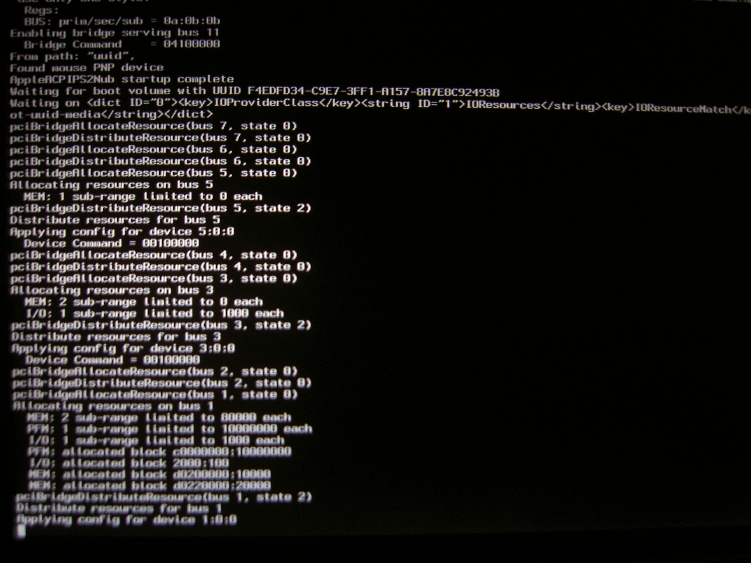

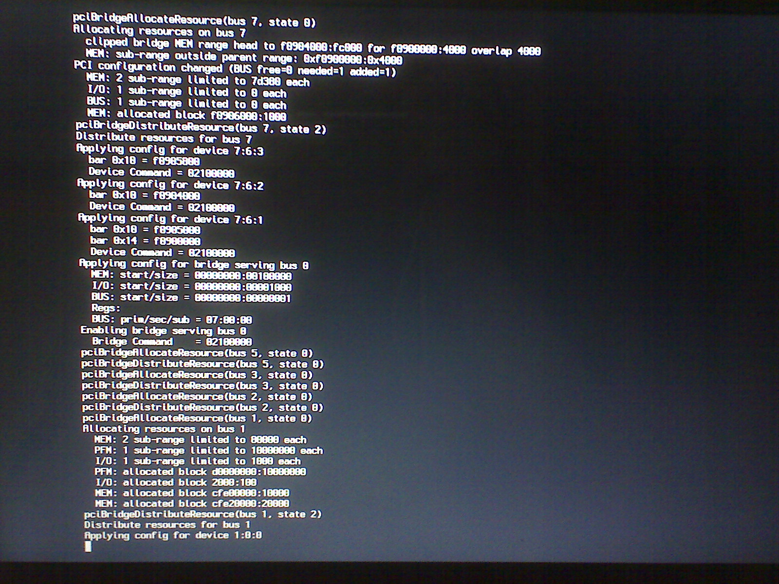

snam11 Posted February 2, 2008 Share Posted February 2, 2008 with rev11 i can't boot with -s, no matter if any pcmcia is plugged into the slot, the system hangs after the pcmcia messages i've attached the pic. booting with standard mode, the internal firewire is detected but has same probs of earliest releases. alf error is still present. pcmcia slot doesn't work anymore. smartcard slot is not detected, only the pcmcia.but no matter which device is plugged in, it doesn't work. i cannot dump the dmesg because log is too long so dmesg buffer doesn't show pcmcia infos. Link to comment https://www.insanelymac.com/forum/topic/81036-cardbuspcmcia-pc-cards-for-leopard/page/11/#findComment-605255 Share on other sites More sharing options...

EqUaTe Posted February 2, 2008 Share Posted February 2, 2008 Mariusz, snam11, Interesting that you both see essentially the same hang.. snam11: One thing you could try - look in /var/log/system.log - you may find the info there. More interesting is that I tried this one before it was released here, and it worked fine for me - in fact I'm using it now.. I've attached my dmesg output for reference, but Chun-Nan already has it. EqUaTe test_s.dmesg.txt Link to comment https://www.insanelymac.com/forum/topic/81036-cardbuspcmcia-pc-cards-for-leopard/page/11/#findComment-605359 Share on other sites More sharing options...
