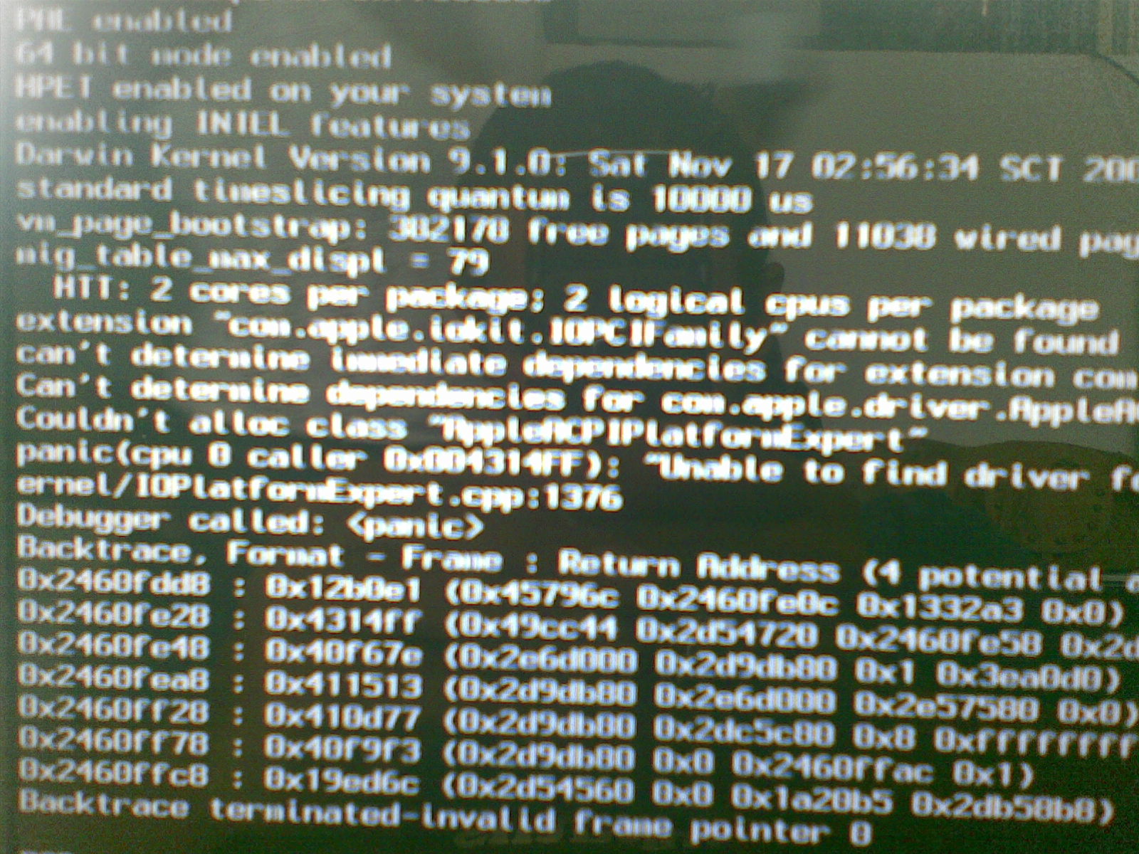

fakedotbr Posted January 17, 2008 Share Posted January 17, 2008 Hello Chun-nan. I tested a version test4, with the version rev5. Erase the Extensions.kext before changing the archives. Now the OSX not restart. He's kernel panic. But it is not the problem of incompatible versions. He says he does not find the IOPCIFamily.kext. I will try to recover soon. When back with my Leopard I stand here the dmesg. Thanks a lot. Junior Link to comment https://www.insanelymac.com/forum/topic/81036-cardbuspcmcia-pc-cards-for-leopard/page/5/#findComment-583069 Share on other sites More sharing options...
EqUaTe Posted January 17, 2008 Share Posted January 17, 2008 Hello Chun-nan. I tested a version test4, with the version rev5. Erase the Extensions.kext before changing the archives. Now the OSX not restart. He's kernel panic. But it is not the problem of incompatible versions. He says he does not find the IOPCIFamily.kext. I will try to recover soon. When back with my Leopard I stand here the dmesg. Thanks a lot. Junior Kinda sounds like you didn't fix the permissions - did you install the kexts by hand, or did you use kexthelper? It's definitely worth doing the permissions manually - diskutil doesn't always sort them. EqUaTe Link to comment https://www.insanelymac.com/forum/topic/81036-cardbuspcmcia-pc-cards-for-leopard/page/5/#findComment-583076 Share on other sites More sharing options...
fakedotbr Posted January 17, 2008 Share Posted January 17, 2008 Hi EqUaTe. Thanks for the reply. Yes.. i set correct permissions and diskutil repairPermissions. rm -f /System/Library/Extensions.mkext cd /System/Library/Extensions/ rm -rf IOPC* cp -rp ~junior/test4_rev5/IOPC* . chown -R root:wheel IOPC* chmod -R 755 IOPC* diskutil repairpermissions reboot Thats all folks Thanks a lot Kinda sounds like you didn't fix the permissions - did you install the kexts by hand, or did you use kexthelper? It's definitely worth doing the permissions manually - diskutil doesn't always sort them. EqUaTe Link to comment https://www.insanelymac.com/forum/topic/81036-cardbuspcmcia-pc-cards-for-leopard/page/5/#findComment-583103 Share on other sites More sharing options...
EqUaTe Posted January 17, 2008 Share Posted January 17, 2008 fakedotbr, Can you take a picture of the panic and upload it here? Cheers Link to comment https://www.insanelymac.com/forum/topic/81036-cardbuspcmcia-pc-cards-for-leopard/page/5/#findComment-583112 Share on other sites More sharing options...

fakedotbr Posted January 17, 2008 Share Posted January 17, 2008 Did you remove kext cache file?# rm -r /System/Library/Extensions.mkext Yes. I remove rm -f /System/Library/Extensions.mkext I will take a picture of the kernel panic and then back to rev3 back to the normal boot. Thanks Link to comment https://www.insanelymac.com/forum/topic/81036-cardbuspcmcia-pc-cards-for-leopard/page/5/#findComment-583138 Share on other sites More sharing options...
EqUaTe Posted January 17, 2008 Share Posted January 17, 2008 Yes. I removerm -f /System/Library/Extensions.mkext I will take a picture of the kernel panic and then back to rev3 back to the normal boot. Thanks This step isn't strictly necessary - you can use the boot flag -f as an alternative. Rebuilds the kext cache (mkext) EqUaTe Link to comment https://www.insanelymac.com/forum/topic/81036-cardbuspcmcia-pc-cards-for-leopard/page/5/#findComment-583142 Share on other sites More sharing options...

fakedotbr Posted January 17, 2008 Share Posted January 17, 2008 This step isn't strictly necessary - you can use the boot flag -f as an alternative.Rebuilds the kext cache (mkext) EqUaTe Yes I use flag -f from boot But he stopped on the screen is gray and does not start the rest of the OS. Link to comment https://www.insanelymac.com/forum/topic/81036-cardbuspcmcia-pc-cards-for-leopard/page/5/#findComment-583146 Share on other sites More sharing options...
EqUaTe Posted January 17, 2008 Share Posted January 17, 2008 YesI use flag -f from boot But he stopped on the screen is gray and does not start the rest of the OS. Was that with -v as well? Your best bet is to boot with -v -f -s and see what happens. Link to comment https://www.insanelymac.com/forum/topic/81036-cardbuspcmcia-pc-cards-for-leopard/page/5/#findComment-583154 Share on other sites More sharing options...
kizwan Posted January 17, 2008 Share Posted January 17, 2008 This step isn't strictly necessary - you can use the boot flag -f as an alternative.Rebuilds the kext cache (mkext) EqUaTe However you do it, rebuilds kext cache file is necessary when you put new kext file in extensions directory. There is another way to rebuild kext cache file, using command line, but I don't remember it. Failed to rebuild kext cache file will prevent new kext file to load properly. Cheers, kizwan Link to comment https://www.insanelymac.com/forum/topic/81036-cardbuspcmcia-pc-cards-for-leopard/page/5/#findComment-583156 Share on other sites More sharing options...
fakedotbr Posted January 17, 2008 Share Posted January 17, 2008 fakedotbr, Can you take a picture of the panic and upload it here? Cheers I Change IOPCCardFamily and IOPCIFamily for rev3. But the messagen continue. See that Link to comment https://www.insanelymac.com/forum/topic/81036-cardbuspcmcia-pc-cards-for-leopard/page/5/#findComment-583173 Share on other sites More sharing options...
fingerr Posted January 17, 2008 Share Posted January 17, 2008 I Change IOPCCardFamily and IOPCIFamily for rev3.But the messagen continue. See that Just a suggestion, try another AppleaACPIPlatform. Regards, Mariusz. Link to comment https://www.insanelymac.com/forum/topic/81036-cardbuspcmcia-pc-cards-for-leopard/page/5/#findComment-583177 Share on other sites More sharing options...
kizwan Posted January 17, 2008 Share Posted January 17, 2008 Just a suggestion, try another AppleaACPIPlatform. Regards, Mariusz. Look carefully, first it cannot found IOPCIFamily then AppleACPIPlatform failed to start. I think IOPCIFamily kext file is the cause of the problem. fakedotbr, can you enter single mode, with "-s" flag? If you can try double check IOPCIFamily kext file. Link to comment https://www.insanelymac.com/forum/topic/81036-cardbuspcmcia-pc-cards-for-leopard/page/5/#findComment-583183 Share on other sites More sharing options...
EqUaTe Posted January 17, 2008 Share Posted January 17, 2008 I Change IOPCCardFamily and IOPCIFamily for rev3.But the messagen continue. See that What are you using to change them? I suggest you restore the stock ones for now, to get the system working again. EqUaTe Link to comment https://www.insanelymac.com/forum/topic/81036-cardbuspcmcia-pc-cards-for-leopard/page/5/#findComment-583197 Share on other sites More sharing options...
fakedotbr Posted January 17, 2008 Share Posted January 17, 2008 I could boot again. I used the macdrive in windows to exchange the files IOPC *, used the rev3. After boot with the flag -s itself gave the permissions root: wheel and 755. And boot -f for to the enter MacOSX But with the rev3 he could not find PCMCIA. Which version should I try now? The last of the Chun-nan with which another version? Thanks EqUaTe, Mariusz, Kizwan Link to comment https://www.insanelymac.com/forum/topic/81036-cardbuspcmcia-pc-cards-for-leopard/page/5/#findComment-583201 Share on other sites More sharing options...

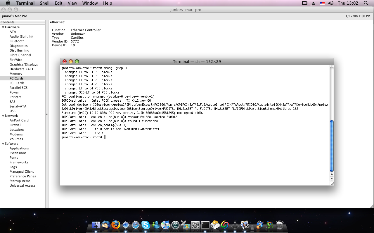

fakedotbr Posted January 17, 2008 Share Posted January 17, 2008 Hi All Have use the rev5 with test4. Now has an icon appears next to the icon of the sound. And also in the system profiler. But he still does not recognize my card wireless D-Link DWL-G650. What I did different was to change the IOPC and not erase the Extensions.mkext. Only booted with flag -f Thanks to all. Link to comment https://www.insanelymac.com/forum/topic/81036-cardbuspcmcia-pc-cards-for-leopard/page/5/#findComment-583248 Share on other sites More sharing options...
