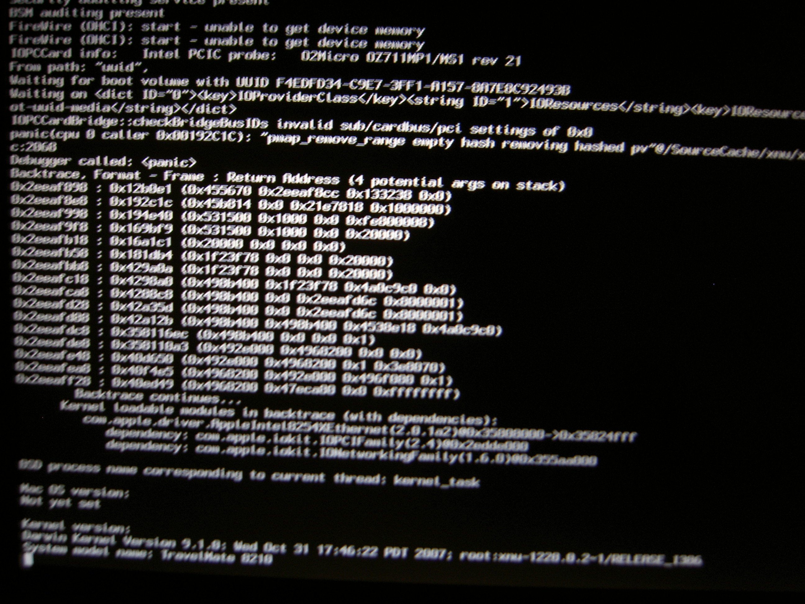

Felipe Viegas Posted January 24, 2008 Share Posted January 24, 2008 I tried to restore original kexts from terminal, but it didn't worked out. And, for my sadness, I was able to safe boot and replace the kexts. But that still gave me the kernel panic. Now safe booting again and trying to repair permissions. Lets see what happens. I will post the message. Thanks. Link to comment https://www.insanelymac.com/forum/topic/81036-cardbuspcmcia-pc-cards-for-leopard/page/9/#findComment-592210 Share on other sites More sharing options...
Felipe Viegas Posted January 24, 2008 Share Posted January 24, 2008 Updating, neither -s or -v will boot the system. I still can safe boot, but replacing the back up kexts or even the ToH DVD kexts will solve the problem. Anymore ideas? Link to comment https://www.insanelymac.com/forum/topic/81036-cardbuspcmcia-pc-cards-for-leopard/page/9/#findComment-592317 Share on other sites More sharing options...
kizwan Posted January 24, 2008 Share Posted January 24, 2008 Updating, neither -s or -v will boot the system. I still can safe boot, but replacing the back up kexts or even the ToH DVD kexts will solve the problem. Anymore ideas? Hi, Can you take the picture where it stuck (boot with "-v") so we can see what is going on? Link to comment https://www.insanelymac.com/forum/topic/81036-cardbuspcmcia-pc-cards-for-leopard/page/9/#findComment-592333 Share on other sites More sharing options...
Felipe Viegas Posted January 24, 2008 Share Posted January 24, 2008 actualy, I can't give u this picture, kizwan. But the system says that there is no driver for /ACPI/.......... and keep going with the diagnoses message. Why replacing the new kexts with the old kexts it's not working?? and if I just reinstall the system, without erasing the volume, will I delete my files on users folder? Thanks Link to comment https://www.insanelymac.com/forum/topic/81036-cardbuspcmcia-pc-cards-for-leopard/page/9/#findComment-592340 Share on other sites More sharing options...
kizwan Posted January 24, 2008 Share Posted January 24, 2008 actualy, I can't give u this picture, kizwan. But the system says that there is no driver for /ACPI/.......... and keep going with the diagnoses message. Why replacing the new kexts with the old kexts it's not working?? Emmm... maybe file permissions is not correct?! :censored2: and if I just reinstall the system, without erasing the volume, will I delete my files on users folder?Thanks It is much better if you backup your file to another location. Link to comment https://www.insanelymac.com/forum/topic/81036-cardbuspcmcia-pc-cards-for-leopard/page/9/#findComment-592356 Share on other sites More sharing options...
Felipe Viegas Posted January 24, 2008 Share Posted January 24, 2008 repair permissions is not working... trying tiger DVD righ now.. Link to comment https://www.insanelymac.com/forum/topic/81036-cardbuspcmcia-pc-cards-for-leopard/page/9/#findComment-592358 Share on other sites More sharing options...

EqUaTe Posted January 26, 2008 Share Posted January 26, 2008 Hy guys, that didn't work for me. I got a kernel panic on reboot. It says that couldn't find driver for pci card or something like that. I have backed up original kexts to desktop and tryied to copy them back to extensions folder.. but it didn't work. Any help?? My system was working fine. I wouldn't like to format. Thanks Take a screenshot of the panic, then boot off your install dvd and restore the kexts you were using previously. Just to check - you DID manually set the correct permissions, right? EqUaTe Link to comment https://www.insanelymac.com/forum/topic/81036-cardbuspcmcia-pc-cards-for-leopard/page/9/#findComment-595009 Share on other sites More sharing options...
pumbaster Posted January 27, 2008 Share Posted January 27, 2008 hi all! Somebody has positive experience with O2Micro OZ6912/601/711E0 (Vendor 1217, DevID 6972) ???? Please HELP!!! I've Dell Latitude D620, iATKOS 1.0i, EFI loader and genuine kernal+AppleACPIPlatform,IOACPIFamily... and other needed kexts. When i use Chun-Nan's rev6 prebuilded IOPCIFamily+IOPCCardFamily what i've got is just a kernel panic during IOPCCard initialization. I've tried to build rev6 from sources with debug options enabled, now there is no kernel panic but following message: IOPCCard info: Mac OS X PCMCIA Card Services 3.1.22 IOPCCard info: options: [pci] [cardbus] [pnp] IOPCCard debug: IOPCCardBridge::probe IOPCCard debug: IOPCCardBridge::start IOPCCard debug: IOPCCardBridge::configure IOPCCard debug: adding bridge mem space 0x0-0xfffff IOPCCard debug: cs: CardServices(AdjustResourceInfo, 0x0x12345678, 0x0x2b7a7cb4) IOPCCard debug: adding bridge io space 0x0-0xfff IOPCCard debug: cs: CardServices(AdjustResourceInfo, 0x0x12345678, 0x0x2b7a7cb4) IOPCCardBridge::start failed IOPCCard debug: IOPCCardBridge::stop IOPCCard debug: IOPCCardBridge::free Below is ioreg -l -x output: +-o IOPCI2PCIBridge <class IOPCI2PCIBridge, registered, matched, active, busy 0, retain 7> | | | | { | | | | "IOProviderClass" = "IOPCIDevice" | | | | "IOProbeScore" = 0xffffffffffffff9c | | | | "CFBundleIdentifier" = "com.apple.iokit.IOPCIFamily" | | | | "Bridge Memory Ranges" = (0xfffffffffff00000,0xfffff,0xfffffffffff00000,0xfffff) <---- Weird, is'nt it? | | | | "IOMatchCategory" = "IODefaultMatchCategory" | | | | "Bridge IO Ranges" = (0xf000,0xfff) <--- Weird, is'nt it? | | | | "IONameMatched" = "pci-bridge" | | | | "IOClass" = "IOPCI2PCIBridge" | | | | "IONameMatch" = "pci-bridge" | | | | "IOPowerManagement" = {"ChildrenPowerState"=0x2,"CurrentPowerState"=0x2} | | | | "IOPCIConfigured" = Yes | | | | } | | | | | | | +-o CRD0@1 <class IOPCIDevice, registered, matched, active, busy 0, retain 6> | | | { | | | "IOPCIResourced" = Yes | | | "#address-cells" = <03000000> | | | "IOName" = "pci1217,6972" | | | "subsystem-id" = <00000000> | | | "IOInterruptControllers" = ("io-apic-0") | | | "IOPMPCIConfigSpaceVolatile" = No | | | "class-code" = <00070600> | | | "IOPowerManagement" = {"CurrentPowerState"=0x2} | | | "revision-id" = <40000000> | | | "IOInterruptSpecifiers" = (<1200000007000000>) | | | "IOChildIndex" = 0x1 | | | "device-id" = <72690000> | | | "vendor-id" = <17120000> | | | "acpi-path" = "IOACPIPlane:/_SB/PCI0@0/PCIE@1e0000/CRD0@10000" | | | "ranges" = <00000082000000000000000000000082000000000000000000000000000010000000008100000 0000000$ | | | "subsystem-vendor-id" = <01000000> | | | "name" = "pci1217,6972" | | | "reg" = <00080300000000000000000000000000000000001008030200000000000000000000000000100 00> | | | "compatible" = <706369312c3000706369313231372c3639373200706369636c6173732c30363037303000> | | | "IOPCIHotPlug" = Yes | | | "#size-cells" = <02000000> Link to comment https://www.insanelymac.com/forum/topic/81036-cardbuspcmcia-pc-cards-for-leopard/page/9/#findComment-596347 Share on other sites More sharing options...

Slice Posted January 27, 2008 Share Posted January 27, 2008 Yes, my device id (17127269) is presented in iopcifamily.. The problem is not in DeviceID. Look my investigations http://forum.insanelymac.com/index.php?sho...81048&st=35 and above. IOPCIFamily doesn't get good IODeviceMemory property as you see too. Link to comment https://www.insanelymac.com/forum/topic/81036-cardbuspcmcia-pc-cards-for-leopard/page/9/#findComment-596976 Share on other sites More sharing options...

pumbaster Posted January 28, 2008 Share Posted January 28, 2008 The problem is not in DeviceID.Look my investigations http://forum.insanelymac.com/index.php?sho...81048&st=35 and above. IOPCIFamily doesn't get good IODeviceMemory property as you see too. any ideas how to fix it?? I've tried 10.4.6, 10.4.8, 10.4.9, 10.5.0 and everywhere same result.. =( Link to comment https://www.insanelymac.com/forum/topic/81036-cardbuspcmcia-pc-cards-for-leopard/page/9/#findComment-597975 Share on other sites More sharing options...
