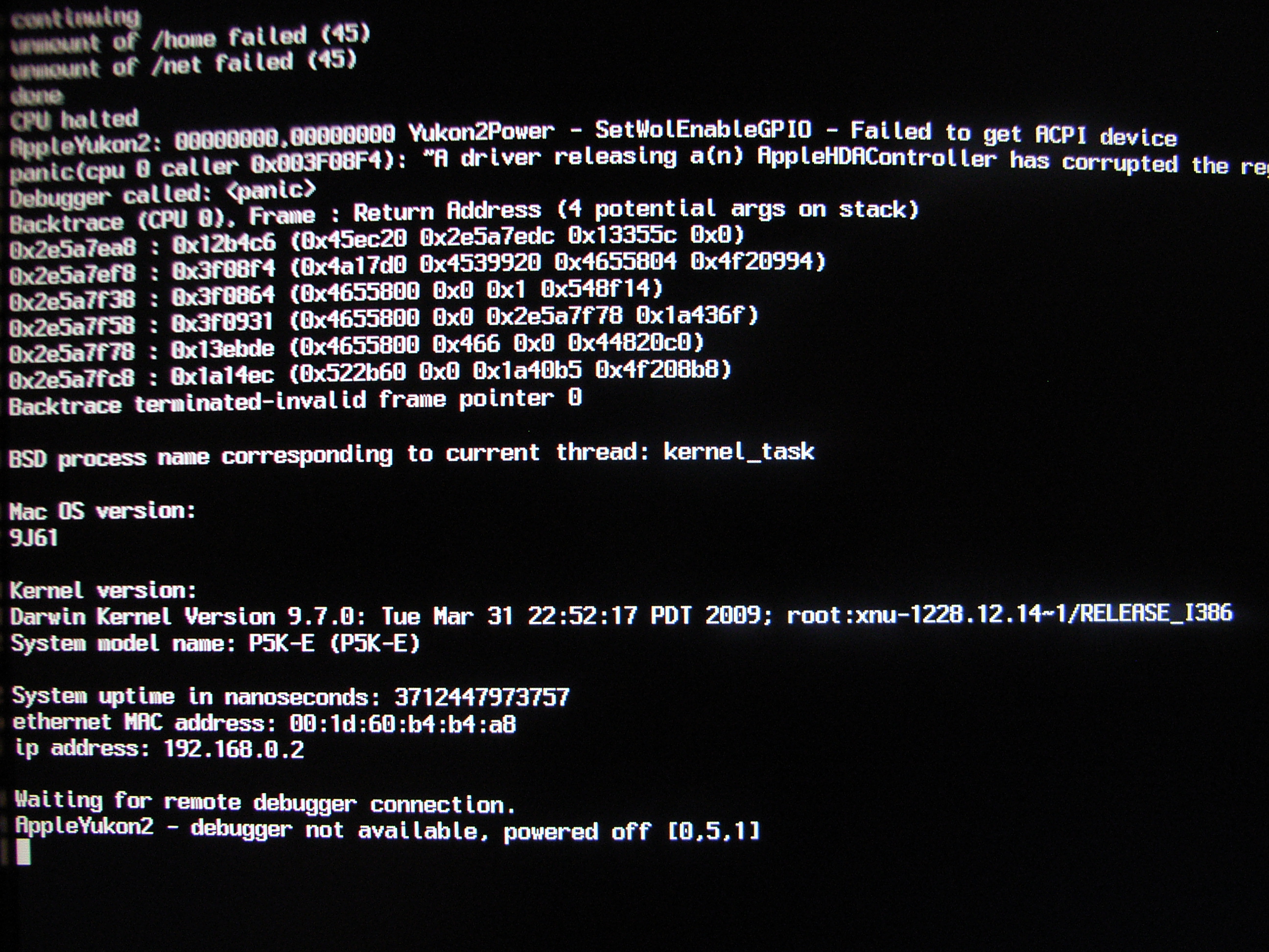

guenthergruen Posted June 3, 2009 Share Posted June 3, 2009 Turn debug on, find out which kext is the one responsible for the KP, seatbelt kext fixes some KP10.5.7 system? Using AppleHDA + LegacyAppleHDA... ? Hi Jimmy, do you get anything out of the picture I added in my last post, I still need help with that shutdown. Sorry I don't want to be annoying, I just don't understand all of it, although Im getting better. I added the picture one more time. Can this have something to do with ACPI?Last time I tried to shut down, this was what verbose mode + debugger gave me: Pic attached If you can't help me, ok, thx anyways you have already been such a great help...all of you of course are. Link to comment https://www.insanelymac.com/forum/topic/79096-p5k-se-retail-leopard-instalation/page/22/#findComment-1168907 Share on other sites More sharing options...
Jimmy Mallmann Posted June 3, 2009 Author Share Posted June 3, 2009 AppleYukon (ethernet), also sound incompatibilities See if you need to downgrade this kext... Also you could inform which is your Ethernet and Sound Card! Update this kext Hi Jimmy, do you get anything out of the picture I added in my last post, I still need help with that shutdown. Sorry I don't want to be annoying, I just don't understand all of it, although Im getting better. I added the picture one more time. If you can't help me, ok, thx anyways you have already been such a great help...all of you of course are. Link to comment https://www.insanelymac.com/forum/topic/79096-p5k-se-retail-leopard-instalation/page/22/#findComment-1168914 Share on other sites More sharing options...
allemattio Posted June 3, 2009 Share Posted June 3, 2009 I think it's a coincidence, but one of the hard drives has started to show read/write errors. sorry..but...I didn't understand... and so what I have to do to solve the problem? thanks Link to comment https://www.insanelymac.com/forum/topic/79096-p5k-se-retail-leopard-instalation/page/22/#findComment-1169059 Share on other sites More sharing options...
guenthergruen Posted June 3, 2009 Share Posted June 3, 2009 AppleYukon (ethernet), also sound incompatibilitiesSee if you need to downgrade this kext... Also you could inform which is your Ethernet and Sound Card! Ah, ok so its Ethernet and or soundcard, thats wired, since they seem to work flawlessly, I'll try to downgrade them. I have the regular sound and Lan which comes onboard with my P5K-E WiFi App. Its the AD1988B and the Marvell 88E8056 Gigabit LAN. Thanks for your answer. Link to comment https://www.insanelymac.com/forum/topic/79096-p5k-se-retail-leopard-instalation/page/22/#findComment-1169120 Share on other sites More sharing options...
Jimmy Mallmann Posted June 3, 2009 Author Share Posted June 3, 2009 Before downgrading... did you install seatbelt.kext? That could solve your problem. Ah, ok so its Ethernet and or soundcard, thats wired, since they seem to work flawlessly, I'll try to downgrade them.I have the regular sound and Lan which comes onboard with my P5K-E WiFi App. Its the AD1988B and the Marvell 88E8056 Gigabit LAN. Thanks for your answer. Link to comment https://www.insanelymac.com/forum/topic/79096-p5k-se-retail-leopard-instalation/page/22/#findComment-1169166 Share on other sites More sharing options...
