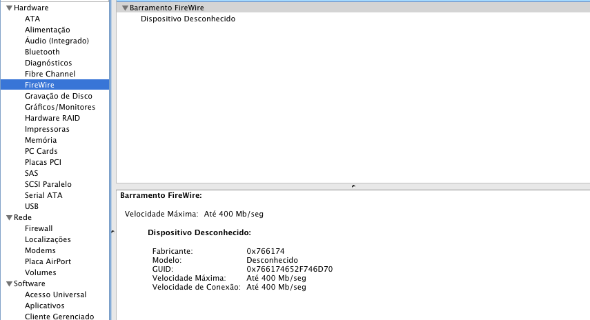

evandro altimari Posted July 10, 2009 Share Posted July 10, 2009 Congratulations on first post, very useful, I have problem to configure the firewire pci via vt 6306, the OSX recognizes, the more it does not work, you know the Why? Thanks !!! Link to comment https://www.insanelymac.com/forum/topic/79096-p5k-se-retail-leopard-instalation/page/27/#findComment-1197162 Share on other sites More sharing options...

evandro altimari Posted July 10, 2009 Share Posted July 10, 2009 Congratulations on first post, very useful, I have problem to configure the firewire pci via vt 6306, the OSX recognizes, the more it does not work, you know the Why? Thanks !!! the device is plugged into the system, not more work Link to comment https://www.insanelymac.com/forum/topic/79096-p5k-se-retail-leopard-instalation/page/27/#findComment-1197354 Share on other sites More sharing options...
Jimmy Mallmann Posted July 11, 2009 Author Share Posted July 11, 2009 Hi, well, I know that vt6307 devices work, you could try adding some 6306 ids to the proper Info.plist, if not, try getting a vt6307 or a FW323-06 based pci card. ... Also install HDAEnabler.kext, that should do. (Legacy... + HDAEnabler) Jimmy,I reinstalled sound kext from 10.5.6 and deleted the voodoo and voodoops2 controller kext. But I go to sound preferences it displays no input devices found. Perhaps I'm missing a step. Can you guide me thru this one? Thanks Link to comment https://www.insanelymac.com/forum/topic/79096-p5k-se-retail-leopard-instalation/page/27/#findComment-1197676 Share on other sites More sharing options...

evandro altimari Posted July 12, 2009 Share Posted July 12, 2009 Hi, well, I know that vt6307 devices work, you could try adding some 6306 ids to the proper Info.plist, if not, try getting a vt6307 or a FW323-06 based pci card. not achieve the above models and the compatible ? Texas Instruments chipset http://cgi.ebay.com/4-ports-T-I-IEEE-1394-...%3A1%7C294%3A50 thanks for help ! Link to comment https://www.insanelymac.com/forum/topic/79096-p5k-se-retail-leopard-instalation/page/27/#findComment-1198753 Share on other sites More sharing options...
Jimmy Mallmann Posted July 12, 2009 Author Share Posted July 12, 2009 Hi, you need to know the chipset used in this one. There are some working models here (link) .... Link to comment https://www.insanelymac.com/forum/topic/79096-p5k-se-retail-leopard-instalation/page/27/#findComment-1198779 Share on other sites More sharing options...
