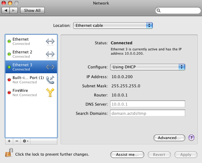

Cave Man Posted February 1, 2009 Share Posted February 1, 2009 OK, this is strange. I ran Migration Assistant last night and this morning I when I checked the computer MA was done and there was an alert telling me a "new" ethernet port was found. Obviously MA copied something over that let the OS see the port. The problem is, it does not see my Airport Extreme Base Station. It has a non-functional IP address (10.211.55.2 - NOT self-assigned), but it does not see the router. I have my AEBS set to assign 10.0.0.xxx addresses and all the other Macs in the house have these, and the router itself is 10.0.0.1. I've tried a reboot but the computer does not get an appropriate 10.0.0.xxx ip address and, thus, remains nonfunctional. I have not installed the Yukon driver you linked to - I thought I'd better wait to see if this new development is revealing. I also discovered I don't have QE or CI. Does the NVInstaller .41 fix this or is there a more recent version I need? I have the MSI 8600GT and had both QE and CI under 10.5.3 (and I'm pretty sure under 10.5.6 prior to MA). Thanks again for your help - it is greatly appreciated. Link to comment Share on other sites More sharing options...

Cave Man Posted February 1, 2009 Share Posted February 1, 2009 OK, I dl'd the AppleYukon.kext and installed it with OSX86Tools, rebooted (without power down) and the problem persists. I have two ethernet connections (en1 = 10.37.29.2, en2 = 10.211.55.2), both have green buttons next to them and are connected. However, they do not work as I am prompted with the "not connected to the internet" message in Safari. I've turned each of them off to see if that works and it doesn't. My subnet is 255.255.255.0 (as expected), but it is still not picking up my AEBSn router (10.0.0.1). All of this is set with Using DHCP for getting an ip address, as with the other Macs in the house. I am going to shut it down and reconnect my 10.5.3 drive to see if the ethernet is still working with it. ---------------------- OK, this is not making any sense. I've booted up with the 10.5.3 drive, which was working just fine with the network yesterday, and it is no longer getting an ip address from my AEBSn, either. There are two additional ethernets (en3 and en4) with the same ip addresses as the 10.5.6 drive (en2=en3 address, en1=en4 address). This seems to suggest it's a hardware issue? I'm going to shut everything down, unplug and reboot. ---------------------- This did not solve the problem. Now my internet access is screwed with both drives. I'm beginning to suspect the 10.5.6 install is just fine, but that somehow the ethernet adapter is mucked up. Any ideas? ---------------------- SUCCESS!!! I hope someone can explain this. My 10.5.6 installer gave me two ethernet connections (Ethernet, Ethernet 2, see attached picture), both of which have bogus ip addresses noted above. So out of desperation, I clicked on the '+' at the bottom left of the Network pane of System Preferences to add Ethernet 3 (port en0) and it gets a proper ip address of 10.0.0.200 and my router shows up as well. Now everything is working just fine. WTF? A BIG thanks, Jimmy. I wish I could buy you a beer or two. Link to comment Share on other sites More sharing options...
Jimmy Mallmann Posted February 2, 2009 Author Share Posted February 2, 2009 Good it worked there! sometimes issues happens.. We have to remmember we are hacking! ... SUCCESS!!! ..... A BIG thanks, Jimmy. I wish I could buy you a beer or two. Link to comment Share on other sites More sharing options...
