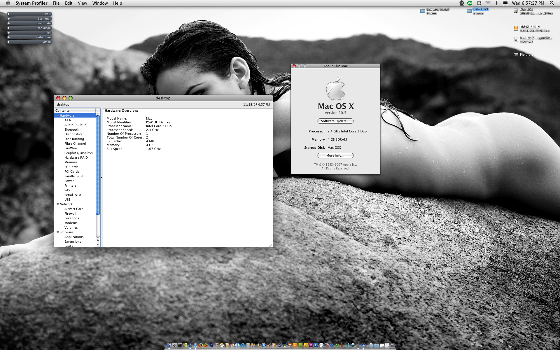

ho11ywood45 Posted November 28, 2007 Share Posted November 28, 2007 i tried this this morning before work crossing my fingers but i encounter the reboot loop after installed the EFI ... has anyone figured out why it does this or could you tell me what causes this on my system? i know p5w dh deluxe has had troubles but is that the issue? im running a e6600 core 2 so i know my requirements are fine ... im gonna try digitmemos guide after work but didnt have time this morning let me know if anyone has had the same problems or what they did to fix this thanks Link to comment https://www.insanelymac.com/forum/topic/72493-leopard-perfect-install/page/10/#findComment-521636 Share on other sites More sharing options...
curvie Posted November 28, 2007 Share Posted November 28, 2007 i tried this this morning before work crossing my fingers but i encounter the reboot loop after installed the EFI ... has anyone figured out why it does this or could you tell me what causes this on my system? i know p5w dh deluxe has had troubles but is that the issue? im running a e6600 core 2 so i know my requirements are fine ... im gonna try digitmemos guide after work but didnt have time this morning let me know if anyone has had the same problems or what they did to fix this thanks Hi there, I ran into this same issue last night. Finally it came down to a bios setting for the p5wdh mobo. You can get the info from this thread here. To summarize, you must toggle these settings in your bios: Execute Disable Function - EnableACPI 2 Support - Yes and Speed step - Disable Hope this resolves your issues. Link to comment https://www.insanelymac.com/forum/topic/72493-leopard-perfect-install/page/10/#findComment-521720 Share on other sites More sharing options...
ho11ywood45 Posted November 28, 2007 Share Posted November 28, 2007 Hi there, I ran into this same issue last night. Finally it came down to a bios setting for the p5wdh mobo. You can get the info from this thread here. To summarize, you must toggle these settings in your bios: Hope this resolves your issues. ohhhh mannnnn if that is the case you are gonna make me one happy camper ... i cant wait to get home and try this .... ill update soon Link to comment https://www.insanelymac.com/forum/topic/72493-leopard-perfect-install/page/10/#findComment-521825 Share on other sites More sharing options...

ho11ywood45 Posted November 29, 2007 Share Posted November 29, 2007 YAY!!!!!!!!! it works! the guide is spot on. the p5b dh bios hack perfect now to upgrade to 10.5.1 with the software update Link to comment https://www.insanelymac.com/forum/topic/72493-leopard-perfect-install/page/10/#findComment-522216 Share on other sites More sharing options...
curvie Posted November 29, 2007 Share Posted November 29, 2007 YAY!!!!!!!!! it works! the guide is spot on. the p5b dh bios hack perfect now to upgrade to 10.5.1 with the software update Glad it worked! Hot wallpaper Link to comment https://www.insanelymac.com/forum/topic/72493-leopard-perfect-install/page/10/#findComment-522245 Share on other sites More sharing options...
