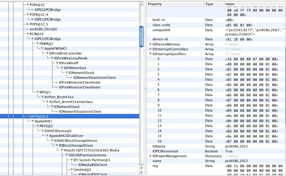

bikinifarm Posted November 30, 2009 Share Posted November 30, 2009 @DB1/BlackCH I am thinking that BlackCH is probably right about the interrupts. I did a little digging into the IOReg with my rather limited understanding of interrupts, and I find; Nvidia uses interrupt 10,7 in dsdt version 3.1 and 3.2, but there is the following difference: 3.1: | | | | "IOInterruptSpecifiers" = (<1000000007000000>,<0000000000000100>) 3.2: | | | | "IOInterruptSpecifiers" = (<1000000007000000>,<0100000000000100>) FW (Builtin) uses interrupt 14,7 in version 3.1 but uses 12,7 in version 3.2. FW (800) uses interrupt 10,7 in version 3.1, and MIA in version 3.2. Also, it seems that USB is also using 12,7. Seems like interrupt changes in ver 3.2 may possibly be driving the FW800 going MIA. Could the change to the interrupt 10,7 be the culprit? Many thanks. Link to comment https://www.insanelymac.com/forum/topic/62111-how-to-asus-p5k-vm-guide/page/34/#findComment-1346158 Share on other sites More sharing options...
BlackCH Posted November 30, 2009 Share Posted November 30, 2009 @DB1/BlackCH I am thinking that BlackCH is probably right about the interrupts. I did a little digging into the IOReg with my rather limited understanding of interrupts, and I find; Nvidia uses interrupt 10,7 in dsdt version 3.1 and 3.2, but there is the following difference: 3.1: | | | | "IOInterruptSpecifiers" = (<1000000007000000>,<0000000000000100>) 3.2: | | | | "IOInterruptSpecifiers" = (<1000000007000000>,<0100000000000100>) FW (Builtin) uses interrupt 14,7 in version 3.1 but uses 12,7 in version 3.2. FW (800) uses interrupt 10,7 in version 3.1, and MIA in version 3.2. Also, it seems that USB is also using 12,7. Seems like interrupt changes in ver 3.2 may possibly be driving the FW800 going MIA. Could the change to the interrupt 10,7 be the culprit? Many thanks. IMO the problem is related to IRQs. It used happens the same between HPET and onboard firewire. What you might try is to free resources (disable on board firewire for example; Also disable unused devices in BIOS like paralell, serial ports, etc -. I dont know if that make a difference but worth trying)) and hope either your graphics or your firewire card get assigned to another irq or maybe plugging the card in a different slot. Maybe there is a way to force devices to be assigned to a specific IRQ but I do not know it. Maybe you can ask Master Chief at the P5K Pro thread Link to comment https://www.insanelymac.com/forum/topic/62111-how-to-asus-p5k-vm-guide/page/34/#findComment-1346369 Share on other sites More sharing options...
DB1 Posted November 30, 2009 Share Posted November 30, 2009 IMHO I dont think it's IRQ problem. v3.2 IOREG | | | +-o FRWR@2 <class IOPCIDevice, [color="#0000FF"]id 0x100000152[/color], registered, matched, active, busy 0 (1584 ms), retain 10> | | | | +-o AppleFWOHCI <class AppleFWOHCI,[color="#0000FF"] id 0x1000001c9[/color], !registered, !matched, active, busy 0 (1162 ms), | | | | +-o IOFireWireController <class IOFireWireController, [color="#0000FF"]id 0x1000001cb[/color], registered, matched, active, busy | | | | +-o IOFireWireLocalNode <class IOFireWireLocalNode, i[color="#0000FF"]d 0x1000002a8[/color], registered, matched, active, busy 0 (1162 ms), retain 12> | | | | +-o IOFireWireUserClientIniter <class IOFireWireUserClientIniter, [color="#708090"]id 0x1000002bf[/color], !registered, !matched, active, busy 0, retain 4> | | | | +-o IOFireWireUserClientIniter <class IOFireWireUserClientIniter, [color="#0000FF"]id 0x1000002c0[/color], !registered, !matched, active, busy 0, retain 4> | | | | +-o IOFireWireIP <class IOFireWireIP, [color="#0000FF"]id 0x1000002c1[/color], registered, matched, active, busy 0 (68 ms), retain 5> | | | | +-o IOFWInterface <class IOFWInterface,[color="#0000FF"] id 0x1000002c3[/color], registered, matched, active, busy 0 (66 ms), retain 10> | | | | +-o IONetworkStack <class IONetworkStack, [color="#0000FF"]id 0x1000002ef[/color], registered, matched, active, busy 0 (5 ms), retain 9> | | | +-o pci104c,8025@0 <class IOPCIDevice, [color="#0000FF"]id 0x100000172[/color], registered, matched, active, busy 0 (561 ms), retain 10> | | | +-o AppleFWOHCI <class AppleFWOHCI, [color="#0000FF"]id 0x1000001d0[/color], !registered, !matched, active, busy 0, retain 6> | | | [color="#FF0000"]+-o IOFireWireController <class IOFireWireController, [/color][color="#0000FF"]id 0x1000001d2[/color], [color="#FF0000"]!registered, !matched, active, busy 0, [u][b]retain 6>[/b][/u][/color] v3.1 IOREG | | | +-o FRWR@2 <class IOPCIDevice, [color="#0000FF"]id 0x100000158[/color], registered, matched, active, busy 0 (1639 ms), retain 9> | | | | +-o AppleFWOHCI <class AppleFWOHCI, [color="#0000FF"]id 0x1000001c1[/color], !registered, !matched, active, busy 0 (828 ms), retain 6> | | | | +-o IOFireWireController <class IOFireWireController, [color="#0000FF"]id 0x1000001c3[/color], registered, matched, active, busy 0 | | | | +-o IOFireWireLocalNode <class IOFireWireLocalNode,[color="#0000FF"] id 0x1000002ba[/color], registered, matched, active, busy 0 | | | | +-o IOFireWireUserClientIniter <class IOFireWireUserClientIniter, [color="#0000FF"]id 0x1000002cf[/color], !registered, !matched, | | | | +-o IOFireWireUserClientIniter <class IOFireWireUserClientIniter, [color="#0000FF"]id 0x1000002d0[/color], !registered, !matched, | | | | +-o IOFireWireIP <class IOFireWireIP, [color="#0000FF"]id 0x1000002d1[/color], registered, matched, active, busy 0 (88 ms), | | | | +-o IOFWInterface <class IOFWInterface, [color="#0000FF"]id 0x1000002d3[/color], registered, matched, active, busy 0 (85 ms), | | | | +-o IONetworkStack <class IONetworkStack, [color="#0000FF"]id 0x1000002f7[/color], registered, matched, active, busy 0 (16 | | | +-o pci104c,8025@0 <class IOPCIDevice, [color="#0000FF"]id 0x10000017c[/color], registered, matched, active, busy 0 (16045 ms), retain | | | +-o AppleFWOHCI <class AppleFWOHCI, [color="#0000FF"]id 0x1000001bf[/color], !registered, !matched, active, busy 0 (15235 ms), retain | | | +-o [color="#FF0000"]IOFireWireController <class IOFireWireController[/color], [color="#0000FF"]id 0x1000001c4[/color],[color="#FF0000"] registered, matched, active, busy 0 [/color] [color="#008000"] | | | | +-o IOFireWireUserClientIniter <class IOFireWireUserClientIniter, id 0x1000002d4, !registered, !matched, | | | | +-o IOFireWireUserClientIniter <class IOFireWireUserClientIniter, id 0x1000002d5, !registered, !matched, | | | | +-o IOFireWireIP <class IOFireWireIP, id 0x1000002d6, registered, matched, active, busy 0 (86 ms), | | | | +-o IOFWInterface <class IOFWInterface, id 0x1000002d8, registered, matched, active, busy 0 (85 ms), | | | | +-o IONetworkStack <class IONetworkStack, id 0x1000002f7, registered, matched, active, busy 0 (16 | | | +-o IOFireWireDevice@30e002002a0275 <class IOFireWireDevice, id 0x1000002bc, registered, matched, active, busy 0 (15134 ms), retain 27> | | | +-o IOFireWireUnit <class IOFireWireUnit, id 0x1000002bd, registered, matched, active, busy 0 (15115 ms), retain 9> | | | | +-o IOFireWireSBP2Target <class IOFireWireSBP2Target, id 0x1000002d9, registered, matched, active, busy 0 (14304 ms), retain 10> | | | | | +-o IOFireWireSBP2LUN <class IOFireWireSBP2LUN, id 0x1000002db, registered, matched, active, busy 0 (14304 ms), retain 8> | | | | | +-o com_apple_driver_Oxford_Semi_FW912 <class com_apple_driver_Oxford_Semi, id 0x100000339, registered, matched, active, busy 0 (8284 ms), retain 8> | | | | | | +-o IOSCSIPeripheralDeviceNub <class IOSCSIPeripheralDeviceNub, id 0x100000345, registered, matched, active, busy 0 (193 ms), retain 6> | | | | | | +-o IOSCSIPeripheralDeviceType0E <class IOSCSIPeripheralDeviceType0E, id 0x1000003b4, !registered, !matched, active, busy 0 (63 ms), retain 6> | | | | | | +-o IOReducedBlockServices <class IOReducedBlockServices, id 0x1000003b9, registered, matched, active, busy 0 (63 ms), retain 5> | | | | | | +-o IOBlockStorageDriver <class IOBlockStorageDriver, id 0x1000003bd, registered, matched, active, busy 0 (58 ms), retain 7> | | | | | | +-o ST365064 0A Media <class IOMedia, id 0x1000003cc, registered, matched, active, busy 0 (54 ms), retain 10> | | | | | | +-o IOMediaBSDClient <class IOMediaBSDClient, id 0x1000003cd, registered, matched, active, busy 0 (2 ms), retain 5> | | | | | | +-o IOGUIDPartitionScheme <class IOGUIDPartitionScheme, id 0x1000003d0, !registered, !matched, active, busy 0 (39 ms), retain 7> | | | | | | +-o EFI System Partition@1 <class IOMedia, id 0x1000003d5, registered, matched, active, busy 0 (13 ms), retain 8> | | | | | | | +-o IOMediaBSDClient <class IOMediaBSDClient, id 0x1000003dc, registered, matched, active, busy 0 (9 ms), retain 5> | | | | | | +-o Untitled@2 <class IOMedia, id 0x1000003d6, registered, matched, active, busy 0 (39 ms), retain 9> | | | | | | +-o IOMediaBSDClient <class IOMediaBSDClient, id 0x1000003dd, registered, matched, active, busy 0 (10 ms), retain 6> | | | | | +-o IOFireWireUserClientIniter <class IOFireWireUserClientIniter, id 0x10000033c, !registered, !matched, active, busy 0, retain 4> | | | | +-o IOFireWireUserClientIniter <class IOFireWireUserClientIniter, id 0x1000002da, !registered, !matched, active, busy 0, retain 4> | | | +-o IOFireWireUnit <class IOFireWireUnit, id 0x1000002be, registered, matched, active, busy 0 (15104 ms), retain 9> | | | | +-o IOFireWireSBP2Target <class IOFireWireSBP2Target, id 0x1000002dc, registered, matched, active, busy 0 (14292 ms), retain 10> | | | | | +-o IOFireWireSBP2LUN <class IOFireWireSBP2LUN, id 0x1000002de, registered, matched, active, busy 0 (14292 ms), retain 8> | | | | | +-o com_apple_driver_Oxford_Semi_FW912 <class com_apple_driver_Oxford_Semi, id 0x100000340, registered, matched, active, busy 0 (8271 ms), retain 8> | | | | | | +-o IOSCSIPeripheralDeviceNub <class IOSCSIPeripheralDeviceNub, id 0x100000347, registered, matched, active, busy 0 (166 ms), retain 6> | | | | | | +-o IOSCSIPeripheralDeviceType0E <class IOSCSIPeripheralDeviceType0E, id 0x1000003b6, !registered, !matched, active, busy 0 (49 ms), retain 6> | | | | | | +-o IOReducedBlockServices <class IOReducedBlockServices, id 0x1000003bb, registered, matched, active, busy 0 (49 ms), retain 5> | | | | | | +-o IOBlockStorageDriver <class IOBlockStorageDriver, id 0x1000003be, registered, matched, active, busy 0 (46 ms), retain 7> | | | | | | +-o Maxtor 6 L250R0 Media <class IOMedia, id 0x1000003cf, registered, matched, active, busy 0 (42 ms), retain 10> | | | | | | +-o IOMediaBSDClient <class IOMediaBSDClient, id 0x1000003d1, registered, matched, active, busy 0 (3 ms), retain 5> | | | | | | +-o IOGUIDPartitionScheme <class IOGUIDPartitionScheme, id 0x1000003d7, !registered, !matched, active, busy 0 (30 ms), retain 7> | | | | | | +-o EFI System Partition@1 <class IOMedia, id 0x1000003da, registered, matched, active, busy 0 (14 ms), retain 8> | | | | | | | +-o IOMediaBSDClient <class IOMediaBSDClient, id 0x1000003de, registered, matched, active, busy 0 (8 ms), retain 5> | | | | | | +-o TimeMachine@2 <class IOMedia, id 0x1000003db, registered, matched, active, busy 0 (30 ms), retain 9> | | | | | | +-o IOMediaBSDClient <class IOMediaBSDClient, id 0x1000003e0, registered, matched, active, busy 0 (7 ms), retain 6> | | | | | +-o IOFireWireUserClientIniter <class IOFireWireUserClientIniter, id 0x100000343, !registered, !matched, active, busy 0, retain 4> | | | | +-o IOFireWireUserClientIniter <class IOFireWireUserClientIniter, id 0x1000002dd, !registered, !matched, active, busy 0, retain 4> | | | +-o IOFireWireUserClientIniter <class IOFireWireUserClientIniter, id 0x1000002bf, !registered, !matched, active, busy 0, retain 4> [/color] I think it is something to do with how the device is identified as you will notice above all the device element id's are different (between the v3.1 (working) & v3.2 (not working)) Also IOFirewireController appears not to be being fed or acquiring the necessary information needed in v3.2. (Red highlighted & green in v3.1 missing v3.2) notice the difference on that line! So I think something done in v3.2 is preventing the correct id of the device being detectable. How to put right could take a while. I notice on the PRO thread MC is working on Firewire problems so there may be a fix in v3.3. @bikinifarm Can you please try this in terminal lspci -d 1106:3044 -xxxvvv with your v3.1 dsdt installed and post the output. BTW - OSXRestart works ok for me with dsdt v3.1 & also does sleep / wake. Give it a try. Link to comment https://www.insanelymac.com/forum/topic/62111-how-to-asus-p5k-vm-guide/page/34/#findComment-1346537 Share on other sites More sharing options...

BlackCH Posted December 1, 2009 Share Posted December 1, 2009 Notice that the onboard firewire is located at PCIB@0x00020000, hence Name (_ADR, 0x00020000) Anyway I belive his problems are not with the onboard VIA chip, but with a TexasInstrument (vendor 104c) FW 800 PCI card located in PCIB@0 (pci104c,8025@0 if you look at his ioreg). Moreover, if you compare both IOREGS (3,1 and 3,2, post #827) in this section you will see that in the IOREG corresponding to the 3,2 dsdt the device misses the "IOInterruptSpecifiers" = (<1000000007000000>) key shown in the 3,1 IOREG. IMO that means theres no IRQ assigned to the device, isnt it? Link to comment https://www.insanelymac.com/forum/topic/62111-how-to-asus-p5k-vm-guide/page/34/#findComment-1347464 Share on other sites More sharing options...
DB1 Posted December 1, 2009 Share Posted December 1, 2009 Notice that the onboard firewire is located at PCIB@0x00020000, hence Name (_ADR, 0x00020000) Anyway I belive his problems are not with the onboard VIA chip, but with a TexasInstrument (vendor 104c) FW 800 PCI card located in PCIB@0 (pci104c,8025@0 if you look at his ioreg). Moreover, if you compare both IOREGS (3,1 and 3,2, post #827) in this section you will see that in the IOREG corresponding to the 3,2 dsdt the device misses the "IOInterruptSpecifiers" = (<1000000007000000>) key shown in the 3,1 IOREG. IMO that means theres no IRQ assigned to the device, isnt it? Ah, I see where your coming from now. (I been barking up the wrong tree!). The question is then what is stopping acquiring of IOInterruptSpecifiers. Seems he had JMB0 in 3.1 when it was working for him (I thought he removed it), in 3.2 he took that out then I provided a dsdt without. I'll not be surprised if he puts that back in and it works. (Oxford IDE Device). Lets wait for confirmation. Link to comment https://www.insanelymac.com/forum/topic/62111-how-to-asus-p5k-vm-guide/page/34/#findComment-1347532 Share on other sites More sharing options...
BlackCH Posted December 1, 2009 Share Posted December 1, 2009 Ah, I see where your coming from now. (I been barking up the wrong tree!). The question is then what is stopping acquiring of IOInterruptSpecifiers. Seems he had JMB0 in 3.1 when it was working for him (I thought he removed it), in 3.2 he took that out then I provided a dsdt without. I'll not be surprised if he puts that back in and it works. (Oxford IDE Device). Lets wait for confirmation. either that or he has some of the other onboard devices enabled (serial, parallel port)... Just a guess Im using a PCI card (wifi in signature) and is doing fine with 3,1 and 3,2 dsdt files. Later today I'll try a firewire 400 PCI card I have laying around to see if I can reproduce the behavior Link to comment https://www.insanelymac.com/forum/topic/62111-how-to-asus-p5k-vm-guide/page/34/#findComment-1347550 Share on other sites More sharing options...
Master Chief Posted December 1, 2009 Share Posted December 1, 2009 It is extremely early for me, having breakfast, and I was wondering if there is a before/after combo zip of both the DSDT's he is using and ioreg output? And yes this is an IRQ problem. Edit: Never mind. I found the ioreg dumps in post #827 Ok. The IRQ's that are normally used for the COM (UAR1) port – being IRQ4 and IRQ3 – and the LPT port – being IRQ7 and IRQ5 – are free/available in DSDT V3.2 whereas before they were bound to these ports. Let's have a look at a particular code snippet: Device (UAR1) { Name (_UID, One) Name (_HID, EisaId ("PNP0501")) Method (_STA, 0, NotSerialized) { Return (DSTA (Zero)) } ............ Method (_PRS, 0, NotSerialized) { Return (CMPR) } Name (CMPR, ResourceTemplate () { StartDependentFn (0x00, 0x00) { IO (Decode16, 0x03F8, // Range Minimum 0x03F8, // Range Maximum 0x01, // Alignment 0x08, // Length ) IRQNoFlags () {4} DMA (Compatibility, NotBusMaster, Transfer8, ) {} } StartDependentFnNoPri () { IO (Decode16, 0x03F8, // Range Minimum 0x03F8, // Range Maximum 0x01, // Alignment 0x08, // Length ) IRQNoFlags () {3,4,5,6,7,10,11,12} DMA (Compatibility, NotBusMaster, Transfer8, ) {} } StartDependentFnNoPri () { IO (Decode16, 0x02F8, // Range Minimum 0x02F8, // Range Maximum 0x01, // Alignment 0x08, // Length ) IRQNoFlags () {3,4,5,6,7,10,11,12} DMA (Compatibility, NotBusMaster, Transfer8, ) {} } StartDependentFnNoPri () { IO (Decode16, 0x03E8, // Range Minimum 0x03E8, // Range Maximum 0x01, // Alignment 0x08, // Length ) IRQNoFlags () {3,4,5,6,7,10,11,12} DMA (Compatibility, NotBusMaster, Transfer8, ) {} } StartDependentFnNoPri () { IO (Decode16, 0x02E8, // Range Minimum 0x02E8, // Range Maximum 0x01, // Alignment 0x08, // Length ) IRQNoFlags () {3,4,5,6,7,10,11,12} DMA (Compatibility, NotBusMaster, Transfer8, ) {} } EndDependentFn () }) Which I presume has been removed in his V3.2? And that explains why they show up under SATA in his "IOReg 3.2 with 3.1 FW". I take it that his PCI card can only handle certain IRQs and we got to know which onces it support. But there must be more/something else wrong because I also see a number of other IRQs there like 0, 1, 2, 6, 8 and 9. What else was changed? Link to comment https://www.insanelymac.com/forum/topic/62111-how-to-asus-p5k-vm-guide/page/34/#findComment-1347559 Share on other sites More sharing options...

BlackCH Posted December 1, 2009 Share Posted December 1, 2009 And that explains why they show up under SATA in his "IOReg 3.2 with 3.1 FW". I take it that his PCI card can only handle certain IRQs and we got to know which onces it support. But there must be more/something else wrong because I also see a number of other IRQs there like 0, 1, 2, 6, 8 and 9. What else was changed? I have those too : Link to comment https://www.insanelymac.com/forum/topic/62111-how-to-asus-p5k-vm-guide/page/34/#findComment-1347682 Share on other sites More sharing options...
bikinifarm Posted December 1, 2009 Share Posted December 1, 2009 You may need to revert/undo this change: - OperationRegion (SMBI, SystemIO, 0x4000, 0x10) + OperationRegion (SMBI, SystemIO, 0x0400, 0x10) Did not resolve issue. Device (FRWR) { Name (_ADR, 0x00020000) Method (_DSM, 4, NotSerialized) { Store (Package (0x02) { "fwports", Buffer (0x04) { 0x02, 0x00, 0x00, 0x00 } }, Local0) MCDP (Arg2, RefOf (Local0)) Return (Local0) } } Tried with BlackCH's correction from post 839. Does not resolve issue. Link to comment https://www.insanelymac.com/forum/topic/62111-how-to-asus-p5k-vm-guide/page/34/#findComment-1347688 Share on other sites More sharing options...
DB1 Posted December 1, 2009 Share Posted December 1, 2009 I have those too : Not on my hack at the moment but just checked sata on my mac mini and shows only 2 Interrupts 13 & 2, I'll check later on the hack. @bikinifarm - Name (_ADR, 0x00020000) is the correct address always for the onboard firewire. 0x00030000 for the PRO I'm sure the Chief will get to the bottom of it between plasterboard and paint. Who said blokes can't multi task LOL Link to comment https://www.insanelymac.com/forum/topic/62111-how-to-asus-p5k-vm-guide/page/34/#findComment-1347729 Share on other sites More sharing options...
BlackCH Posted December 1, 2009 Share Posted December 1, 2009 my other hack (signature) has 5 irq on the SATA device: 11,4,5,6,7 Link to comment https://www.insanelymac.com/forum/topic/62111-how-to-asus-p5k-vm-guide/page/34/#findComment-1347845 Share on other sites More sharing options...
Master Chief Posted December 1, 2009 Share Posted December 1, 2009 ...I'm sure the Chief will get to the bottom of it between plasterboard and paint. Who said blokes can't multi task LOL That and having enough of plasterboard LOL Anyway I found something in Device (PCIB) that isn't right: Method (_PRT, 0, NotSerialized) { Return (Package (0x09) // New: Previously AR01 { Package (0x04) { 0xFFFF, Zero, Zero, 0x10 }, Package (0x04) { 0xFFFF, One, Zero, 0x11 }, Package (0x04) { 0xFFFF, 0x02, Zero, 0x12 }, Package (0x04) { 0xFFFF, 0x03, Zero, 0x13 }, Package (0x04) { 0x0001FFFF, Zero, Zero, 0x11 }, Package (0x04) { 0x0001FFFF, One, Zero, 0x12 }, Package (0x04) { 0x0001FFFF, 0x02, Zero, 0x13 }, Package (0x04) { 0x0001FFFF, 0x03, Zero, 0x10 }, Package (0x04) { 0x0002FFFF, Zero, Zero, 0x14 } }) } Versus: Name (_PRT, Package (0x09) // PCI Routing Table AR01 (ACPIspec30a.pdf / 6.2.11 / page 204). { [color="#008000"]Package (0x04) { 0x0001FFFF, Zero, Zero, 0x11 }, Package (0x04) { 0x0001FFFF, One, Zero, 0x12 }, Package (0x04) { 0x0001FFFF, 0x02, Zero, 0x13 }, Package (0x04) { 0x0001FFFF, 0x03, Zero, 0x10 }, Package (0x04) { 0x0002FFFF, Zero, Zero, [/color][color="#FF0000"]0x12 }, Package (0x04) { 0x0002FFFF, One, Zero, 0x13 }, Package (0x04) { 0x0002FFFF, 0x02, Zero, 0x10 }, Package (0x04) { 0x0002FFFF, 0x03, Zero, 0x11 }, Package (0x04) { 0x0003FFFF, Zero, Zero, 0x10 }[/color] }) in the failing DSDT. Link to comment https://www.insanelymac.com/forum/topic/62111-how-to-asus-p5k-vm-guide/page/34/#findComment-1347920 Share on other sites More sharing options...
