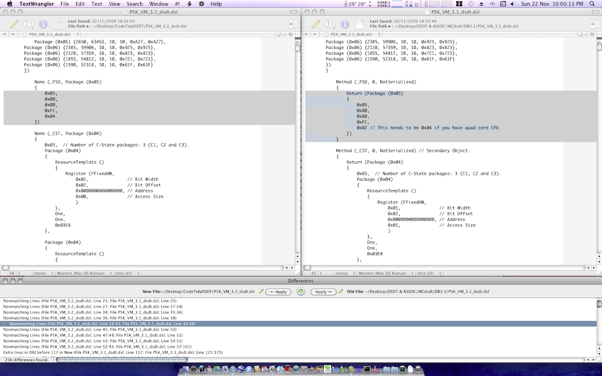

Here's the dsdt: P5K_VM_3.2_dsdt.dsl.zip
OSXRestart.kext is needed in place of OpenHaltRestart or similar kexts to give full restart capabilities.
As the previous dsdt update PSS section needs your own CPU stepping info, JMB0 can be removed if not using ATA devices and you need to make sure:
OperationRegion (BIOS, SystemMemory, 0x7FF8E064, 0x2D) // This code needs to match the one from your original dsdt extract.
is correct.
The changes give a slight faster boot, and very fast shutdown, some unneeded code removed and now restart works as it should.
Have Fun.
PLEASE - Do not ask me to modify your dsdt for you, learn to do for yourself. All the info needed is in past posts of this thread and others.
For those unaware TextWrangler application is great for updating from one text file to another, it highlights the differences and gives the option to update section by section. Just open both files from TextWrangler and then search>Compare Two Front Documents. See example below of difference between v3.1 & 3.2 first different section.

Thx in advance!
Get the v3.1 dsdt I posted #775 (Same cpu as yours) so you get the PSS section and change that section in v3.2.
Change
(Mine in v3.2) to
 OperationRegion (BIOS, SystemMemory, 0xFFFFFF00, 0xFF)
(Yours from your dsl)
Change the GFX0 section for this from your dsl - see slight modification at end:

			Method (_PSD, 0, NotSerialized)
			Return (Package (0x05)
				0x05,
				0x00,
				0x00,
				0xFC,
				0x02 // This needs to be 0x04 if you have quad core CPU
those are the only differences I can see compared with mine

DB1/BlackCH;
- I took dsdt 3.2, adapted to Q6600, fixed operation region, removed JMB0, (as in my post 794, fixed the bracket per BlackCH recommendation post 796)
- Installed OSXRestart, removed Ev0Reboot
- Updated the FakeSMC to version 2.5 (from netkas.org)
Reboot:
- No more Firewire 800 card
- Speedstep is only working on the first two CPUs out of four. The rest are stuck at the lowest speed.
For the second problem, I think I need to edit the equivalent of:
switch, but where is it? Thanks to both of you, really appreciated.
