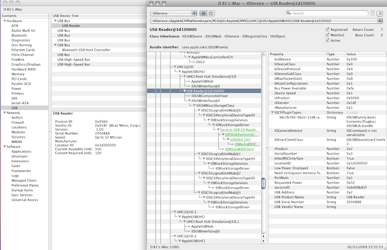

DB1 Posted November 14, 2009 Share Posted November 14, 2009 A temporary solution for auto/schedule sleep:http://www.dragonone.com/products/macosx/pleasesleep/ OSXResatart doesnt work for me either Thanks for this I did download a while ago but did not try it. Is your keyboard bluetooth or wired? If bluetooth which dongle you use & could you post your IOREG so I can compare. D Link to comment https://www.insanelymac.com/forum/topic/62111-how-to-asus-p5k-vm-guide/page/30/#findComment-1330719 Share on other sites More sharing options...
BlackCH Posted November 14, 2009 Share Posted November 14, 2009 Thanks for this I did download a while ago but did not try it. Is your keyboard bluetooth or wired? If bluetooth which dongle you use & could you post your IOREG so I can compare. D All wired here... Link to comment https://www.insanelymac.com/forum/topic/62111-how-to-asus-p5k-vm-guide/page/30/#findComment-1331087 Share on other sites More sharing options...

DB1 Posted November 16, 2009 Share Posted November 16, 2009 I think graphic/PCI cards and how you enable them (in case of the graphics) can also make a difference Agree, same goes for alien devices not normally on a Mac or devices of a different device id than in Mac range. also the jumper settings in the keyboard are only for ps2 keyboard not USB keyboard, Of course I knew this, I suggested the change for compatibility reasons not to get sleep wake functionality from USB devices. The other 3 jumpers are +5VSB, if you change one back to +5V you will get sleep wake issues (I tested) and so thought it wise to change the keyboard one also. I know for sure that the power the USB ports are getting after wake up are not enough, why? because I have a card reader connected to the internal USB port AND ( this "and" is really important ) in Snow Leopard when the computer wakes up the lights told me something is not right, they must be all green, instead I get yellow and RED, that same card reader in Leopard show GREEN only and the Reader works fine, also, the card reader don't work after sleep in Snow Leopard and works fine in Leopard, Have to disagree, the logic does not stack up! If the reader works in Leopard but not in Snow Leopard then it seems obvious it's the differences in the OS's causing the problem as the power to or from USB ports has not changed. Your experiencing similar to BlackCH and I, no wake of device/s after sleep (ours would not go to sleep because the hardware configuration), in your case it could be that the OS does not have wake capability for this type of device. You may need to identify the device in dsdt and find additional code to enable it to wake. Beyond me but may be an interesting challenge for MasterChief. My wake from keyboard or mouse are almost certain to be bluetooth dongle incompatibility issues (even though recommended by apple (Belkin DBT - 120 rev B2), how do I know? Well on my Mac Mini of course everything just works. The IOREG shows differences to my Hack for the bluetooth device and also the "Allow Bluetooth Devices to Wake Computer" in preferences for the Mac although greyed out have a tick in the box where on the Hack it does not. Seems like I need a different dongle! Link to comment https://www.insanelymac.com/forum/topic/62111-how-to-asus-p5k-vm-guide/page/30/#findComment-1332715 Share on other sites More sharing options...
