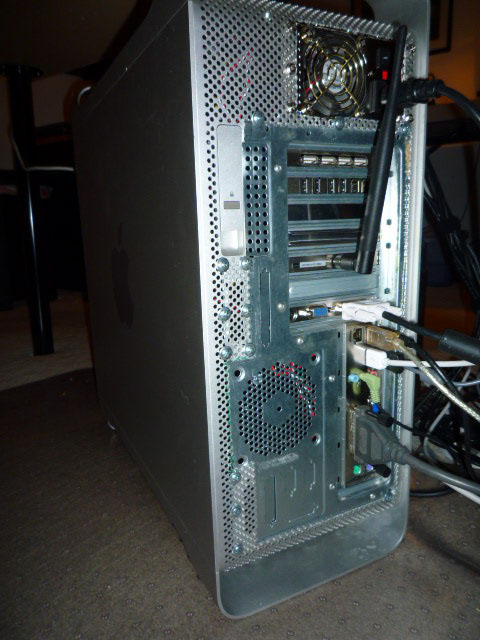

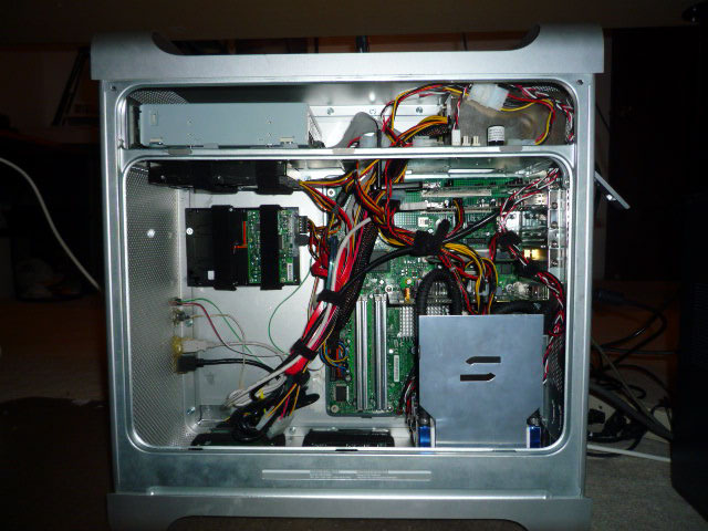

ntsmkfob Posted February 28, 2009 Share Posted February 28, 2009 I've left the top compartment as original, except dropped the fan voltages to 5V. But the fans are still the noisiest ones in the case, and I can hear the disk chattering quite clearly cos there's no sound insulation for it. The CPU and case fan are pretty quiet ( used one of the case back fans instead of both). I have the ATX PSU inside the G5 PSU case with the original fans, again at 5V. As there is a lot of space inside, I'm thinking of fitting the spare HDD case from my P180 to cut down the drive noise and to let me disconnect one or both fans in the top compartment. The CPU runs from about 31 deg to 50 depending on load, so the interior can stand a bit more heat. I cut the back to take an ATX tray cut down to 4 slots, and used a mATX motherboard (P5E-VM HDMI). I've got a GA-EP35-DS4 mobo that I could use instead. Perhaps the next case that comes along ... Link to comment https://www.insanelymac.com/forum/topic/4525-discussion-fit-a-pc-in-a-g5-powermac-enclosure/page/30/#findComment-1094014 Share on other sites More sharing options...
