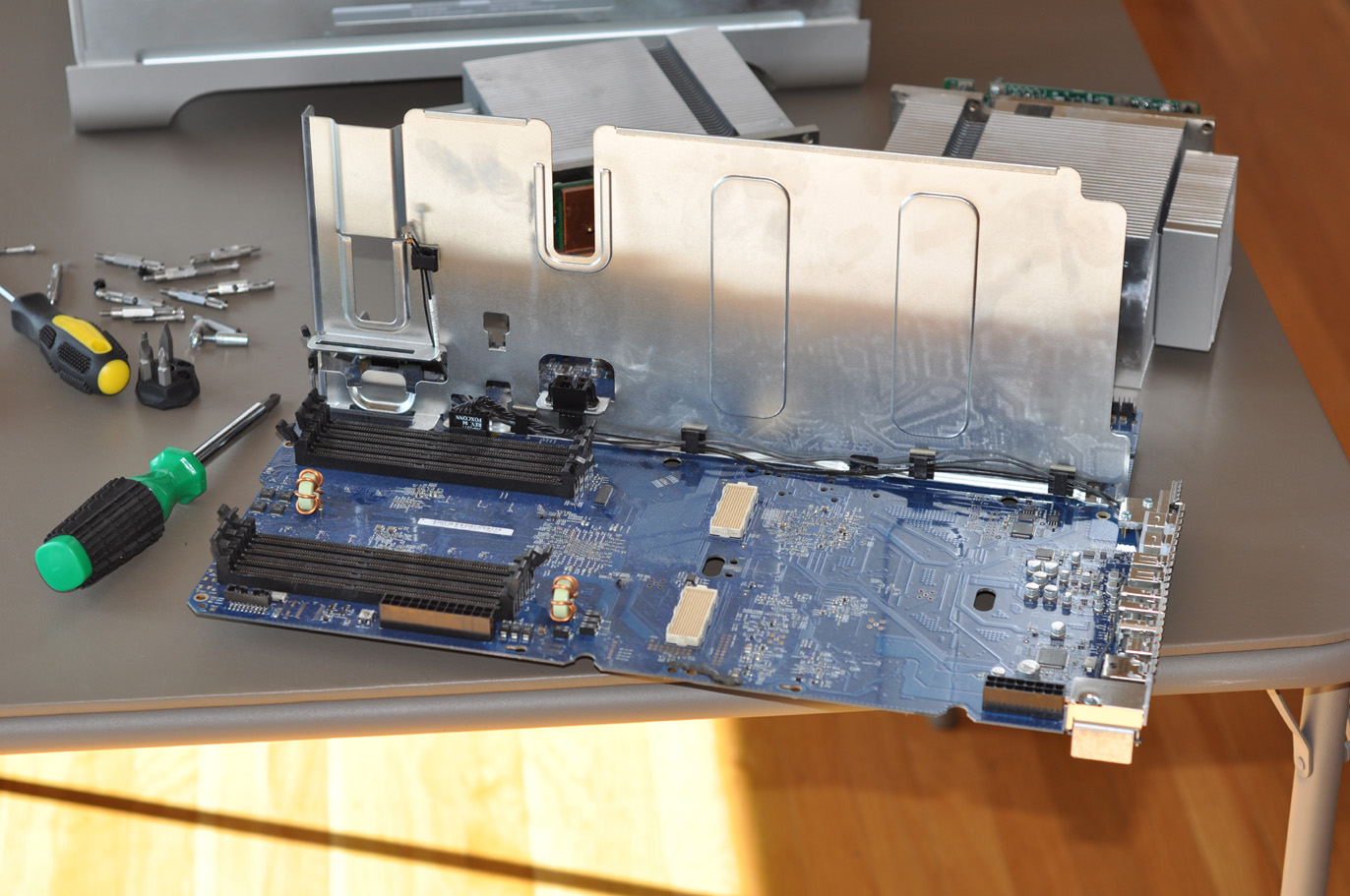

Baudouin Posted March 5, 2009 Share Posted March 5, 2009 Baudouin do you still have those logic board for sale? Anybody else got hold of some? Here are some pix smooth connectors views : Mobo upper side Mobo down side Link to comment https://www.insanelymac.com/forum/topic/4525-discussion-fit-a-pc-in-a-g5-powermac-enclosure/page/31/#findComment-1098956 Share on other sites More sharing options...

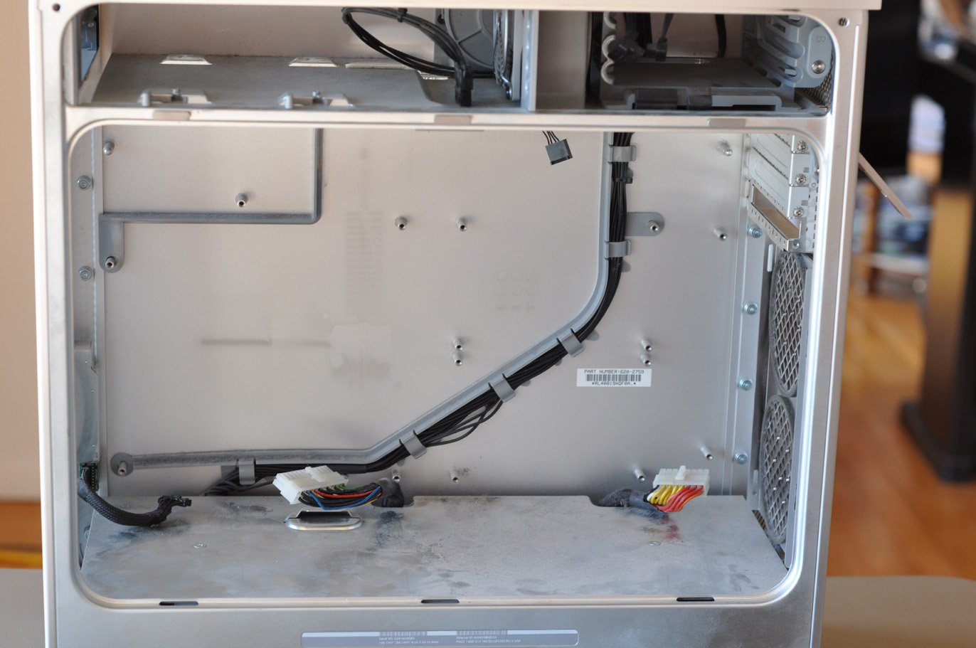

ѕӎѳѳ₮ңӌ Posted March 6, 2009 Share Posted March 6, 2009 i think that would be easier for what you did... but i am attaching the actual tray... no standoffs on the back.. Link to comment https://www.insanelymac.com/forum/topic/4525-discussion-fit-a-pc-in-a-g5-powermac-enclosure/page/31/#findComment-1099862 Share on other sites More sharing options...

DiaboliK Posted March 7, 2009 Share Posted March 7, 2009 i think that would be easier for what you did... but i am attaching the actual tray... no standoffs on the back.. as i'm using a server board a tray would'nt have worked well in my favor, plus all mods with trays look like crapola to me. -D- Link to comment https://www.insanelymac.com/forum/topic/4525-discussion-fit-a-pc-in-a-g5-powermac-enclosure/page/31/#findComment-1101203 Share on other sites More sharing options...
