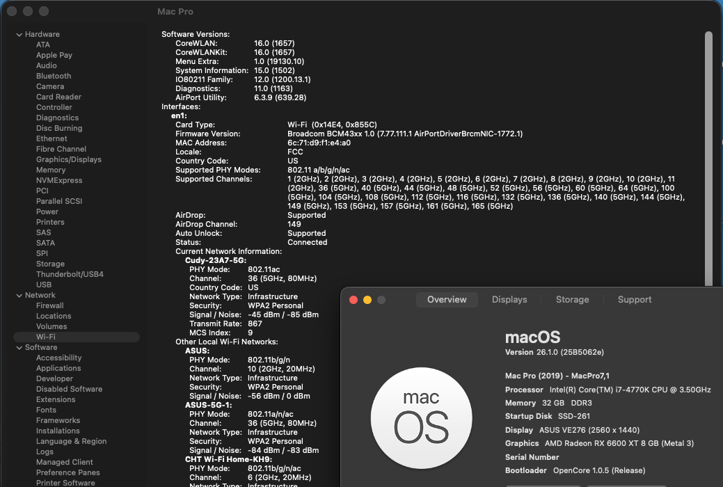

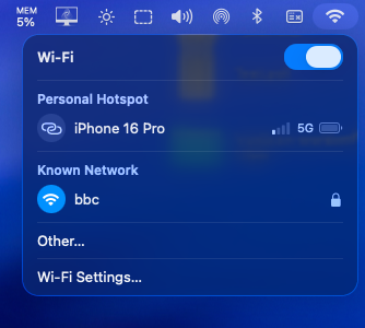

The respective patchsets currently restore the following functionality on supported Hackintosh configurations:

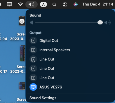

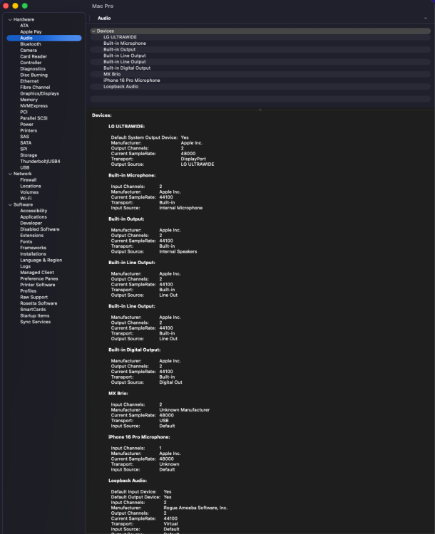

a.) modern audio (AppleHDA) -- functional
b.) modern Wi-Fi -- functional

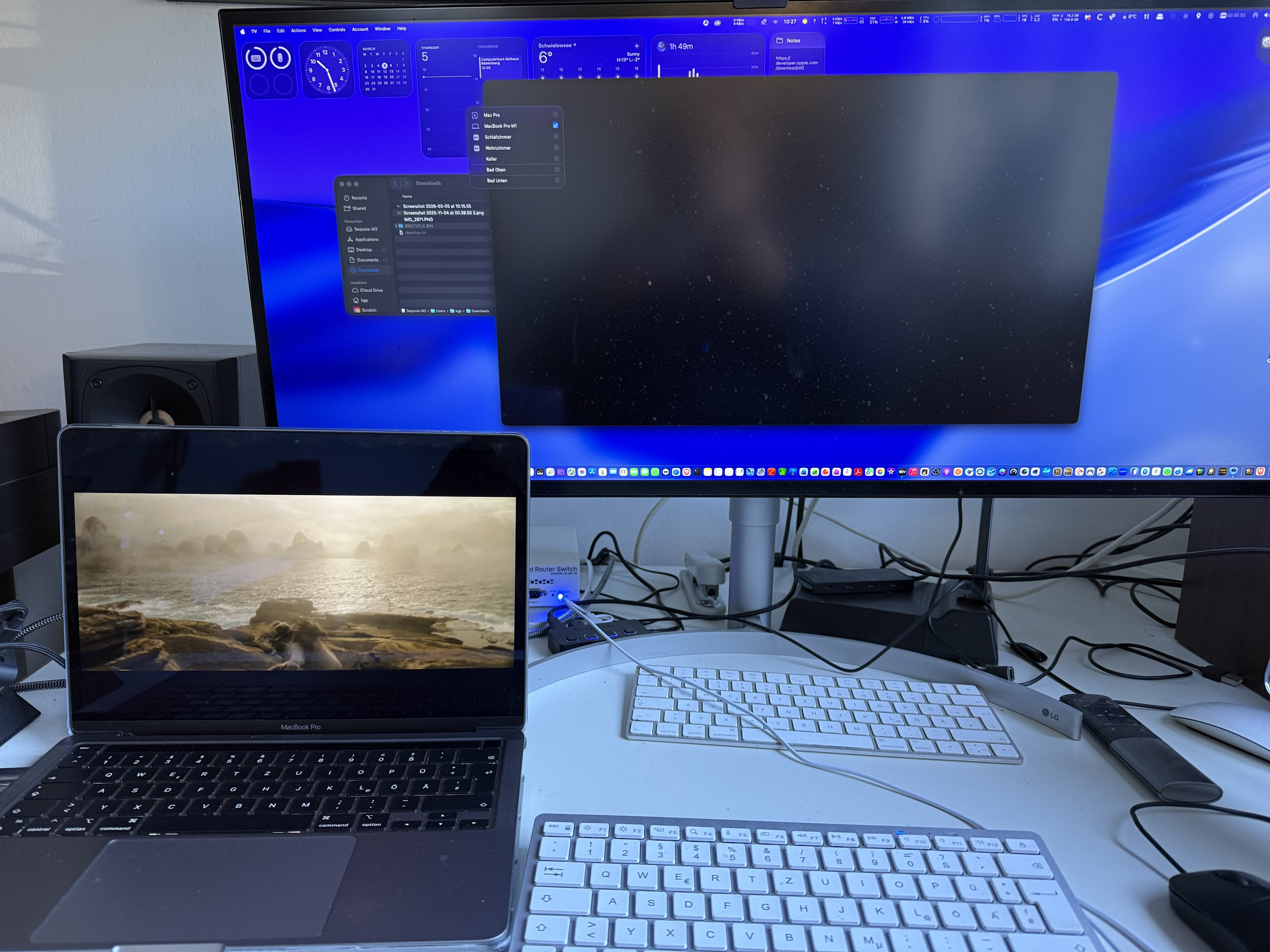

c.) AWDL stack:

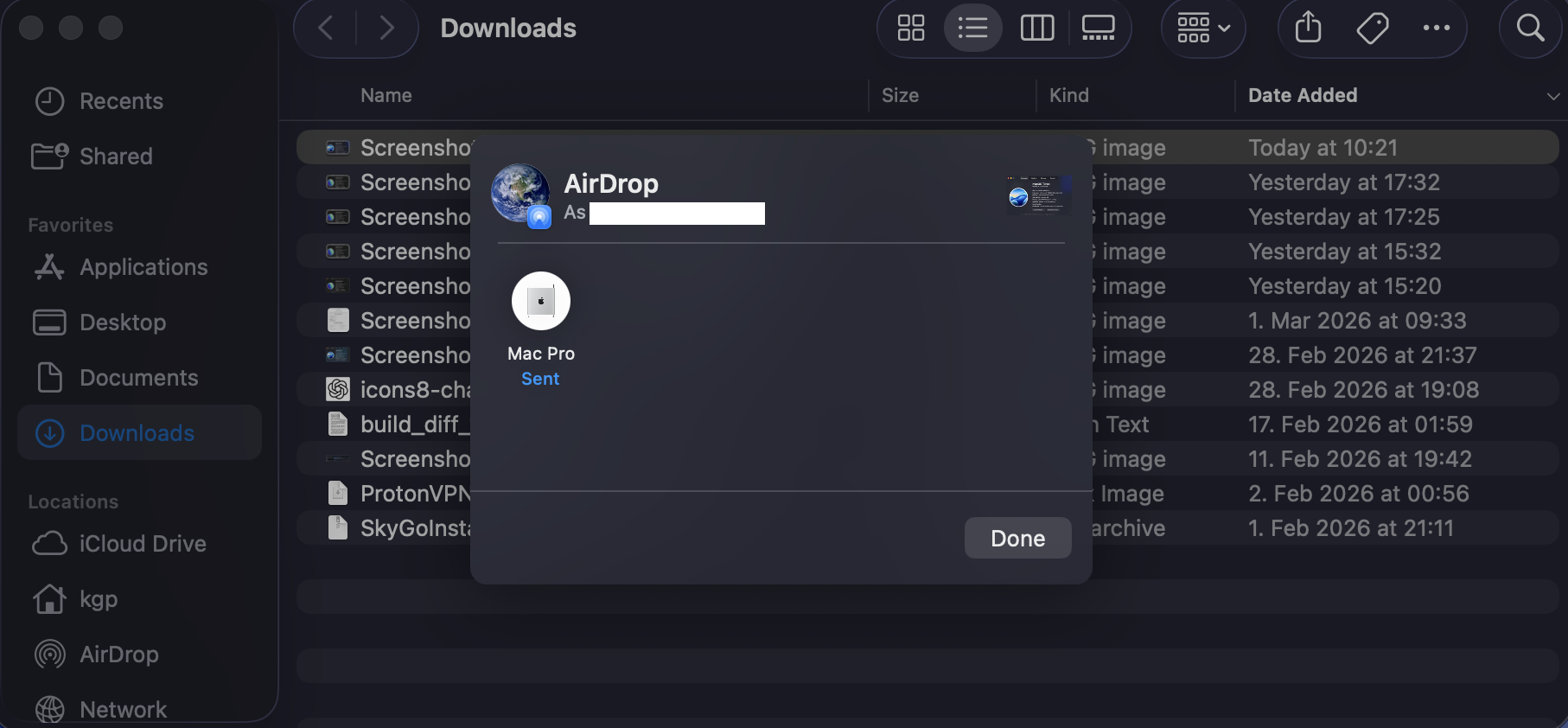

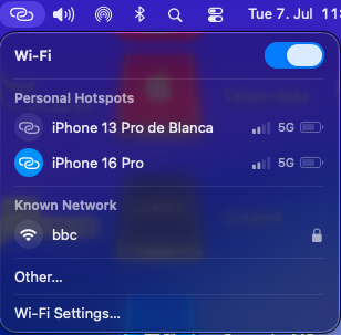

- AirDrop -- fully functional, bidirectional

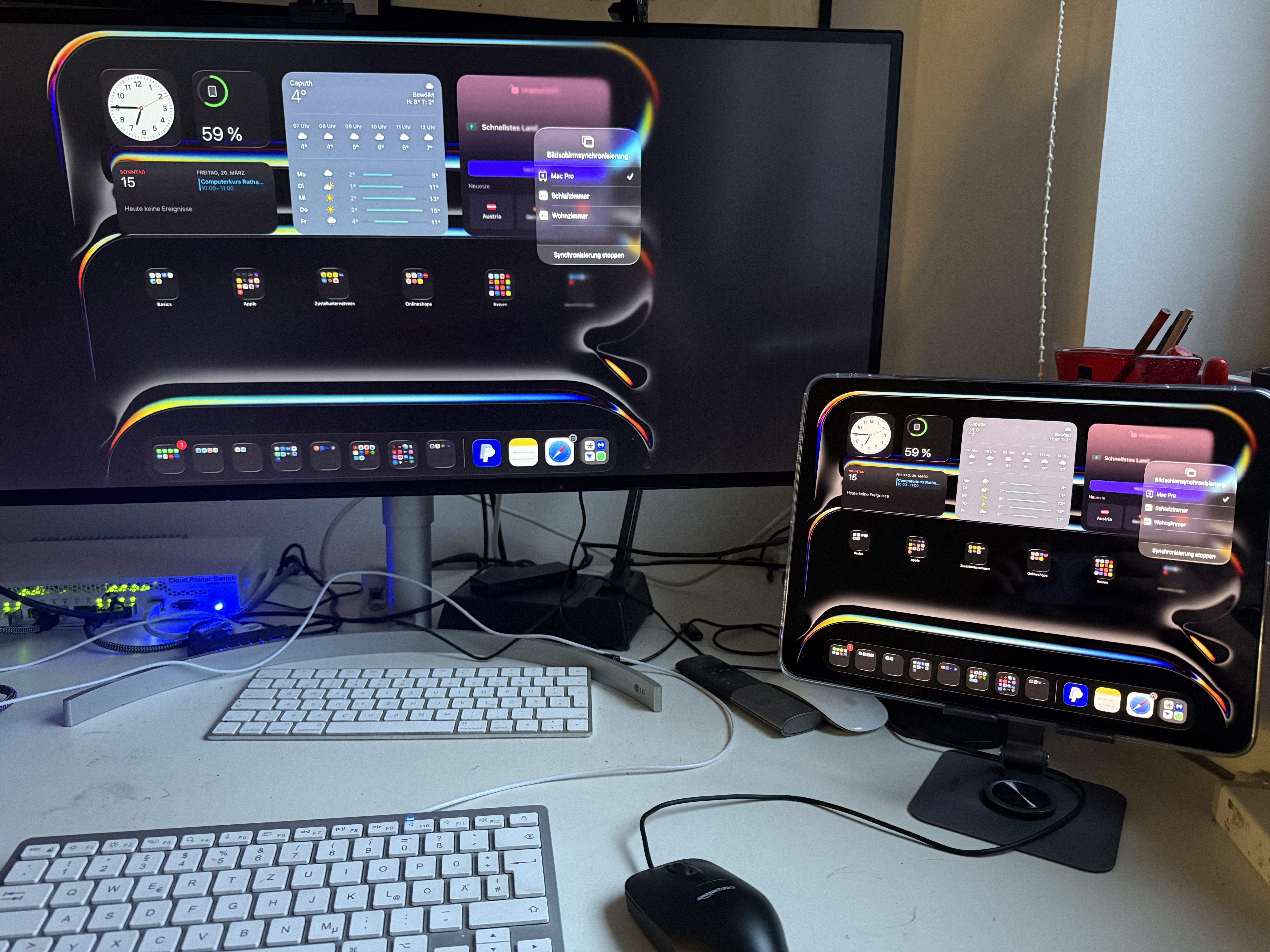

- AirPlay -- functional, bidirectional
- Screen Mirroring -- functional, bidirectional

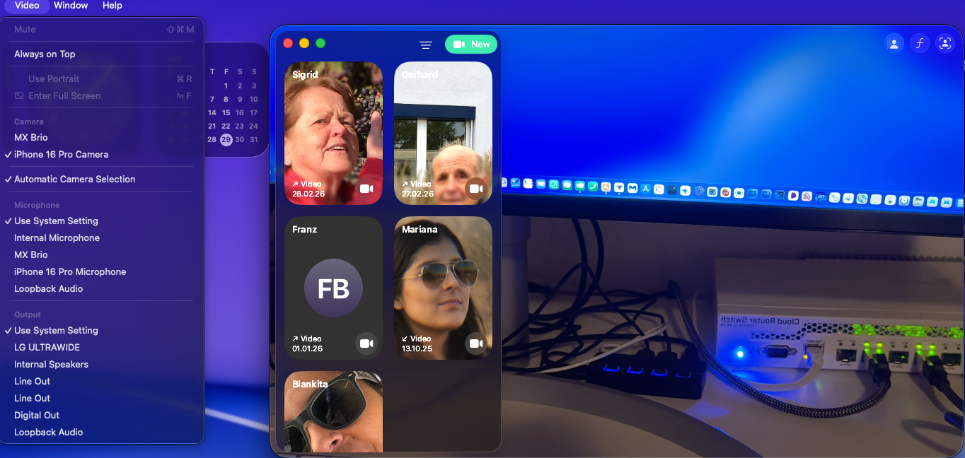

- Continuity Camera -- functional
- Personal Hotspot -- functional
d.) Continuity:
- Handoff -- functional (e.g. Mail, Notes, Safari)
e.) Sidecar -- currently not functional

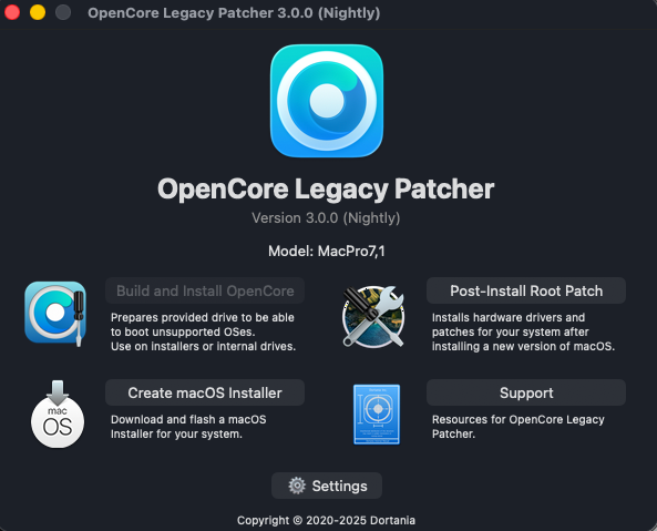

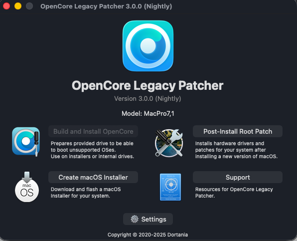

9.6.) OpenCore-Patcher Installation
9.7.) Root Patching

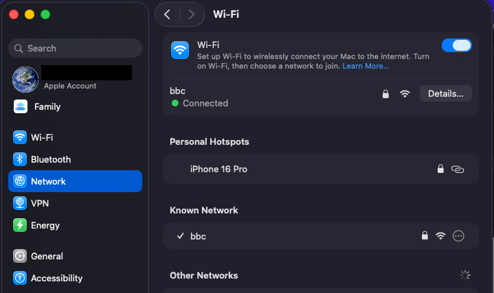

10.1.) Wi-Fi

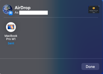

10.2) AirDrop

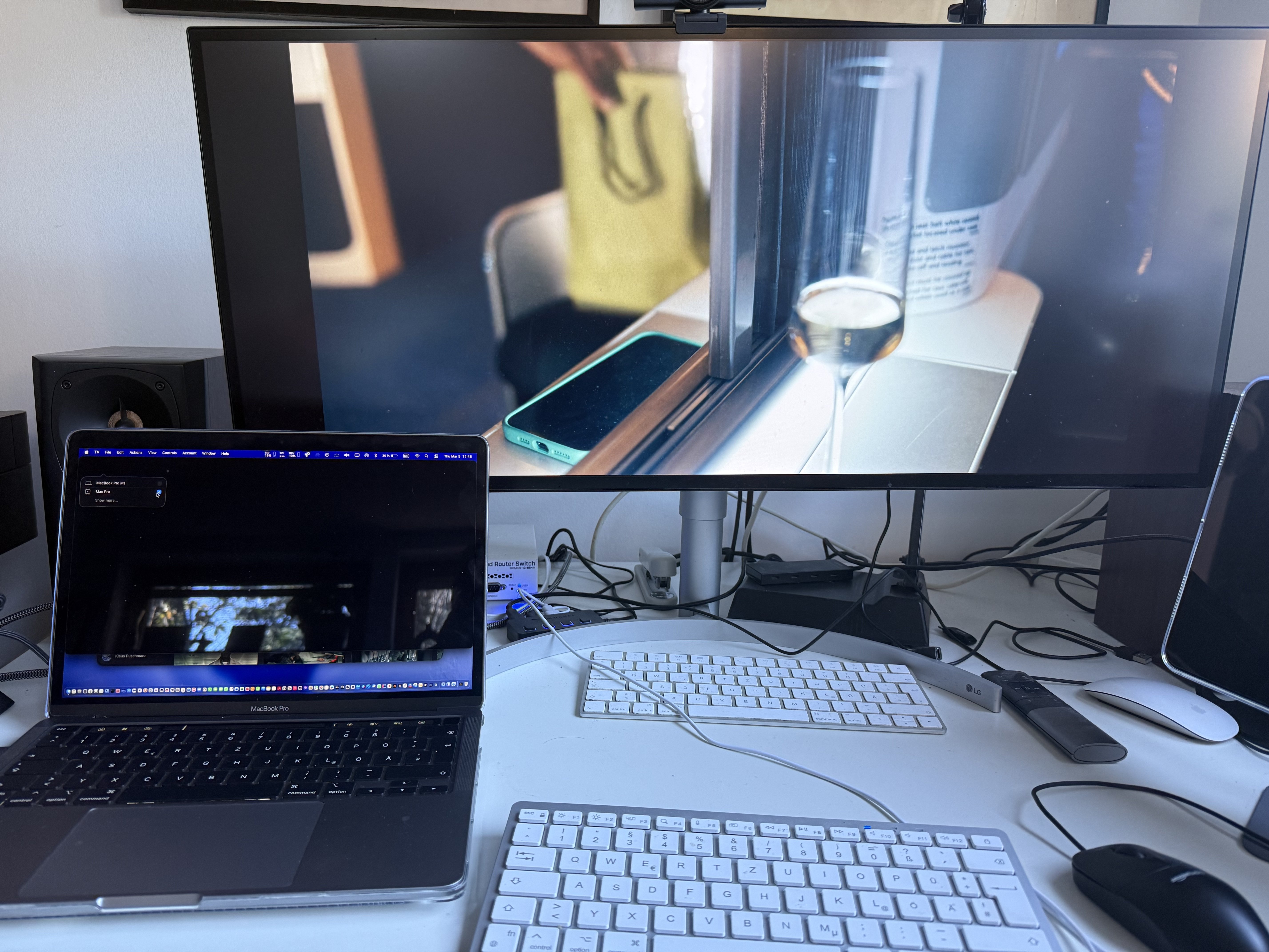

10.4) Screen Mirroring

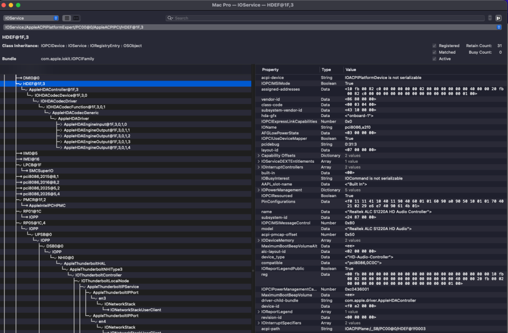

10.5) AppleHDA

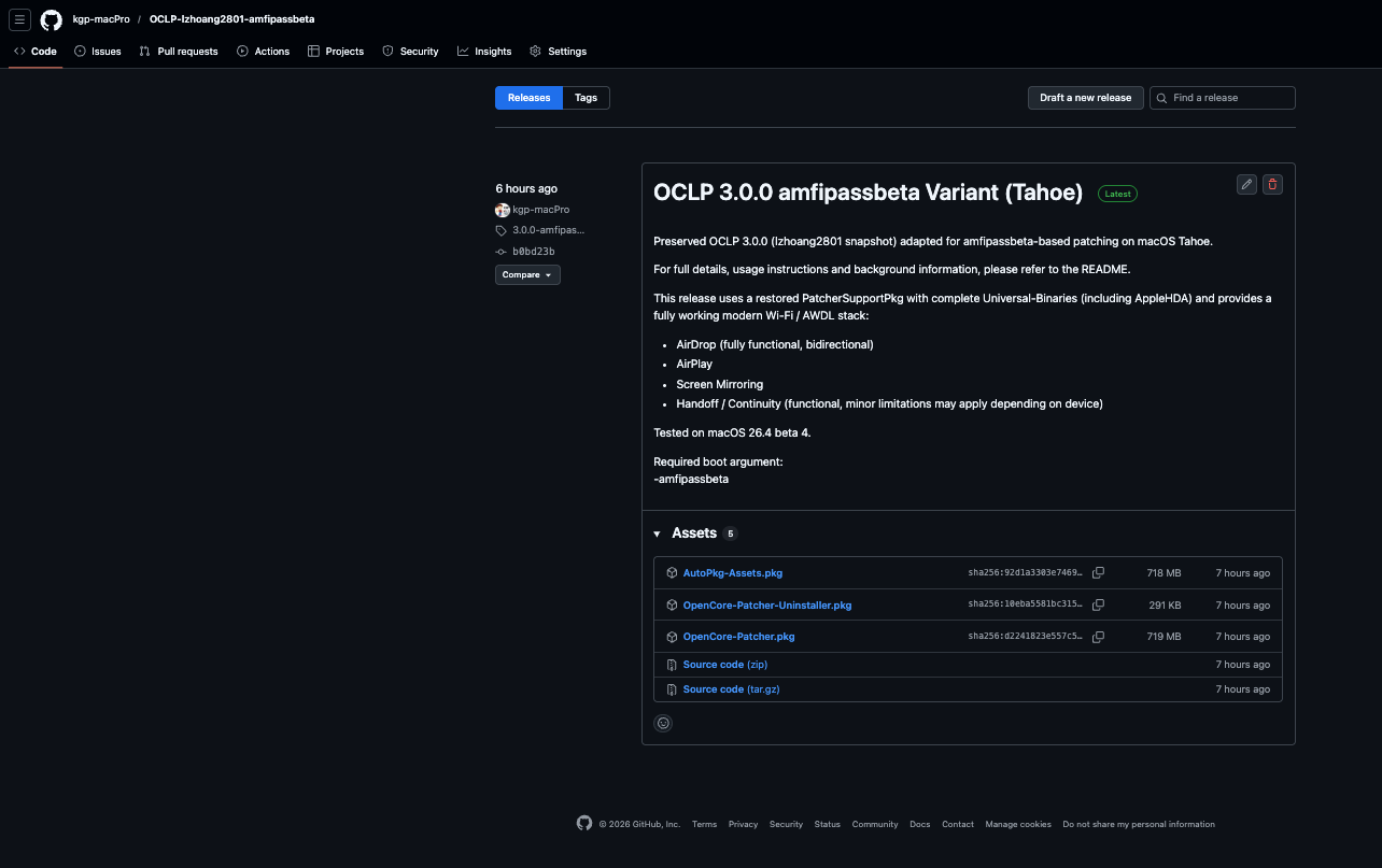

a.) OCLP 3.0.0 Nightly – amfipassbeta Edition
Recommended modern Tahoe setup maintained by kgp
Link: https://github.com/kgp-macPro/OCLP-lzhoang2801-amfipassbeta
Configuration:
- AMFIPass.kext
- boot-arg: -amfipassbeta
Advantages:
- no need for amfi=0x80
- no application launch issues
- clean and stable baseline
- fully working AppleHDA, Wi-Fi and AWDL

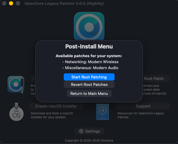

9.) Prerequisites  and Setup:
9.1.) Prerequisites
a.) For OCLP 3.0.0 Nightly (amfipassbeta Edition), OCLP-Mod 3.1.9 and OCLP-Plus 3.1.9 enable AMFIPass.kext and use boot argument "-amfipassbeta".
     For OCLP 3.0.0 Nightly (Preserved Reference Edition) enable or disable AMFIPass.kext but always use boot arguments "amfi=0x80" and "ipc_control_port_options=0 "
b.) Securebootmodel = disabled
c.) csr-active-config = 03080000
d.) AppleVTD disabled, i.e. DisableIOMapper=true

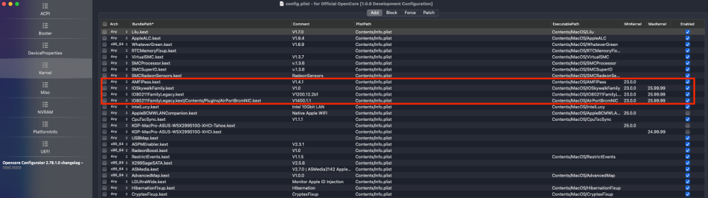

e.) Same com.apple.iokit.IOSkywalkFamily replacement like under Sequoia

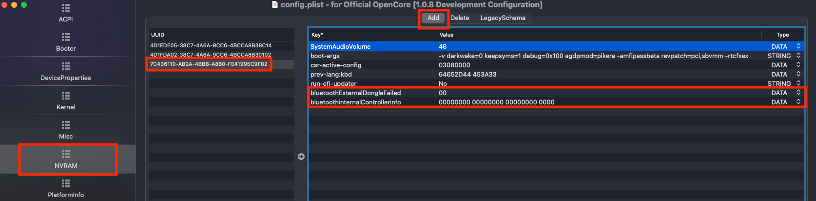

f.) Ensure the following NVRAM entries are present under:
NVRAM → Add → 7C436110-AB2A-4BBB-A880-FE41995C9F82
  • bluetoothExternalDongleFailed = 00
  • bluetoothInternalControllerInfo = 00000000 00000000 00000000 0000
All settings above [a.) to f.)] can also be gathered from my EFI-Folder distribution.

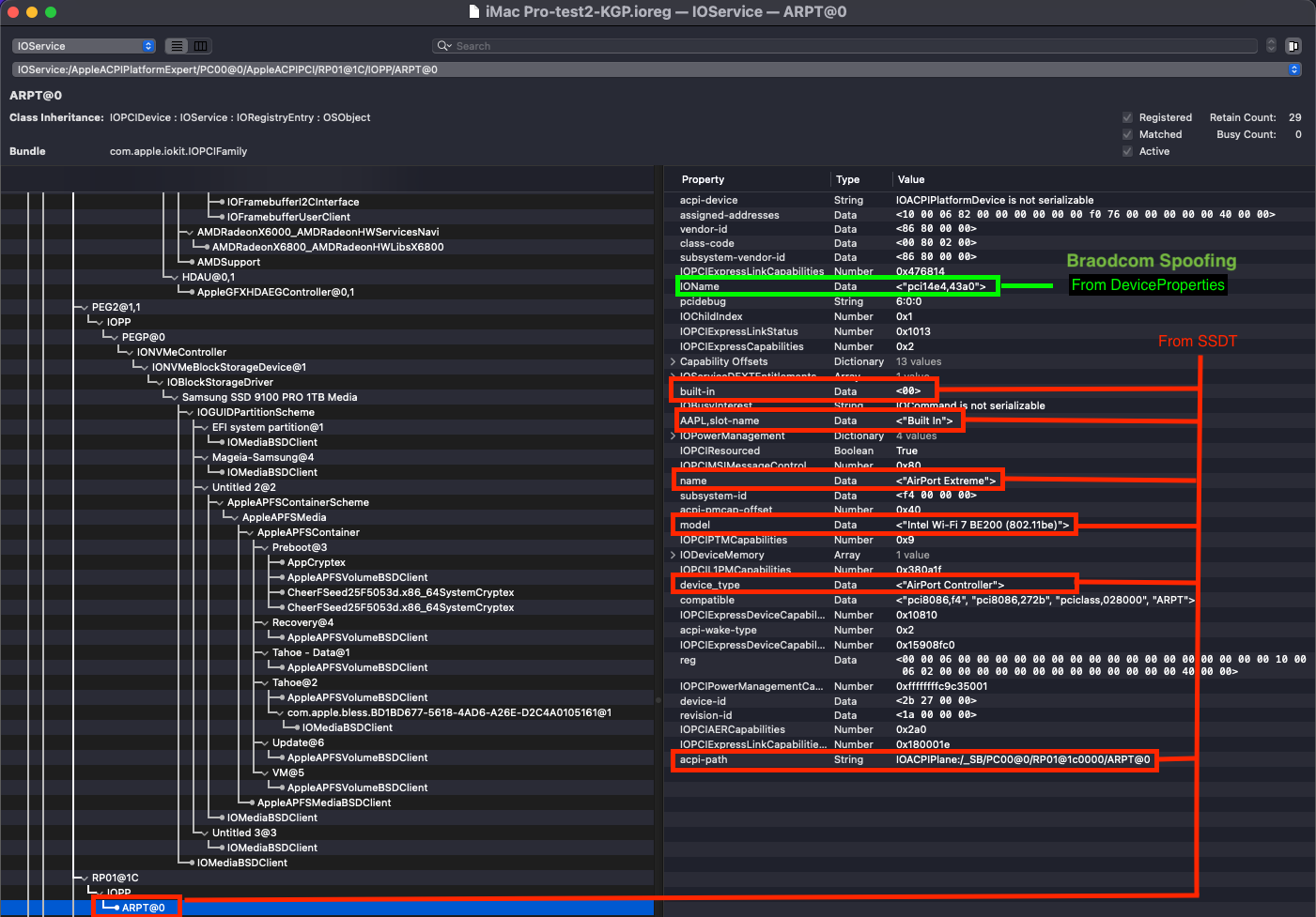

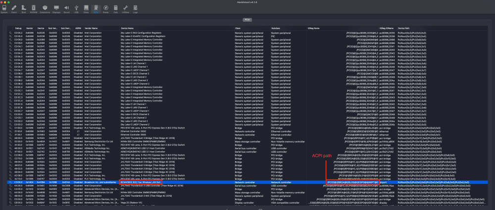

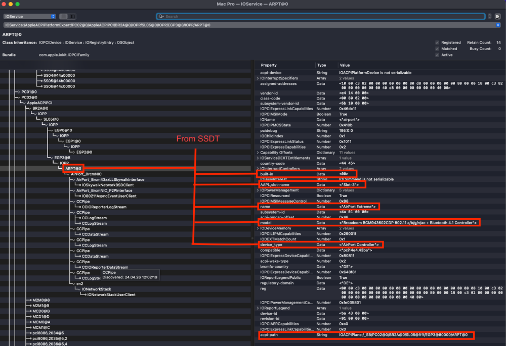

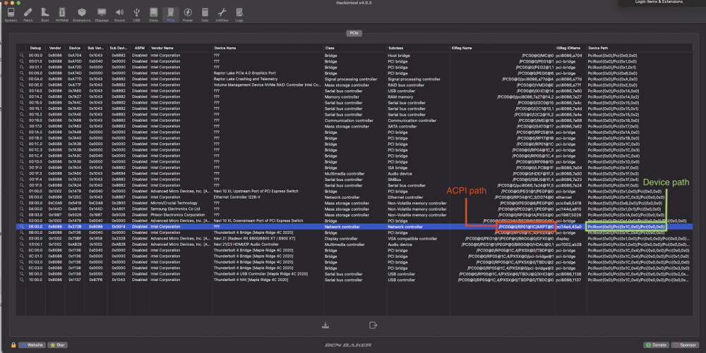

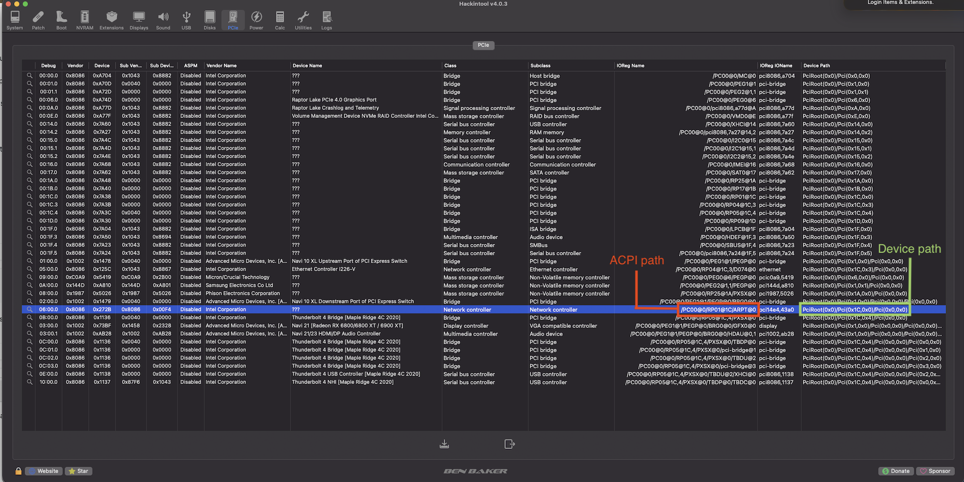

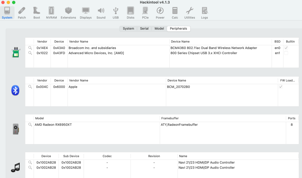

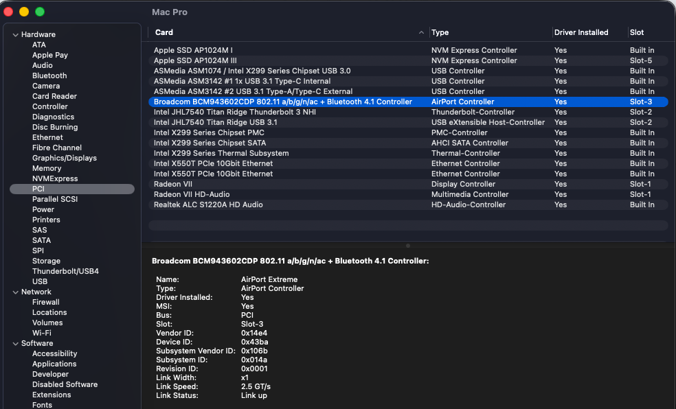

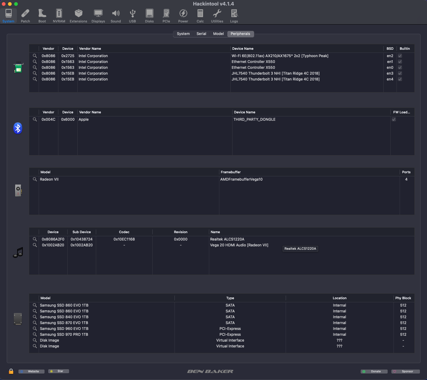

9.3.) Broadcom Wi-Fi Configuration

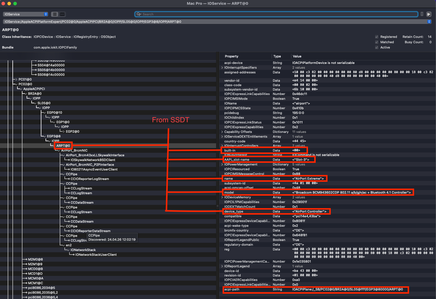

For Broadcom-WiFi to be working with OCLP, EFI-KGP-public-v.1.1.5-OCLP-Broadcom further implements:
- SSDT-DTPG.aml @kgp

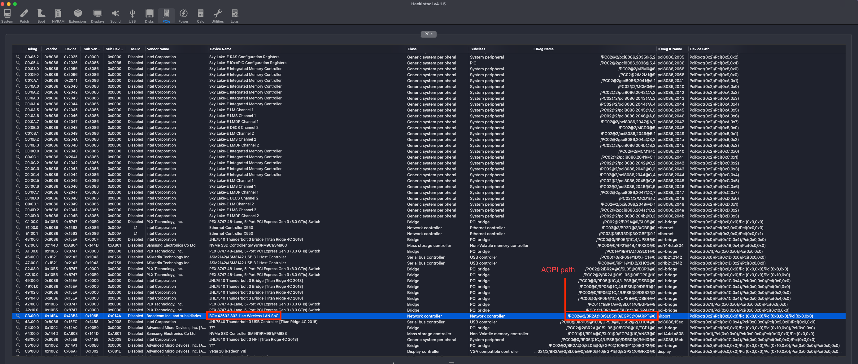

- SSDT-X299-Slot1-Slot3-PC02-BR2A-SL05-RadeonVII-HDAU-ARPT.aml @kgp (adopt your ACPI path based on the information provided by Hackintool -> PCI and remove everything GPU/HDAU related).
Hackintool -> PCI:
IOREG:

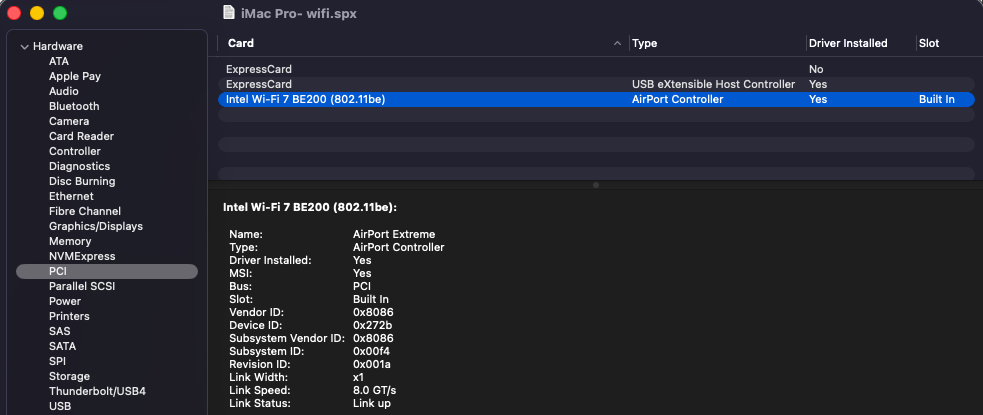

System Information -> PCI:

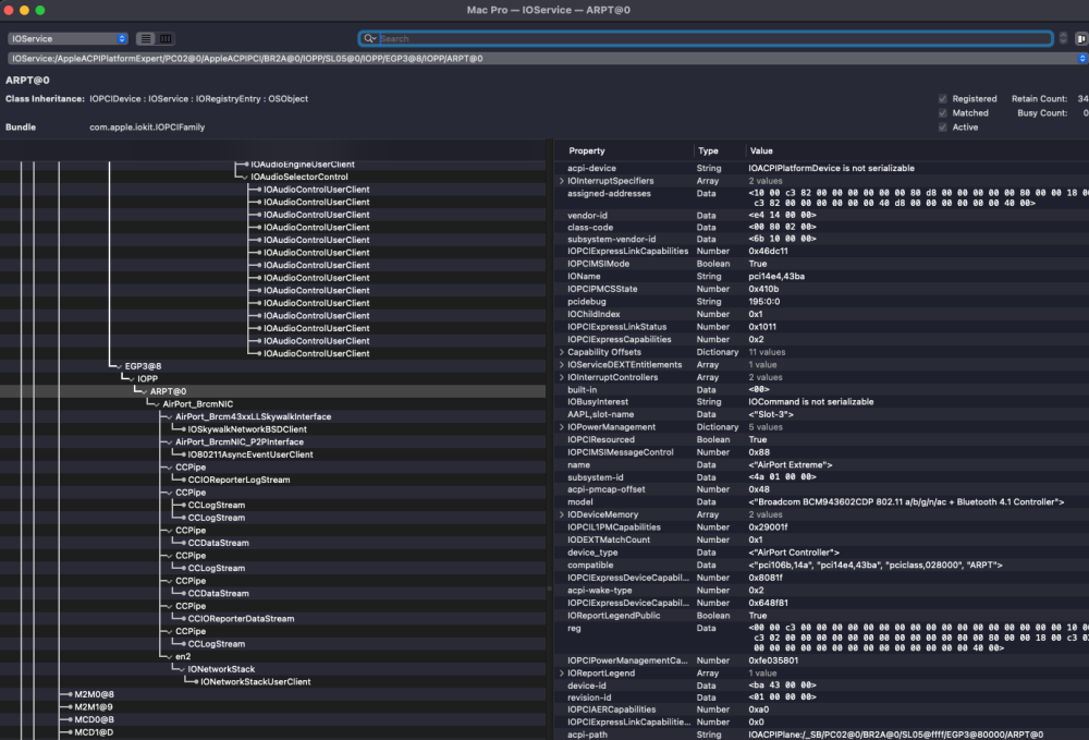

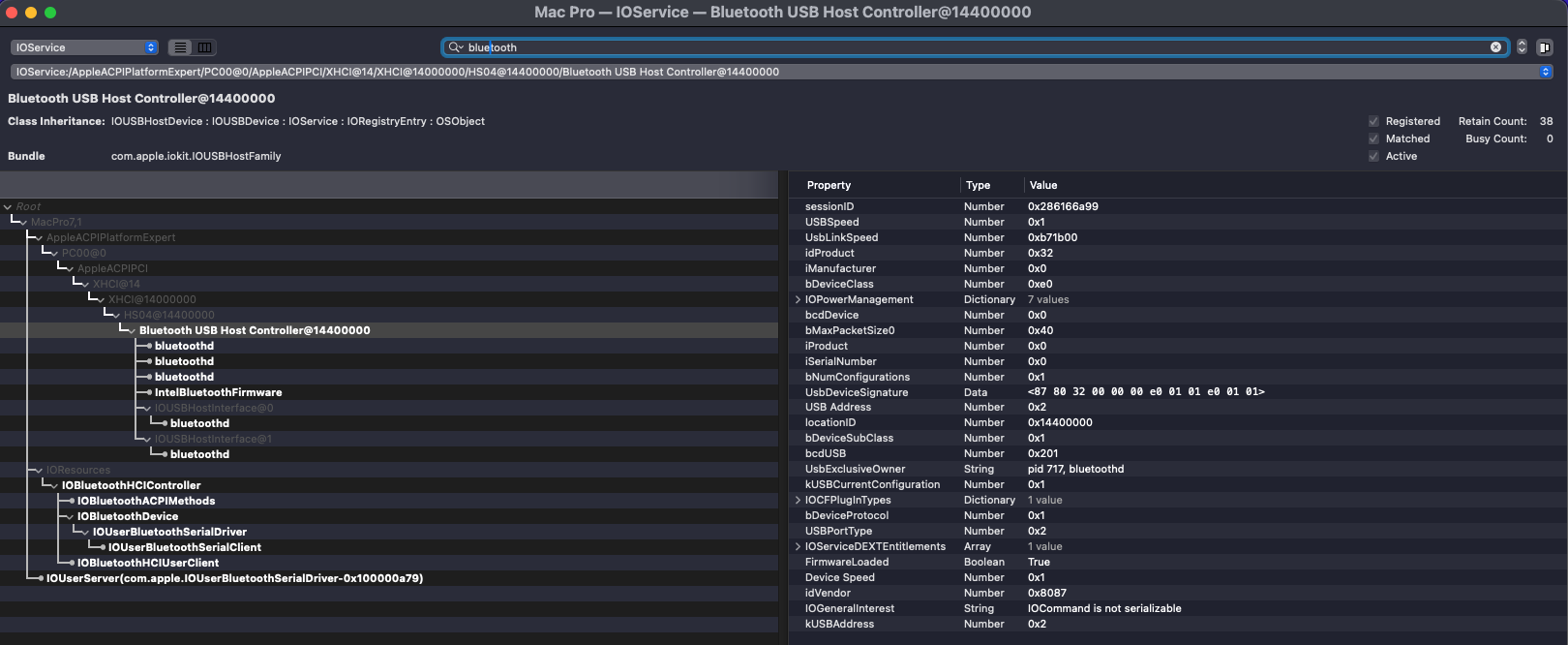

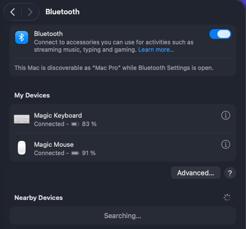

9.4.) Intel Wi-Fi and Bluetooth Configuration

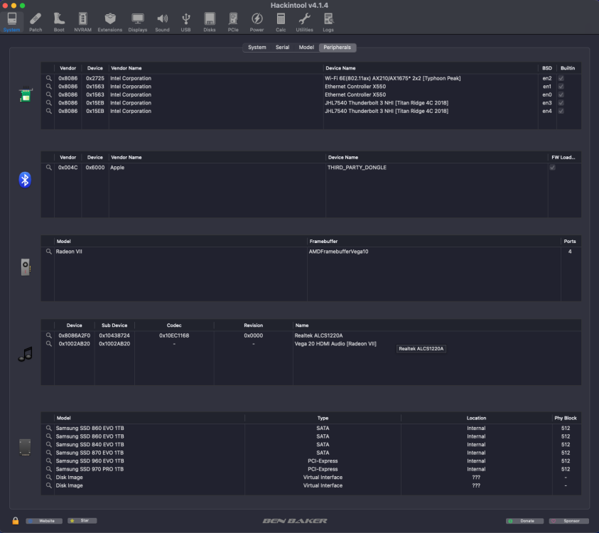

For Intel-WiFi to be working with OCLP, EFI-KGP-public-v.1.1.5-OCLP-Intel further implements:
AirportItlwm.kext v2.3.0 (Ventura) @openintelwireless
- Spoofing of IOName to pci14e4,43a0 under DeviceProperties (adopt your device path based on the information provided by Hackintool -> PCI)
- BlueToolFixup.kext v2.7.2 @acidanthera
- IntelBluetoothFirmware.kext v2.5.0-d2 @lshbluesky
- IntelBTPatcher.kext v2.5.0-d2 @lshbluesky
- SSDT-X299-Slot5-PC01-BR1A-SL01-ANS3-ARPT.aml @kgp (adopt your ACPI path based on the information provided by Hackintool -> PCI and remove everything NVMe related).
Important Note:
a.) For macOS Tahoe 26.5 and later, use IntelBluetoothFirmware v2.5.1 by lshbluesky (includes an updated IntelBluetoothFirmware.kext and IntelBTPatcher.kext with the Bluetooth LE fixes for macOS Tahoe 26.5 developed by Z3c0ld and Vinhts).
Download: https://github.com/lshbluesky/IntelBluetoothFirmware/releases/tag/v2.5.1
b.) For Intel BE200 use AirportItlwm 2.3.0 (Ventura) from https://github.com/OpenIntelWireless/itlwm/issues/955 or just download Ventura.zip.
Hackintool -> PCI:
IOREG:

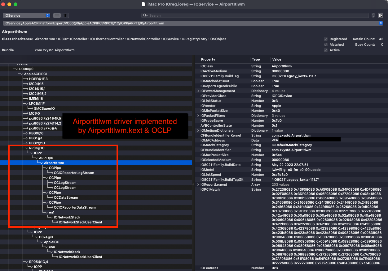

AirportItlwm driver stack implemented by AirportItlwm.kext & OCLP:

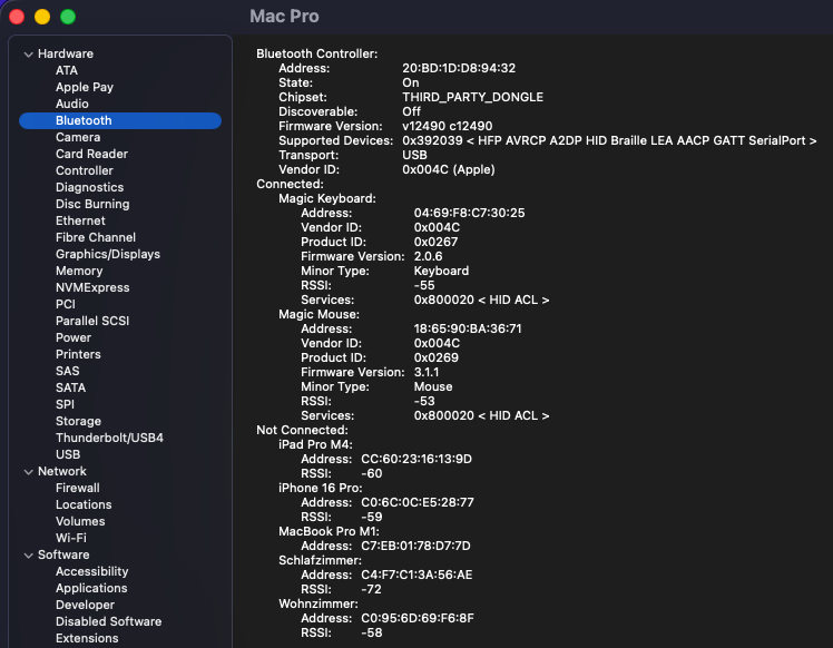

Intel Bluetooth -> System Settings:
Intel Bluetooth -> System Info
Intel Bluetooth -> Hackintool:
Intel Bluetooth -> IOReg:

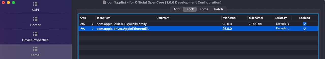

9.5.) Important Compatibility Notes

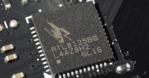

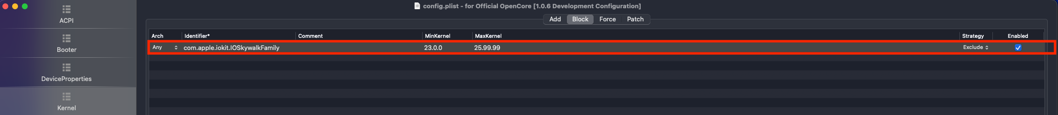

a.) RTL8125 wired network cards
If you have an RTL8125 wired network card, you must go to Kernel -> Block and block com.apple.driver.AppleEthernetRL so that IOSkywalkFamily is loaded (set it to Exclude). Otherwise, the system will crash during boot.
Credits to @laobamac_yyds for this finding.

If Wi-Fi fails to work properly, networking behaves inconsistently, or your system fails to boot, replace:
IntelMausi.kext v1.0.8
with:
IntelMausiEthernet.kext v3.0.0
This solved the issue immediately on multiple tested systems.
c.) Intel I225-V, Intel I225-LM, Intel I226-V, Intel I226-LM Ethernet controllers with AppleIGC.kext
Use: https://github.com/SongXiaoXi/AppleIGC.
a.) Download OpenCore-Patcher.pkg and OpenCore-Patcher-Uninstaller.pkg from Github:
https://github.com/kgp-macPro/OCLP-lzhoang2801-amfipassbeta/releases

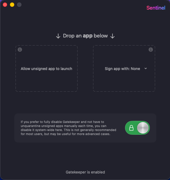

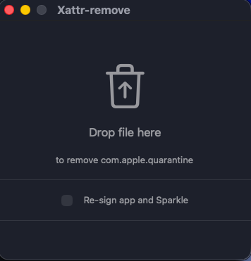

b.) Disable Gatekeeper:
xattr -cr ./OpenCore-Patcher-Uninstaller.pkg
xattr -cr ./OpenCore-Patcher.pkg
or use drag and drop with Sentinel:
You can use also use Xattr-remove:
c.) Install OpenCore-Patcher

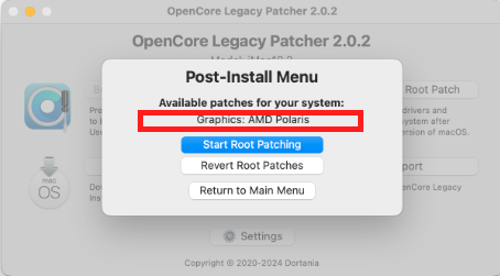

9.7.) Root Patching
Run "Post-Install Root Patch" -> "Start Root Patching"
and you are done! :thumbsup_anim:

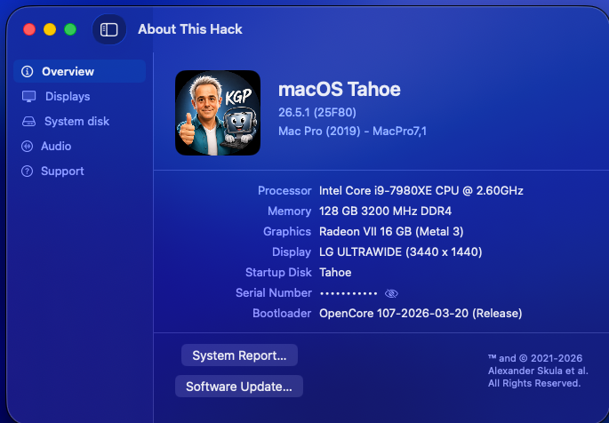

10.) Verified Functional Results

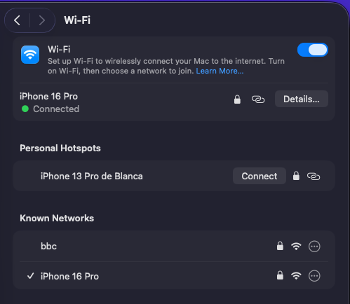

a.) Broadcom: Bluetooth, Wi-Fi, Apple Wireless Direct Link (AWDL - Airdrop, Airplay, Screen Mirroring, Continuity Camera, Personal Hotspot) and Continuity (Handoff) successfully tested with BCM943602CDP, but should also work with BCM943602CS, BCM94360CD, BCM94360CS, etc.)
b.) Intel: Bluetooth, Wi-Fi, Airplay, Screen Mirroring and Handoff successfully  tested with AX211, AX210, AX201 CNVW, 3165, 7260, but should also work with other Intel Wi-Fi chipsets.
Important (macOS Tahoe 26.5 and later):
Recent re-testing with Intel AX210 (Wi-Fi 6 / Bluetooth 5.3) and Intel BE200 (Wi-Fi 7 / Bluetooth 5.4) using the latest IntelBluetoothFirmware package provided by Vinhts indicates that Intel Bluetooth is now functioning correctly again under macOS Tahoe 26.5 and later.
Bluetooth controller detection, device pairing and connections (including Magic Keyboard and Magic Mouse) have been successfully verified on both chipsets.
However, Apple Wireless Direct Link (AWDL) remains unavailable on both AX210 and BE200. The awdl0 interface is currently not being created, preventing AWDL-dependent services such as AirDrop, Personal Hotspot and Continuity Camera from functioning correctly.
Recent testing also revealed significant behavioural differences between AX210 and BE200:
- AX210 currently provides stable Bluetooth and Wi-Fi connectivity. AirPlay, Screen Mirroring and Handoff are working correctly; however, AirDrop, Personal Hotspot and Continuity Camera are currently unavailable.
- BE200 is detected correctly and Bluetooth works reliably, but Wi-Fi functionality remains incomplete and is still under investigation.
Detailed troubleshooting results, screenshots and logs can be found in the dedicated AX210 and BE200 test reports.
Related ongoing investigations:
Additional test results, logs and feedback from Intel Wi-Fi users are highly appreciated.

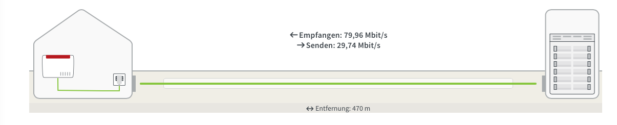

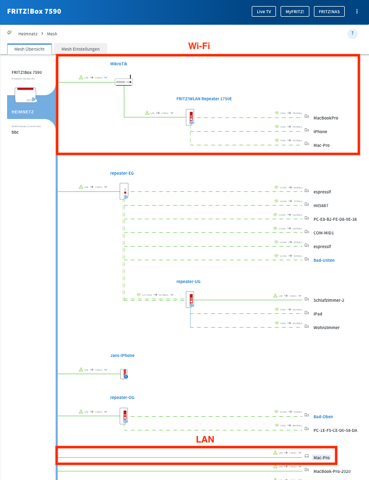

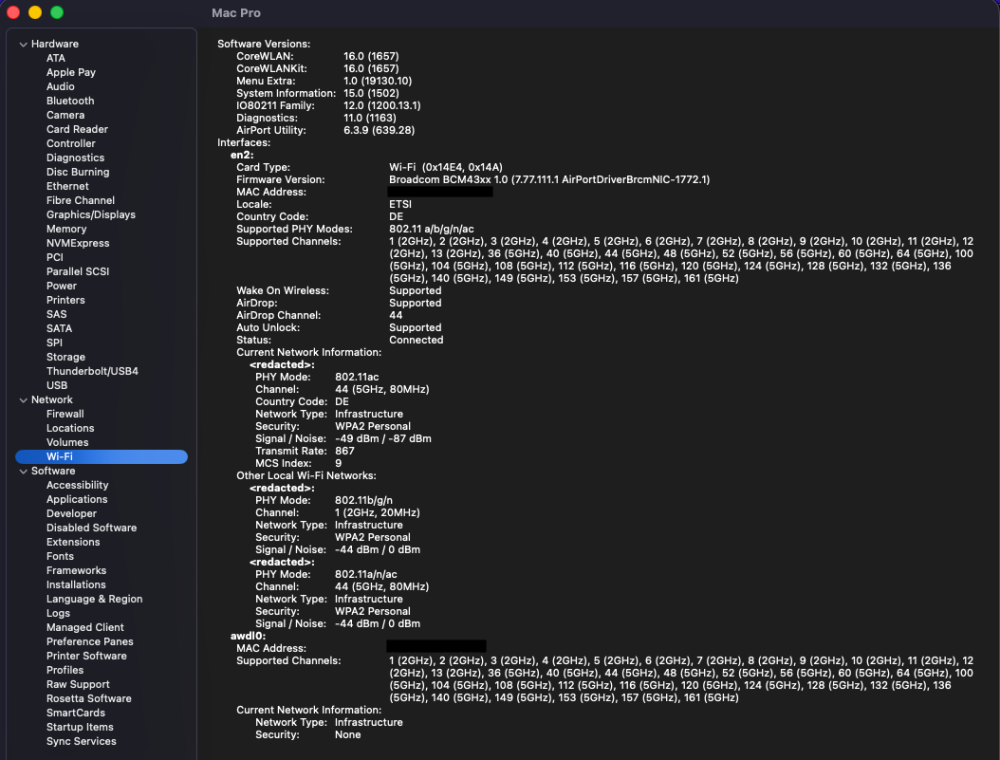

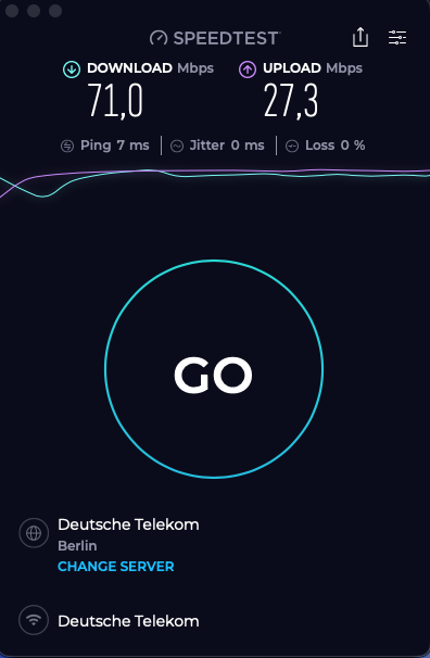

10.1.) Wi-Fi:

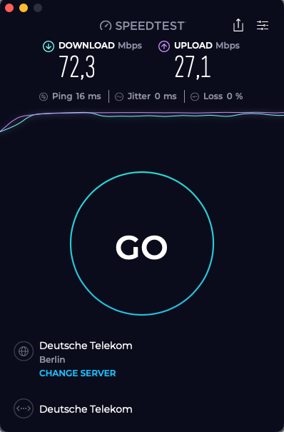

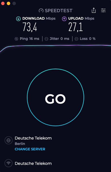

Hackintosh Real-world Network Performance (80 Mbps DSL)
LAN (IntelLucy/X550-AT2):
Wi-Fi (OCLP/BCM943602CDP):
The results show virtually identical real-world internet performance over Ethernet and 5 GHz mesh Wi-Fi on the same Hackintosh.
AX210 Wi-Fi performance under Tahoe is virtually indistinguishable from my BCM943602CDP:
10.2.) Airdrop:
10.3.) Airplay:

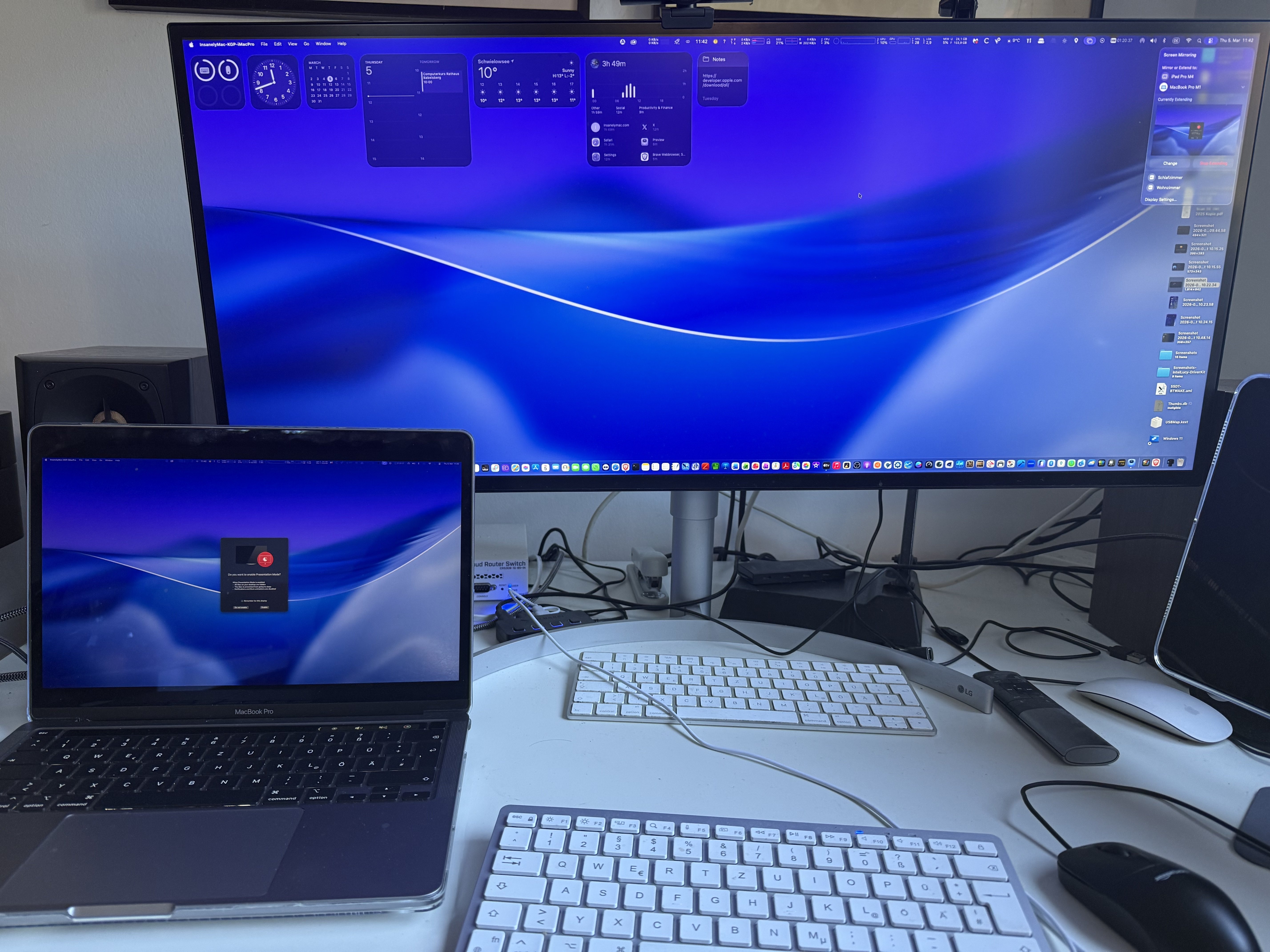

10.4.) Screen Mirroring:
10.5.) AppleHDA:
10.6.) Continuity Camera:

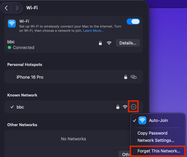

11.3.) Wi-Fi connects as hidden network
If your Wi-Fi network suddenly appears as a hidden network:
- Go to Wi-Fi settings
- Choose “Forget This Network”
- Reconnect normally by entering your Wi-Fi password.
This typically restores normal Wi-Fi behavior.

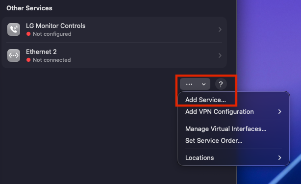

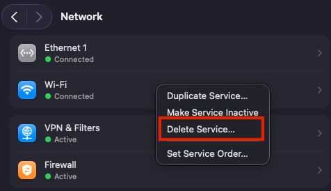

11.4.) Wi-Fi or AirDrop not working at all
If Wi-Fi or AirDrop does not work at all:
- Delete the Wi-Fi service in Network Settings -> right click on Wi-Fi -> Delete Service
- Re-add it (Add Service → Wi-Fi)
This often restores full Wi-Fi or AirDrop functionality.

If the Hackintosh is still not visible to other devices afterwards, apply now point 11.4.):
After doing this, AirDrop should work again for both sending and receiving.

Developer @Mirone implemented a fix in BlueToolFixup.kext v2.7.3 for Bluetooth wake-related issues. The fix is enabled via the boot argument: -btlfxwakecrash
Testing under macOS Tahoe 26.5 and 26.6 indicates that this approach achieves a similar result to the SleepWatcher-based workaround and appears to automatically reinitialize the Bluetooth stack after wake.
Successfully tested so far on:
  • Broadcom BCM4352 (Mirone)
  • Broadcom BCM943602CDP FullMac (kgp)
The fix remains under evaluation and additional user feedback is encouraged. According to Mirone, a future pull request to BrcmPatchRAM may be considered once broader testing has been completed.
Special thanks to @Mirone for implementing and sharing this solution with the community.

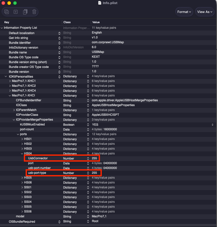

USB configuration (important)
For proper sleep/wake behavior under macOS Tahoe, the internal Bluetooth USB port must be correctly defined in USBMap.kext.
Both properties must be set to:
UsbConnector = 255 (internal)
usb-port-type = 255
and NOT:
UsbConnector = 3 (external)
usb-port-type = 3
Incorrect configuration may cause:
- unwanted wake events
- instant wake after sleep
- sleep being prevented by bluetoothd
- inconsistent Bluetooth / AirDrop (AWDL) behavior
Note:
Under Tahoe, setting only one of the two properties is not sufficient — both must be set to 255 for reliable behavior.

a.) Apparently, the modern WIFI patch works with the Intel 7260 - see this postthis post and this post! Congrats and many thanks to @carlo_67
b.) Also my Intel AX210S is now flawlessly working with the experimental fork of OCLP 3.0.0 Nightly! Special thanks for help by @carlo_67, @FirstCustomac, @schrup21 and @deeveedee! See this post!
c.) For my Intel AX210S with OCLP 2.4.1 under Sequoia see this post!
d.) OCLP 3.0.0 Nightly (amfipassbeta variant) is now also working with the Intel 3165! See this post
e.) Intel BE200 not supported by AirportItlwm.kext! See this post!
f.) First successful Intel BE200 Wi-Fi 7 connection under macOS Tahoe using a modified AirportItlwm (Ventura build) with OCLP. Network scanning and Bluetooth functionality are still under investigation. See this post
g.) Success with OCLP Nightly and AirportItlwm.kext (Ventura) on Lenovo P17 gen 1 with Intel AX201 CNVW under Tahoe 26.5! See this post

Update - 1 July 2026:
- Updated IntelBluetoothFirmware recommendation to official IntelBluetoothFirmware v2.5.1 by lshbluesky.
- Replaced the temporary IntelBluetoothFirmware GitHub Actions build with the official release.
- Added current IntelBluetoothFirmware and AirportItlwm recommendations for macOS Tahoe 26.5.2 and 26.6 beta 3.
- Successfully validated IntelBluetoothFirmware v2.5.1 with Intel AX210 and Intel AX201 CNVW.
- Documented restored Bluetooth controller detection, pairing, automatic Bluetooth reconnection after boot, Magic Keyboard, Magic Mouse, Sleep/Wake, AirPlay, Screen Mirroring, Handoff and LinkQuality = 100.
- Documented that Apple Wireless Direct Link (AWDL) remains unavailable on Intel Wi-Fi (`awdl0` interface not created), leaving AirDrop, Personal Hotspot and Continuity Camera currently non-functional.
- Added reference to AirportItlwm GitHub issue #1062 for ongoing AWDL investigations.
- Updated Intel Wi-Fi setup recommendations, troubleshooting notes and project credits to include the latest OpenIntelWireless contributors.
Edited by kgp
Updated IntelBluetoothFirmware v2.5.1 information, revised Intel Wi-Fi/Bluetooth recommendations, refreshed credits and documentation.

Is there some AMD users and Broadcom WIFI who had success?
In my rig i have tried all and previously my WIFI was well supported with OCLP without any different kexts of these ones:
IOSkywalkFamily.kext
IO80211FamilyLegacy.kext
IO80211FamilyLegacy.kext/Contents/PlugIns/AirPortBrcmNIC.kext
AMFIPass.kext
in OSX like Ventura with zero kexts
BCM 4360 wifi inserted in my X870E hero motherboard replacing default one
tested with amfi=0x80
tested all quirks (DisableIOMapper and the other related to VTD)
i see on wifi exclamation mark and without the possibility of activating it
SO my request if some users had success with AMD rigs
it works :)

53 minutes ago, LockDown said:
Success here.
Also need IO80211FamilyLegacy.kext.
i dont need to disable AppleVTD.
Interesting.. With my BCM943602CDP and AppleVTD enabled,  the Modern Audio patch works, but Modern Wifi doesn't, although e.g. BCMC works with AppleVTD enabled on my system. What might be the difference in our settings?
No success here. After applying root patch, the system won't boot. Rebooted in verbose mode, the last line is something with "tracing disabled, aborting....", and immediately restarts. I had to reinstall Tahoe. Good not needed to do a clean install.
Edited by XanthraX

1 hour ago, KGP-iMacPro said:
Interesting...
I have to verify my setting in DisableIOMapper tomorrow, but pretty sure VT-D is enabled in bios.
You didn't install  IO80211FamilyLegacy.kext?
  • Confused 1
Sure, I did install  IO80211FamilyLegacy.kext and IOSkywalkFamily.kext. See additional information in post 1 to avoid misunderstandings.

3 minutes ago, bestal said:
Hello friends, I can't patch my AMD RX560 graphics card, it doesn't install root.
I don't think that this forked version contains any GPU patches yet. Up to my knowledge it is Wi-fi and AppleHDA only.
  • Like 4
Leaving my post below for historical purposes, but older platforms do require root patches for RX 560.  See @FirstCustomac's post here and  @strangeron 's post here.
@bestal root patches are not required for RX 560 graphics card in Tahoe.
Edited by deeveedee
  • Like 3
Leaving my post below for historical purposes, but older platforms do require root patches for RX 560.  See @FirstCustomac 's post here and  @strangeron 's post here.
@bestal Off-topic for this thread... RX 560 is natively supported by macOS Tahoe.  It is supported now.
EDIT: One of my hacks here has an RX 560 with macOS Tahoe.
Edited by deeveedee
  • Like 3
Thank you, I was asking about the graphics accelerator's OCLP support. My apologies.
You are going to need the patch since your ivy bridge does not support avx2.
  • Like 4
  • Thanks 1
Please correct me if it is wrong.
RX400/500 series will not work without OCLP on SandyBridge and IvyBridge processors that do not support AVX2. (Ventura-Sonoma-Sequoia-Tahoe)
  • Like 5
  • Thanks 1
@strangeron and @FirstCustomac I stand corrected - you are correct that there are patches required for older platforms.  Tahoe natively supports RX 560, but that doesn't mean that the PC supports it.  Good catch!  I have added notes to my previous posts.  Sorry about my confusion.
@bestal You don't owe me an apology - it is I who owe you an apology.  I should have checked your signature to check your hardware platform.  Please accept my apology for incorrect advice.
EDIT: For those who need amfi=0x80, instead try using boot-arg -amfipassbeta with AMFIPass.kext (without amfi=0x80) to see if that resolves the AMFI issues with unofficial OCLP forks.
Edited by deeveedee
