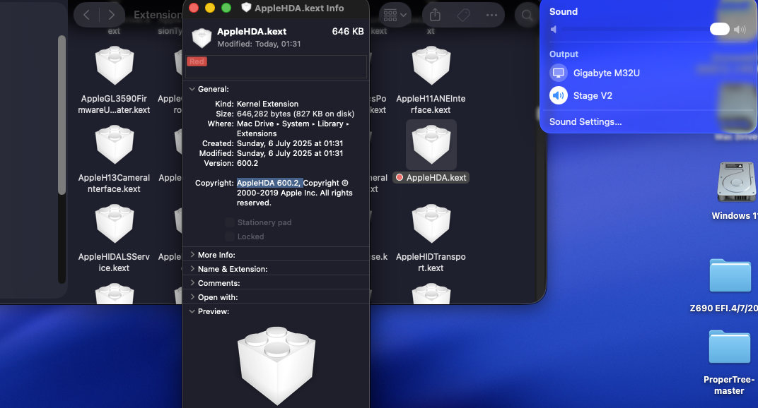

I'm currently using Tahoe OS and I have to tell you that your MyKextInstaller app isn't working in Tahoe.
I just tried installing the AppleHDA.kext, but then I checked, and it's not showing up in either System/Library/extensions or Library/Extensions.
Is there another way to get this AppleHDA.kext into System/Library/extensions? Maybe add it to the OC/kext folder?

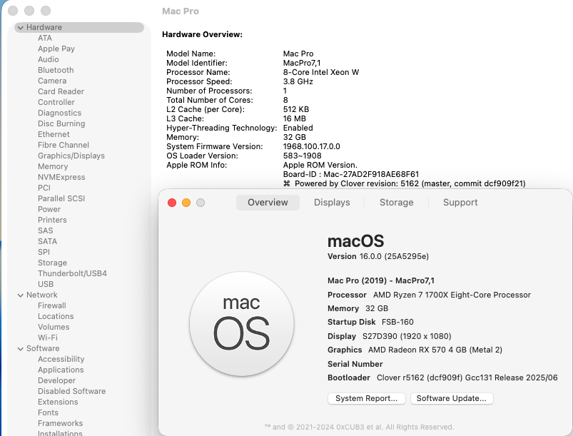

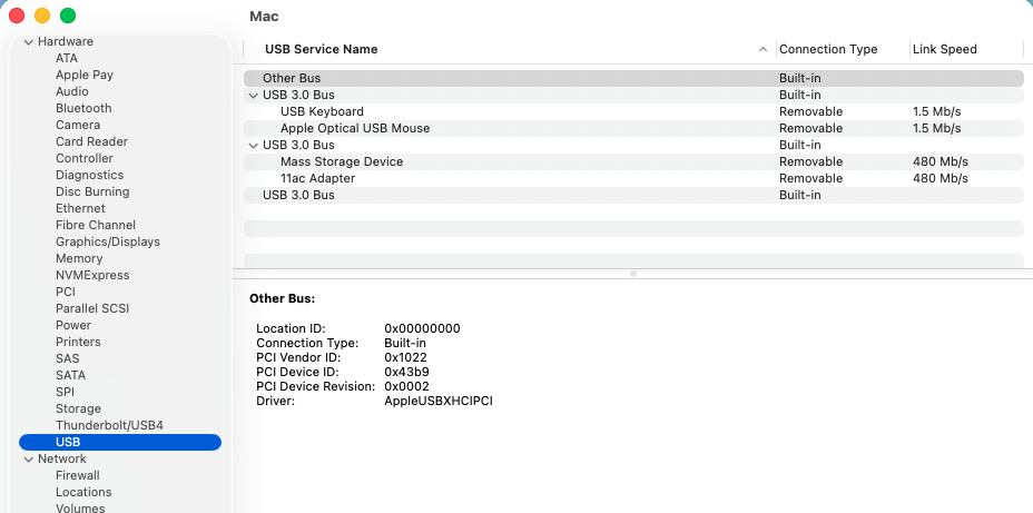

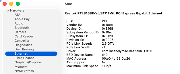

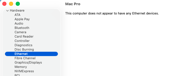

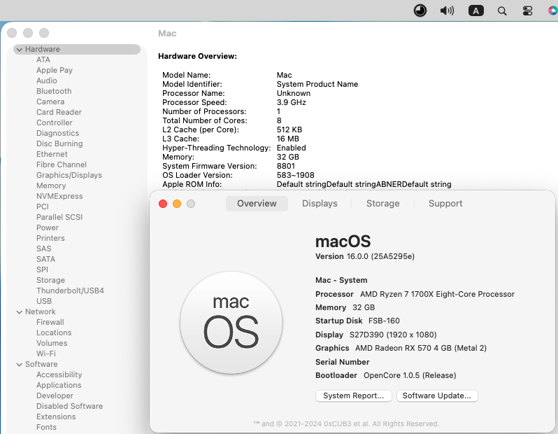

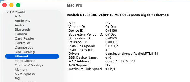

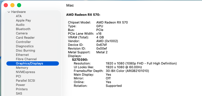

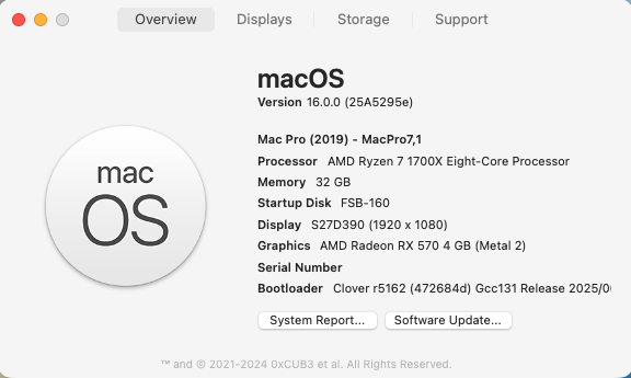

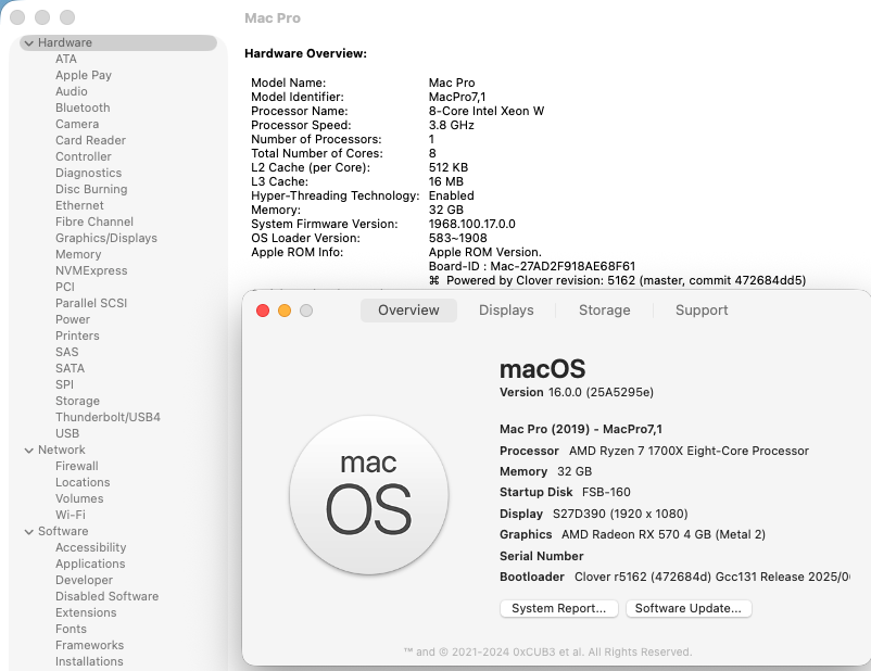

After struggling for almost 4 weeks eventually my Ryzen 1700X hackintosh can boot tahoe with RX570 now.
Firefox is not stable so I must use Google Chrome or Safari instead.

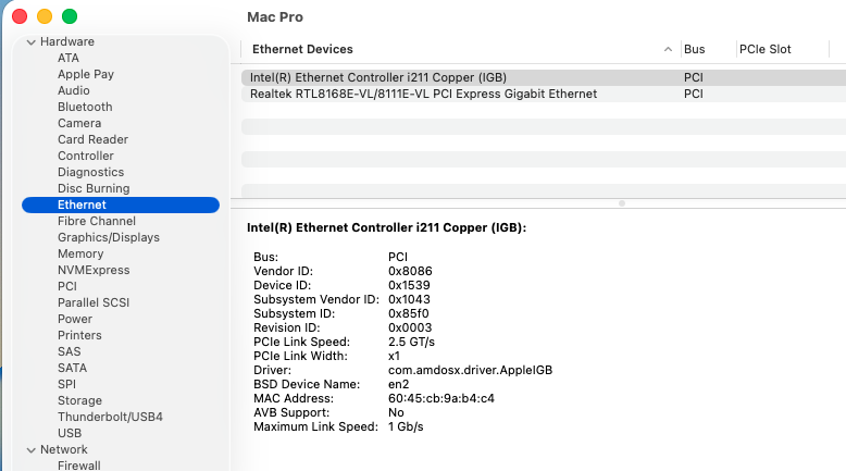

Also AppleIGB may interfere booting and caused system unstable, so I replaced it with Realtek 8111E-VL adapter too.
OpenCore 1.0.5 can not show my system hardware correctly while Clover 5162 did it correctly but it disabled all my networking adapter !
[Edit]
After update to the newest version of Clover 5162 my Realtek 8111E-VL adapter is enabled now !
So its EFI-5162.zip is posted here for your reference !

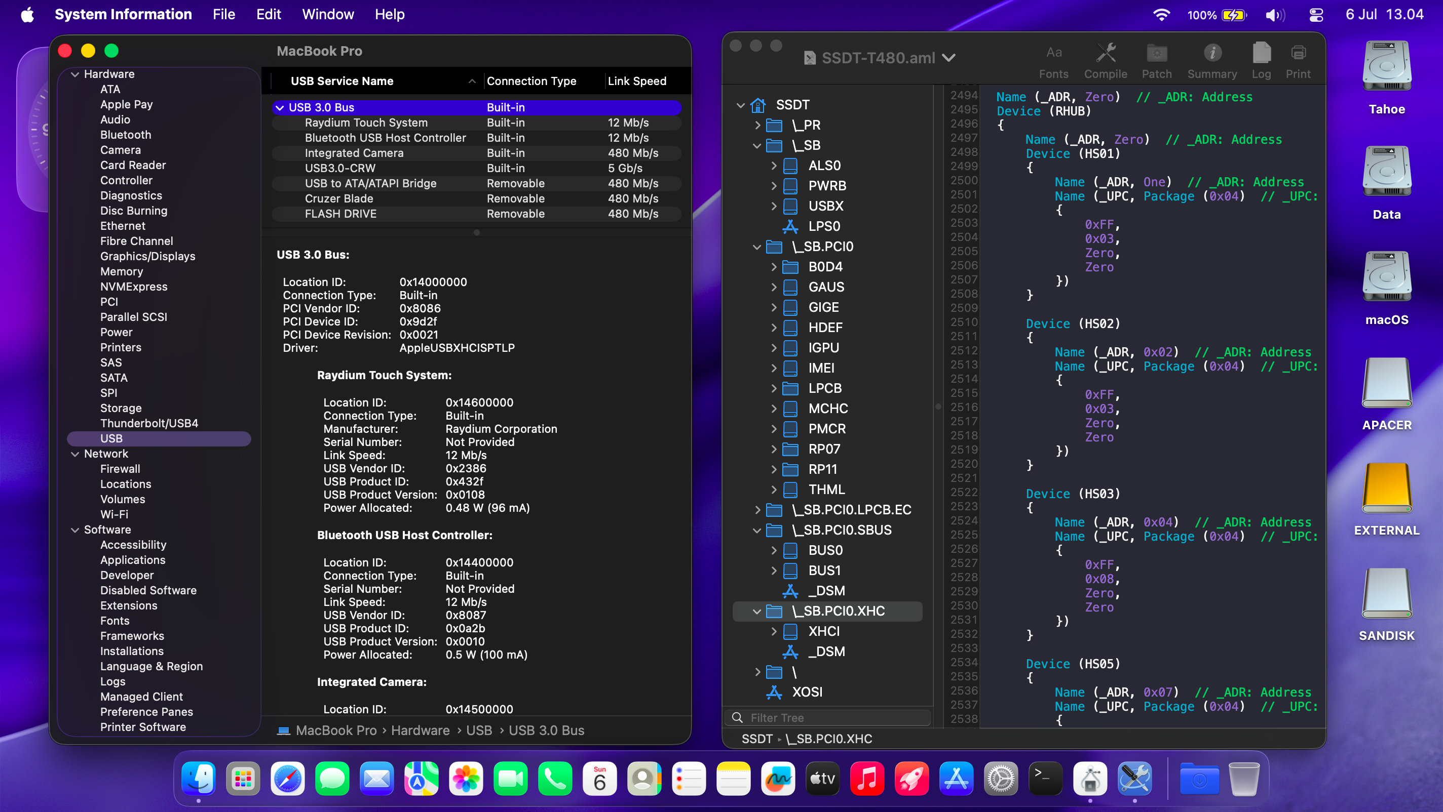

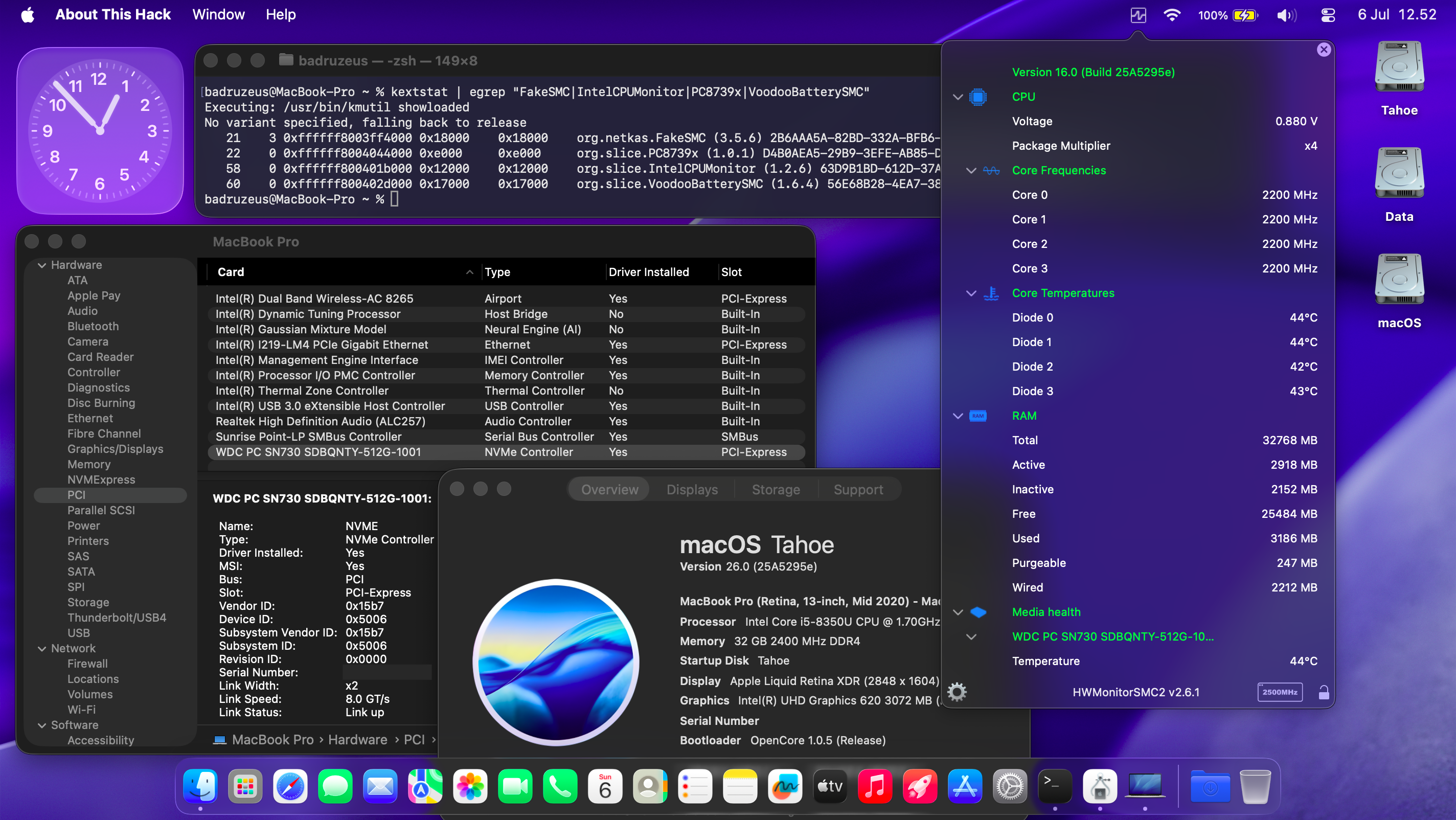

@jsl can you share your clover EFI?

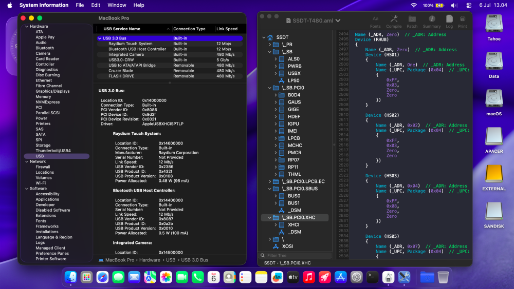

I believe that FakeSMC (and it's PlugIns) are still loaded and working fine on Tahoe.
But the best part... @Slice my Thinkpad T480 Battery Indicator is always on fully 100% and Charging #LoL 🤣 it seems like known issue with VoodooBattery* and also having no idea about this Laptop's FAN reading except YogaSMC.

Although the newest Clover 5162 can enable Intel I211 adapter with AppleIGB.kext, it cause slow booting and after login desktop very unstable system.
So TWO kexts must be disabled in my Ryzen 1700X hackintosh: AMDRyzenCPUPowerManagement.kext & AppleIGB.kext !
8 minutes ago, jsl said:
虽然最新的 Clover 5162 可以通过 AppleIGB.kext 启用 Intel I211 适配器,但它会导致启动速度缓慢,并且登录桌面后系统非常不稳定。
因此,我的 Ryzen 1700X 黑苹果中必须禁用两个 kext:AMDRyzenCPUPowerManagement.kext 和 AppleIGB.kext!

Hi @Badruzeus
These are kexts from @RehabMan, my friend. If Slice’s plugins work for you, that’s great — but keep in mind that with FakeSMC maybe you need use plugins from VirtualSMC, you’ll need to use the appropriate battery plugin and also the ECEnabler kext.
In my case, I don’t need those because my SSDTs were created specifically to use the native polling regions, along with RehabMan’s kexts. It’s a different approach, more tailored for laptops. 🤩
Battery information works perfectly for me — and I’m not using VoodooBattery at all. So yes, this issue really exists.
Hopefully one day Slice will fix it when he has the chance.
