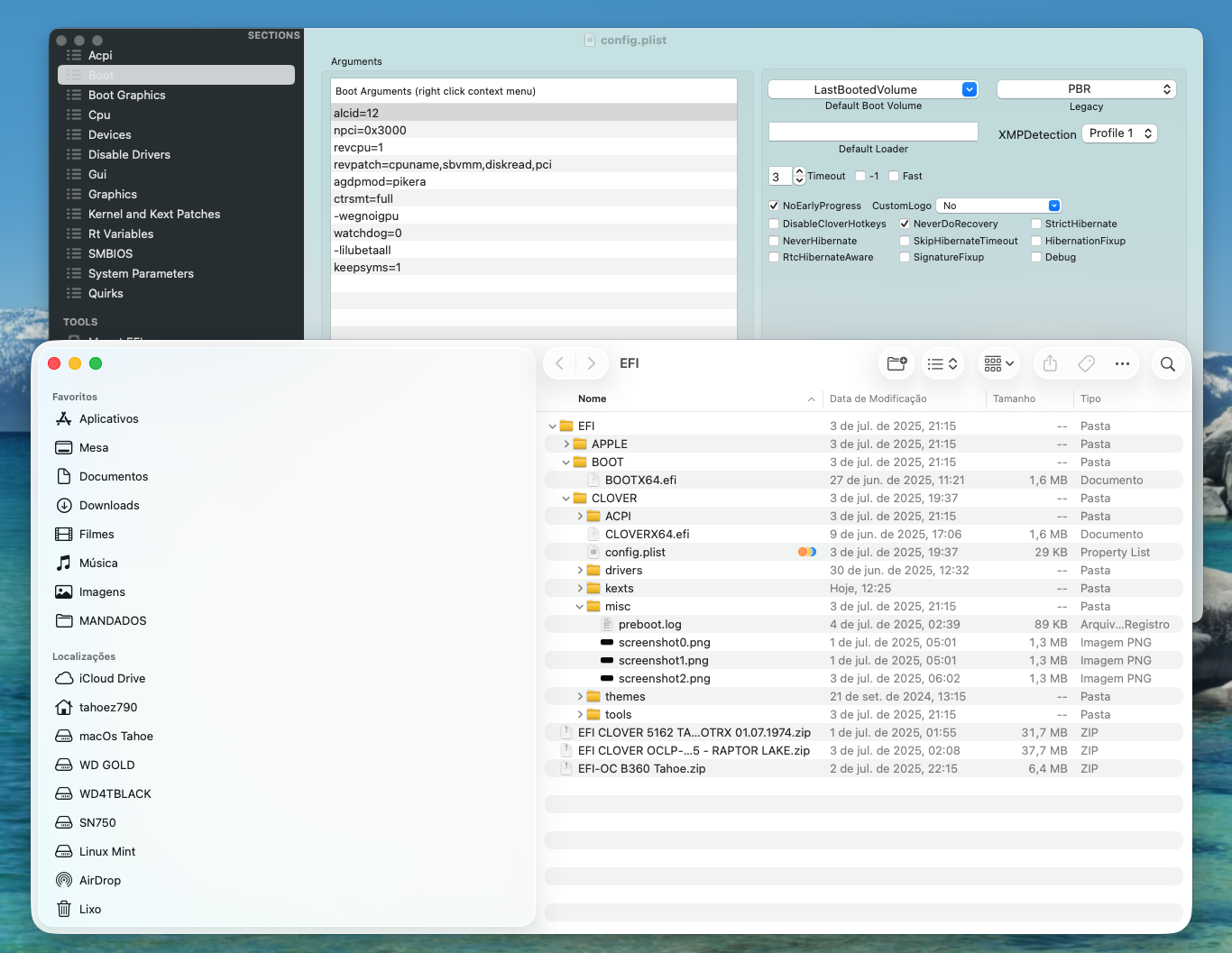

1 minute ago, strangeron said:
Have you tried opening the EFI partition with OC Configurator? Is it just me who is having this slow start-up? After that it's normal.
I use OCAT. I think it's important to use the configurator that created the EFI in the first place. Well that was my experience from years ago anyway.

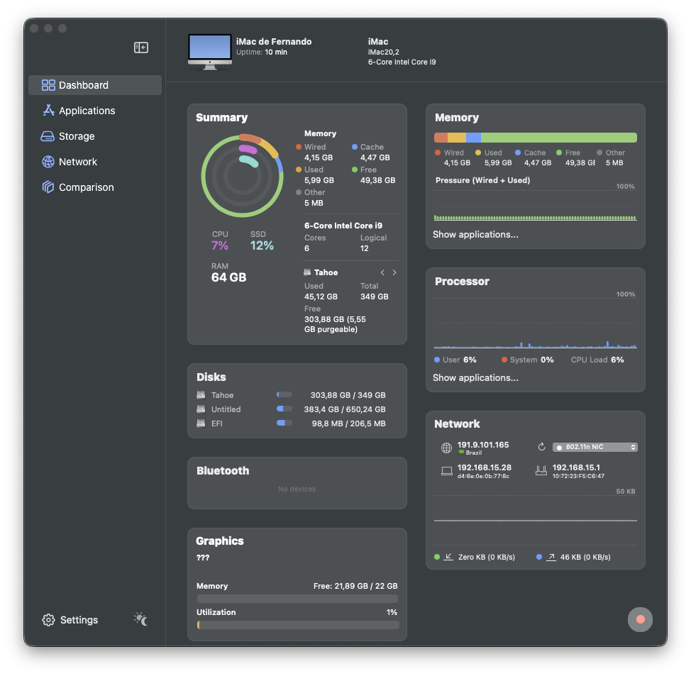

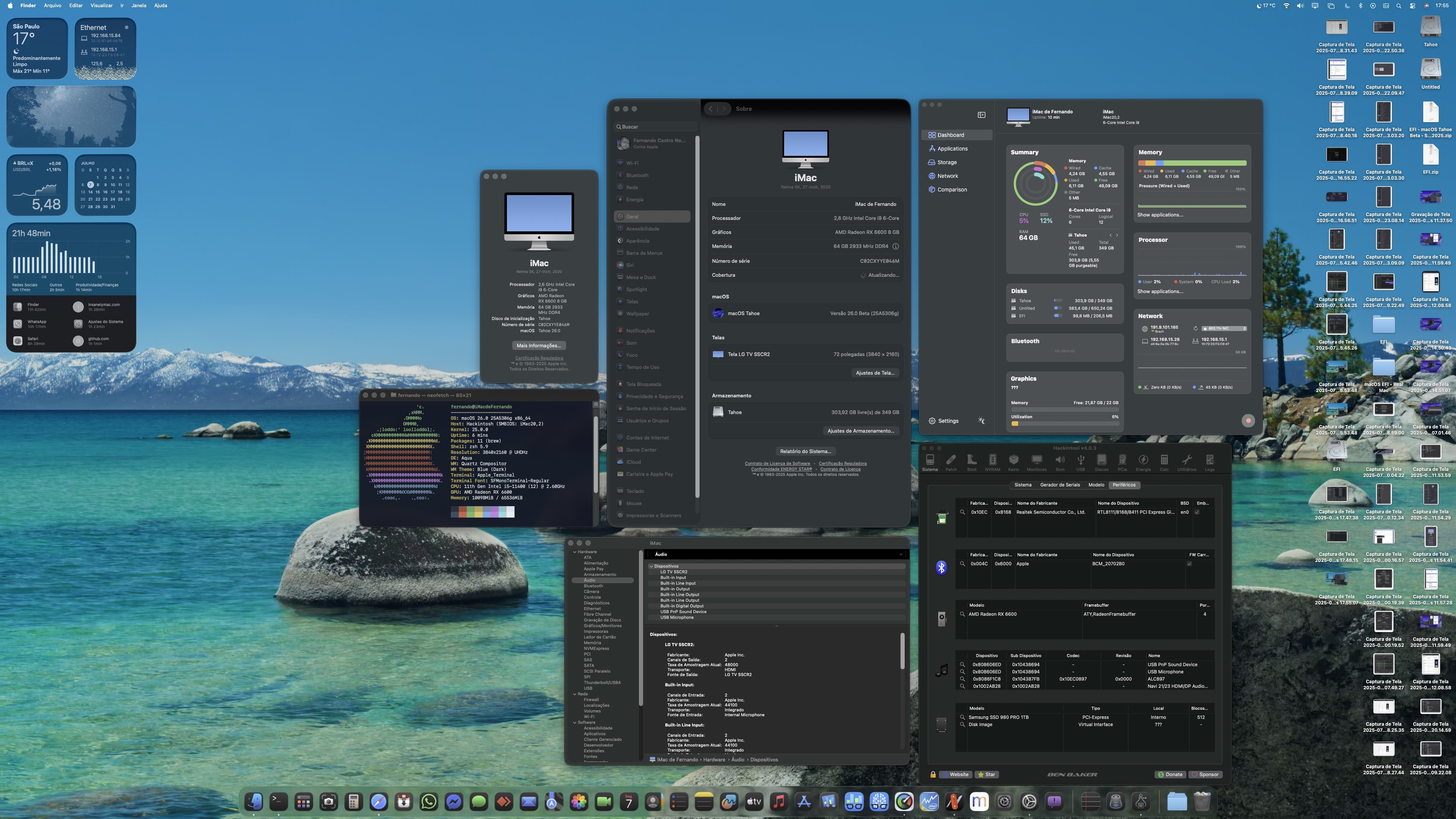

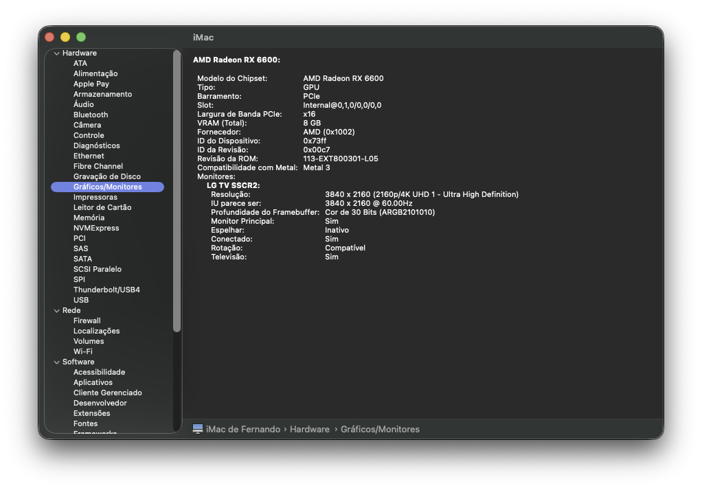

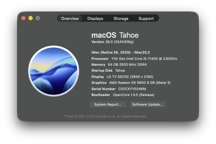

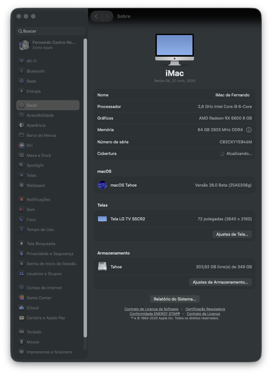

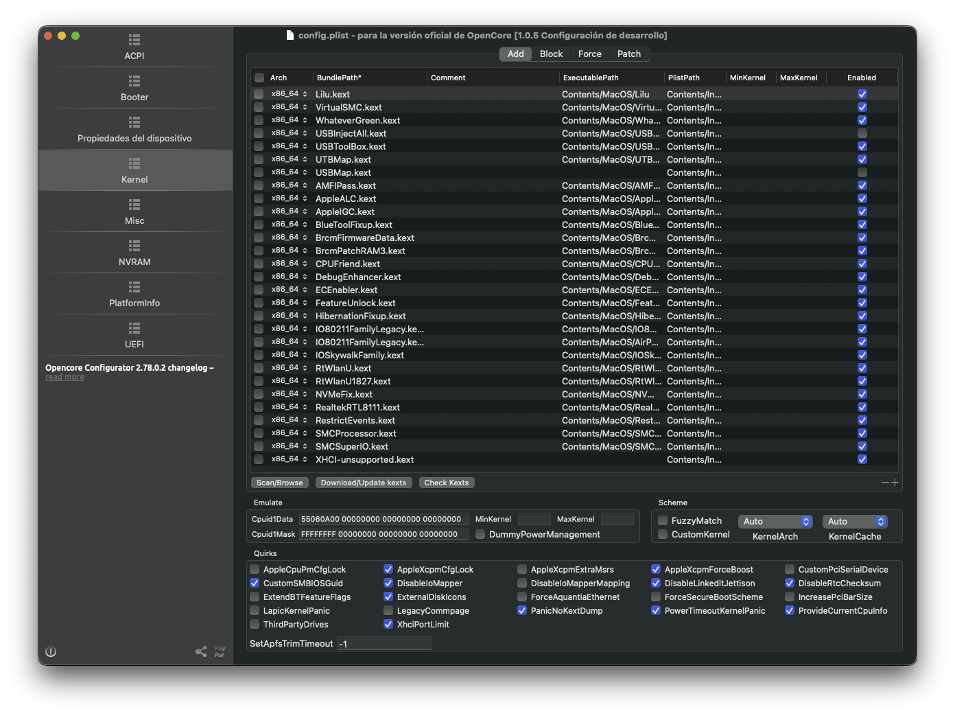

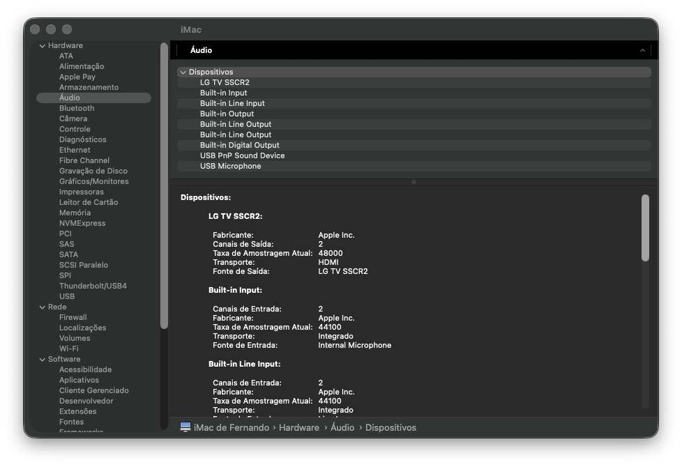

Now the review of Tahoe Beta 3.

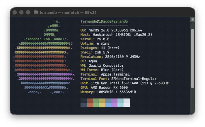

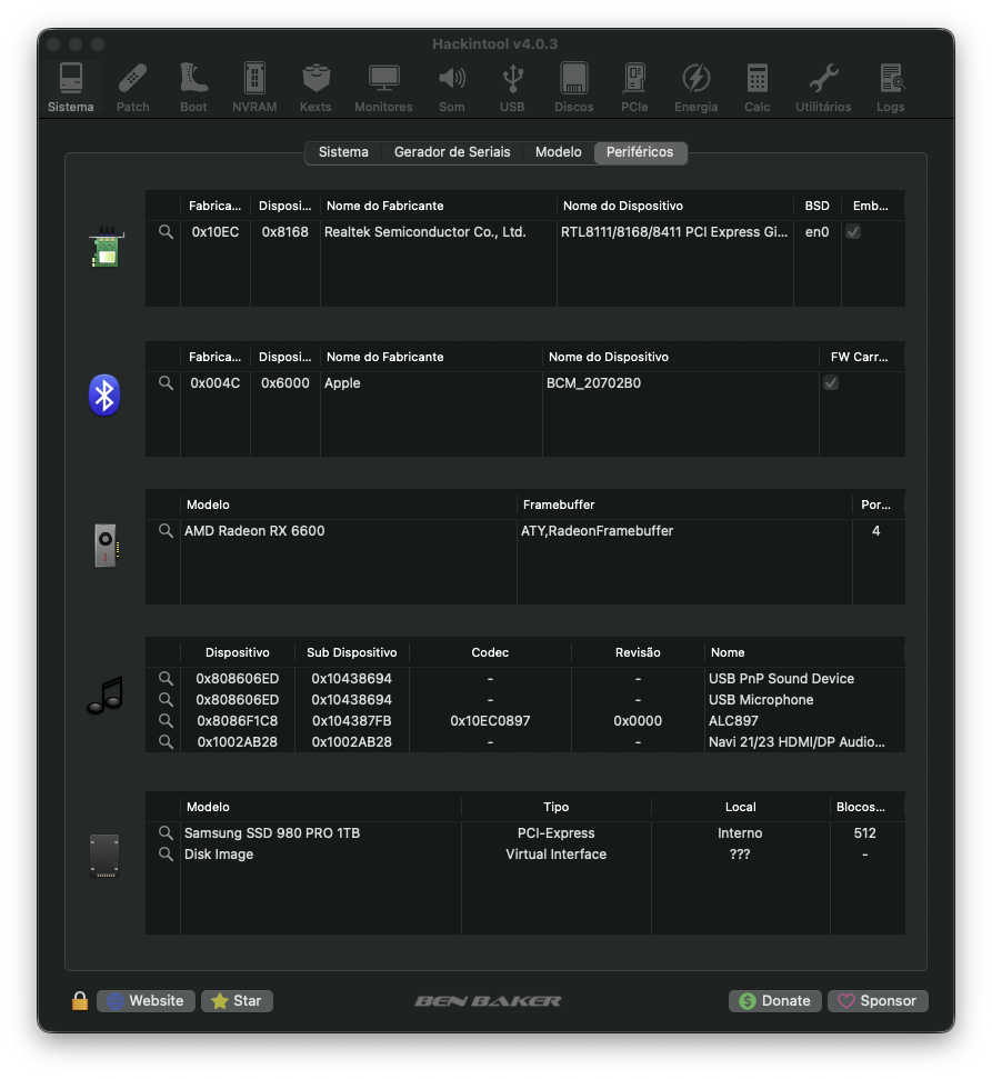

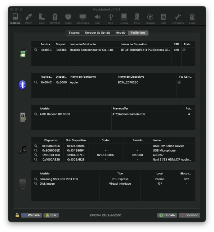

New Wallpaper, AppleHDA.kext working after successfully installed the Beta 3 (Update). My Graphics Card => AMD Radeon RX 6600 8GB is working without any issue with WEG working OOB,
Audio ALC897 is working without any issue so far, and every single app I run Works without any issues..
CapturadeTela2025-07-07s17_47_38.thumb.png.0b9e8a19f68d306b41395ddb0ab745e1.pngCapturadeTela2025-07-07s17_48_15.thumb.png.2417a6eb6d5a7160fcb890d67567f9c1.pngCapturadeTela2025-07-07s17_55_38.png.89bea10950f13da40b37cd9173f6d338.pngCapturadeTela2025-07-07s17_55_40.png.1cf5c3c4c867c729b4ca8948cc1b41ae.pngCapturadeTela2025-07-07s17_55_44.thumb.png.0b2df3c45df00ee5464e33f66a812f59.pngCapturadeTela2025-07-07s17_55_47.thumb.png.d1aefc5fa59df58f6506c691b4b681cb.pngCapturadeTela2025-07-07s17_55_50.thumb.png.d3234f0590d1e2a0cde62adc4d45c7a8.pngCapturadeTela2025-07-07s17_56_10.thumb.png.6af7f75cbdcd88f7f162c4f2e60d6bbe.png

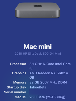

Smooth and easy upgrade from Tahoe Beta 2 -> Beta 3 on my HackMini8,1.  Same upgrade procedure as Beta 1 -> Beta 2: Temporarily disable BluetoolFixup.kext and temporarily add WEG boot-arg -wegnoegpu for OTA incremental upgrade.  After upgrade is complete, enable BluetoolFixup.kext and remove WEG boot-arg -wegnoegpu, then reboot.  RX 560x and VoodooHDA work in Beta 3 without issues that I have observed.
I'm using VoodooHDA.kext with csr-active-config = <01000000> (only need to allow untrusted kexts - no need to further disable SIP after VoodooHDA is installed).  Sound quality is outstanding.  I'm not using OCLP at all on this hack, since it is my "production" hack and I want maximal SIP, enabled AMFI and no rooting.
After performing upgrade, VoodooHDA.kext continued to work without issues - no need to re-install VoodooHDA or perform any other operations following the upgrade.
Incremental Upgrade after temporarily disabling BluetoolFixup.kext and temporarily adding -wegnoegpu boot-arg

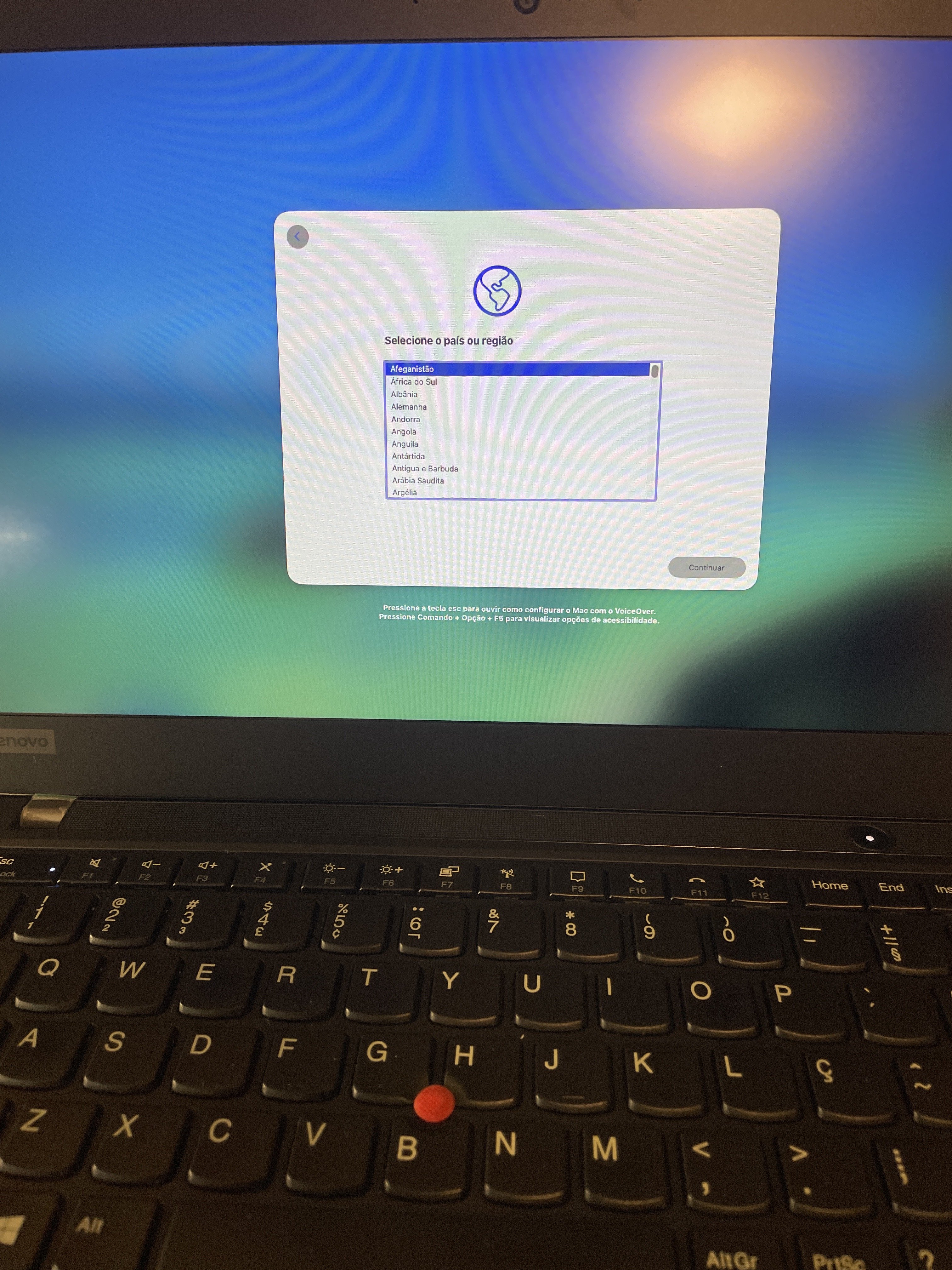

33 minutes ago, eSaF said:
Clean install Beta 3 test done no problem.
Removed the Amfi boot-arg and returned to using just the Amfi.kext.

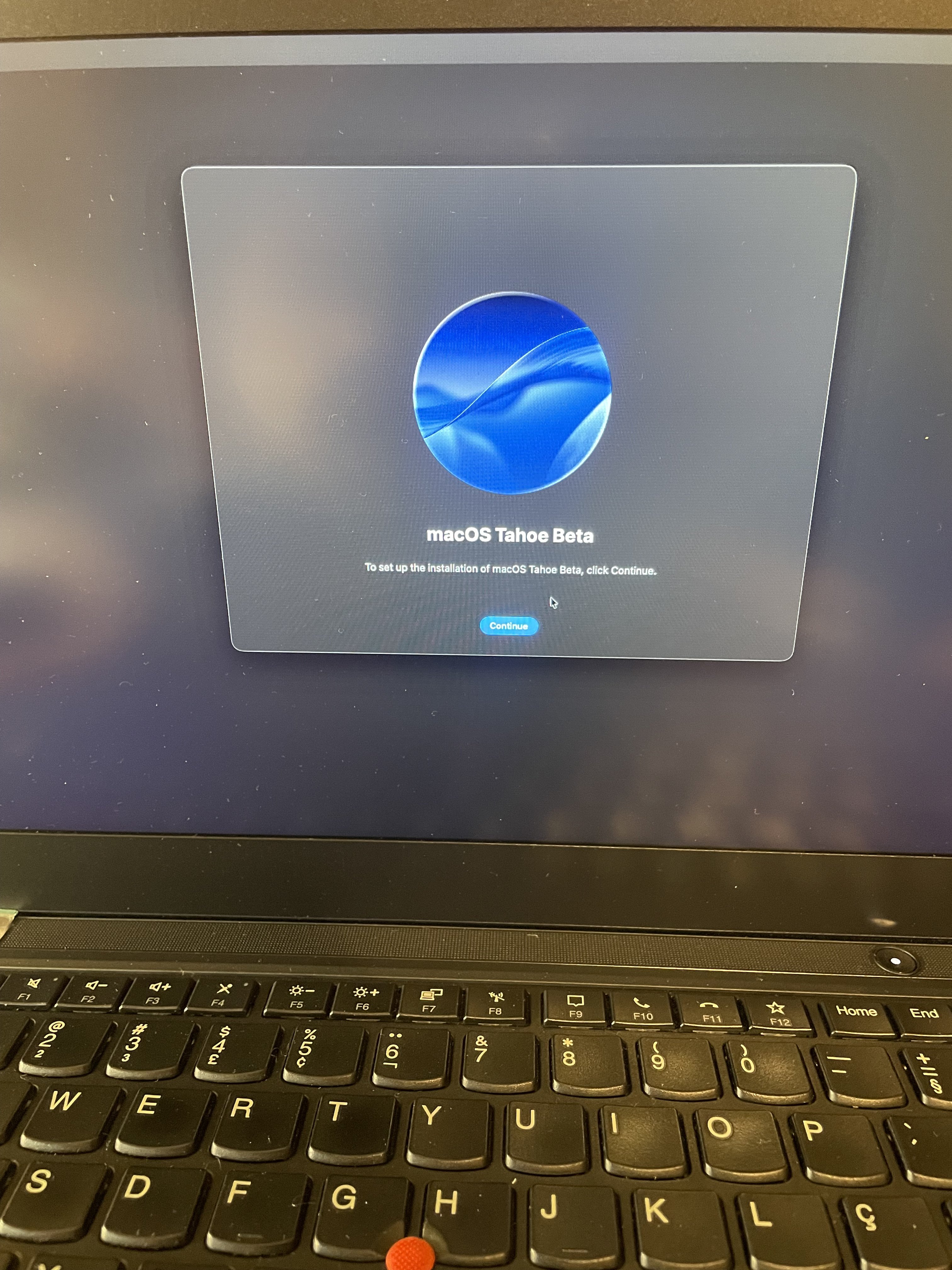

Yes, I'm using Clover with RehabMan's kexts for a fresh install on my Lenovo T14
Fastest installation ever — just 10 minutes!  :plane: 👀
