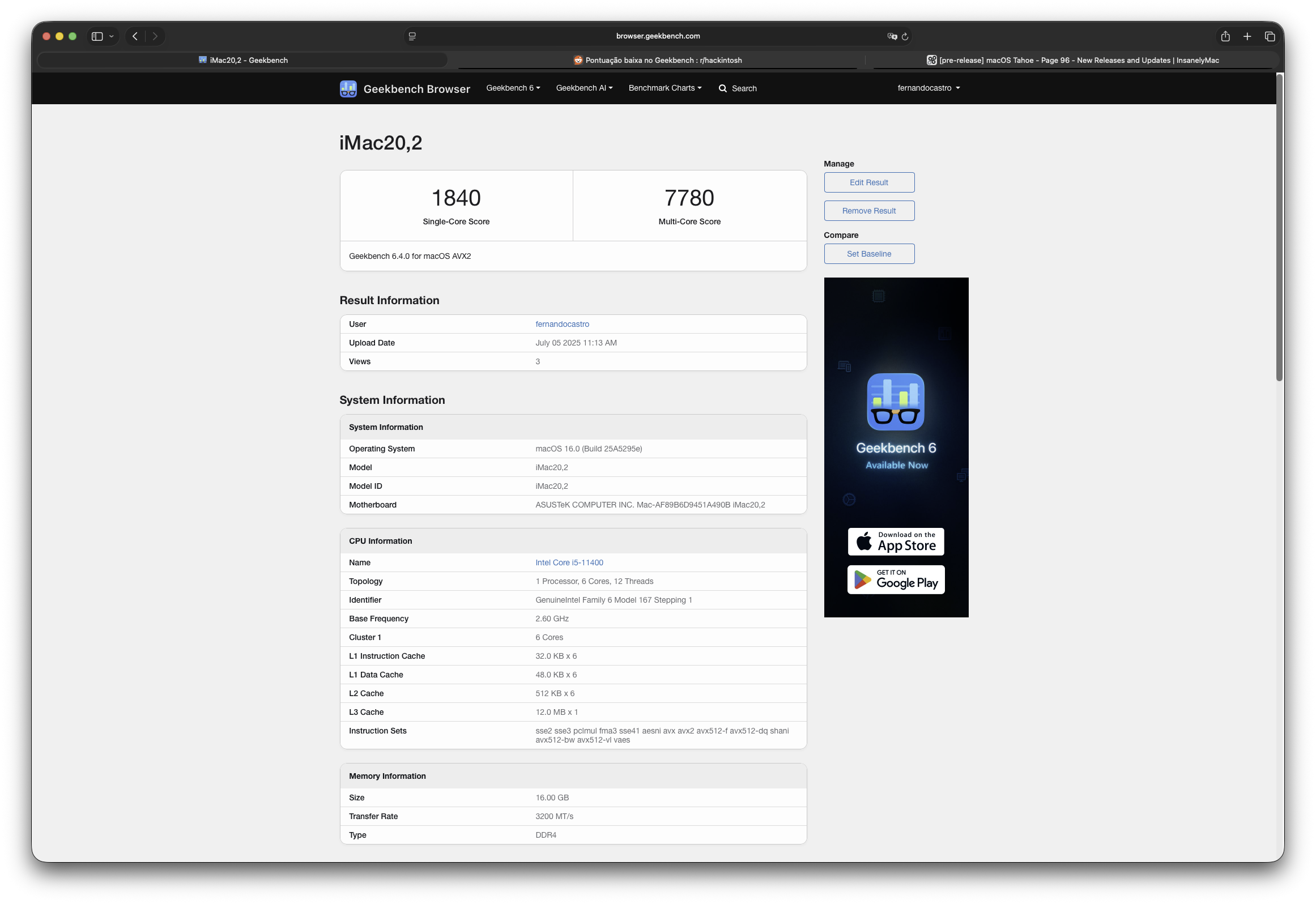

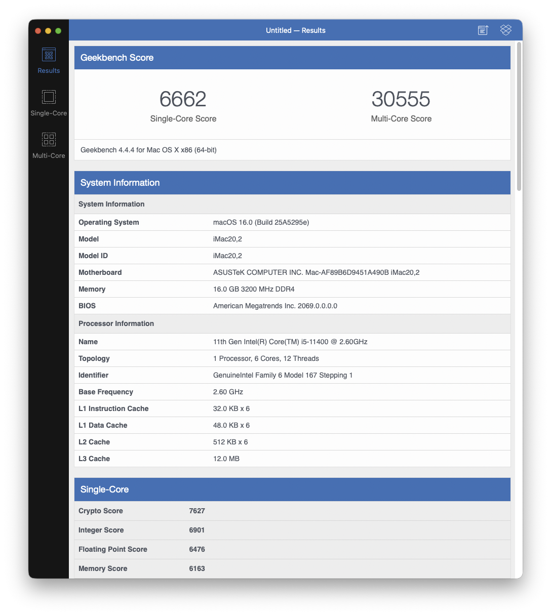

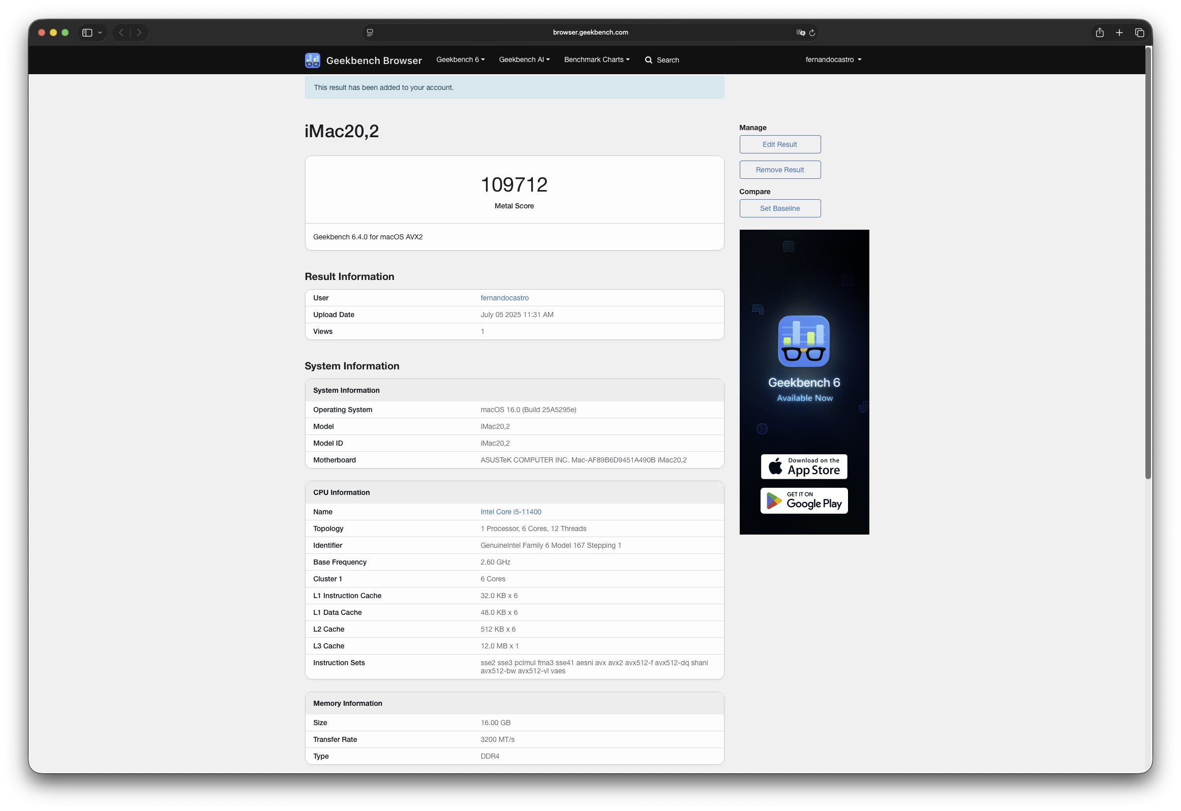

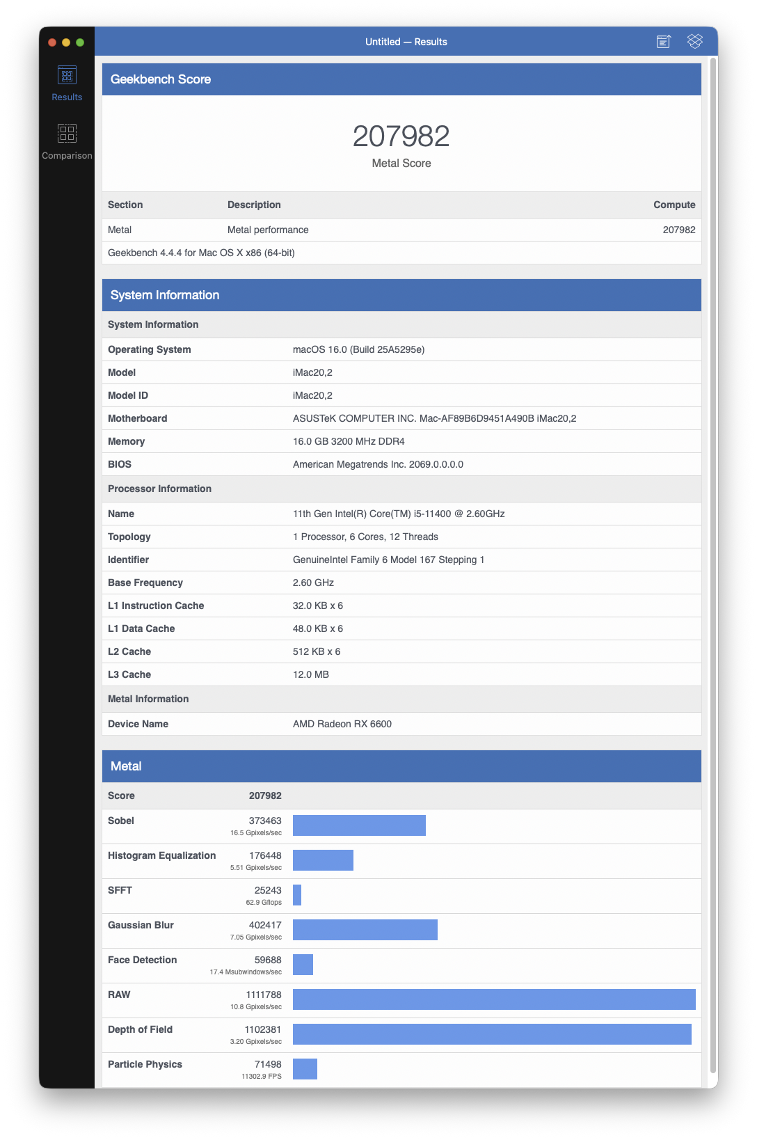

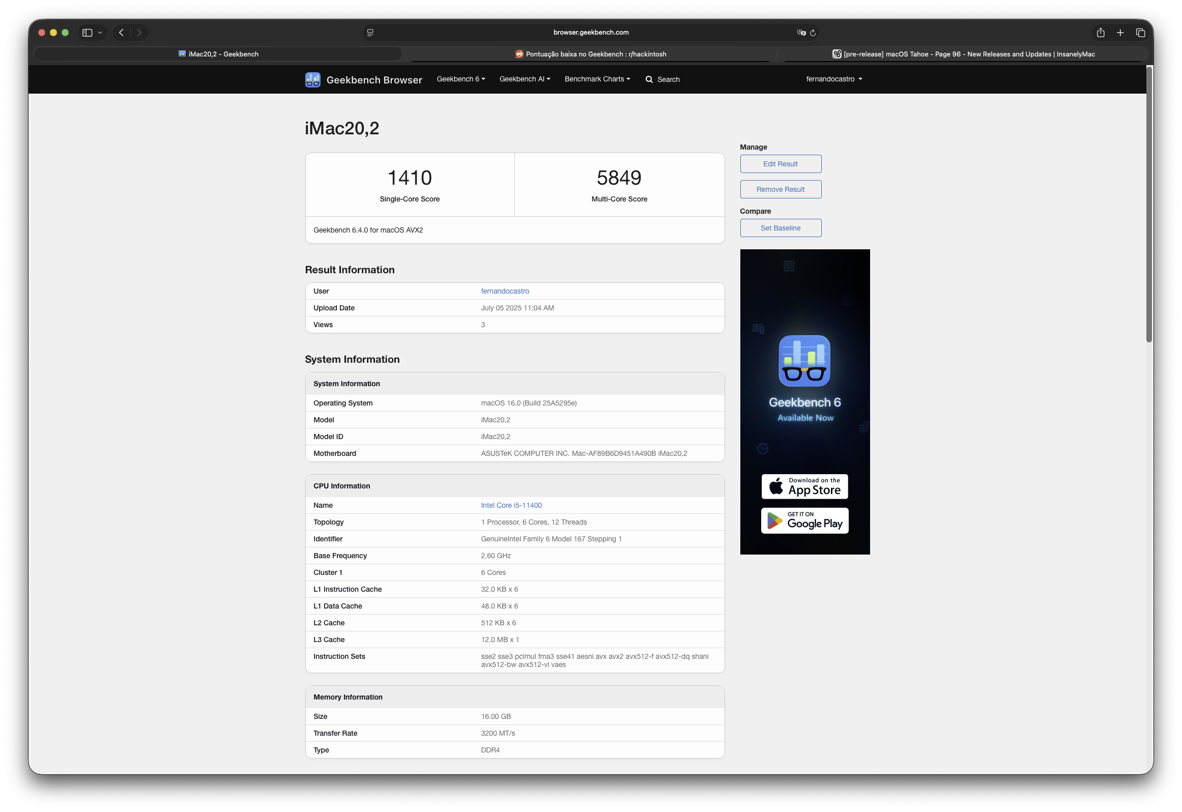

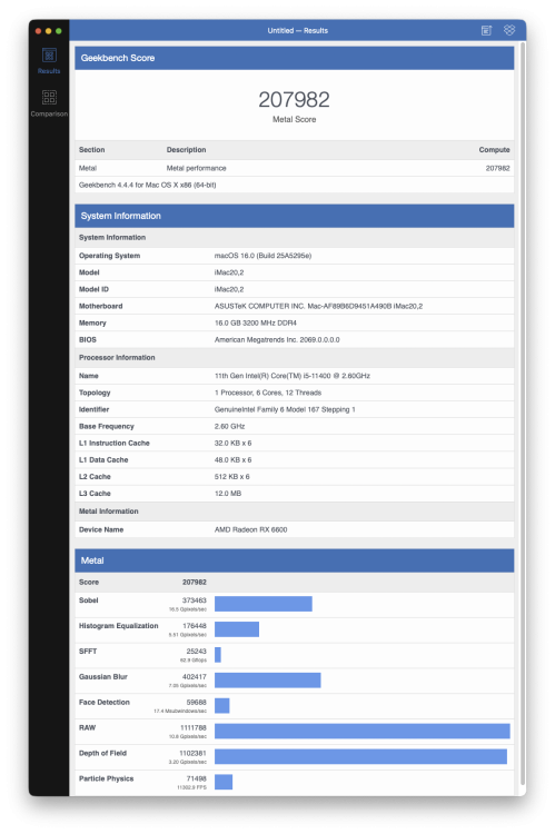

fernando.c.neves Posted July 5, 2025 Share Posted July 5, 2025 (edited) If you getting poor Geekbench Results, do this in OpenCore Configurator... Enable => AppleXcpmForceBoost > Kernel>Quirks Before results => 5849 After => 7780 Now in Windows I´m getting => 7980 AMD Radeon RX 6600 8GB Regards, Fernando. Ps: Those results are obtained in GeekBench 6 with ASUS Prime H510M-K R2.0 with an Intel core i5 11400 / XMP II => Dual Channel 3200Mhz DDR4 / AMD Radeon RX 6600 8GB Reference in Geekbench 4 results Edited July 5, 2025 by fernando.c.neves 4 Link to comment https://www.insanelymac.com/forum/topic/361162-pre-release-macos-tahoe/page/85/#findComment-2836002 Share on other sites More sharing options...

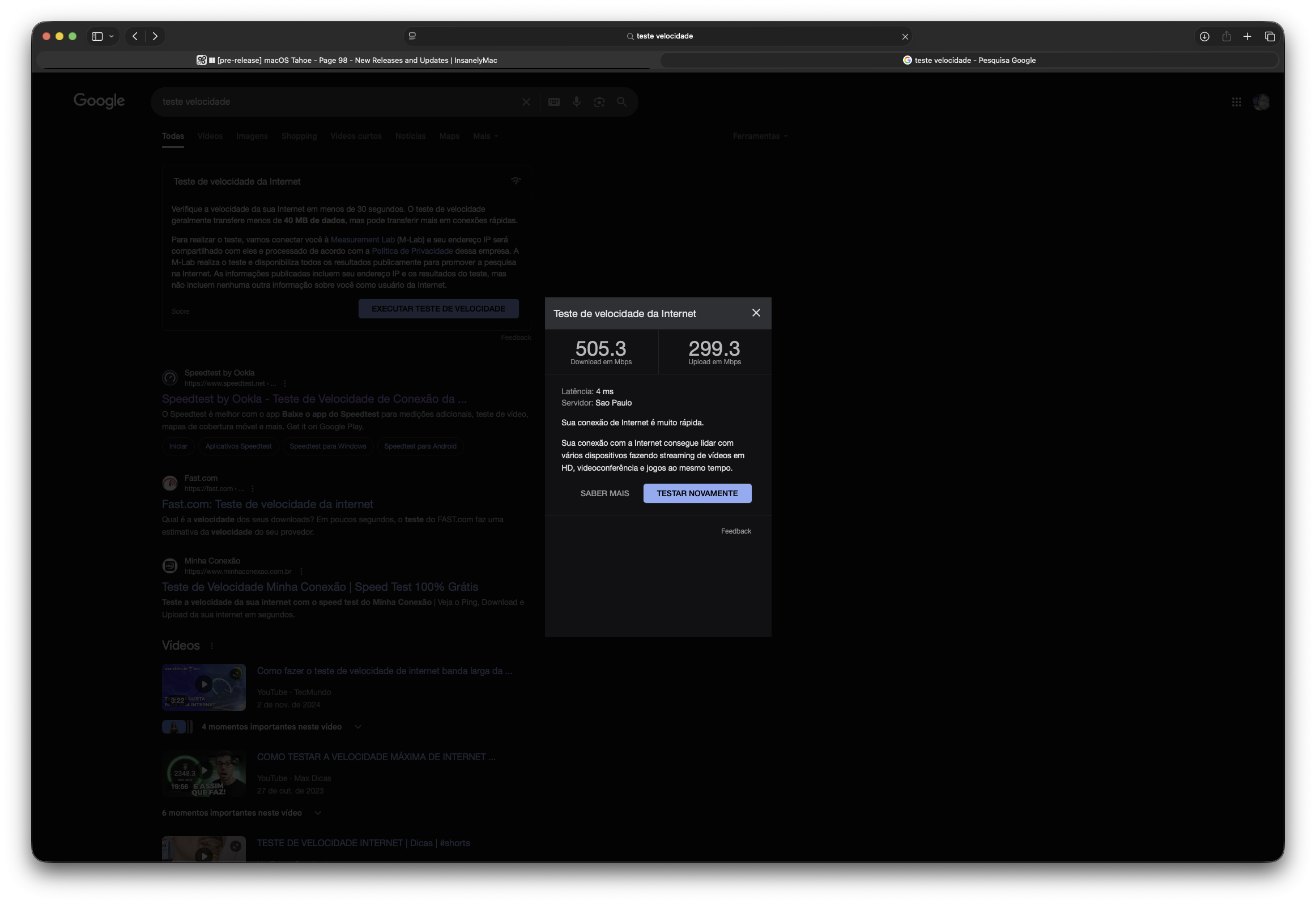

strangeron Posted July 5, 2025 Share Posted July 5, 2025 24 minutes ago, laobamac_yyds said: bro, I noticed that many of you like to use USB wireless network cards, but why is the speed of using USB wireless network cards here slow, even around 200Mbps? I am certain that this is not an issue with macOS, as it is also the case under Windows 10😭😭 We shouldn't be defined on this list. Turkey ranks 101st in fixed internet speed with 49.11 Mbps. However, it is still a bit slower in Tahoe than in Ventura and Sequoia. 1 Link to comment https://www.insanelymac.com/forum/topic/361162-pre-release-macos-tahoe/page/85/#findComment-2836038 Share on other sites More sharing options...

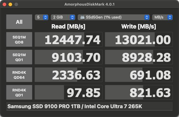

surenmunoo Posted July 5, 2025 Share Posted July 5, 2025 (edited) 9 hours ago, ori said: And can anything be done on the link speed ssd 5th gen? My 9100 Pro shows the same with no link speed but I get 10500 write and 10000 read. Maybe Mac does not know how to deal with Gen 5 5 hours ago, chris1111 said: For Realtek USB Wifi adapter All pages (Usage) is updated for macOS Tahoe 26 All Release is Update Enjoy Anyway to get the wifi icon visible when not using Dark mode? Edited July 5, 2025 by surenmunoo Link to comment https://www.insanelymac.com/forum/topic/361162-pre-release-macos-tahoe/page/85/#findComment-2836046 Share on other sites More sharing options...

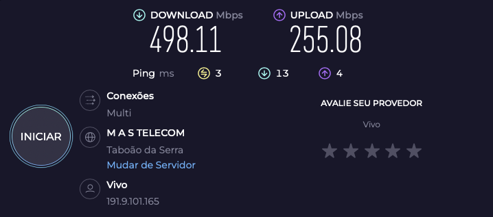

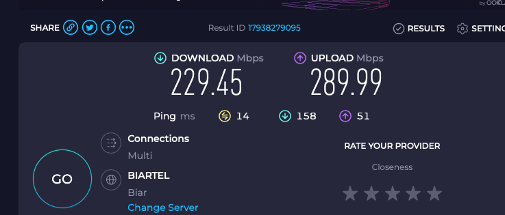

robi62 Posted July 5, 2025 Share Posted July 5, 2025 20 minutes ago, strangeron said: USB Wifi is very slow on Tahoe. However, it is not the same on Ventura and Sequoia. I had to remove OCLP-Mod and switch back to Ethernet. I may not have seen it. What is the situation for those using USB Wifi? Hi i im ok wtih usb wifi these are my speeds 3 Link to comment https://www.insanelymac.com/forum/topic/361162-pre-release-macos-tahoe/page/85/#findComment-2836051 Share on other sites More sharing options...

strangeron Posted July 5, 2025 Share Posted July 5, 2025 27 minutes ago, robi62 said: Hi i im ok wtih usb wifi these are my speeds I think we cannot even dream of such speed in this country. Let's not exaggerate, please. 😂😉🫣 2 Link to comment https://www.insanelymac.com/forum/topic/361162-pre-release-macos-tahoe/page/85/#findComment-2836054 Share on other sites More sharing options...
