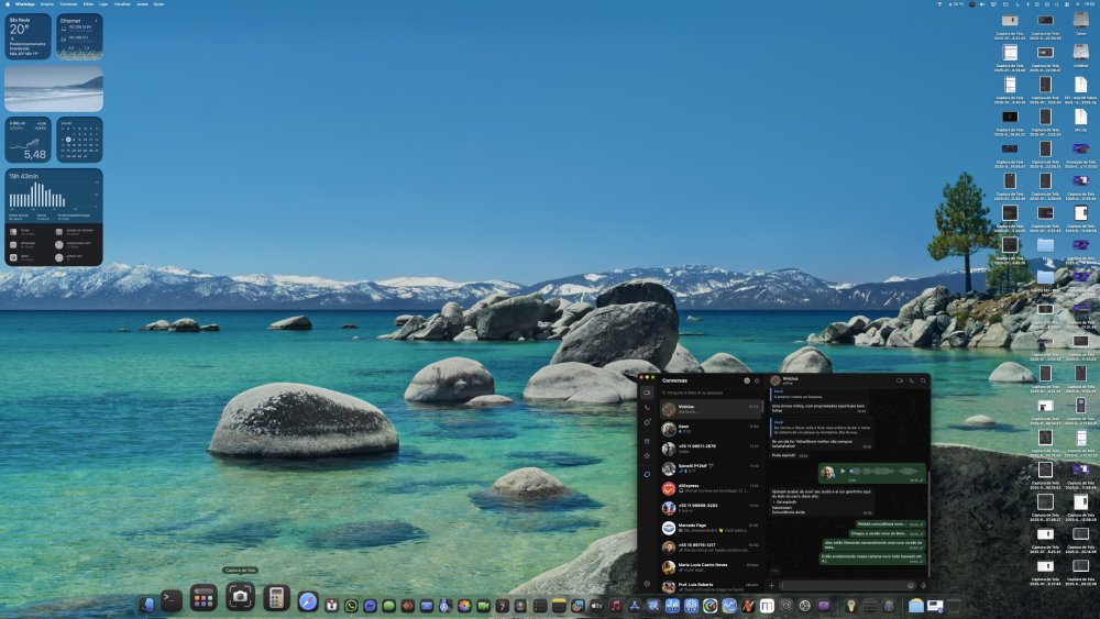

Anto65 Posted July 7, 2025 Share Posted July 7, 2025 Just now, eSaF said: The Tahoe Day Wallpaper is also a live Screen Saver. Quite a pleasant addition in this Beta. Yes absolutely it was really necessary 1 3 Link to comment https://www.insanelymac.com/forum/topic/361162-pre-release-macos-tahoe/page/91/#findComment-2836233 Share on other sites More sharing options...

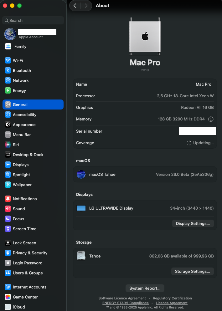

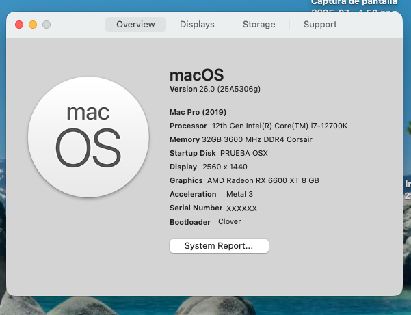

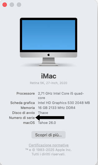

Anto65 Posted July 7, 2025 Share Posted July 7, 2025 13 minutes ago, jm26200 said: Done. quickly 😀 Update About-This-Hack 😉 4 1 Link to comment https://www.insanelymac.com/forum/topic/361162-pre-release-macos-tahoe/page/91/#findComment-2836237 Share on other sites More sharing options...

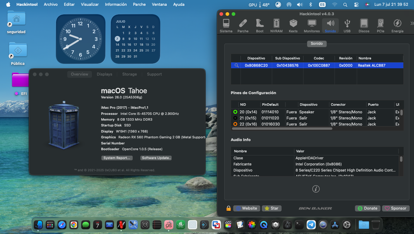

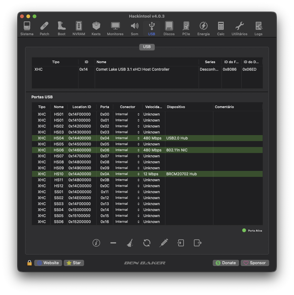

fernando.c.neves Posted July 7, 2025 Share Posted July 7, 2025 (edited) 59 minutes ago, laobamac_yyds said: Damn Apple, why has IOSurface.framework been modified again .... f********k😭😭😭😭 Note: Has anyone tested the HDA and USB patches of the OCLP-Mod under beta3? Everything working like a charm... AppleHDA, USB, etc... Regards, Fernando. Edited July 7, 2025 by fernando.c.neves 3 Link to comment https://www.insanelymac.com/forum/topic/361162-pre-release-macos-tahoe/page/91/#findComment-2836239 Share on other sites More sharing options...

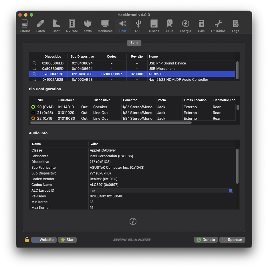

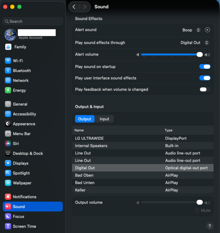

Derty Posted July 7, 2025 Share Posted July 7, 2025 ok not audio.... 2 Link to comment https://www.insanelymac.com/forum/topic/361162-pre-release-macos-tahoe/page/91/#findComment-2836241 Share on other sites More sharing options...

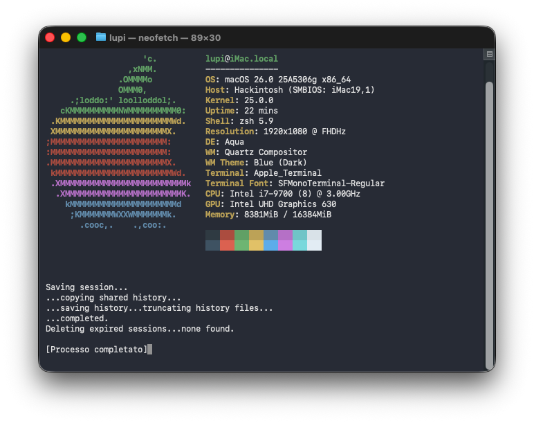

webipsum Posted July 7, 2025 Share Posted July 7, 2025 1 hour ago, eSaF said: neofetch for Terminal, installation only through Homebrew? 1 Link to comment https://www.insanelymac.com/forum/topic/361162-pre-release-macos-tahoe/page/91/#findComment-2836242 Share on other sites More sharing options...
Anto65 Posted July 7, 2025 Share Posted July 7, 2025 (edited) 3 minutes ago, webipsum said: neofetch for Terminal, installation only through Homebrew? https://github.com/dylanaraps/neofetch/releases Spoiler Edited July 7, 2025 by Anto65 1 Link to comment https://www.insanelymac.com/forum/topic/361162-pre-release-macos-tahoe/page/91/#findComment-2836243 Share on other sites More sharing options...

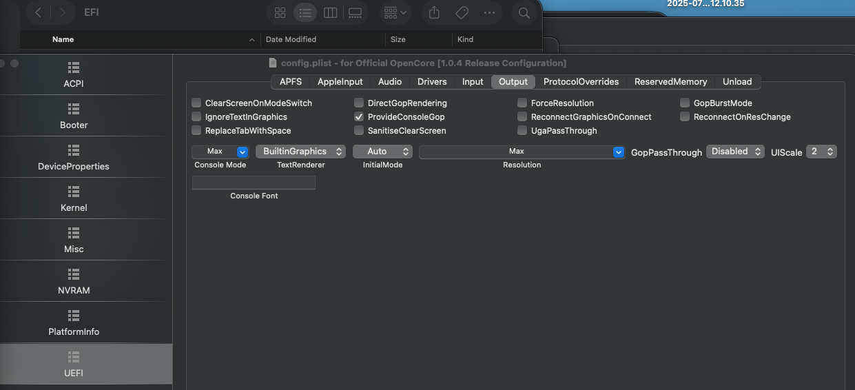

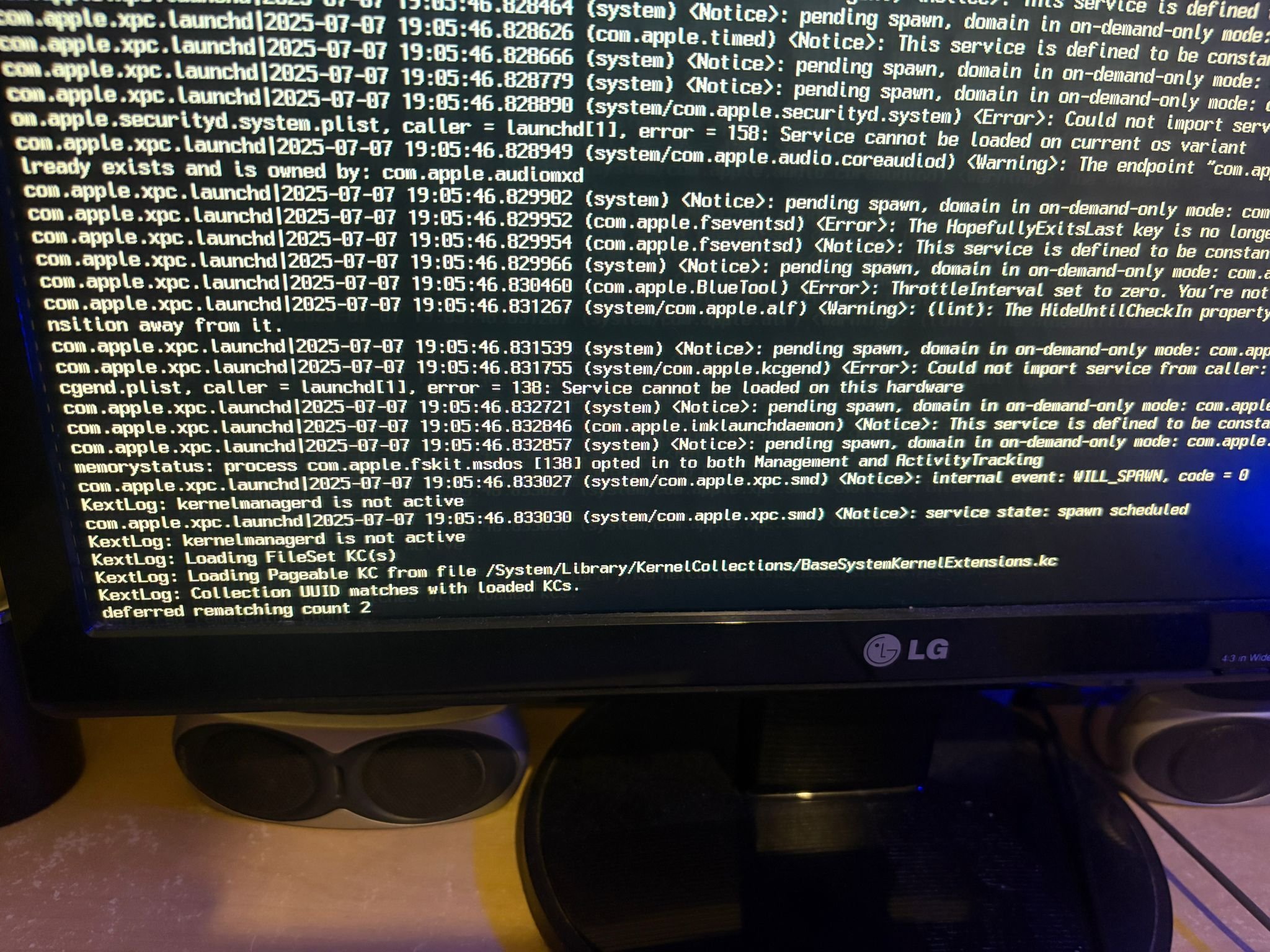

kaoskinkae Posted July 7, 2025 Share Posted July 7, 2025 (edited) On the OLD: computer: I have not been able to finish the update of the computer in this beta 3 and in the 2 using a MacPro 7.1 in beta 2 I chose to remove the SSD and place it in a USB-SSD adapter and on my NEW: computer finish the update it stays in one part see photo I will continue investigating before removing the SSD solution to disable the WhateverGreen.kext kext Edited July 7, 2025 by kaoskinkae 1 Link to comment https://www.insanelymac.com/forum/topic/361162-pre-release-macos-tahoe/page/91/#findComment-2836246 Share on other sites More sharing options...

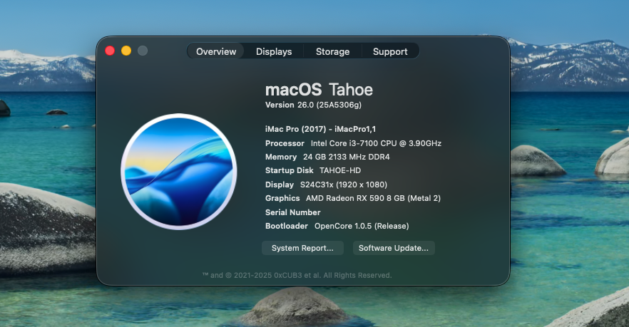

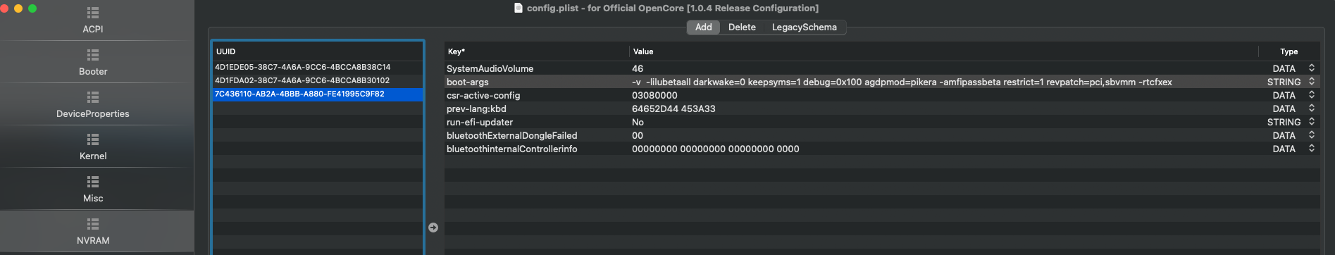

kgp Posted July 7, 2025 Share Posted July 7, 2025 (edited) With the official release of opencore 1.0.5 and the official release of the latest Lilu-kext-family-package (Lilu.kext 1.7.1, WhateverGreen.kext 1.7.0, AppleALC.kext 1.9.5), flawless update to Tahoe Beta 3 even with WhateverGreen.kext enabled during the update. With WhateverGreen.kext, I am using boot argument: agdpmod=pikera. Note that I did not revert the OCLP-Mod Root Patch before the update to Tahoe Beta 3 ( and still flawless incremental update to Tahoe 3 Beta via system settings) and thus OCLP-Mod automatically detected the missing root patch after the update to Tahoe Beta 3 and automatically reinstalled everything. Just that straight! Thanks, @laobamac_yyds! With respect to the findings above, my latest EFI-Folder distribution v1.0.3 Edited July 9, 2025 by KGP-iMacPro 4 Link to comment https://www.insanelymac.com/forum/topic/361162-pre-release-macos-tahoe/page/91/#findComment-2836247 Share on other sites More sharing options...

kaoskinkae Posted July 7, 2025 Share Posted July 7, 2025 Beta 3 installation using a MacPro 7.1 on an OLD: computer: use an installation USB when using an imacpro1.1 on this computer to complete the update it is necessary that the WhateverGreen.kext kext is disabled on the beta 3 installation USB but I have applied the AppleHDA patch perfectly Link to comment https://www.insanelymac.com/forum/topic/361162-pre-release-macos-tahoe/page/91/#findComment-2836249 Share on other sites More sharing options...

kgp Posted July 7, 2025 Share Posted July 7, 2025 (edited) 24 minutes ago, kaoskinkae said: Beta 3 installation using a MacPro 7.1 on an OLD: computer: use an installation USB when using an imacpro1.1 on this computer to complete the update it is necessary that the WhateverGreen.kext kext is disabled on the beta 3 installation USB but I have applied the AppleHDA patch perfectly And it did not work with enabeled WhateverGreen.kext, when implementing the latest official release of opencore and the Lilu-Family-Package? See my post above. In my case it worked now perfectly, while I always had to disable WhateverGreen.kext, when booting the macOS Tahoe installers. Edited July 7, 2025 by KGP-iMacPro Link to comment https://www.insanelymac.com/forum/topic/361162-pre-release-macos-tahoe/page/91/#findComment-2836252 Share on other sites More sharing options...
strangeron Posted July 7, 2025 Share Posted July 7, 2025 Yes. For a smooth update on the RX500 series, WEG.kext must be removed. Using this kext also prevents access to the Recovery disk. 1 Link to comment https://www.insanelymac.com/forum/topic/361162-pre-release-macos-tahoe/page/91/#findComment-2836253 Share on other sites More sharing options...
