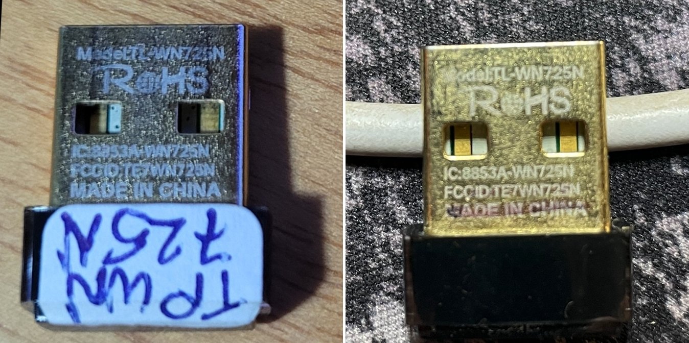

webipsum Posted July 3, 2025 Share Posted July 3, 2025 (edited) 10 hours ago, Max.1974 said: Hi @chris1111 my friend, "It’s always good to keep the old wine, for we can always drink from the source!" @Max.1974 Is this yours and is it working? I noticed that the printed information is the same as my TL-WN725N. Tks. EDIT 1: Newbie question: do I need the kext or just OCLP-Mod? . Edited July 3, 2025 by webipsum kext or just OCLP-Mod? 1 Link to comment https://www.insanelymac.com/forum/topic/361162-pre-release-macos-tahoe/page/83/#findComment-2835853 Share on other sites More sharing options...

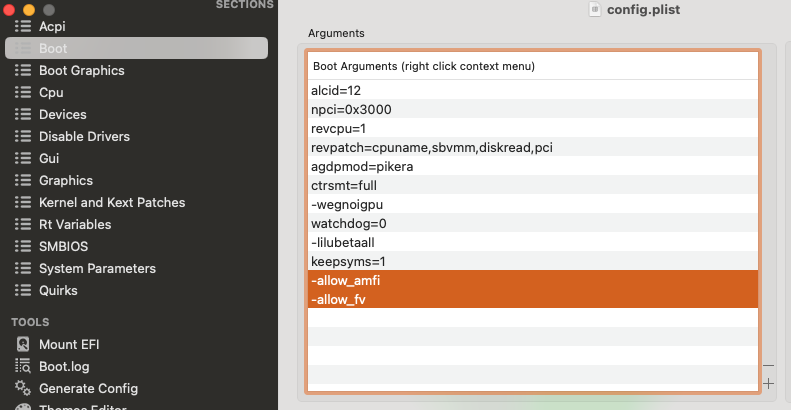

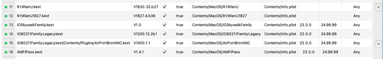

Max.1974 Posted July 3, 2025 Share Posted July 3, 2025 3 hours ago, webipsum said: @Max.1974 Is this yours and is it working? I noticed that the printed information is the same as my TL-WN725N. Tks. EDIT 1: Newbie question: do I need the kext or just OCLP-Mod? . @webipsum Yes my friend, its the motive that im test it, its the same. Put AMFIpass.kext and boot args. Need check IOSUB to on OCLP-Mod Menu. Works with Clover 5162 and Wireless app for Clover. AMFIPass.kext.zip With Cover need install this app: https://github.com/chris1111/Clover-OCLP/releases/tag/V2 3 Link to comment https://www.insanelymac.com/forum/topic/361162-pre-release-macos-tahoe/page/83/#findComment-2835861 Share on other sites More sharing options...

robi62 Posted July 3, 2025 Share Posted July 3, 2025 (edited) 1 hour ago, Perdu said: I think I've done everything...thanks Hide contents Hi you cannot load the Wlan kext from OC You need to install them with chris111 wifi app. Edited July 3, 2025 by robi62 Link to comment https://www.insanelymac.com/forum/topic/361162-pre-release-macos-tahoe/page/83/#findComment-2835870 Share on other sites More sharing options...

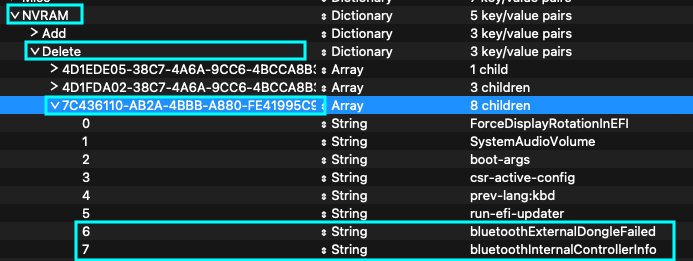

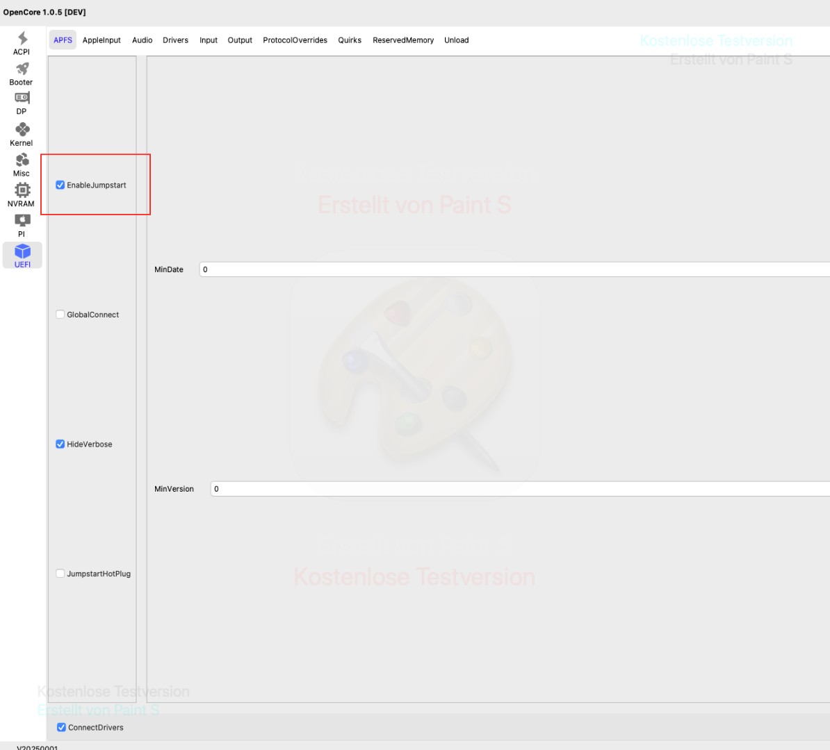

Max.1974 Posted July 3, 2025 Share Posted July 3, 2025 53 minutes ago, Moviemakergr said: Yes bro , i try to use only intel Hi brother, try use this configurations the I saw in German forum WWDC 2025, MACOS 26 E HACKINTOSH 1 Link to comment https://www.insanelymac.com/forum/topic/361162-pre-release-macos-tahoe/page/83/#findComment-2835873 Share on other sites More sharing options...
Moviemakergr Posted July 3, 2025 Share Posted July 3, 2025 (edited) Thank you @max for looking for me. I've tried it and it doesn't work. 😇 Edited July 3, 2025 by Moviemakergr 1 Link to comment https://www.insanelymac.com/forum/topic/361162-pre-release-macos-tahoe/page/83/#findComment-2835874 Share on other sites More sharing options...

robi62 Posted July 3, 2025 Share Posted July 3, 2025 (edited) 44 minutes ago, Perdu said: yes I used the kriss app but it creates another efi with the Wlan kexts, so I added them to my efi and deleted the other one Hi they do not load with opencore they need to be in library/Extensions Im pretty sure about it. Edited July 3, 2025 by robi62 1 Link to comment https://www.insanelymac.com/forum/topic/361162-pre-release-macos-tahoe/page/83/#findComment-2835876 Share on other sites More sharing options...
chris1111 Posted July 3, 2025 Share Posted July 3, 2025 (edited) 57 minutes ago, Perdu said: yes I used the kriss app but it creates another efi with the Wlan kexts, so I added them to my efi and deleted the other one I does not create efi the utility installed the kext in the current efi partition drive 19 minutes ago, robi62 said: Hi they do not load with opencore they need to be in library/Extensions Im pretty sure about it. Yes it load from OC I post a successful test yesterday ! it also load in /Library/Extensions with the required program. You can not using both Edited July 3, 2025 by chris1111 4 1 Link to comment https://www.insanelymac.com/forum/topic/361162-pre-release-macos-tahoe/page/83/#findComment-2835877 Share on other sites More sharing options...

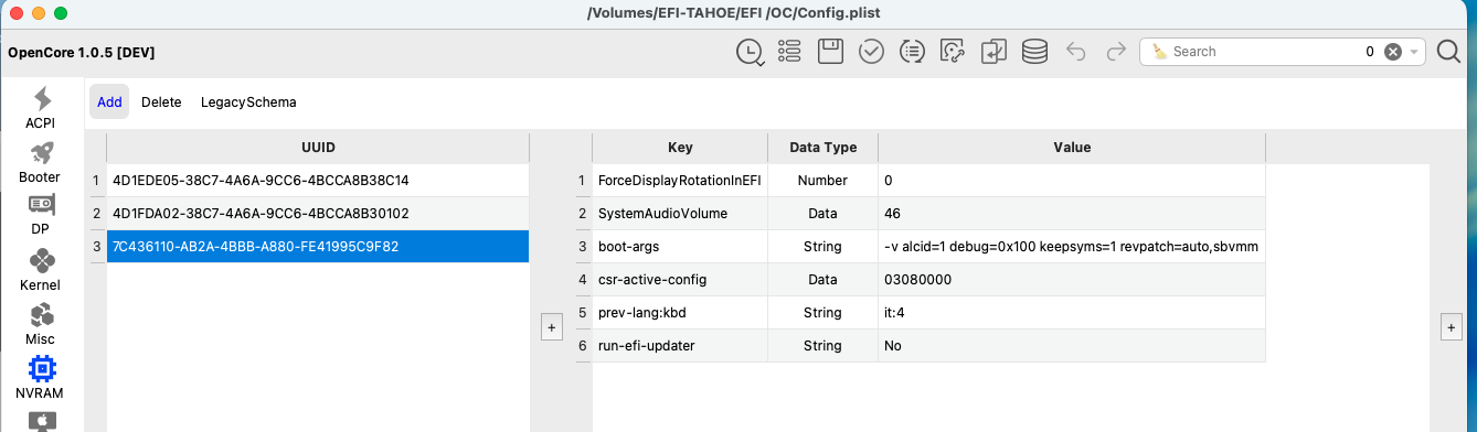

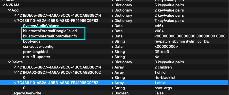

Montblanc Posted July 3, 2025 Share Posted July 3, 2025 2 hours ago, Moviemakergr said: Has anyone managed to get Intel's built-in bluetooth to work? Wi_Fi working but no ΒΤ on me (Z790 AORUS ELITE AX) Had the same problem with my Z590 Aorus Tachyon with built-in Intel AX210. Finally got it working with this config.plist (serials, etc removed) config.plist 4 Link to comment https://www.insanelymac.com/forum/topic/361162-pre-release-macos-tahoe/page/83/#findComment-2835878 Share on other sites More sharing options...
Moviemakergr Posted July 3, 2025 Share Posted July 3, 2025 (edited) 1 hour ago, Max.1974 said: Oh my brother — there shouldn't be any reason for it not to work. Try recompiling your kexts, or check for updates. Maybe @lorys89 has the solution. 58 minutes ago, Montblanc said: Had the same problem with my Z590 Aorus Tachyon with built-in Intel AX210. Finally got it working with this config.plist (serials, etc removed) config.plist 65.46 kB · 7 downloads Thank you both very much. I recompiling my kexts,and compare the config's and now works 💥 Edited July 3, 2025 by Moviemakergr 4 1 Link to comment https://www.insanelymac.com/forum/topic/361162-pre-release-macos-tahoe/page/83/#findComment-2835879 Share on other sites More sharing options...
