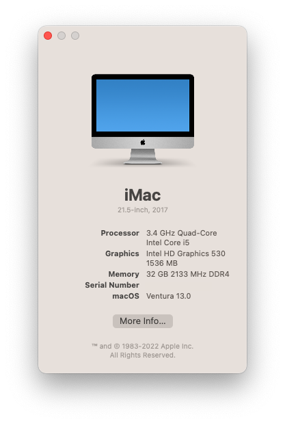

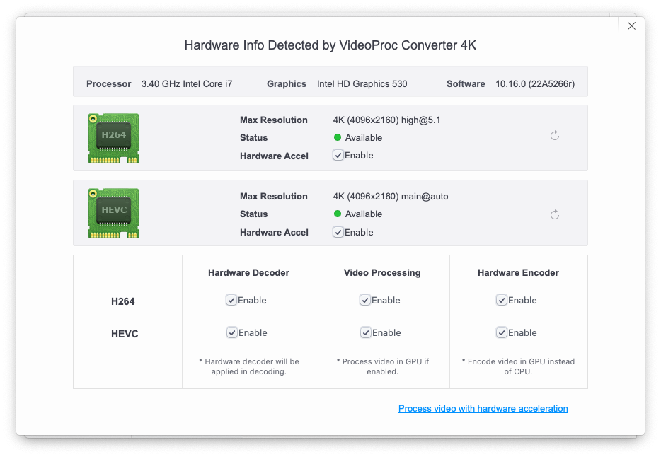

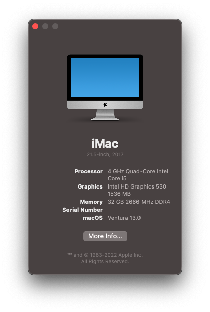

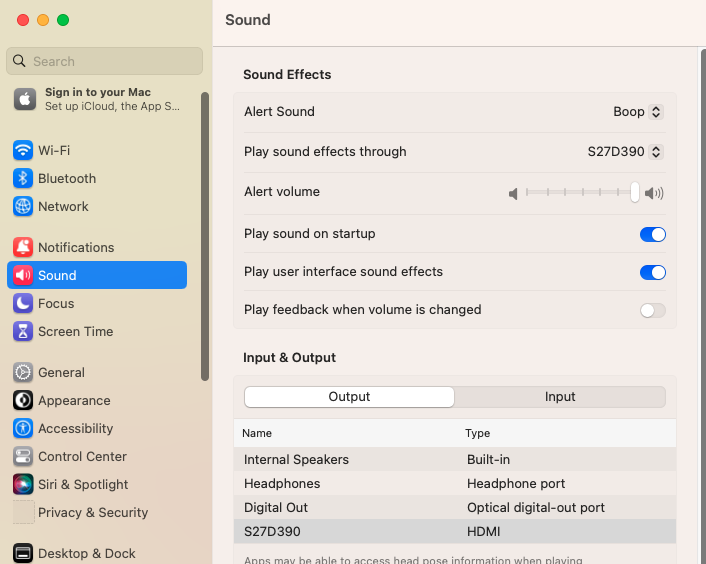

5 hours ago, jsl2000 said:
Thanks for your help and attached files which enable HEVC now !
But DP audio still missing.
My config.plist is attached here for your reference. You need the newest OpenCore 0.8.2 from related post in this topic.
https://dortania.github.io/builds/?product=OpenCorePkg&viewall=true
DP/HDMI Audio requires a correct framebuffer patching.
4 hours ago, Hervé said:
DP audio working on my Skylake Latitude E7270 laptop. I used my usual DP-to-HDMI adapter and TV registered against con1 connector which is patched for HDMI type 00080000.
Bingo!
3 hours ago, aben said:
Yes! That is indeed how I approached the HEVC test - retained all IOGVAxxxx (enc/dec) values from KBL (incl. Gen95) while omitting IOGVAXDecode for VP9 fix :) Works great, no issues seen so far, with HEVC as well.
I believe this rollback should sort out all codec hw acceleration supported on SKL.
