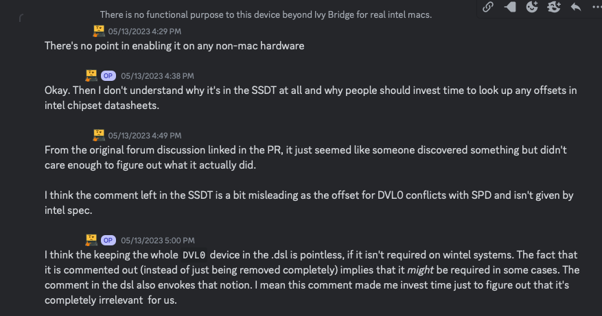

2 hours ago, cankiulascmnfye said:
Based on your discord discussion, it appears that we should NOT add Device DVL0 in SBUS.BUS0.

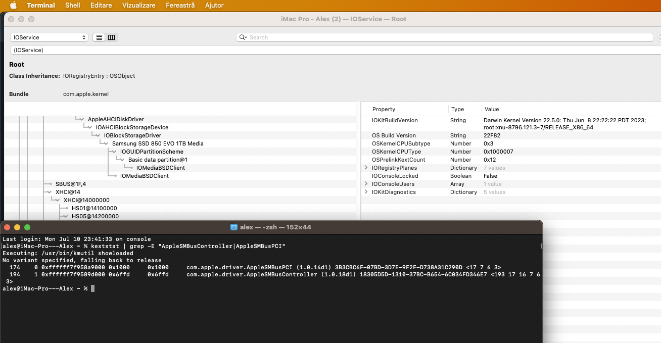

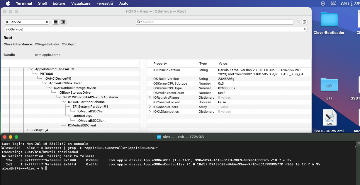

I took out DVL0 in all my rigs and kextstat | grep -E "AppleSMBusController|AppleSMBusPCI" give the right answer. Just in one, don't remember wich, I need to keep DVL0.

@Stefanalmare I wonder if this will be another topic with as many opinions as contributors. @cankiulascmnfye 's discord discussion says that DVL0 should not be installed on any non-mac hardware.
@deeveedee I think SBUS is very important in a hack. Can be a topic discussion. Speaking about "should not be installed", I remember that without DVL0 in that rig, com.apple.driver.AppleSMBusController does not load. So, I keep it.

Run: kextstat | grep -E "AppleSMBusController|AppleSMBusPCI"
And if you have this:
You good to go.

H370:
Spoiler
z690:
Spoiler
Edited by Stefanalmare

I don't use any SSDT-SBUS and also have the 2 kexts loaded and the device SBUS@1F,4 in IOReg. Monterey and Sonoma.
Edited by miliuco

Well, SBUS and MCHC are important so that the System Management bus works but not DVL0 which is the "Diagsvault". More info: https://github.com/acidanthera/OpenCorePkg/pull/442

From the info I could gather om github, it's only important that Sbus is present in IOReg.
Now, if you don't inject SBUS-MCHC into the system and run
And get com.apple.driver.AppleSMBusPCI (1.0.14d1) … you're should be fine
If yu inject SSBU-MCHC containing the DVL0 device, you get 2 results in return – simply because of the DVL0 device is attached to the SMBUS:
…   com.apple.driver.AppleSMBusPCI (1.0.14d1)…
…   com.apple.driver.AppleSMBusController (1.0.18d1) …
From my understanding the real Diagsvault device needs to be able wo write to addresses which are disabled by default since Intel 7 Series. So there's no point in injecting DVL0 on Wintel systems. In my case. I only have to inject SSDT-MCHC to get both results.

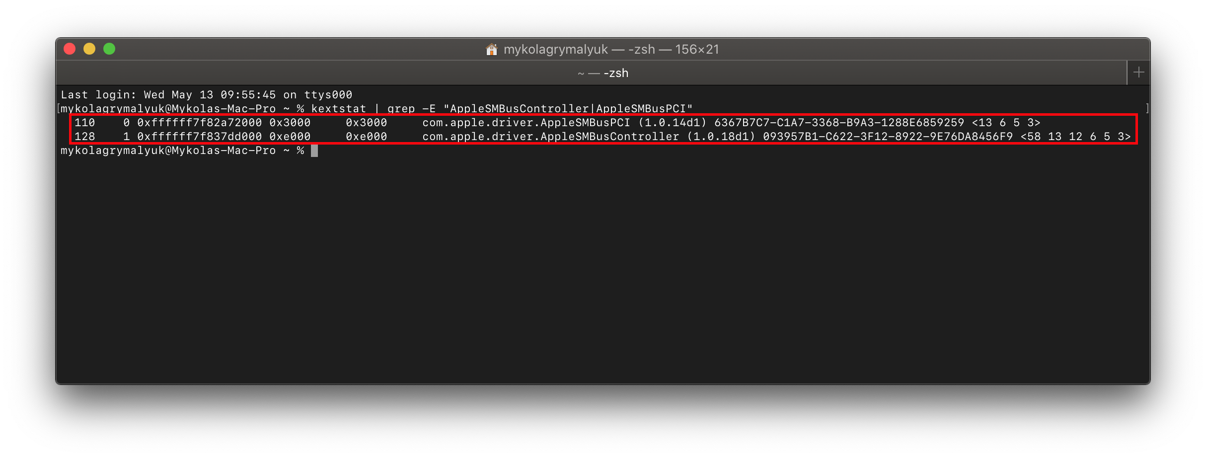

Thanks @deeveedee just to confirm to everyone else here too, that I also disabled completely the SSDT-SBUS.aml in OpenCore config on my NUC10i7FNH (Core i7-8700B @ 3.20 GHz) declared as MacMini8,1 and rebooted. Even let it sleep. I still get both kexts being active on Ventura; but indeed on IOReg, there's no longer a tree under device SBUS. My device is according to "lspci -nn" 00:1f.4 SMBus [0c05]: Intel Corporation Comet Lake SMBus Host Controller [8086:02a3]
$ kextstat | grep -E "AppleSMBusController|AppleSMBusPCI"
Executing: /usr/bin/kmutil showloaded
No variant specified, falling back to release
  157    0 0xffffff7f958a9000 0x1000     0x1000     com.apple.driver.AppleSMBusPCI (1.0.14d1) 3B3CBC6F-07BD-3D7E-9F2F-D738A31C290D <17 7 6 3>
  165    1 0xffffff7f9589d000 0x6ffd     0x6ffd     com.apple.driver.AppleSMBusController (1.0.18d1) 18305D5D-1310-37BC-B654-6C034FD346E7 <164 17 16 7 6 3>
I will keep using it and see if I detect anything noticeable. Thanks to everyone.
