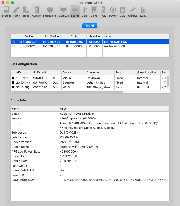

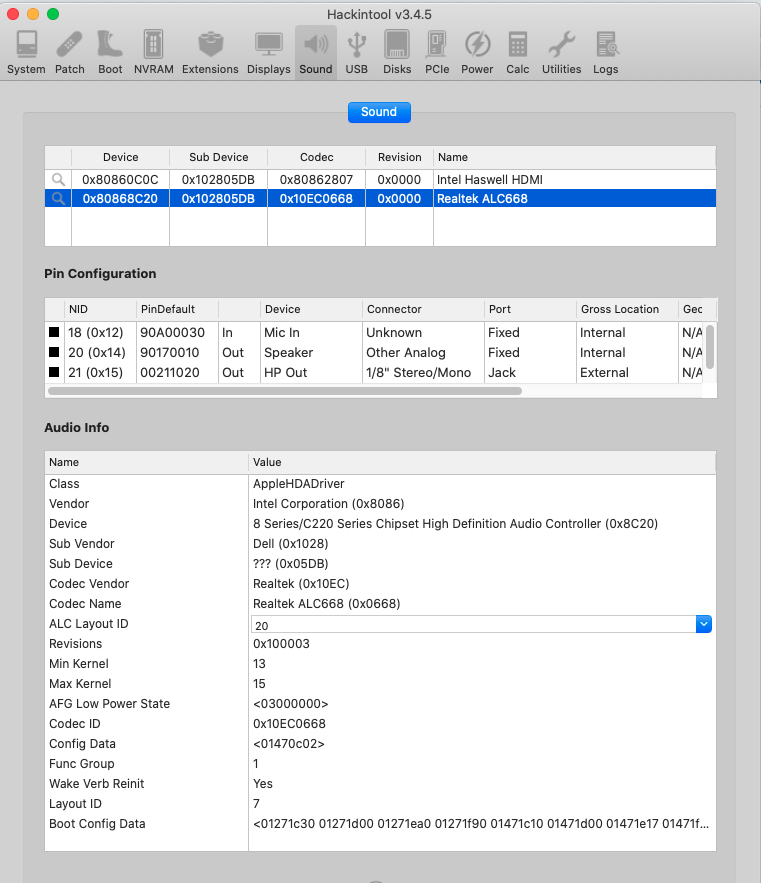

AlvinGenius Posted October 14, 2020 Share Posted October 14, 2020 Hello I've AIO PC - Dell inspiron 2350 and I've installed Catalina 10.15.17 using OPENCORE 0.6.2 debug version and everything is going good with drivers Audio: ALC668 - Working ( working alc Layout id: 20 ) iGPU: HD4600 - Working Ethernet: RTL 8111 - Working Bluetooth: Working Wireless: Not working Touch screen: Not working So I'm trying to enable Boot-chime with AudioDxe as explained here So, after following this tuts and after the first restart of the pc it hangs for about 1:45 minute on this screen PS : if I removed AudioDxe driver this screen ^ loads in less than a second then boot to os Then it loads normally to the OS But No Boot Chime Sound After checking opencore debug file I found this part 106:823 00:001 OCAU: System volume is 68 (calculated from 48) - Success 106:824 00:001 OCAU: Matching PciRoot(0x0)/Pci(0x1B,0x0)/VenMsg(A9003FEB-D806-41DB-A491-5405FEEF46C3,00000000)... 106:825 00:001 OCAU: 1/1 PciRoot(0x0)/Pci(0x3,0x0)/VenMsg(A9003FEB-D806-41DB-A491-5405FEEF46C3,00000000) (0 outputs) - Success 106:826 00:001 OCAU: Cannot find specified audio device - Not Found 106:827 00:001 OC: Audio connection failed - Not Found So I've no clue what to do next !!! I'm attaching a Screenshot from config.plist and IORegistryExplorer and gfxutility side by side showing why I'm choosing this edits PS: I've tried AudioOut 0,1,2,3 - same results And also I'm attaching config.plist file and opencore-2020-10-14-090509.txt debug file So... what I miss here !!!!? Thanks, Link to comment https://www.insanelymac.com/forum/topic/350754-opencore-general-discussion/page/249/#findComment-2740329 Share on other sites More sharing options...

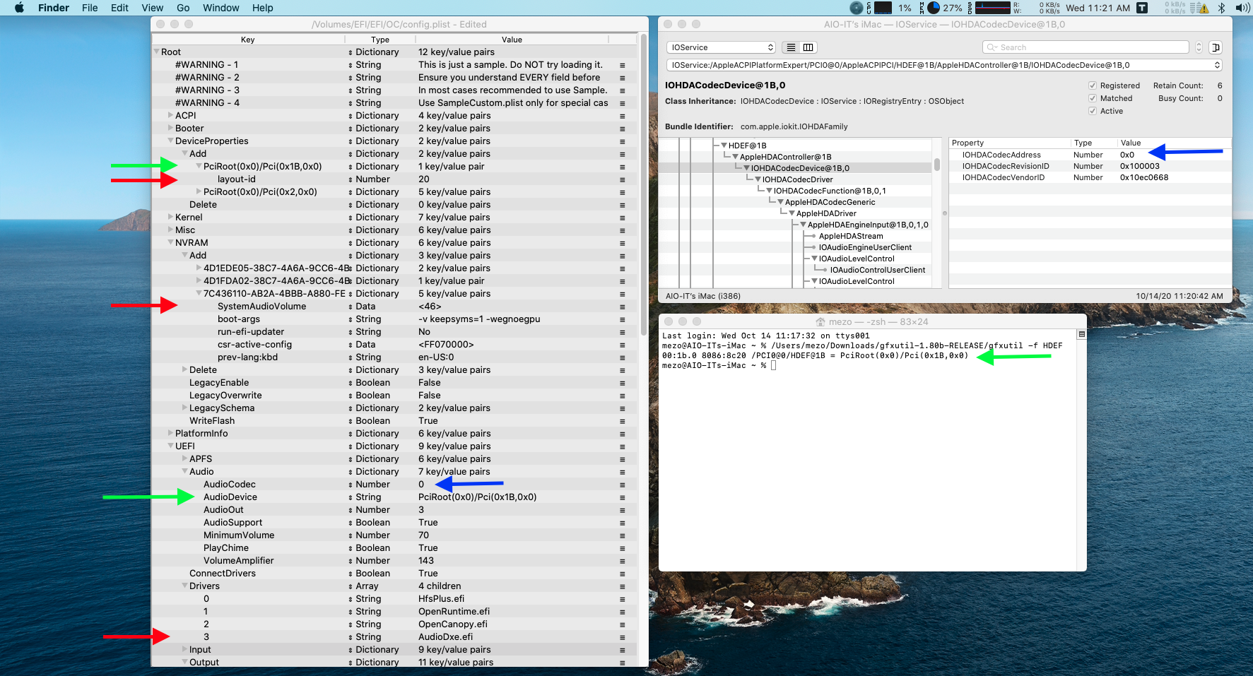

AlvinGenius Posted October 14, 2020 Share Posted October 14, 2020 2 hours ago, eSaF said: @AlvinGenius I have looked at your config.plist and made a few suggestion with this pic, take a look and hope it helps. Reveal hidden contents Hello @eSaf Thanks for your reply and I'm attaching SS from Hackintool. and regarding ur suggestions, DONE Please check them and let me know where's the issue! Thanks Link to comment https://www.insanelymac.com/forum/topic/350754-opencore-general-discussion/page/249/#findComment-2740341 Share on other sites More sharing options...

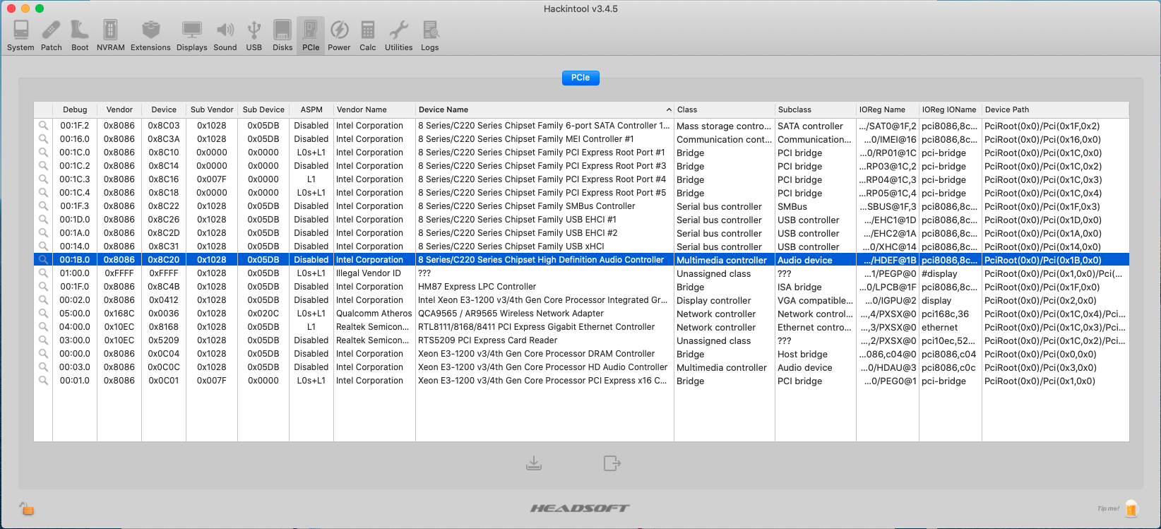

AlvinGenius Posted October 14, 2020 Share Posted October 14, 2020 (edited) 2 hours ago, eSaF said: @AlvinGenius - That is strange, your PCIe entry is correct as shown in your pic, but having another look at your config.plist I noticed a possible error as shown in this pic. Change the value I indicated to 0 (zero) save the change, reboot and clean the NVRAM and hopefully should be fixed along with my earlier recommendations. Let me know how it goes. Good luck. PS Turn your volume down before you restart incase you blow your speakers. Hello @eSaF Thanks again for your reply But I've said that already in my thread, I've tried 0,1,2 and 3 with no luck I might have an clue what's wrong here !! in config.plist I'm only using HD4600 iGPU, and this PC have a dGPU: AMD Radeon HD 8690A So i've used the the other multimedia controller HDAE Device path that I found in Hackintool and put it in config.plist> UFEI > Audio > AudioDevice and added it too in DeviceProperties section using Open Configurator!! and I made a restart and still stuck at this watchdog debug screen for 1 min and no Boot sound, and when I checked the opencore debug txt file I didn't found the "Audio connection failed - not found " error so maybe the boot chime audio should go through dGPU that's why I stuck in watchdog debug and no sound ! Edited October 14, 2020 by AlvinGenius Link to comment https://www.insanelymac.com/forum/topic/350754-opencore-general-discussion/page/249/#findComment-2740430 Share on other sites More sharing options...

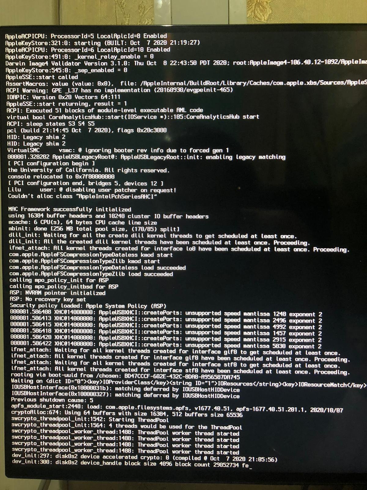

Mike Ranger Posted October 16, 2020 Share Posted October 16, 2020 Hi... with the latest Developer Beta 10, after the the reboot during installation I get the following KP: panic(cpu 0 caller 0xffffff80192bd8ea): "Rooting from the live fs of a sealed volume is not allowed on a RELEASE build\n"@/AppleInternal/BuildRoot/Library/Caches/com.apple.xbs/Sources/apfs/apfs-1677.40.51.201.1/kext/apfs_vfsops.c:2011 Backtrace (CPU 0), Frame : Return Address 0xffffffa08fc6ae20 : 0xffffff80162b666d mach_kernel : _handle_debugger_trap + 0x3dd 0xffffffa08fc6ae70 : 0xffffff80163f8f93 mach_kernel : _kdp_i386_trap + 0x143 0xffffffa08fc6aeb0 : 0xffffff80163e95ca mach_kernel : _kernel_trap + 0x55a 0xffffffa08fc6af00 : 0xffffff801a00e924 as.vit9696.VirtualSMC : __ZN18VirtualSMCProvider10kernelTrapI22x86_saved_state_1010_tEEvPT_Pm + 0x454 0xffffffa08fc6af80 : 0xffffff801625ba2f mach_kernel : _return_from_trap + 0xff 0xffffffa08fc6afa0 : 0xffffff80162b5f0d mach_kernel : _DebuggerTrapWithState + 0xad 0xffffffa08fc6b0c0 : 0xffffff80162b61f8 mach_kernel : _panic_trap_to_debugger + 0x268 0xffffffa08fc6b130 : 0xffffff8016ab792a mach_kernel : _panic + 0x54 0xffffffa08fc6b1a0 : 0xffffff80192bd8ea com.apple.filesystems.apfs : _apfs_vfsop_mount + 0x339b 0xffffffa08fc6b990 : 0xffffff80192c6d70 com.apple.filesystems.apfs : _apfs_vfsop_mountroot + 0x3d 0xffffffa08fc6b9c0 : 0xffffff801653cb20 mach_kernel : _vfs_mountroot + 0x140 0xffffffa08fc6bb40 : 0xffffff80167f9883 mach_kernel : _set_rootvnode + 0x3c53 0xffffffa08fc6be70 : 0xffffff80162e3e83 mach_kernel : _max_valid_stack_address + 0xdf3 0xffffffa08fc6bfa0 : 0xffffff801625b13e mach_kernel : _call_continuation + 0x2e Kernel Extensions in backtrace: as.vit9696.VirtualSMC(1.1.8)[7BBAC837-0013-398A-BBEE-6BF8DD81C31B]@0xffffff8019fff000->0xffffff801a025fff dependency: as.vit9696.Lilu(1.4.9)[AC8A0C7F-6FCC-3F6A-9A82-96789EEDE7B5]@0xffffff8019f79000->0xffffff8019ffcfff dependency: com.apple.iokit.IOACPIFamily(1.4)[F42E4E8D-BBE9-37B7-A3A4-9D9641BBB848]@0xffffff80186aa000->0xffffff80186abfff com.apple.filesystems.apfs(1677.40.51)[82FE49D0-2A08-3128-B5A7-D0D3BF99D28D]@0xffffff8019243000->0xffffff80193a6fff dependency: com.apple.driver.AppleEFINVRAM(2.1)[AB65643D-1BE4-35C1-B566-2898844DADE0]@0xffffff8017634000->0xffffff801763dfff dependency: com.apple.driver.AppleEffaceableStorage(1.0)[7A75BFCC-F40A-3991-8D3D-BA843F37A7F8]@0xffffff8017647000->0xffffff801764cfff dependency: com.apple.iokit.CoreAnalyticsFamily(1)[B69C1AF1-494E-3321-B1FE-1EC42C6F2A5E]@0xffffff8017a82000->0xffffff8017a88fff dependency: com.apple.iokit.IOStorageFamily(2.1)[63B7DD4D-C3CC-311C-9FD7-30032779F1F8]@0xffffff8018d0f000->0xffffff8018d20fff dependency: com.apple.kec.corecrypto(1.0)[B1A179FD-27C2-3F5B-A97B-267774ECA9DF]@0xffffff80193d4000->0xffffff8019460fff dependency: com.apple.security.AppleImage4(3.0.0)[9F4F723F-52EE-3B0F-AB02-9755CCEB7DF7]@0xffffff80176a9000->0xffffff80176b8fff Process name corresponding to current thread: kernel_task Boot args: keepsyms=1 debug=0x100 npci=0x2000 -v agdpmod=pikera -bsdmgroot chunklist-security-epoch=0 -chunklist-no-rev2-dev Mac OS version: Not yet set Kernel version: Darwin Kernel Version 20.1.0: Wed Oct 7 21:17:40 PDT 2020; root:xnu-7195.40.137.201.1~1/RELEASE_X86_64 Kernel UUID: D5AE727A-F8F2-31EE-B874-4E907B0C5115 KernelCache slide: 0x0000000016000000 KernelCache base: 0xffffff8016200000 Kernel slide: 0x0000000016010000 Kernel text base: 0xffffff8016210000 __HIB text base: 0xffffff8016100000 System model name: iMacPro1,1 (Mac-7BA5B2D9E42DDD94) System shutdown begun: NO Panic diags file unavailable, panic occurred prior to initialization Hibernation exit count: 0 System uptime in nanoseconds: 9406301602 Last Sleep: absolute base_tsc base_nano Uptime : 0x00000002346808ff Sleep : 0x0000000000000000 0x0000000000000000 0x0000000000000000 Wake : 0x0000000000000000 0x000017a143d7e380 0x0000000000000000 Not really sure what is going on. Beta 9 was working fine. Regards, Mike Link to comment https://www.insanelymac.com/forum/topic/350754-opencore-general-discussion/page/249/#findComment-2740810 Share on other sites More sharing options...
Mike Ranger Posted October 16, 2020 Share Posted October 16, 2020 @eSaF: many thanks, that worked out perfectly. Best, Mike 1 Link to comment https://www.insanelymac.com/forum/topic/350754-opencore-general-discussion/page/249/#findComment-2740819 Share on other sites More sharing options...
