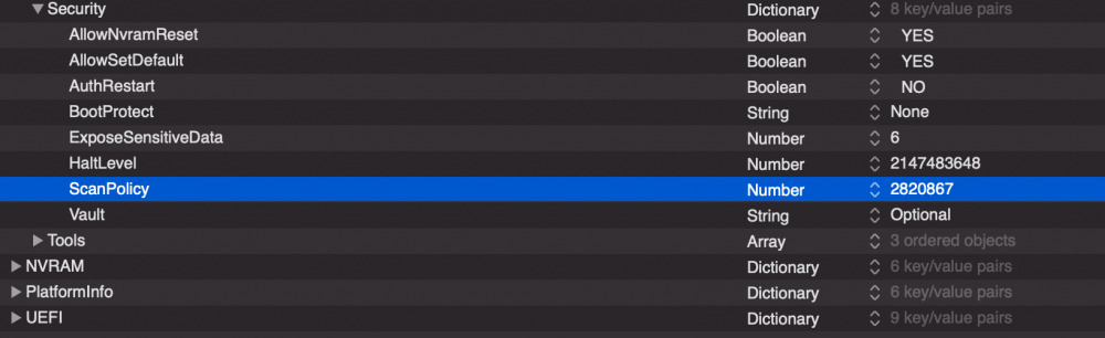

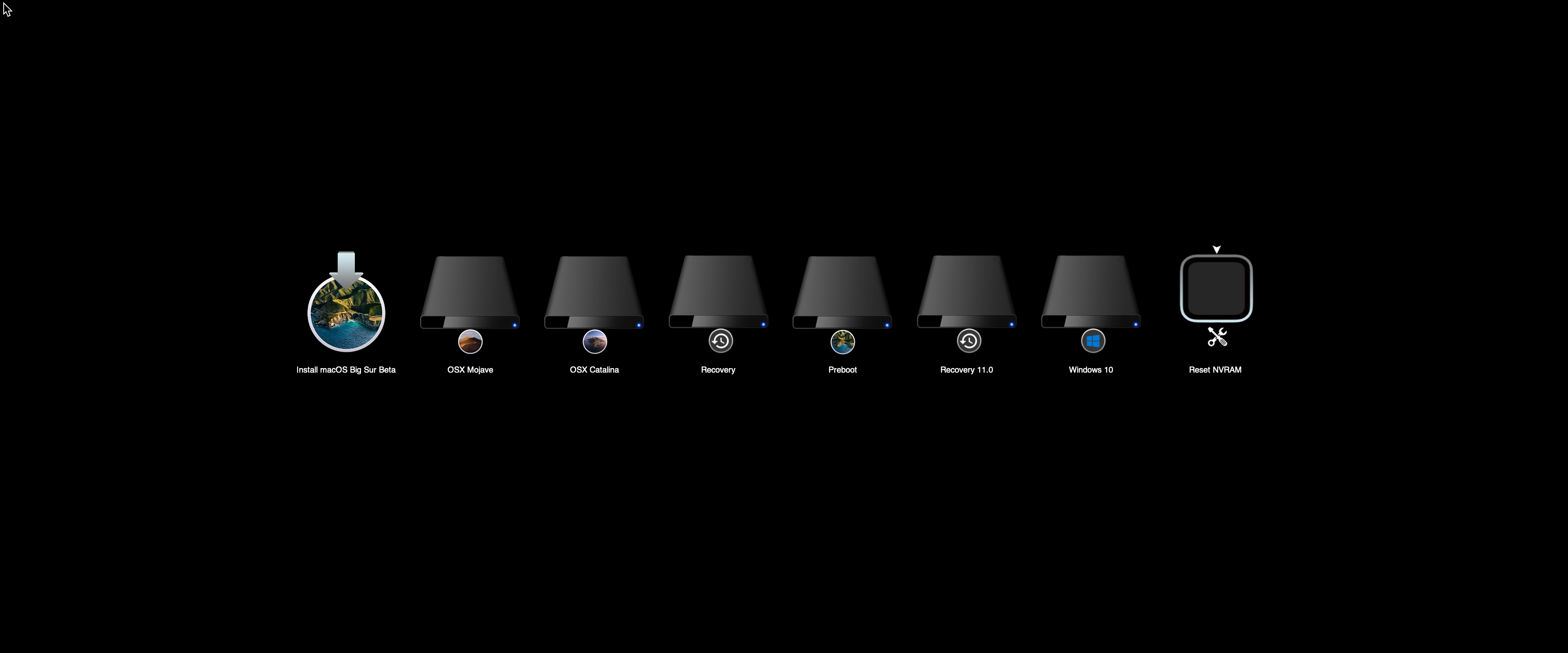

Ellybz Posted September 25, 2020 Share Posted September 25, 2020 (edited) 6 hours ago, chris1111 said: Thanks @obus Try that EFI Partition is show again; windows is visible that's ok @Ellybz 2820867 EFI is hide but also windows and USB installer That is extremely odd. This is what I have with ScanPolicy 2820867. Everything works as intended. ( USB, Windows, etc..) Have you tried with PickerMode "Builtin"? Maybe it's an Icon/OpenCanopy issue? Are you using Windows OS in a separate drive or with Bootcamp? I have windows in a separate drive. If you're not using bootcamp, I highly suggest to add a custom entry for Windows. PS: I forgot to fix that "Preboot" name entry, easy fix. In my system I also deleted the recovery partition from Mojave. Too many recovery entries IMO. Edited September 25, 2020 by Ellybz 4 Link to comment https://www.insanelymac.com/forum/topic/350754-opencore-general-discussion/page/246/#findComment-2738393 Share on other sites More sharing options...
chris1111 Posted September 25, 2020 Share Posted September 25, 2020 2 hours ago, Ellybz said: That is extremely odd. This is what I have with ScanPolicy 2820867. Everything works as intended. ( USB, Windows, etc..) Have you tried with PickerMode "Builtin"? Maybe it's an Icon/OpenCanopy issue? Are you using Windows OS in a separate drive or with Bootcamp? I have windows in a separate drive. If you're not using bootcamp, I highly suggest to add a custom entry for Windows. PS: I forgot to fix that "Preboot" name entry, easy fix. In my system I also deleted the recovery partition from Mojave. Too many recovery entries IMO. Thank you I don't use bootcamp my windows 10 is installed in UEFI on a 250 g SSD separate I will do another more in-depth test but I find it very complicated to simply hide or see partitions Link to comment https://www.insanelymac.com/forum/topic/350754-opencore-general-discussion/page/246/#findComment-2738400 Share on other sites More sharing options...
Ellybz Posted September 25, 2020 Share Posted September 25, 2020 25 minutes ago, chris1111 said: Thank you I don't use bootcamp my windows 10 is installed in UEFI on a 250 g SSD separate I will do another more in-depth test but I find it very complicated to simply hide or see partitions I sent you a PM. Link to comment https://www.insanelymac.com/forum/topic/350754-opencore-general-discussion/page/246/#findComment-2738408 Share on other sites More sharing options...

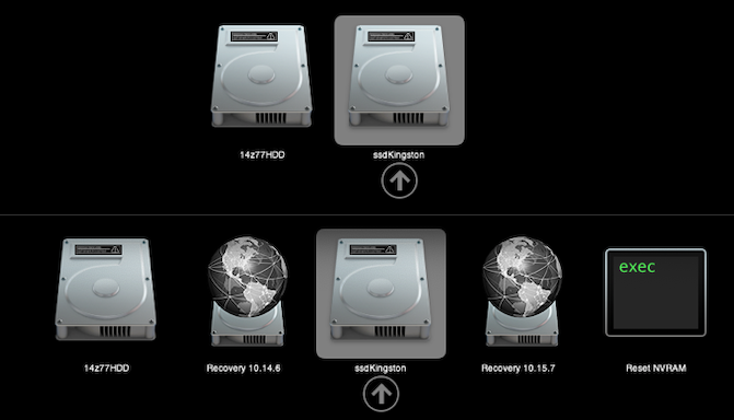

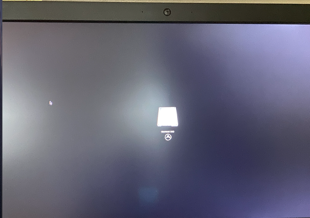

luky35 Posted September 26, 2020 Share Posted September 26, 2020 I have installed Catalina 10.15.7. The Efi OC start menu only shows me the Macintosh SSD boot disk icon. No Recovery and no Tools icons? Spoiler 1 Link to comment https://www.insanelymac.com/forum/topic/350754-opencore-general-discussion/page/246/#findComment-2738434 Share on other sites More sharing options...
droples Posted September 26, 2020 Share Posted September 26, 2020 (edited) 1 hour ago, luky35 said: I have installed Catalina 10.15.7. The Efi OC start menu only shows me the Macintosh SSD boot disk icon. No Recovery and no Tools icons? Reveal hidden contents These are not OC issues. See your config. Maybe you should press the magic key Edited September 26, 2020 by droples 2 Link to comment https://www.insanelymac.com/forum/topic/350754-opencore-general-discussion/page/246/#findComment-2738438 Share on other sites More sharing options...
luky35 Posted September 26, 2020 Share Posted September 26, 2020 16 minutes ago, droples said: Thanks. Link to comment https://www.insanelymac.com/forum/topic/350754-opencore-general-discussion/page/246/#findComment-2738439 Share on other sites More sharing options...

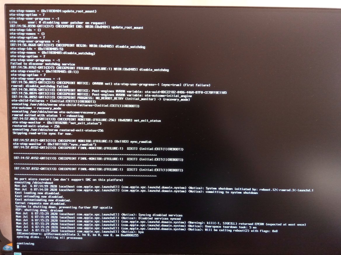

Emanuele-1998 Posted September 27, 2020 Share Posted September 27, 2020 On 7/6/2020 at 9:59 AM, ghost8282 said: Greetings to all! I'm seeing that things are moving faster with kernel collection and kext injection, after spending the whole day yesterday trying to install (install, not restore) big sur on qemu without success, I tried again today, since I saw that the work is still in development (as always) and some commits were added, to lilu too. Kernel patching and kext injection seem to work, apart from manually pointing the boot picker after the first and second reboot I'm able to have the installation screen to show and proceed. I'm stuck after the second reboot, when you choose to boot from "Preboot", with "No port micro restart (we don't support SMC on this platform)": after this it reboots and loops. I will follow the progress on github, I don't know if you are already aware of the issue and/or if you have a solution or not, just to report my trials. On another chinese forum a user said he solved the issue by pointing oc to clover, pointing to mac os (???????????) --> I don't like it at all. (edited, as it's a non sense..) Thanks for your hard work, you are the best! I have the same error as the post, with the new build of Lilu 1.4.6+ and VirtualSMC 1.1.5+ the bootargs vmscgen = 1, no longer needed. I'm upgrading to Big Sur beta 8 @Andrey1970 1 Link to comment https://www.insanelymac.com/forum/topic/350754-opencore-general-discussion/page/246/#findComment-2738552 Share on other sites More sharing options...

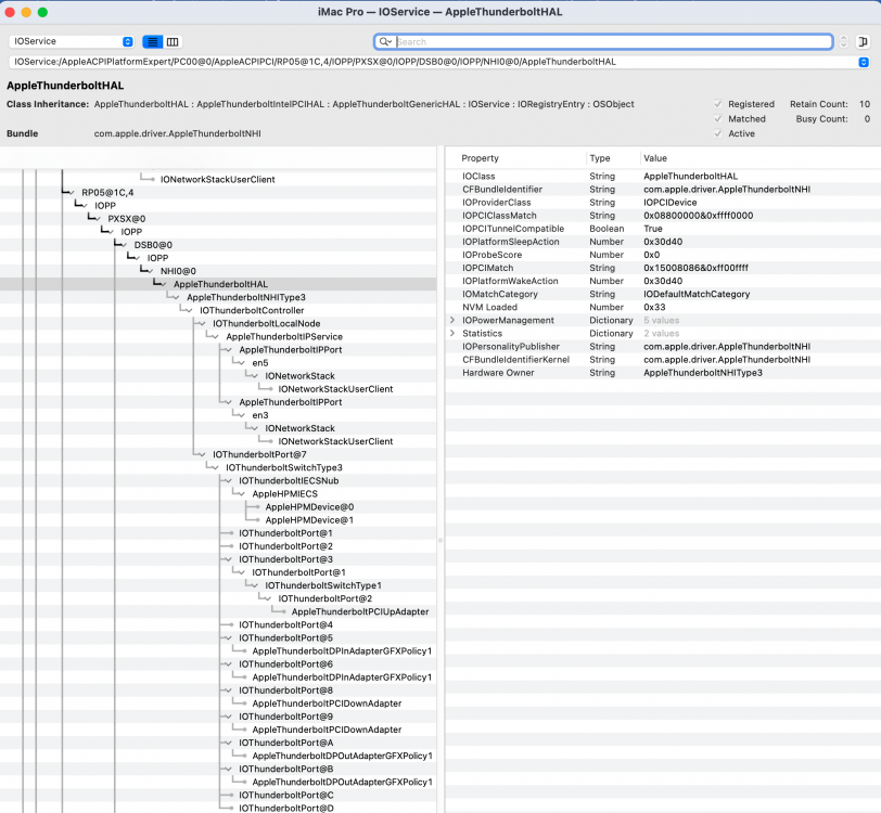

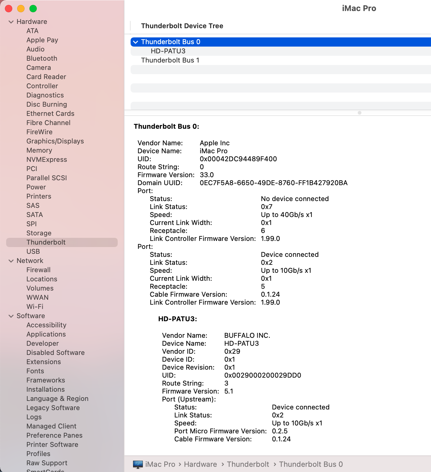

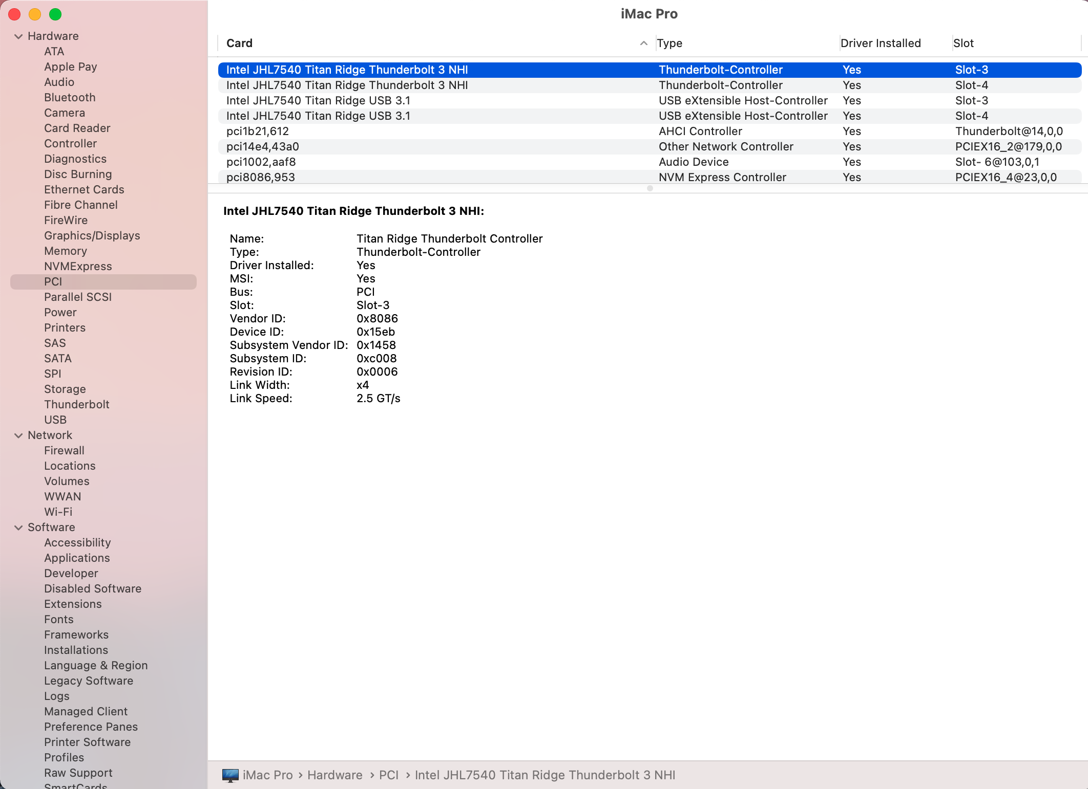

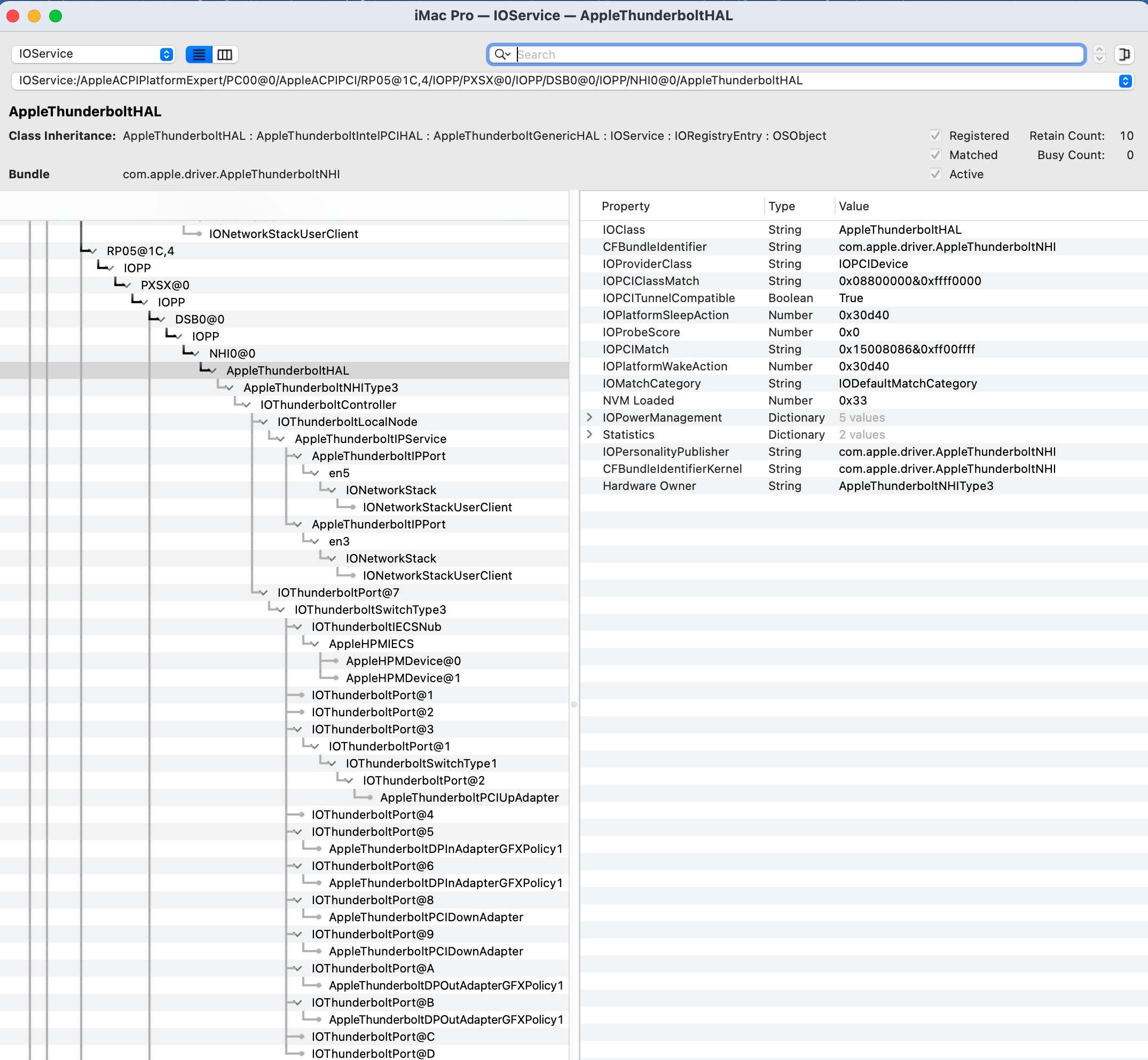

obus Posted September 27, 2020 Share Posted September 27, 2020 (edited) Could anybody out there tell me if it's possible to boot macOS from a connected thunderbolt drive with OpenCore? Has two GC-TITAN RIDGE card with flashed @DSM2 firmware (https://forums.macrumors.com/threads/testing-tb3-aic-with-mp-5-1.2143042/page-37?post=28291766#post-28291766 ) Booting from the same external thunderbolt disk is working perfect on my MacBookPro. Spoiler OpenCore does not detect the disk in BootPicker. Drivers are loaded according to system preferences and the disk is showing up in "Startup disk" as a bootable disk. Is it something with ScanPolicy settings or could it be a driver problem? Any ideas? Edited September 27, 2020 by obus 1 Link to comment https://www.insanelymac.com/forum/topic/350754-opencore-general-discussion/page/246/#findComment-2738580 Share on other sites More sharing options...

obus Posted September 28, 2020 Share Posted September 28, 2020 (edited) 8 hours ago, meaganmargaret said: I guess you could say maybe I'm booting via USB, but the drive is directly connected via an Apple TB cable to a TB port on the Titan Ridge, and it, and other drives connected this way boot just fine. Is your boot disk listed here? If soo you are booting trough USB 3.1. Spoiler Edited September 28, 2020 by obus Link to comment https://www.insanelymac.com/forum/topic/350754-opencore-general-discussion/page/246/#findComment-2738630 Share on other sites More sharing options...
joevt Posted September 28, 2020 Share Posted September 28, 2020 20 hours ago, obus said: Could anybody out there tell me if it's possible to boot macOS from a connected thunderbolt drive with OpenCore? Has two GC-TITAN RIDGE card with flashed @DSM2 firmware (https://forums.macrumors.com/threads/testing-tb3-aic-with-mp-5-1.2143042/page-37?post=28291766#post-28291766 ) Booting from the same external thunderbolt disk is working perfect on my MacBookPro. Reveal hidden contents OpenCore does not detect the disk in BootPicker. Drivers are loaded according to system preferences and the disk is showing up in "Startup disk" as a bootable disk. Is it something with ScanPolicy settings or could it be a driver problem? Any ideas? In the EFI Shell, does the NVMe or SATA or whatever controller that is in the Thunderbolt drive exist in the list of PCI devices? If not, then you need some different BIOS settings or a new EFI Thunderbolt driver that someone would have to create. It's possible the flashed ROM that makes it work better for macOS stops it from working with EFI or Windows. 15 hours ago, meaganmargaret said: Hmm......maybe I'm not understanding, but I can boot macOS from my TB Titan Ridge with OC - the drive is in a 10G USB adapter and connected directly to a TB port on the Titan Ridge. Just as an aside, I tried flashing my TR card, but didn't like the result so I flashed it back to factory. So, my TB card is not flashed, and it's been at factory for quite a while now. I do have some settings set in the Asus bios to make sure the Thunderbolt Titan Ridge can boot external drives. I guess you could say maybe I'm booting via USB, but the drive is directly connected via an Apple TB cable to a TB port on the Titan Ridge, and it, and other drives connected this way boot just fine. I boot this way all the time - this is the way I boot into my Big Sur install, for instance. You are talking about USB. The USB controller of an unflashed Thunderbolt controller usually works fine. Booting from a Thunderbolt drive requires PCI enumeration of the connected Thunderbolt devices while in EFI which may require some new EFI code. 1 Link to comment https://www.insanelymac.com/forum/topic/350754-opencore-general-discussion/page/246/#findComment-2738678 Share on other sites More sharing options...

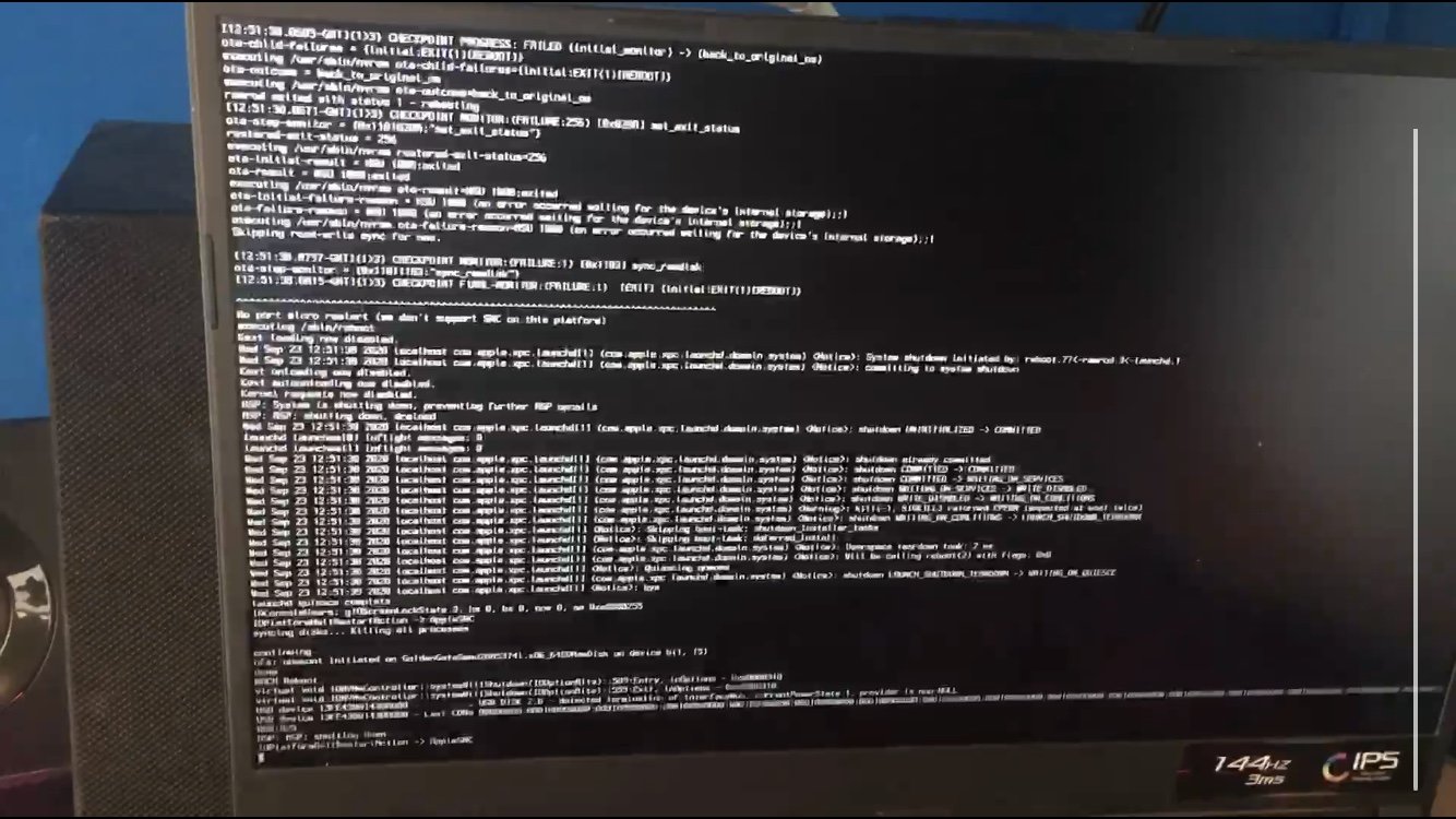

Emanuele-1998 Posted September 29, 2020 Share Posted September 29, 2020 Hi, I have already installed Big Sur beta 3 but can't upgrade to beta 8. I have the new build of Lilu 1.4.6+ and VirtualSMC 1.1.5+ and bootargs vmscgen = 1 but no longer needed.I have an Asus G731GW with 9750h IMG_0203.MP4 Link to comment https://www.insanelymac.com/forum/topic/350754-opencore-general-discussion/page/246/#findComment-2738788 Share on other sites More sharing options...

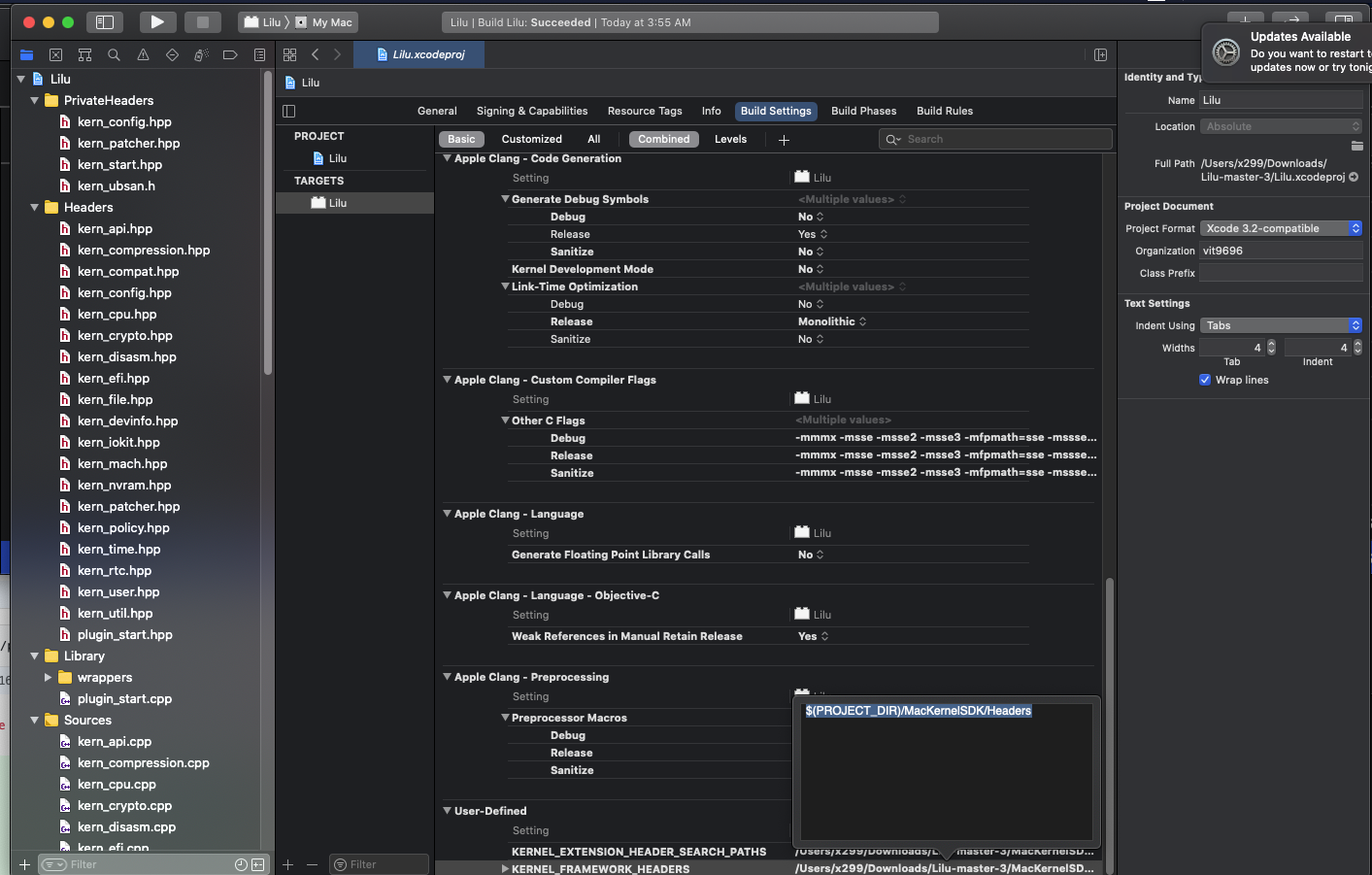

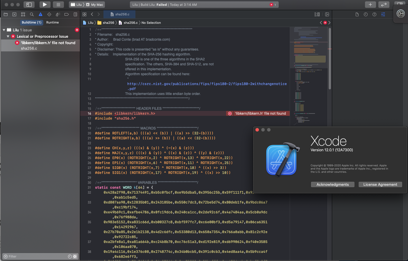

nmano Posted September 30, 2020 Share Posted September 30, 2020 (edited) I Fix build Lilu.kext Errors Before PLEASE DOWNLOAD https://github.com/acidanthera/MacKernelSDK You have to setting KERNEL_FRAMEWORK_HEADERS I appreciate Lilu Team. Edited September 30, 2020 by nmano Link to comment https://www.insanelymac.com/forum/topic/350754-opencore-general-discussion/page/246/#findComment-2738827 Share on other sites More sharing options...
obus Posted September 30, 2020 Share Posted September 30, 2020 (edited) 13 hours ago, Emanuele-1998 said: Hi, I have already installed Big Sur beta 3 but can't upgrade to beta 8 You need to enable SIP (System Integrity Protection) to download update for macOS Big Sur 11 beta. Boot into Recovery --> terminal--> command: csrutil enable Edited September 30, 2020 by obus Changing Disable to Enable Link to comment https://www.insanelymac.com/forum/topic/350754-opencore-general-discussion/page/246/#findComment-2738833 Share on other sites More sharing options...
Emanuele-1998 Posted September 30, 2020 Share Posted September 30, 2020 You need to disable SIP (System Integrity Protection) to update macOS Big Sur 11 beta. Boot into Recovery --> terminal--> command: csrutil disable Yes I have and have CSR-active-config in FF0F0000 but the same Inviato dal mio iPhone utilizzando Tapatalk Link to comment https://www.insanelymac.com/forum/topic/350754-opencore-general-discussion/page/246/#findComment-2738836 Share on other sites More sharing options...
obus Posted September 30, 2020 Share Posted September 30, 2020 (edited) On 9/28/2020 at 5:59 PM, joevt said: In the EFI Shell, does the NVMe or SATA or whatever controller that is in the Thunderbolt drive exist in the list of PCI devices? If not, then you need some different BIOS settings or a new EFI Thunderbolt driver that someone would have to create. It's possible the flashed ROM that makes it work better for macOS stops it from working with EFI or Windows. The disk is not showing up in Shell so obviously there is a driver problem. The disk is visible and readable in Windows without installed original THB driver from Gigabyte. Thunderbolt is disabled in Bios and THB-header on mobo unconnected with jumpered pins 3 to 5 on the two THB cards.. Edited September 30, 2020 by obus Link to comment https://www.insanelymac.com/forum/topic/350754-opencore-general-discussion/page/246/#findComment-2738837 Share on other sites More sharing options...
obus Posted September 30, 2020 Share Posted September 30, 2020 (edited) 1 hour ago, Emanuele-1998 said: Yes I have and have CSR-active in FF0F0000 but the same Inviato dal mio iPhone utilizzando Tapatalk Sorry my bad. I mean you have to ENABLE SIP to get the updates. Try 00000000 in csr-active-config. Edited September 30, 2020 by obus 1 Link to comment https://www.insanelymac.com/forum/topic/350754-opencore-general-discussion/page/246/#findComment-2738839 Share on other sites More sharing options...
Emanuele-1998 Posted September 30, 2020 Share Posted September 30, 2020 Sorry my bad. I mean you have to ENABLE SIP to get the updates. Try 00000000 in car-active-config.Same Link to comment https://www.insanelymac.com/forum/topic/350754-opencore-general-discussion/page/246/#findComment-2738840 Share on other sites More sharing options...
Emanuele-1998 Posted September 30, 2020 Share Posted September 30, 2020 Yes - I was wondering about your previous solution that SIP should be disabled. SIP should be enabled just like on real Macs, even though we are talking about Hacks, the conditions are created to emulate/imitate the behaviour of real Macs. Yes but for me the problem is other Inviato dal mio iPhone utilizzando Tapatalk 1 Link to comment https://www.insanelymac.com/forum/topic/350754-opencore-general-discussion/page/246/#findComment-2738843 Share on other sites More sharing options...
ghost8282 Posted September 30, 2020 Share Posted September 30, 2020 (edited) Hi, In the attempt to update big sur from beta 8 to beta 9 with a sealed system, SIP and authenticated-root enabled I received the error "Download failed, check your internet connection". I noticed that the error was due to not booting from a snapshot, in fact sudo mount -uw / returned error 77 instead of error 66, as it happens if booting from a snapshot. Changing in opencore config SecureBootModel from Default to Disabled solved all the issues, the system booted from the snapshot, mounting / in read/write returned error 66 and update to beta 9 worked without any problem. I read in other discussions that on supported mac a large amount of users solved their update issues with increasing security in recovery through the startup security utility. However I'm understanding (and sorry if I'm wrong) that in my case I'm decreasing security by changing from Default to Disabled: is this expected behaviour? Thanks PS: wouldn't be better to set the SecureBootModel to Disabled in the sample.plist? For sure you have valid reasons to set it to Default, I'm just trying to understand. Edited September 30, 2020 by ghost8282 1 Link to comment https://www.insanelymac.com/forum/topic/350754-opencore-general-discussion/page/246/#findComment-2738852 Share on other sites More sharing options...
