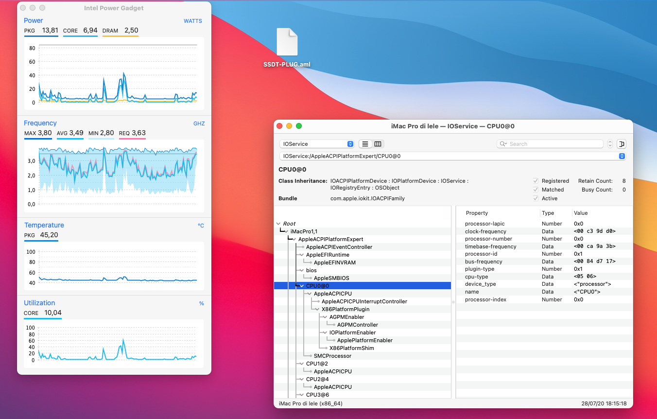

22 hours ago, iCanaro said:
create an SSDT for the custom PM for your CPU
https://github.com/Piker-Alpha/ssdtPRGen.sh
tried. but I don't think this change anything...
I remove the prebuilt ssdt, reboot, run the script, generate the file, rename in ssdt-plug, copy in the ACPI folder, enable via OpenCore configurator and reboot. This is the result1881206220_Schermata2020-07-28alle18_15_34.thumb.png.092b94d8e16f50b3f134c0cc19984a6b.png

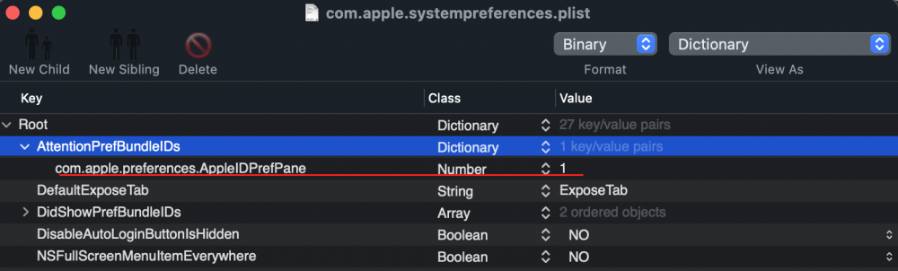

3 hours ago, MorenoAv said:
Hi guys,

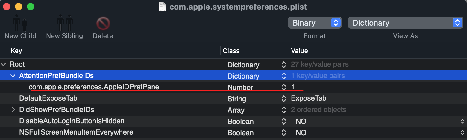

Today I'm at work, and as you remember I had 2 updates for my Mac mini 2018, today I installed it again... and now I have the installation appear although I already made it... and the one in system preferences satay there. BS weirdness strikes again, how do I remove the update from system preferences and the reminder that I have one update in about this Mac?
If you feel that this post is off topic feel free to move it elsewhere...
Thanks
Delete the items under AttentionPrefBundleIDs then log out.
1225086985_ScreenShot2020-07-28at9_50_59AM.thumb.png.5a1b6581d64391cb1482f050c1990bd5.png
Edited by AppleBreak
  • Thanks 2

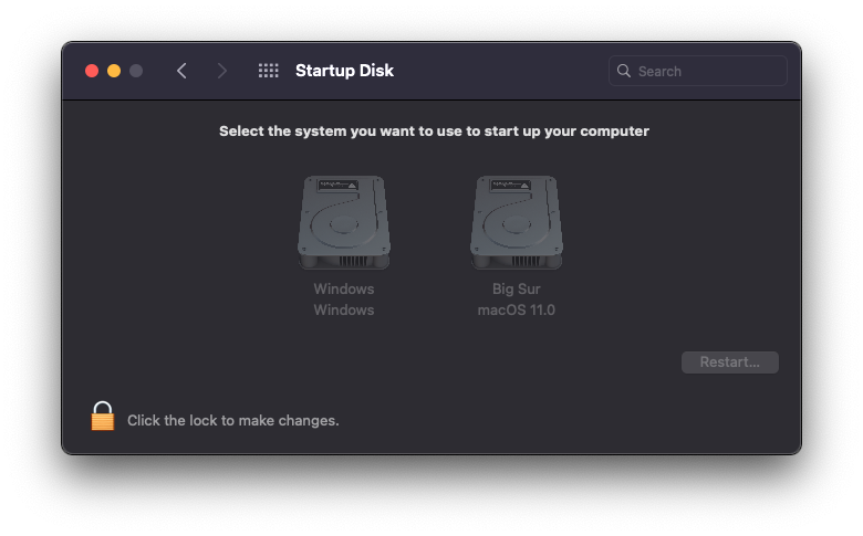

@dvil - Although I've posted about this bug a few times, can I ask if your Clover finding is just with Windows and BS alone connected, because I found BS will only be present if and when another OS X disk is connected. If it is easy for you to do can you just boot your system with just BS and Windows Disk connected and check the result in System Preferences/Startup Disk please.
Still working fine in Clover just with BS and Windows.
Cheers.

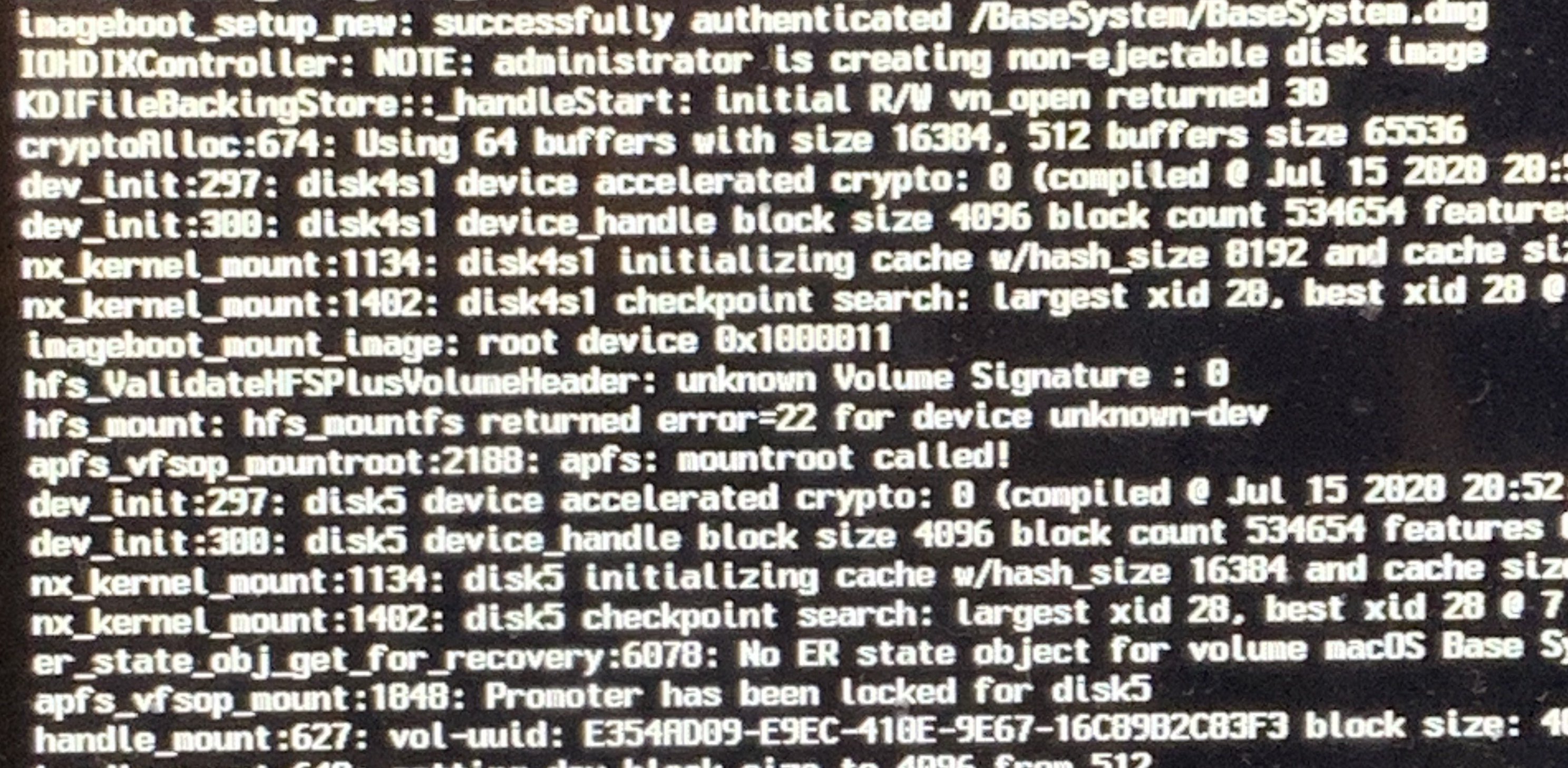

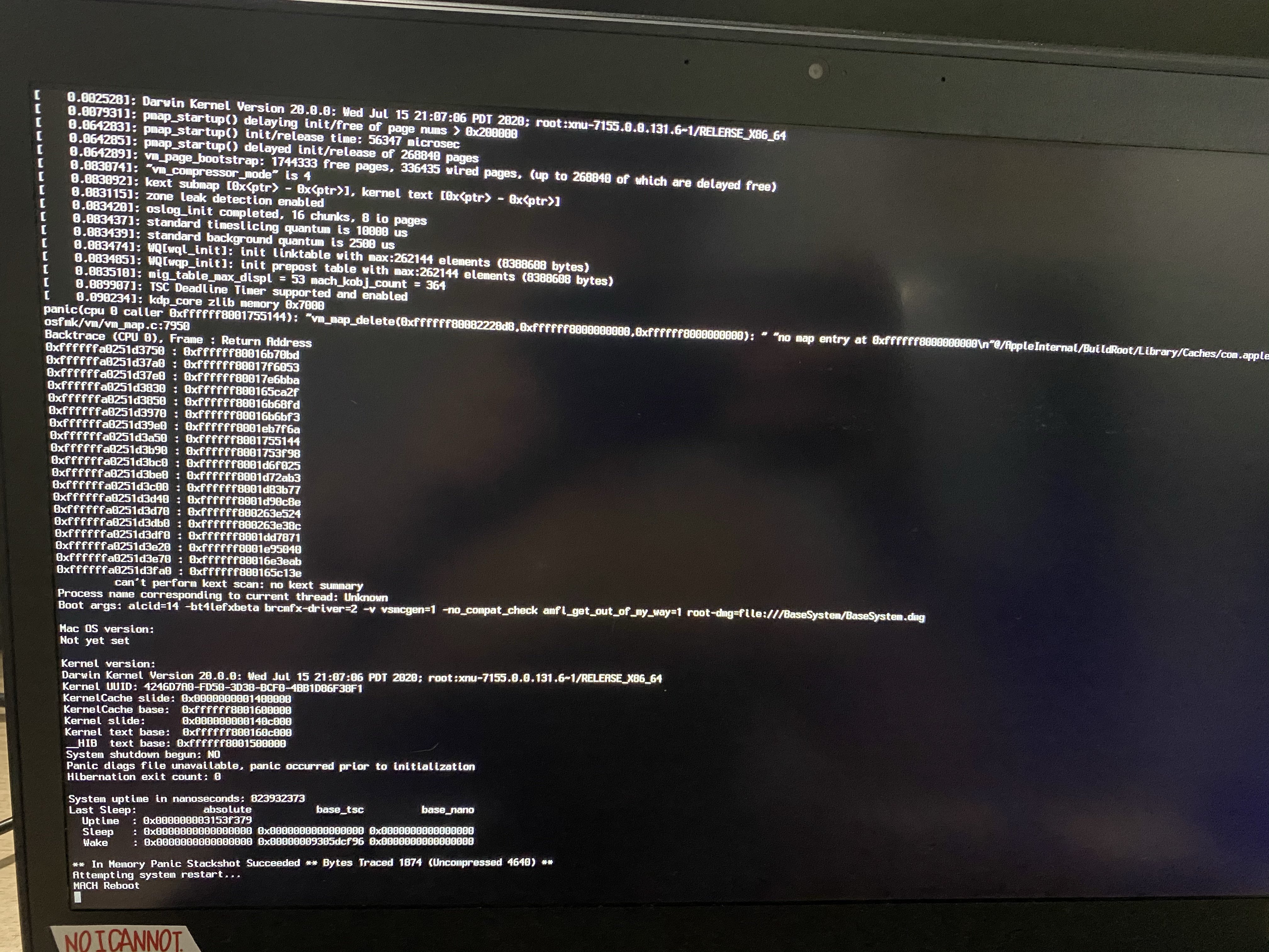

Hi guys,
Currently I have Catalina 10.15.6 and Big Sur Beta 2. I tried to update to beta 3 and it created a Preboot entry in OC, but every time I try to boot it, it results in the kernel panic from the attached picture. I tried it with the latest Clover v2020 and with a compiled OC from today - it results in the same error. Both bootloaders are booting successfully Catalina and BigSur Beta 2. I even downloaded and created a usb installer for beta 3. But unfortunately, it also resulted in the same error (both in Clover and OC).
Please if you have encountered this error before and know how to fix it, help me!
Many thanks!!!
19 minutes ago, mvitanov said:
Hi guys,
Many thanks!!!
I could be wrong but it looks like you don't have a ssd-tpl0 or what ever your device is called to identify the touch hub in order for Big Sur to move on mark it present and go on booting I posted my ssd-tpl0 for any one to get compiled but so far no takers
Edited by markl18
I use Samsung 970 EVO SSD - NVMe m.2; I haven't had any problems so far with it (using it since High Sierra). And the other betas of Big Sur were not making this problem, so I assume apple changed sth yet again related to that.
you are missing the point your computer has a touchscreen according to the screen you posted and there is no corresponding driver for that hub to take care off, so installation dies because of unidentified device you could take of the problem by posting a notch kext which tells make no to busy with this device to make it its own and use its own drivers
Edited by markl18

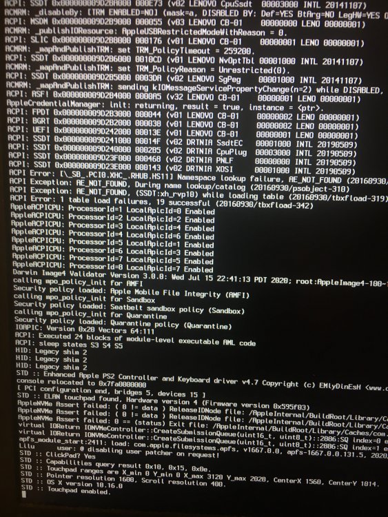

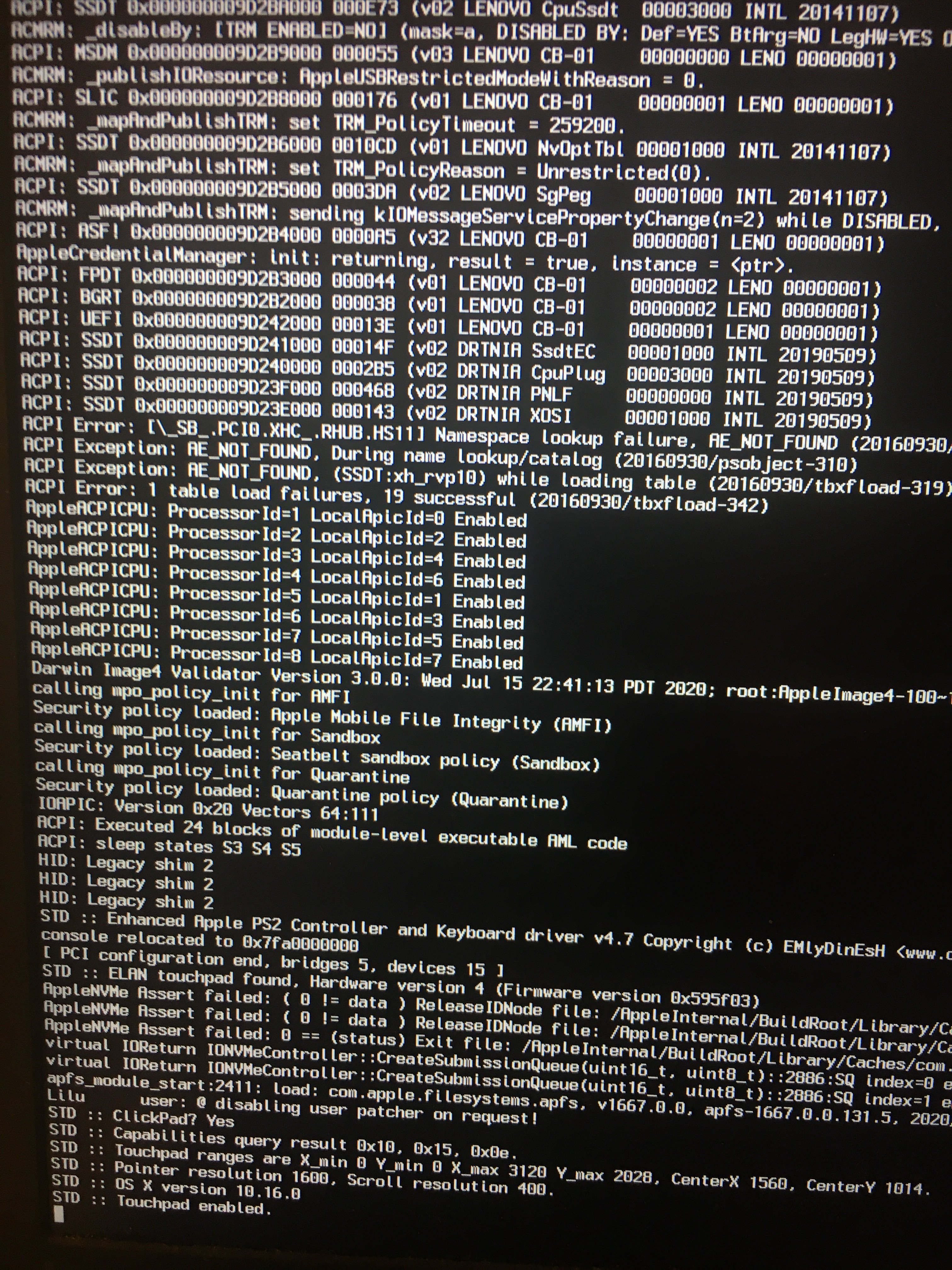

My computer does not have a touchscreen (lenovo 700 - 15isk with Skylake i7). How did you infer that? I see only touchpad related stuff in the boot logs.
u vac napisano eto vconze bashei loga kotorgo vi postali pochitai ego vnimatelno i vi uvidete sami look at the end of your log it says all about your touchscreen device elan which probably needs a voodooCElan.kext andvoodoogpio.kext and a ssd-tplo or tpd0 or what ever your DSDT says
This is not the problem. I turned off the kext for my touchpad and this line disappears. It gets stuck on AppleNVMe assert failed and the 2 virtual IOReturn IONVMeController lines
5 minutes ago, markl18 said:
I don't know what ever the picture says I think I tries to mount something and than expand the dmg file into it but doesn't succeed in mounting

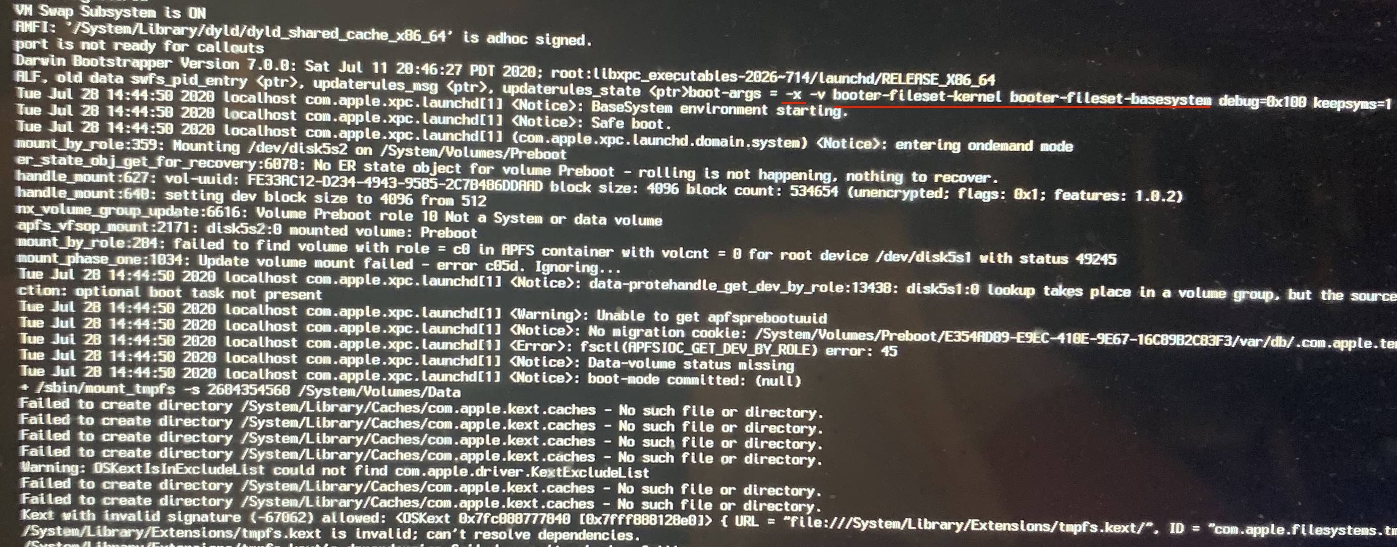

If you want to boot the installer you need to remove these boot-args:
Spoiler
4 minutes ago, Toilet said:
Add vsmcgen=1 to boot-args for beta 3
it's already using it
<plist version="1.0">
<string> -v debug=0x100 keepsyms=1 alcid=5 vsmcgen=1</string>
</plist>
Please update your kexts to the latest ones
54 minutes ago, markl18 said:
I think it is the same exact error do you think it is integrity of the file should I download it again but doesn't it check for check some errors it is tcp/ip the whole 7 layer stack
Untitled.heic
