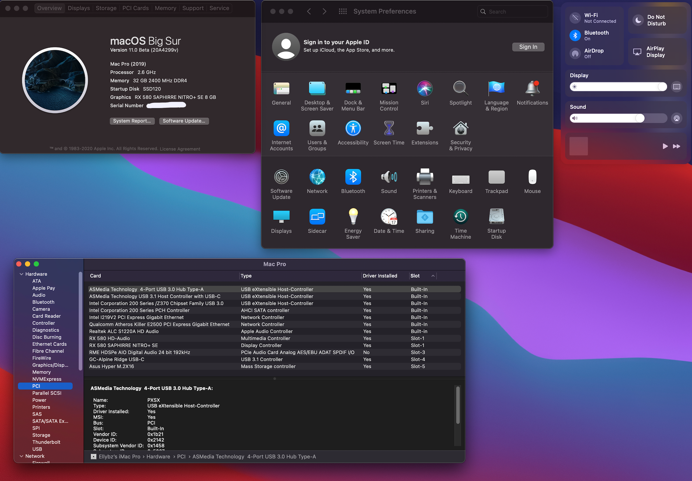

Ellybz Posted June 29, 2020 Share Posted June 29, 2020 (edited) Booting with OpenCore NDK 059 - X299 Gigabyte Gaming 7 -I9 7980xe First part of installation done via VMware Fusion / OSX Mojave Not working (Yet ) : AirDrop & Sleep functions BT, Audio ( except RME PCIe) , DP, TB3 are working. Edited June 29, 2020 by Ellybz 2 Link to comment Share on other sites More sharing options...
