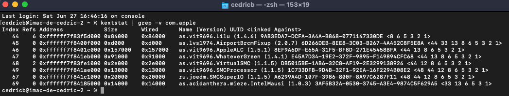

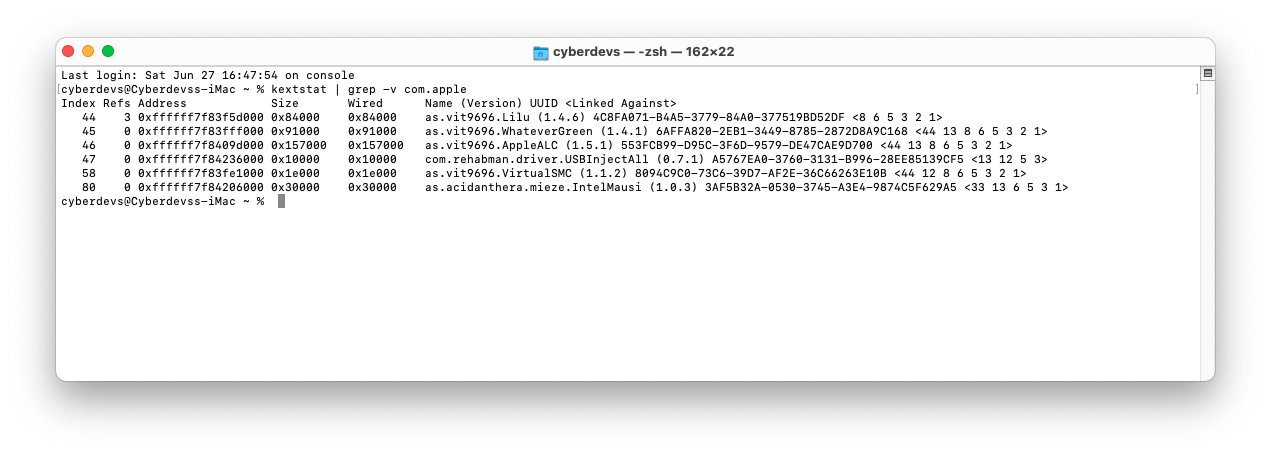

On 6/27/2020 at 9:11 AM, cryosat7 said:
Also I lost wired connection on Catalina if I use my 0.6.0 Bootloaders for macOS Big Sur, could it be a config file error?
Your Ethernet Controller is Realtek® RTL8111H mine is Intel.
On 6/27/2020 at 9:05 AM, YukiPowa said:
I use BCM94360CS2 and IntelMausi.kext not work for me :(
But bluetooth work with kexts
Let me check my Ethernet connection on Big Sur and see if it's working, I have Intel GBE LAN.
Yes its' working with IntelMausi.kext

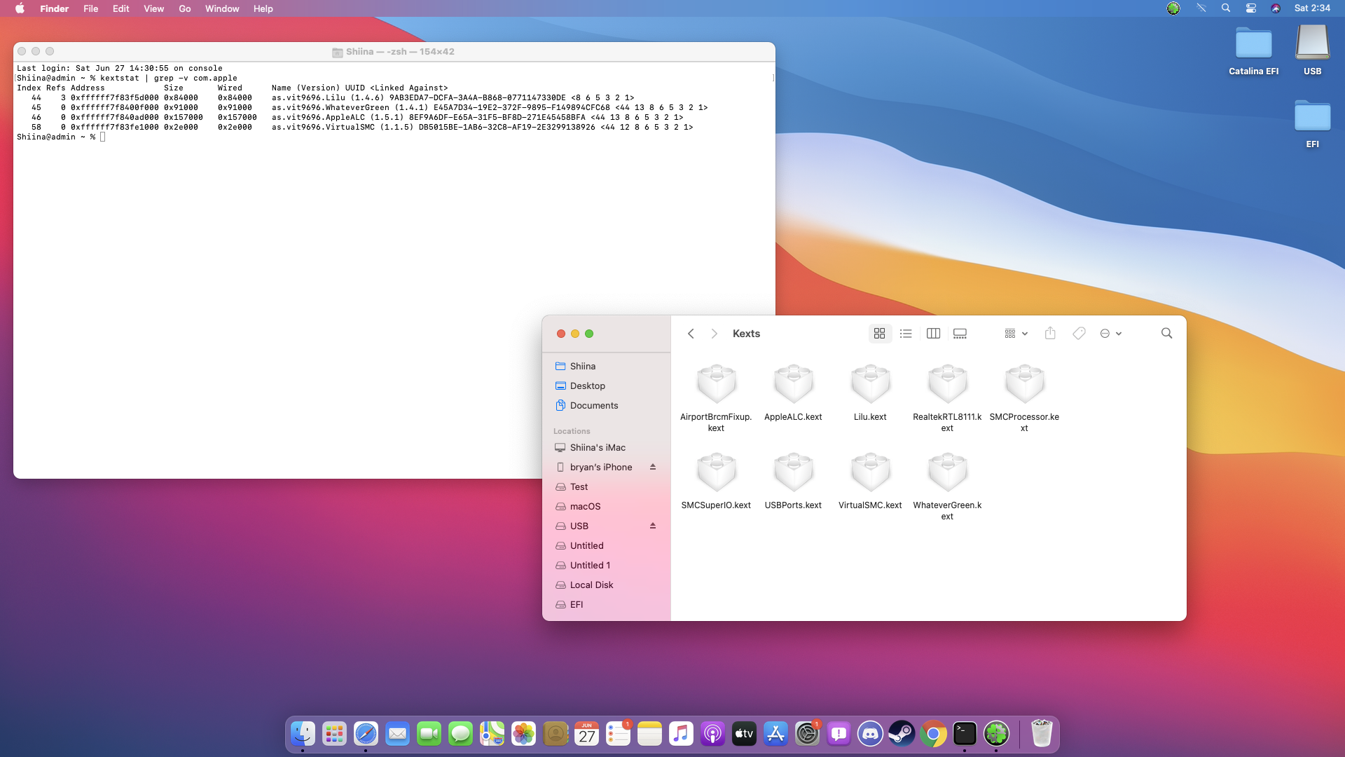

Use this command in terminal and see if the kext are loaded:
kextstat | grep -v com.apple
Spoiler
Strange. it doesn't seem like everything is loaded.
Spoiler

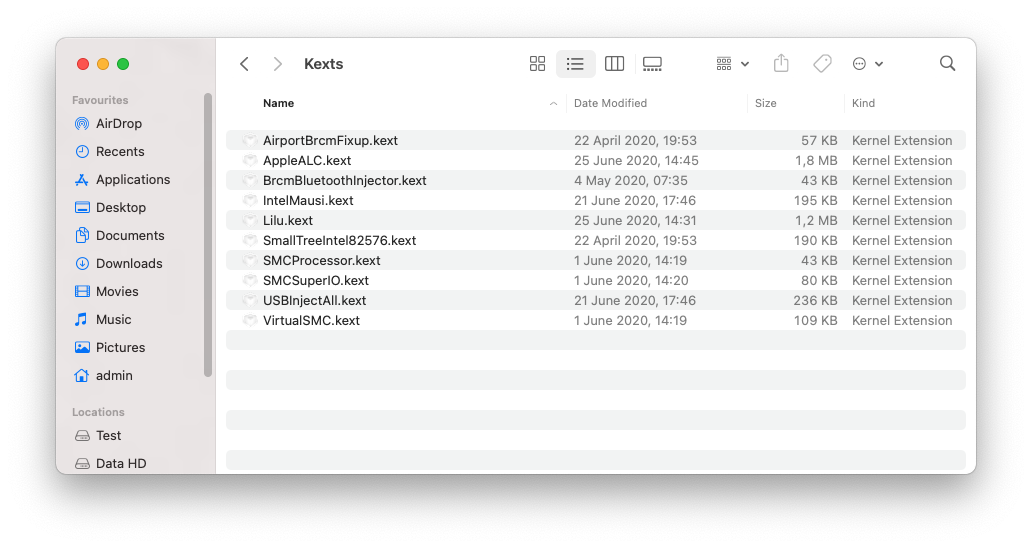

Use the -brcmfxbeta boot flag or you can use -lilubetaall if you are using all of their kexts.

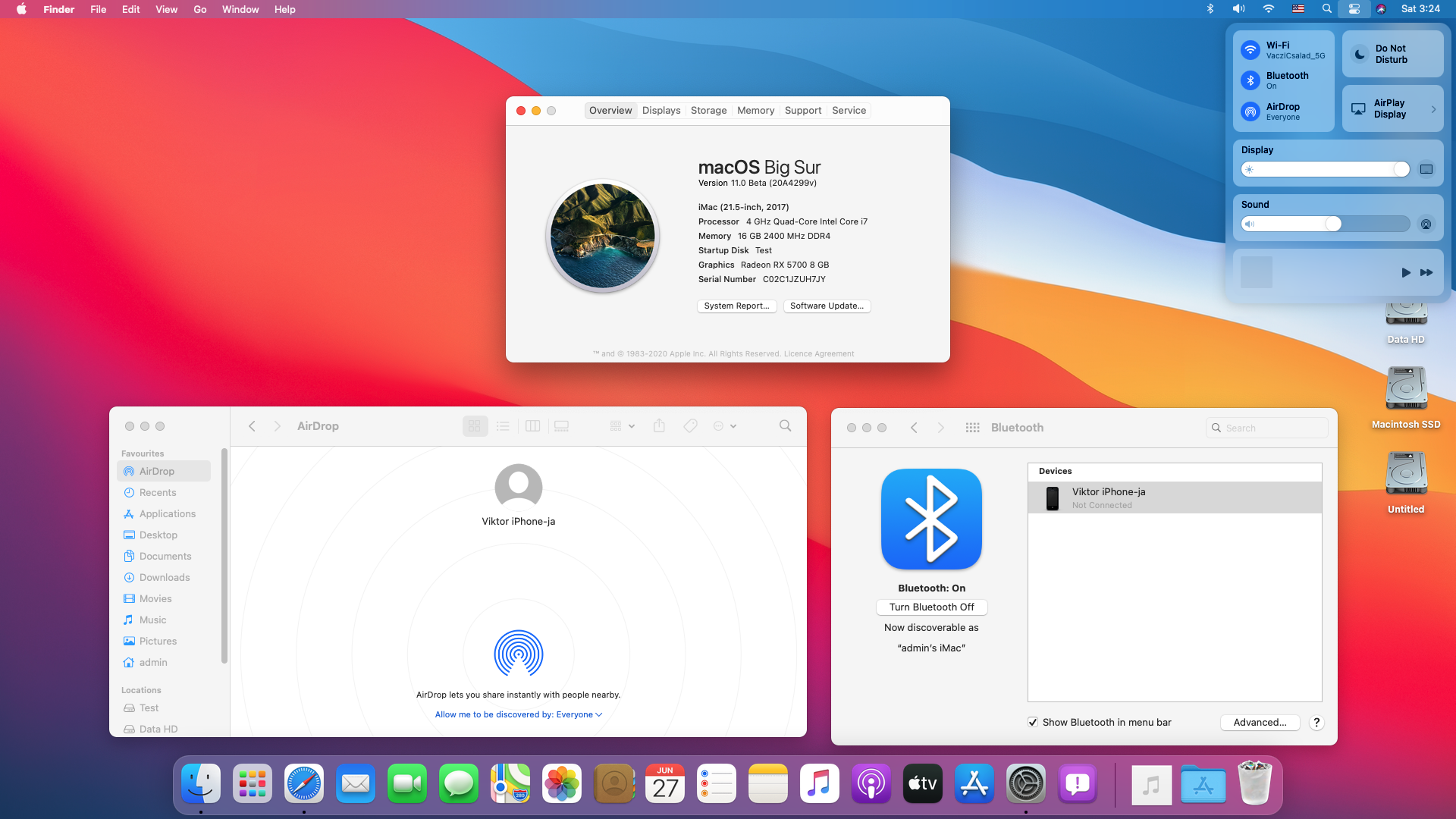

I've been thinking about changing from Clover to OC so long, so now it was that time. Was pretty easy.
System:
ASUS Z170-Deluxe
ASUS RX 5700 8 GB
16 GB DDR4
Intel Core i7-6700K
Wi-Fi and BT: Broadcom BCM94360HMB Half-Mini-PCI-E
Everything is working as expected, no need for Whatevergreen for my RX 5700. For WiFi and BT I used BrcmBluetoothInjector.kext and AirportBrcmFixup.kext.
I didn't tested Messages, FaceTime, etc. but I think they're okay too. Airdrop & Handoff is working.
Attaching EFI and pictures.
Because I can't boot the USB Installer I created a VM Big Sur, created a restore image, and on Catalina I restored that dmg with dd in Terminal to a spare HDD.

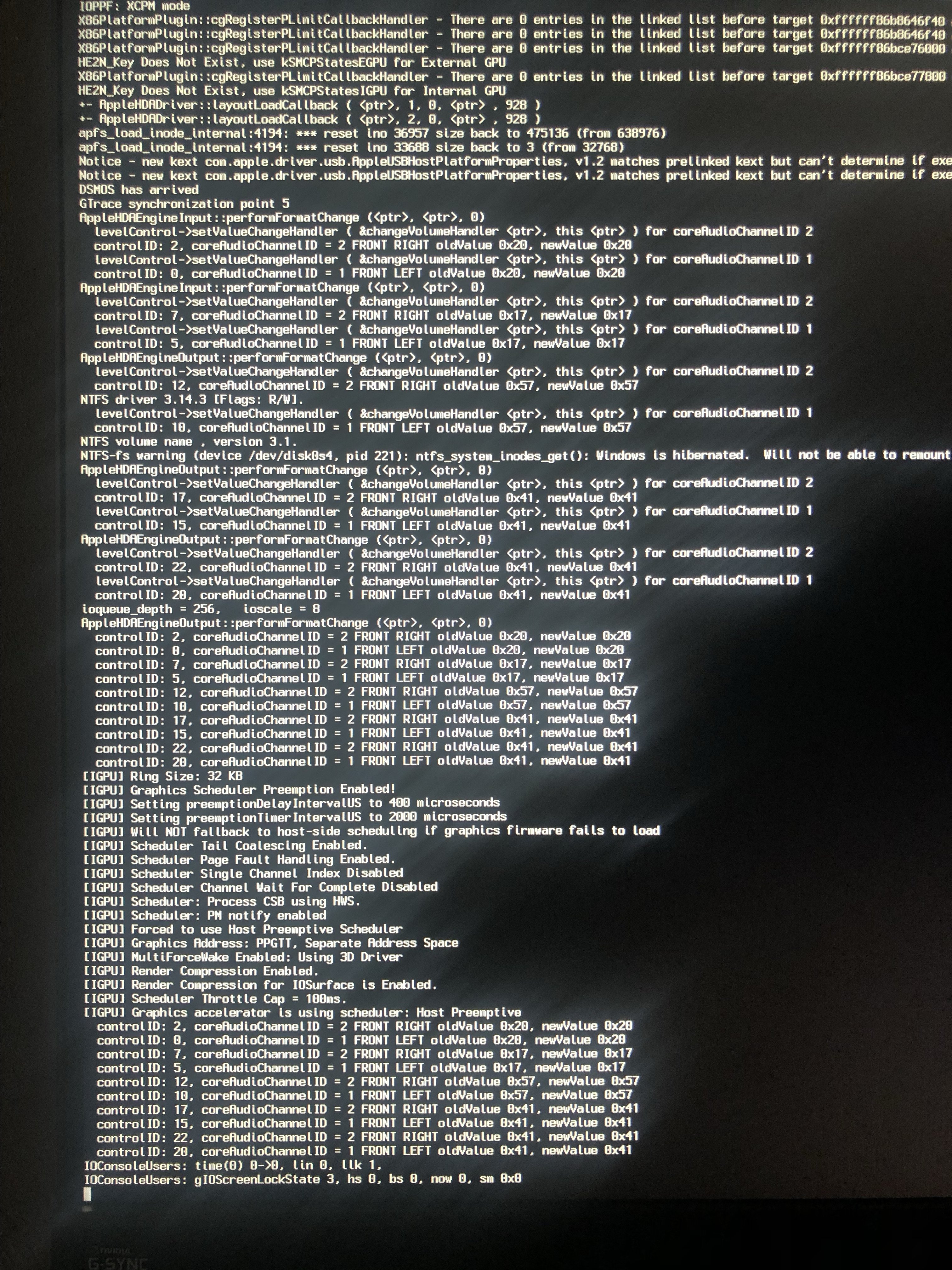

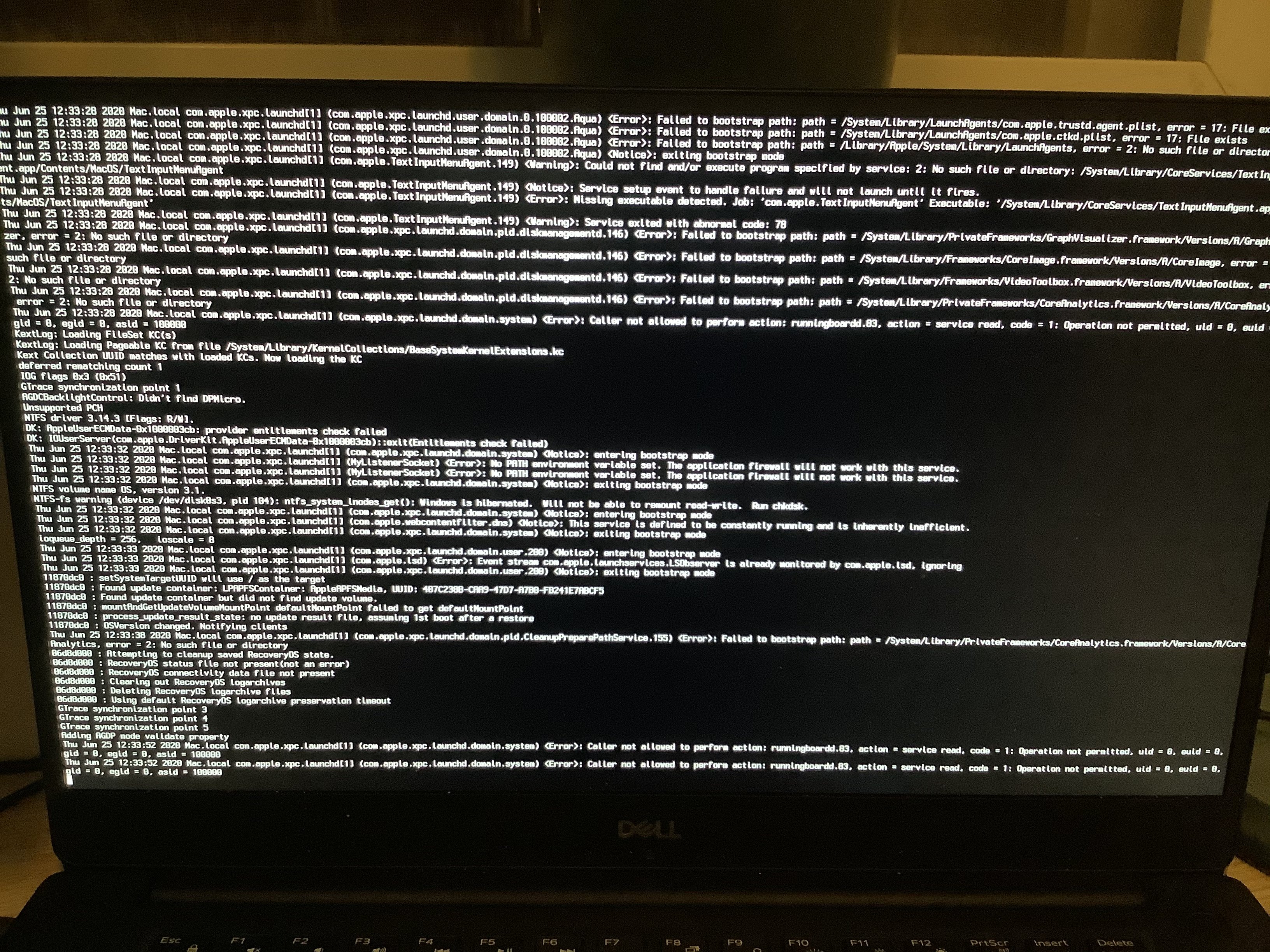

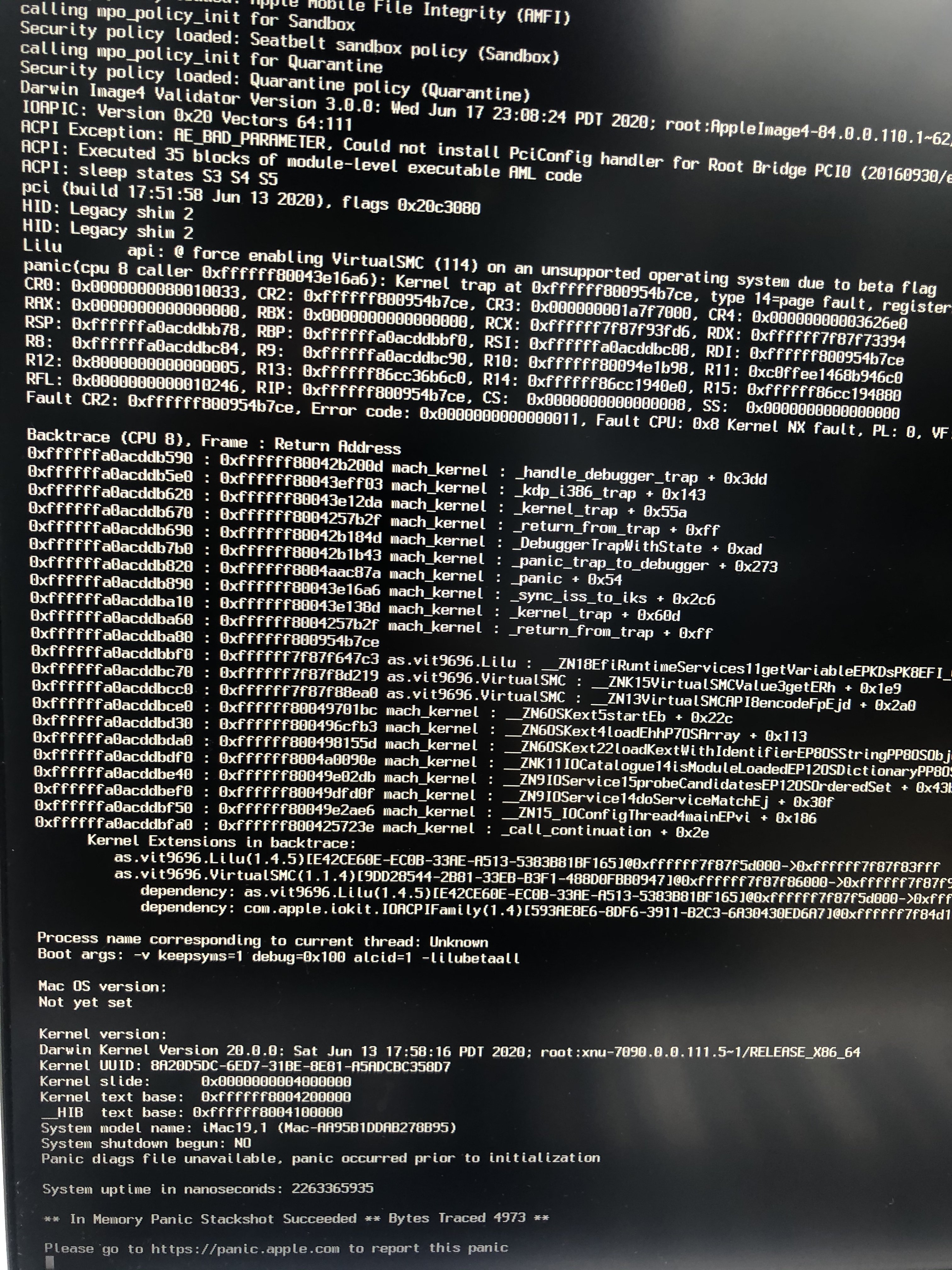

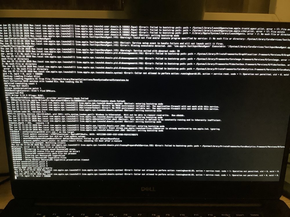

Good job guys. I’m presented with very early KP on my z370. I got the thing installed on external and verified good on my real MacBook. I can successfully boot with previous OpenCore to Catalina so I cannot be that stupid. All kext are updated and I’m using 0.6.0 trying to boot into BigSur.
Spoiler
System:
ASUS Z170-Deluxe
ASUS RX 5700 8 GB
16 GB DDR4
Intel Core i7-6700K

Well since Catalina this metal is running pretty native without any big modifications, no need for any big DSDT patches and KextPatches. The only thing I need is the SSDT-EC.aml.
You should start reading this: https://dortania.github.io/OpenCore-Desktop-Guide/ to get started.
The only thing I needed to modify is the SMBIOS to iMac18,1 and add booter-fileset-basesystem=00, booter-fileset-kernel=00, AvoidRuntimeDefrag=False.
Still need to figure out one thing tho, interestingly I can boot and use Big Sur without any problem, but when I try to boot Catalina with the same OC EFI the system is rebooting immediately after arriving to desktop (no kp log). So I put the OC Big Sur EFI to that HDD's EFI, put Catalina Clover to my main drive's EFI and I can select the drives using my boot key (and I set it to boot my main Clover automatically)
Maybe some unsupported kexts. For me I transferred all of my kexts from Clover to OC and on Big Sur boot I got the same KP log, the culprits were the BrcmFirmwareData.kext and BrcmPatchRAM3.kext, BUT the KP didn't show me a thing about it, just throwed a VirtualSMC kp. After I deleted these two the system booted just fine. Try booting only with just the necessary kexts, then add one-by-one the others to see which one is not working.

@Cyberdevs Thanks mate, I had to update my config file with the kexts that were in the folder.
And that beta flag did it for wifi!
I'll be waiting for my Bluetooth card to arrive and I'll test that out too.

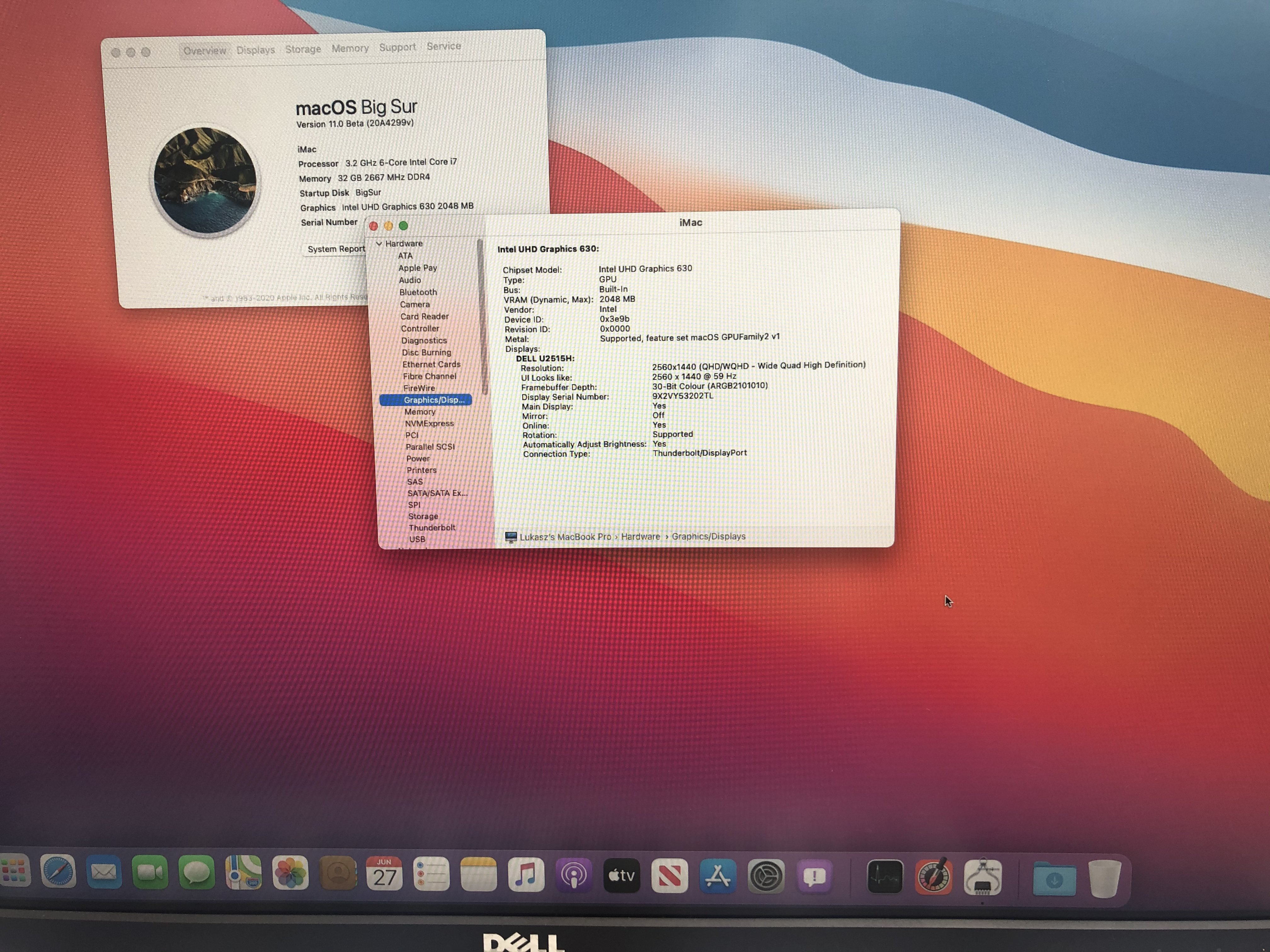

Finally! Z370 brother. Your EFI worked straight away with my preinstalled External SSD, I use real Mac and not Virtual Machine for installation. Thank you for good UHD patch. Now I just got to make WiFi work and patch USB but that’s not a problem. I’m happy.
