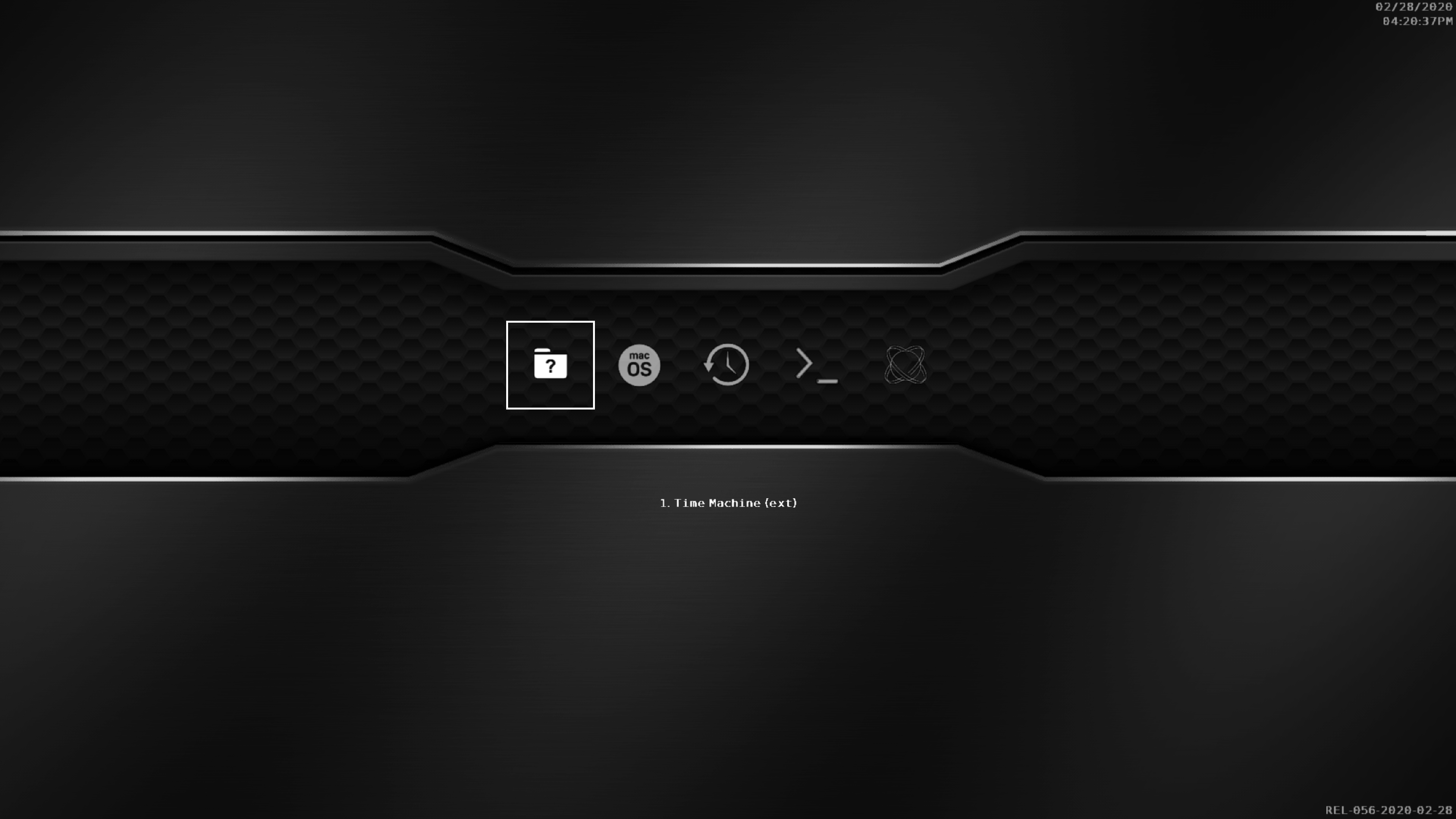

n.d.k Posted February 28, 2020 Author Share Posted February 28, 2020 49 minutes ago, eng_redaesm said: @n.d.k Dear latest fork >>>Working NDKbootpicker. R14 only Blank screen (on options no background ) I just did a test on NDKbootpicker. R14, it seems working Ok. Maybe, you missed something.. 2 Link to comment https://www.insanelymac.com/forum/topic/341402-customized-opencore-with-additional-features/page/24/#findComment-2710246 Share on other sites More sharing options...
eng_redaesm Posted February 28, 2020 Share Posted February 28, 2020 3 hours ago, n.d.k said: I just did a test on NDKbootpicker. R14, it seems working Ok. Maybe, you missed something.. yes test it now with latest OC upstream working good (i was testing with older build) thanks 1 Link to comment https://www.insanelymac.com/forum/topic/341402-customized-opencore-with-additional-features/page/24/#findComment-2710264 Share on other sites More sharing options...

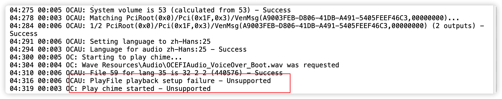

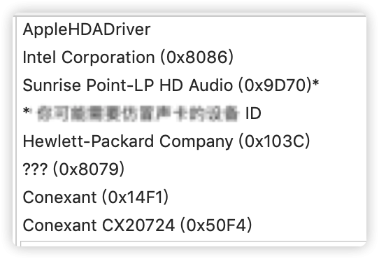

btwise Posted February 29, 2020 Share Posted February 29, 2020 @ndk After updating to the latest version, I want to experience the sound effect of the boot interface, but I found that it could not play. After getting the log, I found that the prompt was not supported. I wonder if this is my sound card model not supported? My sound card model is like this! 1 Link to comment https://www.insanelymac.com/forum/topic/341402-customized-opencore-with-additional-features/page/24/#findComment-2710364 Share on other sites More sharing options...

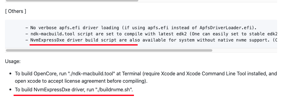

Andrey1970 Posted February 29, 2020 Share Posted February 29, 2020 @n.d.k You don't need to build this driver separately, because NvmExpressDxe.efi build in bundle with OpenCore v0.5.4+ Link to comment https://www.insanelymac.com/forum/topic/341402-customized-opencore-with-additional-features/page/24/#findComment-2710437 Share on other sites More sharing options...
n.d.k Posted February 29, 2020 Author Share Posted February 29, 2020 (edited) 29 minutes ago, Andrey1970 said: @n.d.k You don't need to build this driver separately, because NvmExpressDxe.efi build in bundle with OpenCore v0.5.4+ Was the verbose showing problem on OC NvmExpressDxe Driver solved?...I think it need a buildoption flag -DMDEPKG_NDEBUG to suppress the verbose showing when driver load..at least on my system. Edited February 29, 2020 by n.d.k Link to comment https://www.insanelymac.com/forum/topic/341402-customized-opencore-with-additional-features/page/24/#findComment-2710440 Share on other sites More sharing options...

vit9696 Posted February 29, 2020 Share Posted February 29, 2020 33 minutes ago, n.d.k said: Was the verbose showing problem on OC NvmExpressDxe Driver solved?...I think it need a buildoption flag -DMDEPKG_NDEBUG to suppress the verbose showing when driver load..at least on my system. There had never been a "verbose" problem. Debug drivers (DEBUG and NOOPT) produce verbose output, all of them: NvmeExpressDxe, AudioDxe, XhciDxe, even OpenCore itself (unsurprisingly). This is expected and normal, you build a debug version exactly to troubleshoot and see the verbose. Release drivers do not. Therefore what your tool does is basically borking the debug builds of these drivers. 1 Link to comment https://www.insanelymac.com/forum/topic/341402-customized-opencore-with-additional-features/page/24/#findComment-2710446 Share on other sites More sharing options...
n.d.k Posted February 29, 2020 Author Share Posted February 29, 2020 (edited) 17 minutes ago, vit9696 said: There had never been a "verbose" problem. Debug drivers (DEBUG and NOOPT) produce verbose output, all of them: NvmeExpressDxe, AudioDxe, XhciDxe, even OpenCore itself (unsurprisingly). This is expected and normal, you build a debug version exactly to troubleshoot and see the verbose. Release drivers do not. Therefore what your tool does is basically borking the debug builds of these drivers. Then maybe it's not related to that switch, but the OC NvmeExpressDxe.efi release version did give me a couple verbose lines when the driver is loading while the one that was build from this fork does not...maybe you can check out the build description to see what's different. https://github.com/n-d-k/NvmExpressDxePkg/blob/master/NvmExpressDxePkg.dsc Edited February 29, 2020 by n.d.k Link to comment https://www.insanelymac.com/forum/topic/341402-customized-opencore-with-additional-features/page/24/#findComment-2710450 Share on other sites More sharing options...

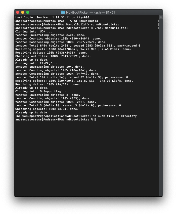

Andres ZeroCross Posted February 29, 2020 Share Posted February 29, 2020 2 hours ago, n.d.k said: I think, it was it! https://github.com/tianocore/edk2/blob/af51cb48a22d4135db48ed784dbb6bbbea9c15b5/MdeModulePkg/Bus/Pci/NvmExpressDxe/NvmExpressHci.c#L781 Try to build Ndkbootpicker with ./ndk-macbuild.tool but i got this error problem. I have delete Ndkbootpicker folder and made git clone again. But still same error log Link to comment https://www.insanelymac.com/forum/topic/341402-customized-opencore-with-additional-features/page/24/#findComment-2710478 Share on other sites More sharing options...
Andres ZeroCross Posted February 29, 2020 Share Posted February 29, 2020 2 hours ago, n.d.k said: I think, it was it! https://github.com/tianocore/edk2/blob/af51cb48a22d4135db48ed784dbb6bbbea9c15b5/MdeModulePkg/Bus/Pci/NvmExpressDxe/NvmExpressHci.c#L781 And for your comment here , i have tested version 0.1.5 from Release Version and problem still persist. I have 4 entry with "HideAuxiliary = Yes",1. Windows 10 Enterprise 2. macOS Mojave 3. macOS Catalina 4. Linux Mint But, Voice Assistant said wrong order, "4 (Four) macOS Catalina" and "6 (six) for Linux Mint" It's still read entry order with actually entry (show Auxillary Entry) 1. Windows 10 Enterprise 2. macOS Mojave 3. Recovery Image of Mojave 4. macOS Catalina 5. Recover Image of Catalina 6. Linux Mint 7. Custom Tool Sorry for bad english Link to comment https://www.insanelymac.com/forum/topic/341402-customized-opencore-with-additional-features/page/24/#findComment-2710484 Share on other sites More sharing options...
n.d.k Posted February 29, 2020 Author Share Posted February 29, 2020 22 minutes ago, Andres ZeroCross said: Try to build Ndkbootpicker with ./ndk-macbuild.tool but i got this error problem. I have delete Ndkbootpicker folder and made git clone again. But still same error log OC recently merged OcSupportPkg to OpenCorePkg, So NdkBootPicker source code need to be changed to reflect merge, just use Binary Release for now. Link to comment https://www.insanelymac.com/forum/topic/341402-customized-opencore-with-additional-features/page/24/#findComment-2710486 Share on other sites More sharing options...
