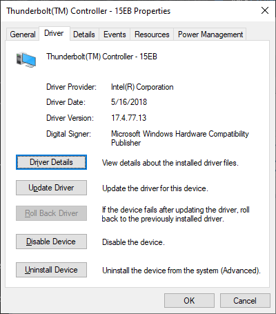

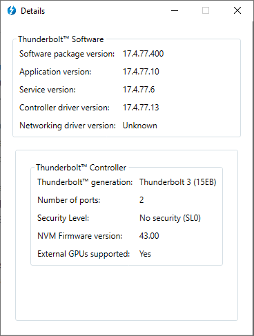

dsynos80 Posted April 10, 2020 Share Posted April 10, 2020 2 hours ago, jimborae said: I'm on NVM Firmware 50.00. Yikes! Also will try those drivers you linked to later, thanks. It's in the Thunderbolt Control Centre in Windows. It's installed as part of the driver install in Windows. On Windows, Right click on thunderbolt icon in taskbar->About Link to comment https://www.insanelymac.com/forum/topic/339980-audiogods-aorus-z390-pro-patched-dsdt-mini-guide-and-discussion/page/99/#findComment-2716558 Share on other sites More sharing options...
Project 2501 Posted April 10, 2020 Share Posted April 10, 2020 16 minutes ago, dsynos80 said: On Windows, Right click on thunderbolt icon in taskbar->About Thanks! I went to the TB Control Center and couldn't find it there either. It looks like my firmware is 43?! Were there firmware updates on the Gigabyte site; I can't remember. BTW, are your Firewire devices recognized by Windows 10? Link to comment https://www.insanelymac.com/forum/topic/339980-audiogods-aorus-z390-pro-patched-dsdt-mini-guide-and-discussion/page/99/#findComment-2716565 Share on other sites More sharing options...
jimborae Posted April 10, 2020 Share Posted April 10, 2020 37 minutes ago, dsynos80 said: On Windows, Right click on thunderbolt icon in taskbar->About It would seem 1.41.648.5 are the newer thunderbolt drivers, those 17.4.77.400 are dated from 2018. 1.41.648.5 are June 2019. 17 minutes ago, Project 2501 said: Thanks! I went to the TB Control Center and couldn't find it there either. It looks like my firmware is 43?! Were there firmware updates on the Gigabyte site; I can't remember. BTW, are your Firewire devices recognized by Windows 10? Yes on Gigabyte's Titan Ridge product page under support you'll find the firmware update download. Link to comment https://www.insanelymac.com/forum/topic/339980-audiogods-aorus-z390-pro-patched-dsdt-mini-guide-and-discussion/page/99/#findComment-2716568 Share on other sites More sharing options...
dsynos80 Posted April 10, 2020 Share Posted April 10, 2020 Yes the firewire card works under windows. Link to comment https://www.insanelymac.com/forum/topic/339980-audiogods-aorus-z390-pro-patched-dsdt-mini-guide-and-discussion/page/99/#findComment-2716571 Share on other sites More sharing options...
Project 2501 Posted April 10, 2020 Share Posted April 10, 2020 3 minutes ago, jimborae said: It would seem 1.41.648.5 are the newer thunderbolt drivers, those 17.4.77.400 are dated from 2018. 1.41.648.5 are June 2019. Yes on Gigabyte's Titan Ridge product page under support you'll find the firmware update download. Yes, but when I installed 1.41.648.5, I get almost no feedback... just a few flashes of the CMD windows. It doesn't install the Control Center either. I forgot to look at the Task Tray before I uninstalled it and tried dsynos80's uploaded Designaire Z390 TB driver. Neither of the drivers recognized the MBP target disc. Link to comment https://www.insanelymac.com/forum/topic/339980-audiogods-aorus-z390-pro-patched-dsdt-mini-guide-and-discussion/page/99/#findComment-2716572 Share on other sites More sharing options...
dsynos80 Posted April 10, 2020 Share Posted April 10, 2020 I remember trying to install the .648 drivers and was getting an error. The ones i posted worked for me but AFTER i did the correct settings in bios. Before i set the no security and the gpio forcee power option the card was loosing connection every 10 second or so. Dont know what else to say. Link to comment https://www.insanelymac.com/forum/topic/339980-audiogods-aorus-z390-pro-patched-dsdt-mini-guide-and-discussion/page/99/#findComment-2716573 Share on other sites More sharing options...
MorenoAv Posted April 10, 2020 Share Posted April 10, 2020 Sometimes hackitoshing is very frustrating, but we persist insist and all is well after sometime. I can't thank @AudioGod enough for his support and help, even if his OpenCore EFI didn't work in my Hack. Link to comment https://www.insanelymac.com/forum/topic/339980-audiogods-aorus-z390-pro-patched-dsdt-mini-guide-and-discussion/page/99/#findComment-2716577 Share on other sites More sharing options...
Project 2501 Posted April 10, 2020 Share Posted April 10, 2020 1 hour ago, dsynos80 said: I remember trying to install the .648 drivers and was getting an error. The ones i posted worked for me but AFTER i did the correct settings in bios. Before i set the no security and the gpio forcee power option the card was loosing connection every 10 second or so. Dont know what else to say. I found a thread at Gigabyte forums (https://forum.gigabyte.us/thread/6193/) that actually answers some of my questions. The Designaire controller is Titan Ridge, so it makes sense the Designaire MB driver works with the PCI card. Athough there is some disagreement whether Titan Ridge is backward compatible with TB2, most agree that TB1 won't work the Titan Ridge controller. My ancient MBP is TB1, so I'll need to test it with something else. Link to comment https://www.insanelymac.com/forum/topic/339980-audiogods-aorus-z390-pro-patched-dsdt-mini-guide-and-discussion/page/99/#findComment-2716587 Share on other sites More sharing options...
