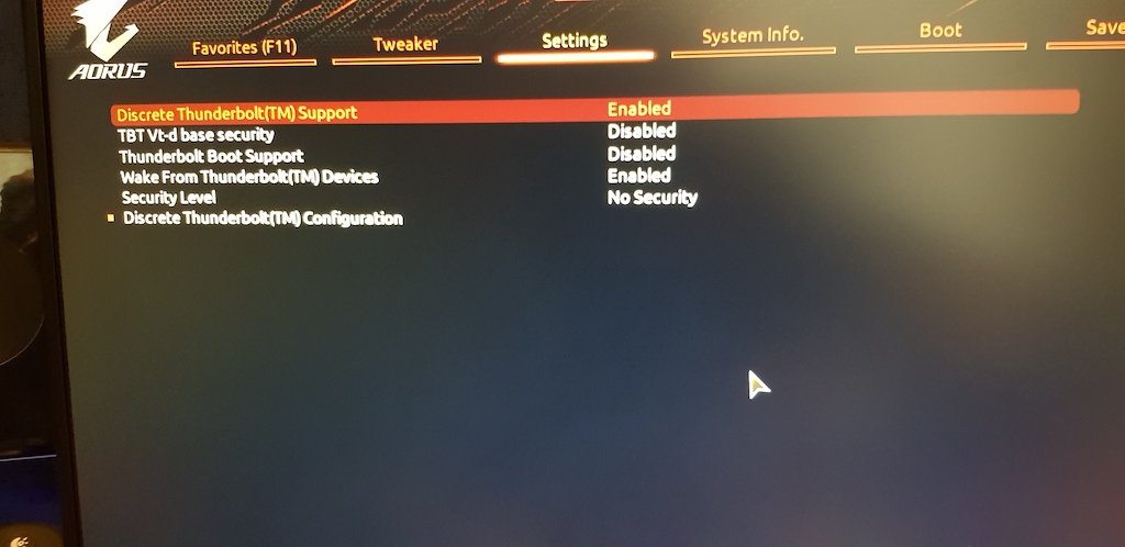

Project 2501 Posted April 3, 2020 Share Posted April 3, 2020 8 hours ago, dsynos80 said: I think anyone that has different devices with thunderbolt connection should report before we writh guide. I only have my fw400 card connected via Tb3 to tb2 adapter, then tb to fw800 adapter, then fw800 to fw400 cable. Before i use the ssdt and do the correct bios settings AFTER i have installed the driver in windows, i had signal loss of the audio card. Now works great. I dont have any TB camera or disk to test. Not sure I understand. You have a FW400 [sound] card in an external enclosure connected to your Titan Ridge card using series of adapters: Sound Card (external) -> FW400 -> FW800 -> TB2 -> TB3 -> Titan Ridge Card. I think I'll try to connect the MBP target disc on the Windows side just to see if it works at all. I'll have to reinstall the driver, because I had to reinstall Windows to get the boot manager on the same disk as the OS. If it works, it will at least tell me the disk is not readable by Windows. I'll double check my BIOS settings as well. In meantime, I'll have see if I have a USB cable on hand for my scanner if I need it later. Link to comment https://www.insanelymac.com/forum/topic/339980-audiogods-aorus-z390-pro-patched-dsdt-mini-guide-and-discussion/page/94/#findComment-2715331 Share on other sites More sharing options...
dsynos80 Posted April 3, 2020 Share Posted April 3, 2020 2 minutes ago, Project 2501 said: Not sure I understand. You have a FW400 [sound] card in an external enclosure connected to your Titan Ridge card using series of adapters: Sound Card (external) -> FW400 -> FW800 -> TB2 -> TB3 -> Titan Ridge Card. I think I'll try to connect the MBP target disc on the Windows side just to see if it works at all. I'll have to reinstall the driver, because I had to reinstall Windows to get the boot manager on the same disk as the OS. If it works, it will at least tell me the disk is not readable by Windows. I'll double check my BIOS settings as well. In meantime, I'll have see if I have a USB cable on hand for my scanner if I need it later. Yes thats what i did and no problems!! I was surprised though with so much protocol conversion that it worked! Check your firmware version on windows if it is the same as mine Link to comment https://www.insanelymac.com/forum/topic/339980-audiogods-aorus-z390-pro-patched-dsdt-mini-guide-and-discussion/page/94/#findComment-2715332 Share on other sites More sharing options...
Project 2501 Posted April 3, 2020 Share Posted April 3, 2020 4 hours ago, texem said: did you flash your Titan Ridge with the modified binary or is it stock fw ? Stock. I remember discussing this with you earlier; I confessed to being too chicken to do it (still am), but if I'll do it as a last resort. dsynos80 was able to get it to work without it, so I'm following his lead. Unfortunately, I didn't download the firmware and forgot to bookmark the site. I quick lookup pointed me to create.pro that has firmware the will allow Titan Ridge to work with a Mac Pro 5,1? Which flash utility did you use? Link to comment https://www.insanelymac.com/forum/topic/339980-audiogods-aorus-z390-pro-patched-dsdt-mini-guide-and-discussion/page/94/#findComment-2715333 Share on other sites More sharing options...

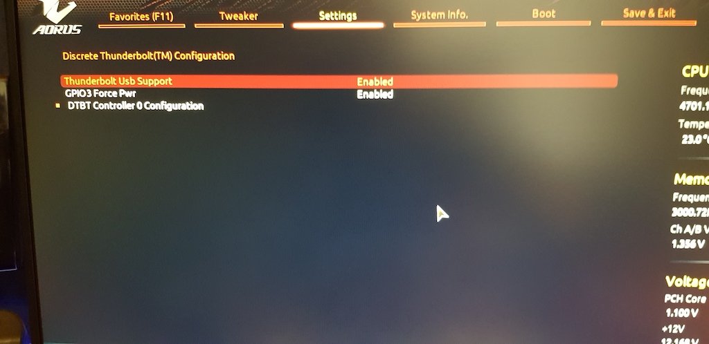

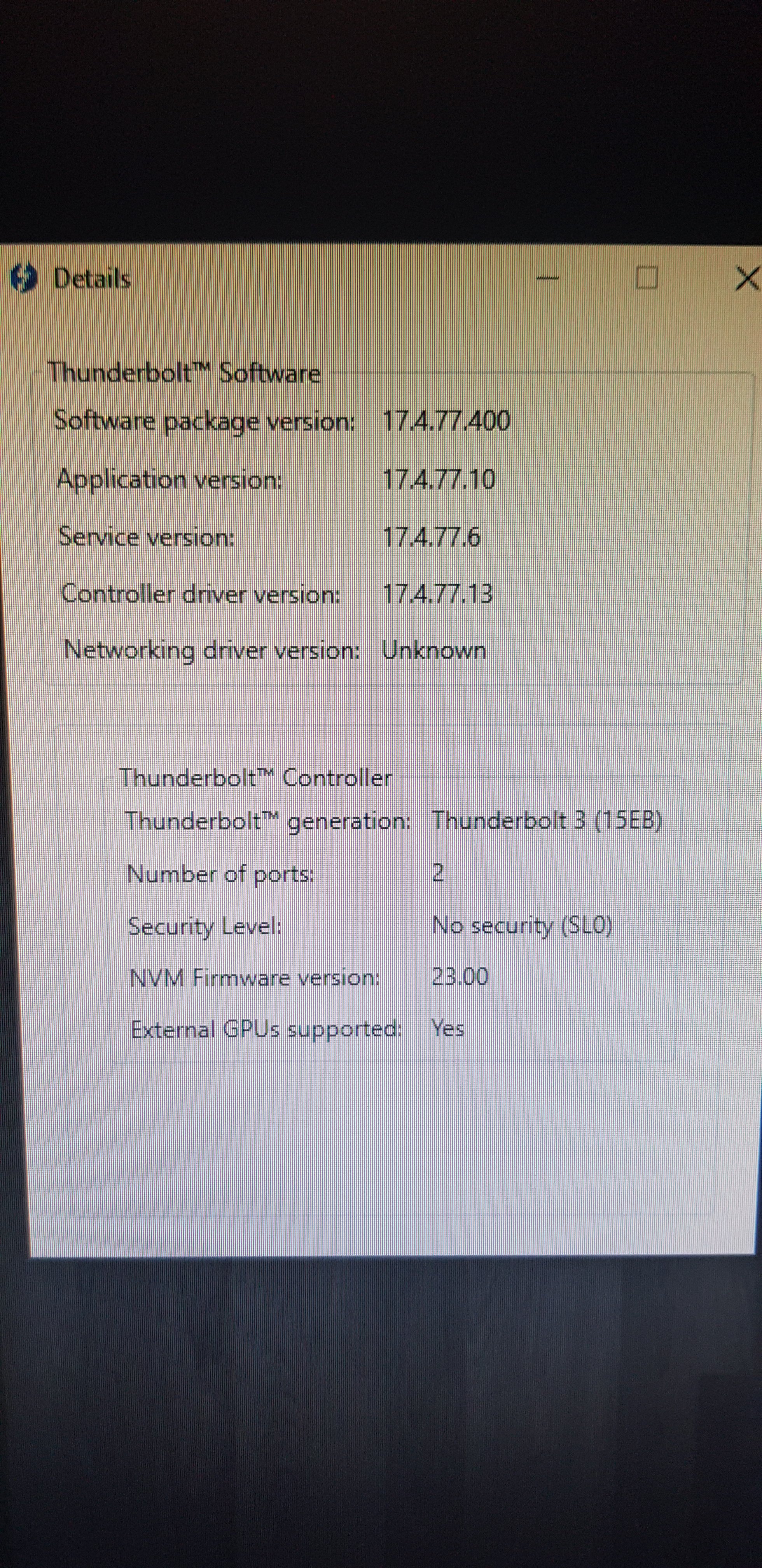

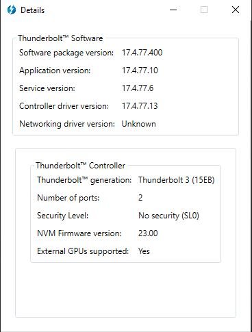

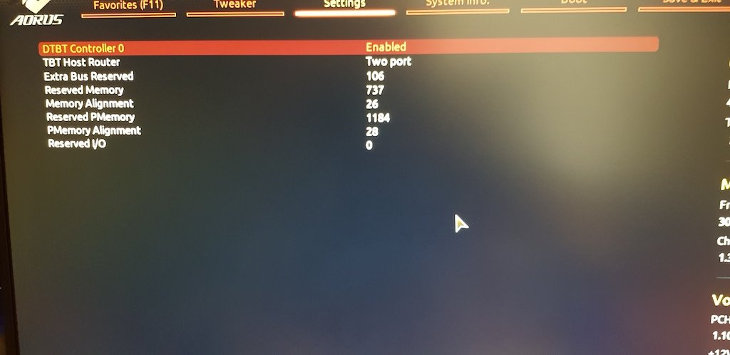

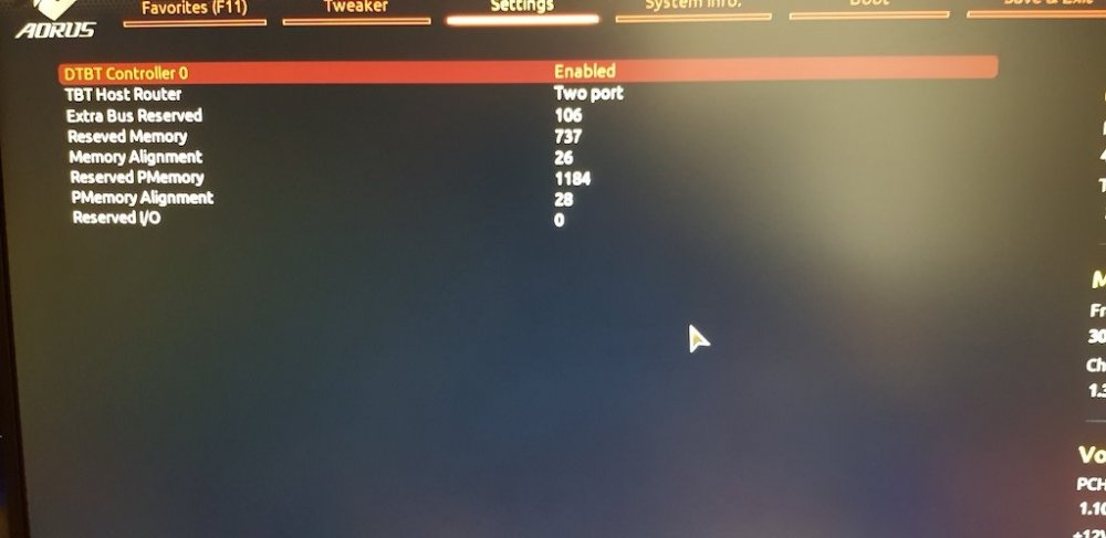

dsynos80 Posted April 4, 2020 Share Posted April 4, 2020 Audiogod, I cannot Pm with Files attached so i am posting the guide here and you can delete the post afterwards modify it as you see fit! 1: Install Gc_Titan Ridge Card in the BOTTOM slot. 2: Boot to Windows 3: Download and install the driver from Gigabyte. Correct version is 17.4.77.400 4: Reboot to Windows, then reboot to BIOS. 5: In IO Ports Menu you should now have the Thunderbolt Configuration Options 6: Enter the Correct Settings as seen in the images. 7: Reboot to Windows and go on the taskbar at the About entry of the Thunderbolt driver, it should be seen as the image provided. 8: Boot to Osx 9: Place the SSDT on Clover/ACPI/patched 10: Reboot to Osx 11: All Done!! SSDT-Z390-RP21-SLOT4-TB3HP.aml 1 1 Link to comment https://www.insanelymac.com/forum/topic/339980-audiogods-aorus-z390-pro-patched-dsdt-mini-guide-and-discussion/page/94/#findComment-2715384 Share on other sites More sharing options...
Olas Posted April 4, 2020 Share Posted April 4, 2020 1 hour ago, dsynos80 said: Audiogod, I cannot Pm with Files attached so i am posting the guide here and you can delete the post afterwards modify it as you see fit! 1: Install Gc_Titan Ridge Card in the BOTTOM slot. 2: Boot to Windows 3: Download and install the driver from Gigabyte. Correct version is 17.4.77.400 4: Reboot to Windows, then reboot to BIOS. 5: In IO Ports Menu you should now have the Thunderbolt Configuration Options 6: Enter the Correct Settings as seen in the images. 7: Reboot to Windows and go on the taskbar at the About entry of the Thunderbolt driver, it should be seen as the image provided. 8: Boot to Osx 9: Place the SSDT on Clover/ACPI/patched 10: Reboot to Osx 11: All Done!! SSDT-Z390-RP21-SLOT4-TB3HP.aml SSDT-Z390-RP21-SLOT4-TB3HP.aml this SSDT it work GC-Titan Ridge on MB Gigabyte Aorus Z390 Pro WiFi (F12c) Link to comment https://www.insanelymac.com/forum/topic/339980-audiogods-aorus-z390-pro-patched-dsdt-mini-guide-and-discussion/page/94/#findComment-2715392 Share on other sites More sharing options...
dsynos80 Posted April 4, 2020 Share Posted April 4, 2020 51 minutes ago, Olas said: SSDT-Z390-RP21-SLOT4-TB3HP.aml this SSDT it work GC-Titan Ridge on MB Gigabyte Aorus Z390 Pro WiFi (F12c) Yes mate, i have the same motherboard as you and the same bios version. End of story. Link to comment https://www.insanelymac.com/forum/topic/339980-audiogods-aorus-z390-pro-patched-dsdt-mini-guide-and-discussion/page/94/#findComment-2715398 Share on other sites More sharing options...

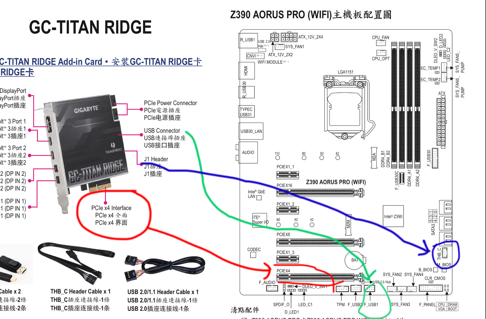

Olas Posted April 4, 2020 Share Posted April 4, 2020 16 hours ago, Project 2501 said: Here goes. Let me know if the Titan Ridge card works for you, and what device you are testing it with. If it does, it might be a problem with TB Target Disc Mode and not the card itself. I just don't have a good positive control to evaluate my results. EFI_PR2501-2020-04-03.zip Thank you very Much for Help 3 minutes ago, dsynos80 said: project2501 posted the correct EFI folder for you 5 posts back. It is the same. Thank you very Much for Help 1 Link to comment https://www.insanelymac.com/forum/topic/339980-audiogods-aorus-z390-pro-patched-dsdt-mini-guide-and-discussion/page/94/#findComment-2715403 Share on other sites More sharing options...
Olas Posted April 4, 2020 Share Posted April 4, 2020 (edited) 7 hours ago, Olas said: SSDT-Z390-RP21-SLOT4-TB3HP.aml this SSDT it work GC-Titan Ridge on MB Gigabyte Aorus Z390 Pro WiFi (F12c) Mr.dsynos80, Is this correct in the cable connection? Edited April 4, 2020 by Olas Link to comment https://www.insanelymac.com/forum/topic/339980-audiogods-aorus-z390-pro-patched-dsdt-mini-guide-and-discussion/page/94/#findComment-2715425 Share on other sites More sharing options...
dsynos80 Posted April 4, 2020 Share Posted April 4, 2020 Yes this is the correct setup. Link to comment https://www.insanelymac.com/forum/topic/339980-audiogods-aorus-z390-pro-patched-dsdt-mini-guide-and-discussion/page/94/#findComment-2715429 Share on other sites More sharing options...
Olas Posted April 4, 2020 Share Posted April 4, 2020 12 minutes ago, dsynos80 said: Yes this is the correct setup. Thank you very much Link to comment https://www.insanelymac.com/forum/topic/339980-audiogods-aorus-z390-pro-patched-dsdt-mini-guide-and-discussion/page/94/#findComment-2715430 Share on other sites More sharing options...
