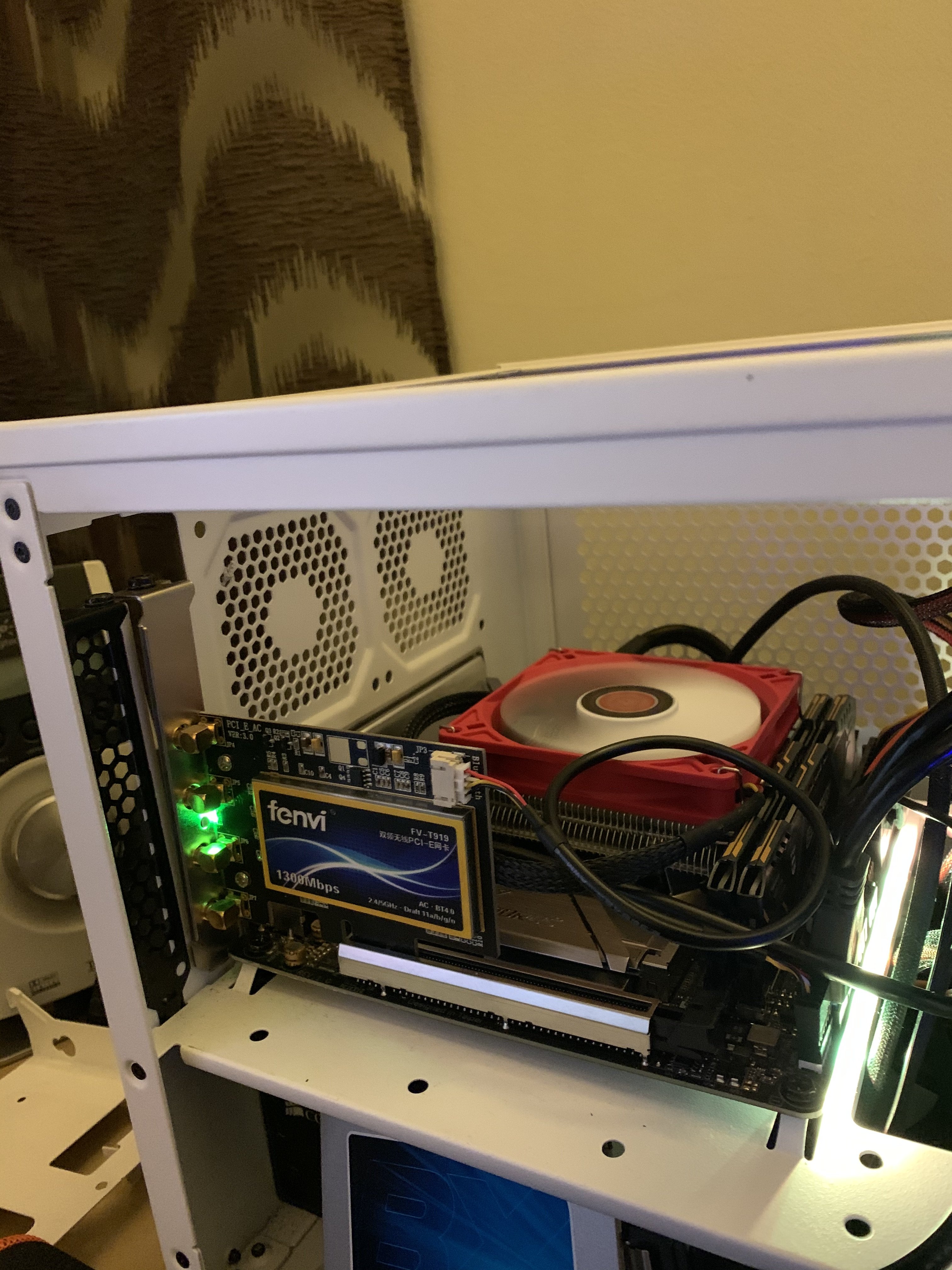

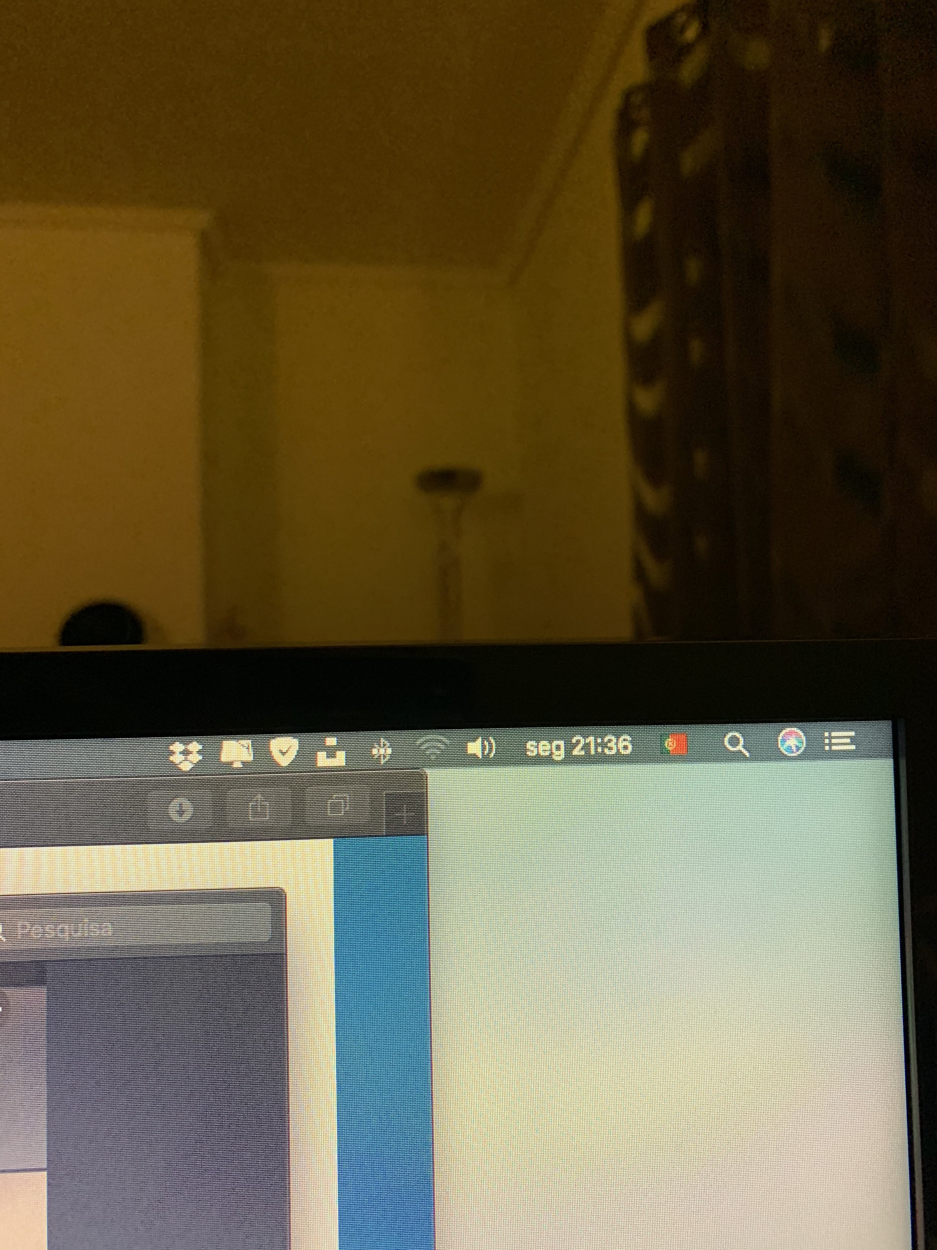

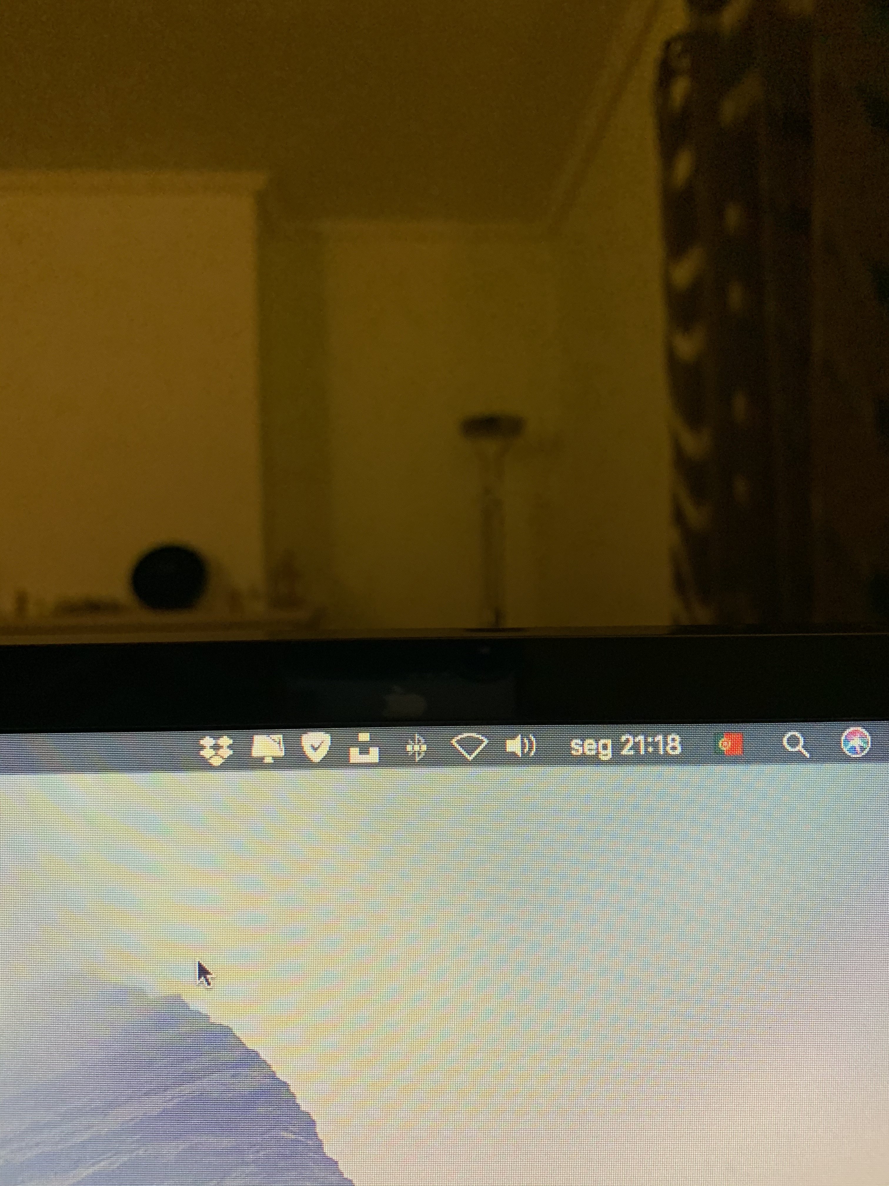

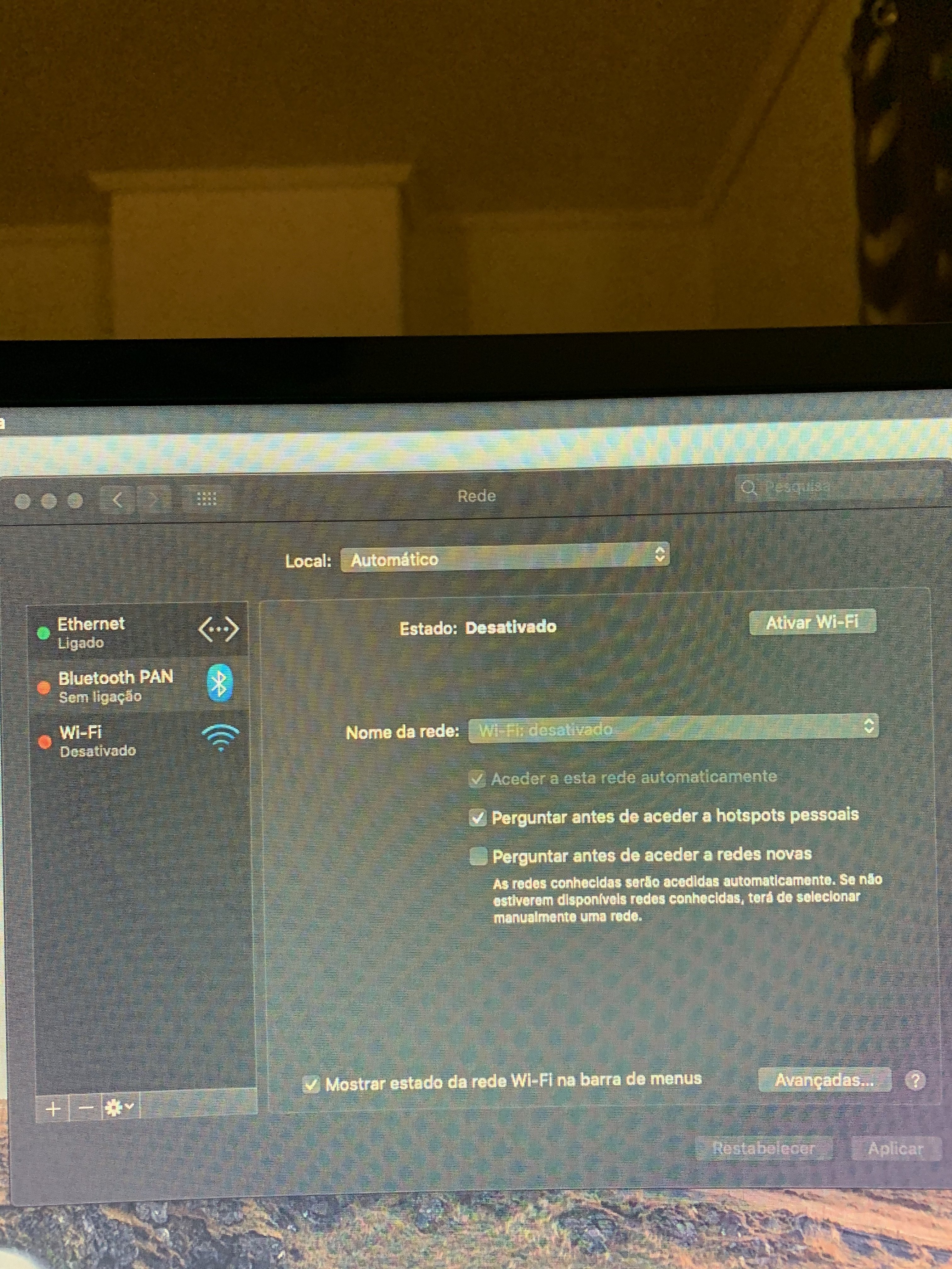

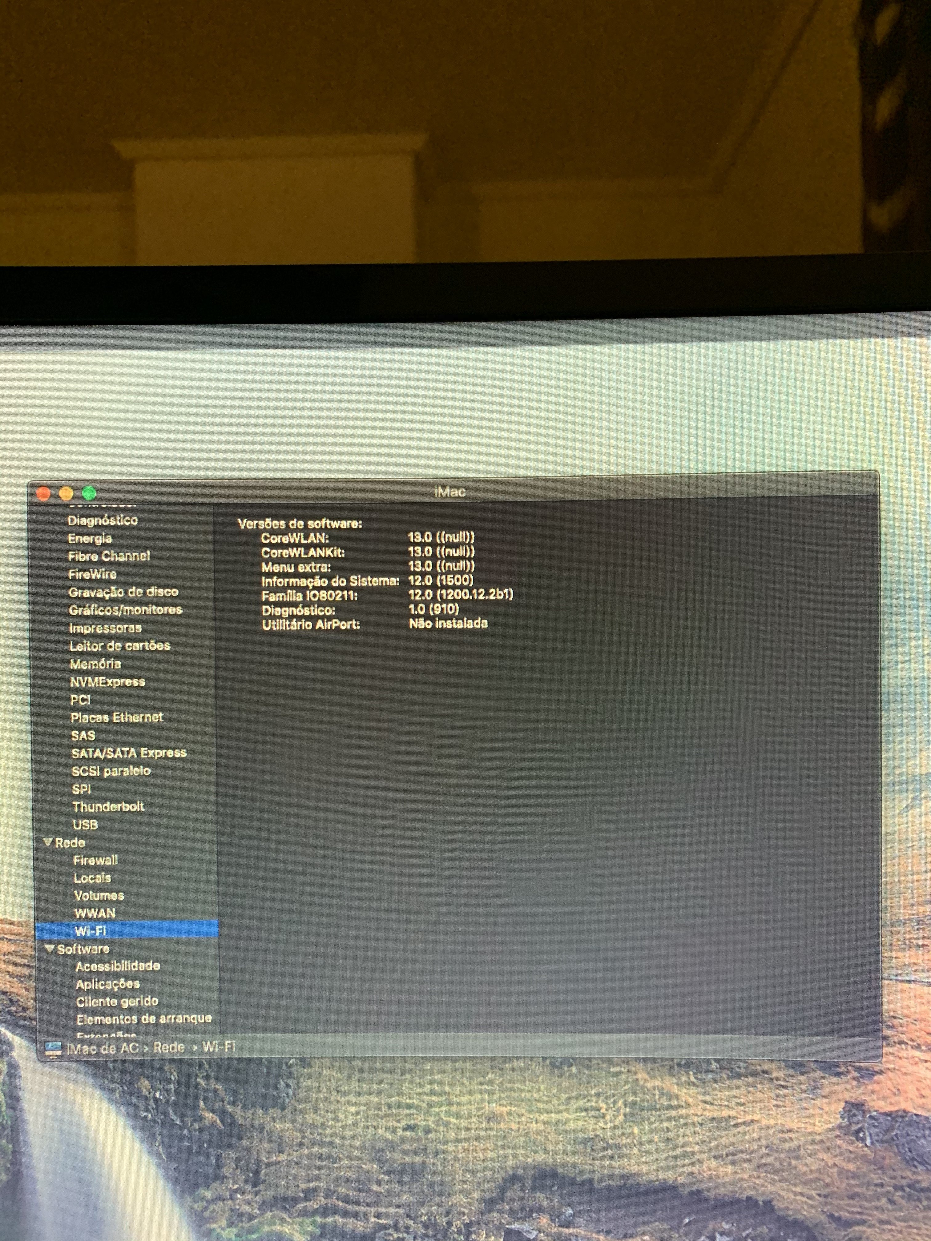

MorenoAv Posted April 13, 2020 Share Posted April 13, 2020 (edited) Hi guys, Today I resolved to install again the Fenvi -T 919 car and here it is the result: I have bluetooth but no wifi the wifi symbol appears in the bar but don't connect to any networks... here are the photos. Anyone can help me? Thanks in Advance Edited April 13, 2020 by MorenoAv Link to comment https://www.insanelymac.com/forum/topic/339980-audiogods-aorus-z390-pro-patched-dsdt-mini-guide-and-discussion/page/104/#findComment-2717288 Share on other sites More sharing options...

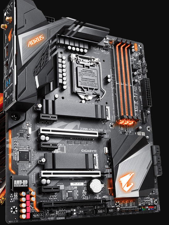

Cass67 Posted April 13, 2020 Share Posted April 13, 2020 50 minutes ago, MorenoAv said: Hi guys, Today I resolved to install again the Fenvi -T 919 car and here it is the result: I have bluetooth but no wifi the wifi symbol appears in the bar but don't connect to any networks... here are the photos. Anyone can help me? Thanks in Advance From the top picture it seems to say your wifi is inactive .. what happens when you activate it ? Do you get the interface ? Also what board is that in the picture .. looks diff from my z390 pro.. Link to comment https://www.insanelymac.com/forum/topic/339980-audiogods-aorus-z390-pro-patched-dsdt-mini-guide-and-discussion/page/104/#findComment-2717292 Share on other sites More sharing options...

Cass67 Posted April 13, 2020 Share Posted April 13, 2020 Just now, AudioGod said: @Cass67 If not mistaken that’s a Z390 I Pro WiFi Hmm looks too small to me, its why im asking .. Not enough pci-e slots, what looks to be shielding next to pci-e slot in use ... different from what i can see on gigabyte site.. Link to comment https://www.insanelymac.com/forum/topic/339980-audiogods-aorus-z390-pro-patched-dsdt-mini-guide-and-discussion/page/104/#findComment-2717294 Share on other sites More sharing options...
AudioGod Posted April 13, 2020 Author Share Posted April 13, 2020 (edited) 2 minutes ago, Cass67 said: Hmm looks too small to me, its why im asking .. Not enough pci-e slots, what looks to be shielding next to pci-e slot in use ... different from what i can see on gigabyte site.. na man not the Z390 pro WiFi the Z390 I Pro Wifi (The I stands for the ITX version ) Edited April 13, 2020 by AudioGod Link to comment https://www.insanelymac.com/forum/topic/339980-audiogods-aorus-z390-pro-patched-dsdt-mini-guide-and-discussion/page/104/#findComment-2717295 Share on other sites More sharing options...

Cass67 Posted April 13, 2020 Share Posted April 13, 2020 2 minutes ago, MorenoAv said: Hi @Cass67, Is a Z390 I Aorus Pro, as @AudioGod said, but I solved the ridle myself and now it's working as it should, I had to go to the bios and change the PCIe x16 to x8/x4 and voilá at the reboot it works... yupiiiii Thanks anyway Glad you go it fixed... that pic is totally tricking my eye then ... Below is what gigabyts site looks like Link to comment https://www.insanelymac.com/forum/topic/339980-audiogods-aorus-z390-pro-patched-dsdt-mini-guide-and-discussion/page/104/#findComment-2717298 Share on other sites More sharing options...
MorenoAv Posted April 13, 2020 Share Posted April 13, 2020 (edited) lol @AudioGod I'm glad too until yesterday I had almost lost the faith in that fenvi card, but today I had more free time and resolved to try again... This is my mini-ITX Sorry wrong picture, my bad... Edited April 13, 2020 by MorenoAv Link to comment https://www.insanelymac.com/forum/topic/339980-audiogods-aorus-z390-pro-patched-dsdt-mini-guide-and-discussion/page/104/#findComment-2717300 Share on other sites More sharing options...
AudioGod Posted April 13, 2020 Author Share Posted April 13, 2020 @Cass67 the pic your showing is a Z390 Pro WiFi (ATX) he has the Z390 I Pro WiFi (ITX) Link to comment https://www.insanelymac.com/forum/topic/339980-audiogods-aorus-z390-pro-patched-dsdt-mini-guide-and-discussion/page/104/#findComment-2717301 Share on other sites More sharing options...
