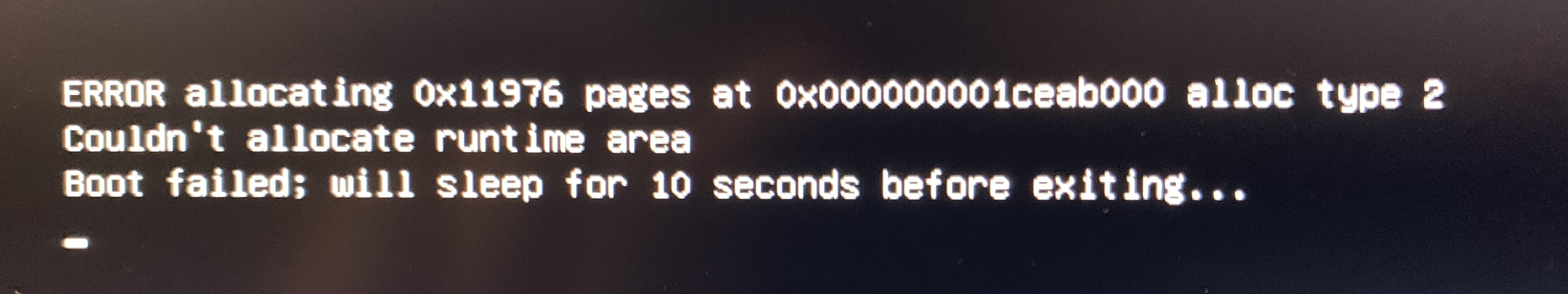

Hi AudioGod,
Still have a same problem :(
Works fine ONLY first boot after bios cleaning via your great guide (using Updated 17/12/2019) and all others boot have an error (see screenshot please) why it happened I don't understanding anymore.
3 minutes ago, velopitex said:
Hi AudioGod,
are you removing the power from the mains and then removing the battery from the motherboard for a few minutes to reset the bios fully?
you can also try reducing the Igpu memory from 64mb down too 32mb but do the bios reset properly first.
if it’s still happening after that then something is wrong with your system. Your welcome to send me your EFI to look at if you have made changes to it?
also if you don’t care about Sidecar then you can try switching the smbios to 1,1 and disable the igpu in the bios.
if it’s still happening after that then 100% something else must be causing it.
are you using my bios settings and the MSR unlocked profile?
Edited by AudioGod

Yes. Using all step-by-step in you guide.
When I replaced the OcQuirks & FwRuntimeServices with old OsxAptioFix2Drv-free2000.efi it boots again as normal, but why? Why new drivers did not work with my system. But first boot works with the OcQuirks & FwRuntimeServices fine.
P.S. I using my previous Rt Variables for registered audio soft to continue working license for this.
I mean this RT Variables:
 - Product Name: iMac19,1
 - SmUUID: my old
 - MLB: my old
 - ROM: my old
 - SmUUID: my old
 - MLB: my old
 - ROM: my old
 Try the other options I gave you and see what if any farm it down.

@velopitex Here you go pal, Replace with this EFI and put your details back and let me know if this solves it for you?
if you get any more errors after using this EFI then raise the igpu memory to 512mb :thumbsup_anim:
Edited by AudioGod

NEW Clover EFI UPDATE 3rd January 2020
The EFI has now been updated to the my latest version.
Changes made include,
OcQuirks & FwRuntimeServices Latest Revisions
MemoryAllocation.efi now added to the UEFI driver folder to fix failure to boot due to memory allocation failure at start up
Whatevergreen 1.3.6 latest Beta
Clover Updated too Revision 5102
Plus other minor tweaks to the clover config
EFI Update - 03/01/2020 - Use with Bios revision F11 Only
19,1 Aorus Z390 Pro Navi Vega EFI.zip - Vega, Navi (5700, 5700xt), Radeon VII DSDT EFI
19,1 Aorus Z390 Pro RX Polaris EFI.zip - RX5XX Polaris DSDT EFI
If you are having trouble to boot up using smbios 19,1 with iGPU enabled then make the following change to the bios
• Settings -> IO Ports -> DVMT Pre-Allocated -> 512M
You will need to reset the bios by Removing the power cable and then pulling the battery on the motherboard for a few minutes to totally clear the nvram before loading into Catalina with the new EFI for the first time.
Use the unlocked MSR Bios profile if you can and untick kernelPM in the clover config if you do use it and then make the following changes to the bios,
If you prefer using SMBios 1,1 then by all means switch to it but all the old problems of using 19,1 are corrected now with this EFI plus DRM is fully working unless you have a  Polaris gpu. Just to add, SMBios 19,1 is the correct one to be using for our chipset and cpu, if you check the spec of a real macpro it is not a using a CoffeeLake CPU or Z3xx chipset. It does work perfectlyl but correct is correct so 19,1 it is. :)
Edited by AudioGod
velopitex EFI.zip
With this EFI system boot successfully.
Fine booting with 32M and 64M of igpu memory and using my own Rt Variables details.
Thank you AudioGod the Wise !!!
P.S. I will continue testing my system with work in audio hosts and with sound in general.
