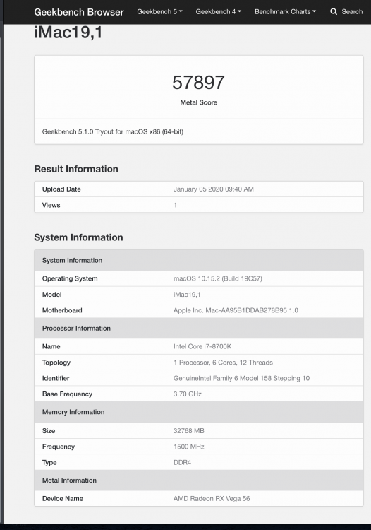

14 hours ago, AudioGod said:

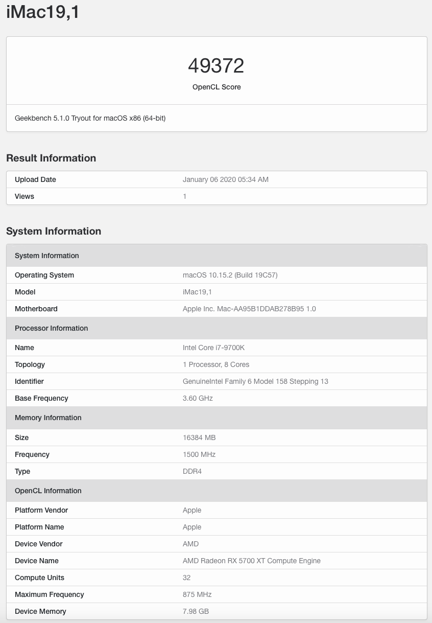

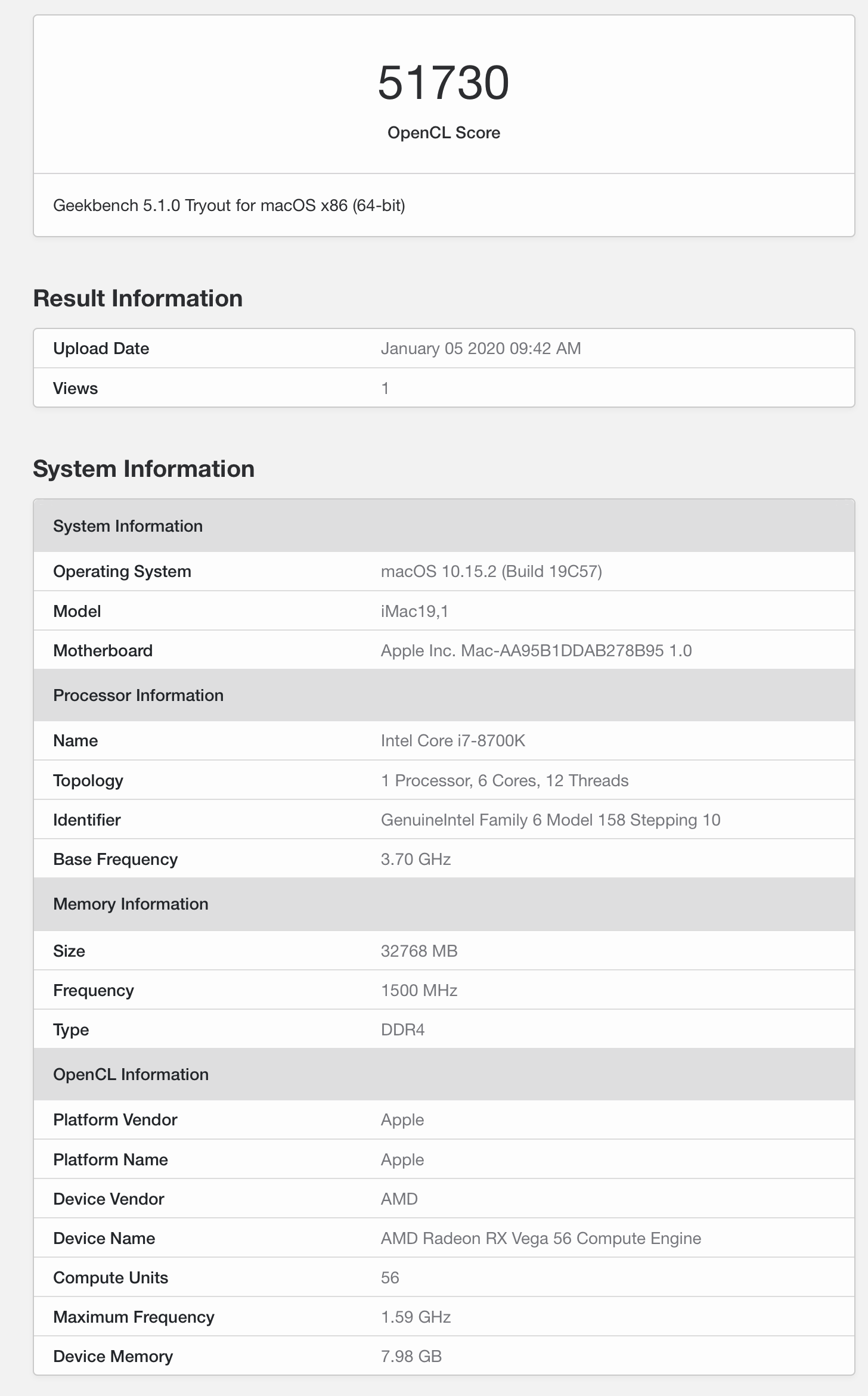

you know what, that’s the exact opposite to my results using the same gpu...lolol
That now just shows me it’s the 5700xt and the rubbish OSX drivers.
im betting them results will sway if you keep doing them.
I think that solves it but a few more 5700xt user results would be the icing on the cake.

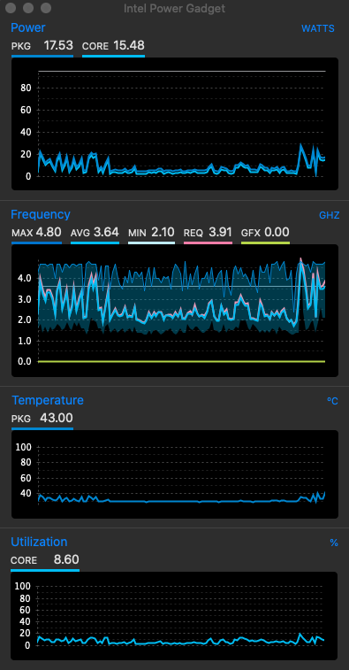

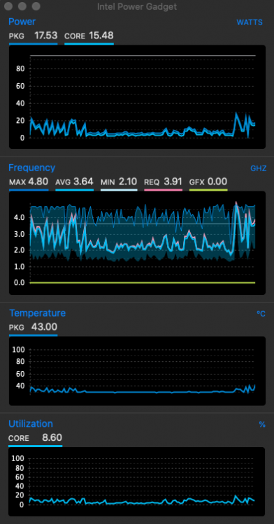

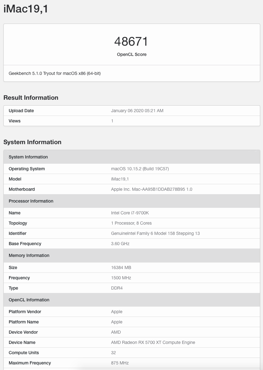

BTW, when I run the Geekbench Compute tests (Metal or OpenCL) the Intel Power Gadget does not show any GFX activity (i.e. GFX clock stays at 0), so everything is happening on the 5700.  On the other hand, when using Compressor to encode a video, the Intel GFX clock bumps up to 1.2 GHz.

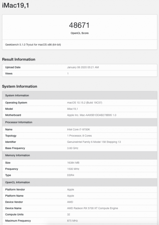

Any idea why Geekbench is detecting my Model as iMac19,1?   "About This Mac" says: iMac (Retina 5K, 27-inch, 2019).
Also, notice the "Maximum Frequency" is only 875 MHz.  It should be close to 2000.

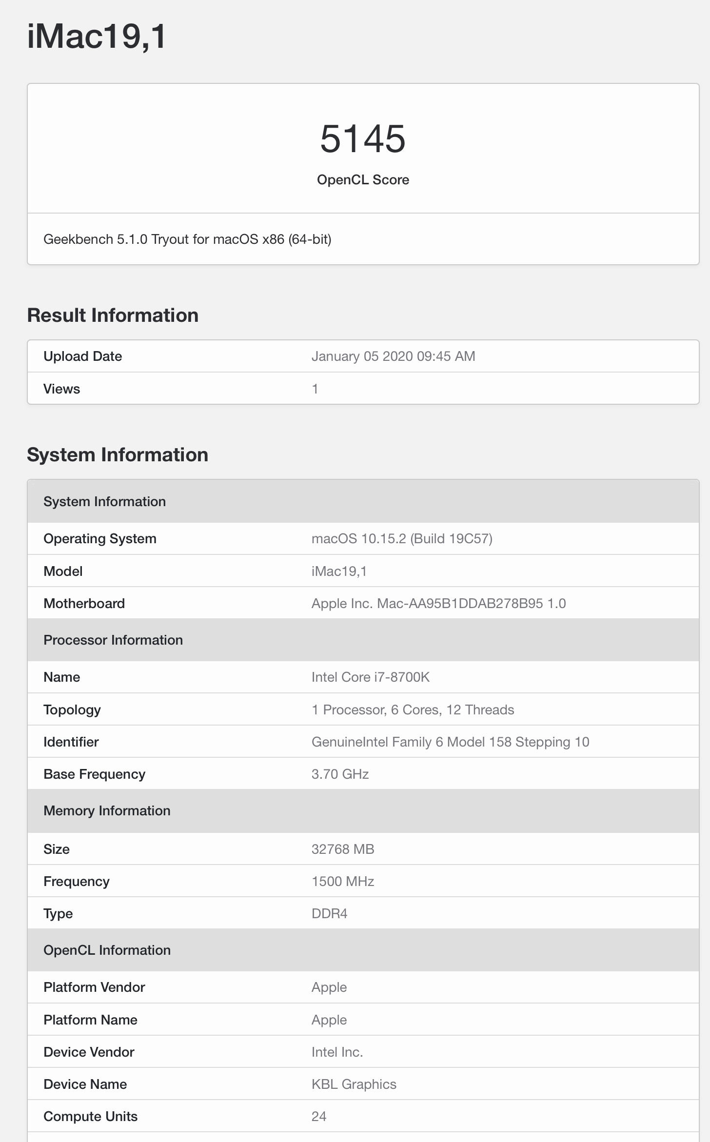

 @Sharkus the igpu being dormant is correct, it will become active when using quick sync to aid with encoding etc etc so that correct.
About your frequency’s being off, my DSDTs are not designed for your board so like I told you right at the beginning the power tables are probably going to be wrong plus more,
really you should use the link on the main guide and put in a dsdt request with MaLD0n for your system and get a dsdt done right for your build.
geekbench should show the same info as about my Mac if it doesn't then check your info and make sure it’s all correct but also and not so likely it could be down to the mismatched DSDT too.
To Create Your Own Patched DSDT Message @MaLd0n using the link bellow
https://olarila.com/forum/viewtopic.php?f=19&t=1131
(If you want a perfect setup then getting your own patched DSDT made would be the best thing to do, Mine will work perfectly fine but different hardware no matter how small a change it is can tend to have some sort of effect on the DSDT and your setup)

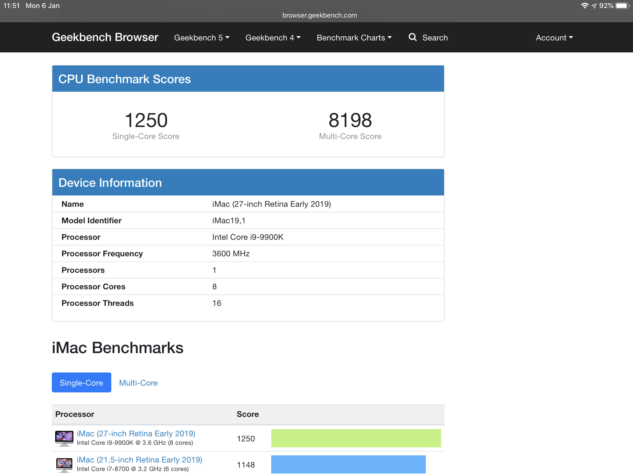

That's not true. The iMAC 9900k uses the i9-9900KF which doesn't have an Igpu. As far as I know they are using it because it runs cooler.
https://www.macobserver.com/analysis/intel-cpus-in-apples-2019-imacs-chart/
Linus also mentions it at min 3:30
https://www.youtube.com/watch?v=7jvTm9Bj9rc

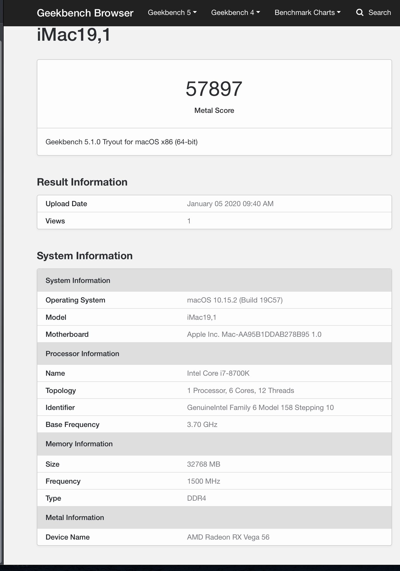

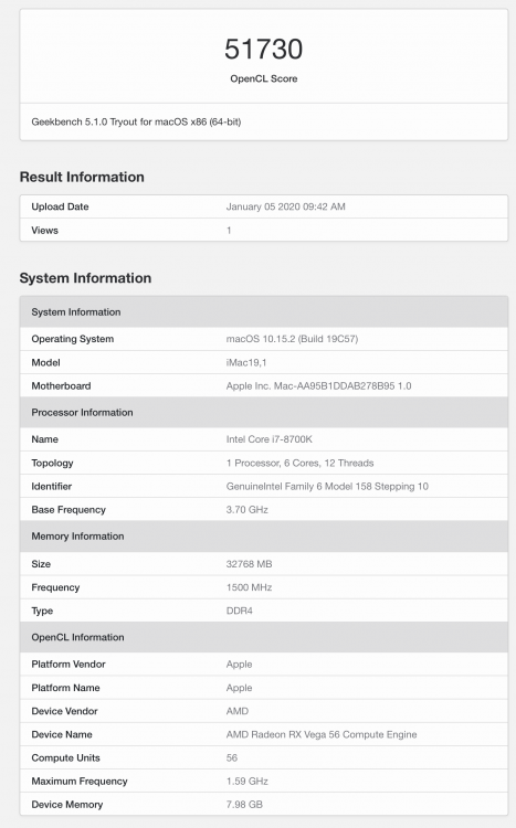

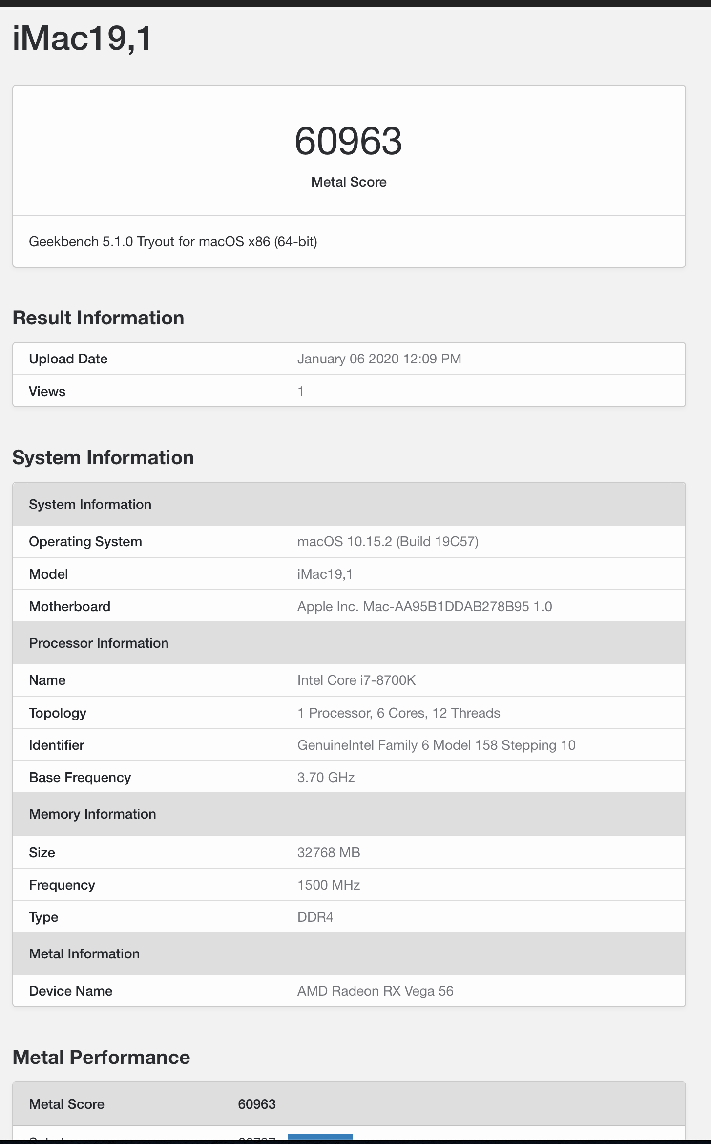

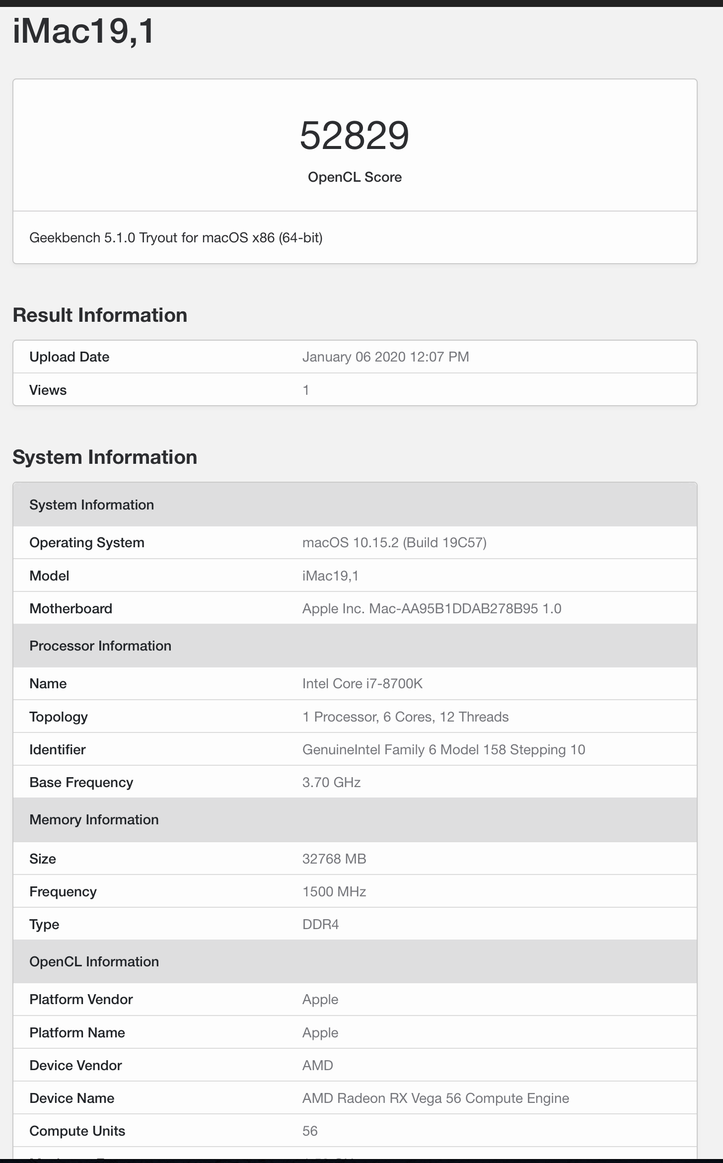

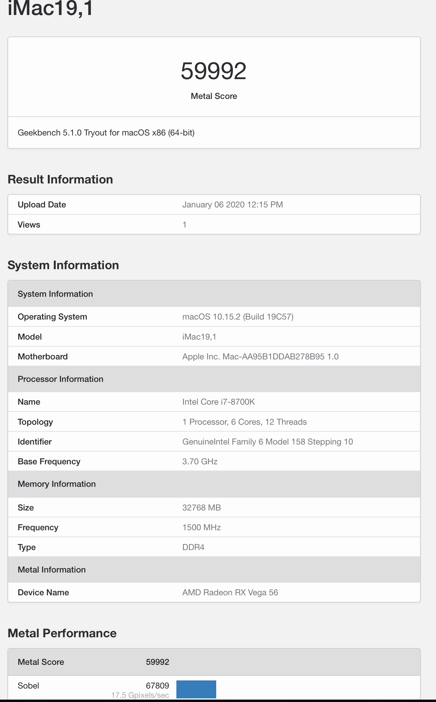

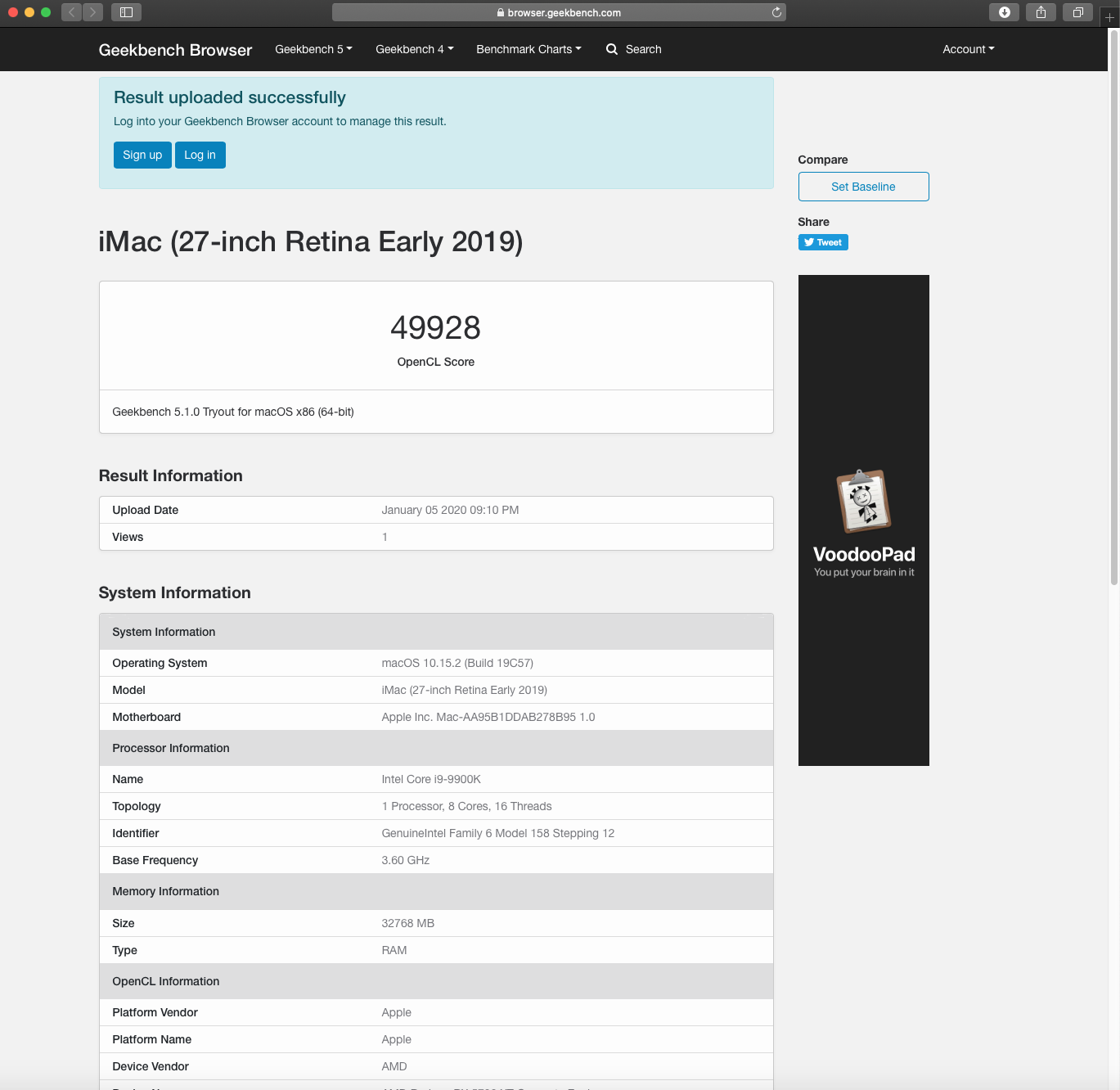

Here you go, the proof is in the pudding right so here’s a real geekbench of a iMac
is that a 9900k or 9900kf ?
Linus isn’t always right you know buddy.
Edited by AudioGod
2 minutes ago, AudioGod said:
Mate your wrong about the iMac 19,1...look it up properly.
why do you think Sidecar works on 19,1?
I’m not gonna argue with you about it though but your welcome to speak to anybody on this website and they will tell you exactly the same thing that I have.
Oh wow I'm sorry you are right. I just researched and you can find a lot of websites the claim it has the 9900KF but you find more that claim 9900k. I guess that's fake news then and Linus is wrong. Pahh. Thanks for your help.
I did a geekbench on a real iMac just to show you.
no worries mate :hysterical::hysterical:

Done some more GPU testing with GeekBench 5
System setup is no Whatevergreen.kext with InjectIntel, non headless mode ie gpu 1 is intel 630 and gpu 2 is the Vega 56...
with this setup I'm able to test the intel 630 separately but alas freezes using the Metal bench test. OpenCL is fine.
with this setup Booting is faster, Final Cut Pro is more responsive and does not drop frames with HEVC very high bit videos (tested with HEVC 4K 1.5Gb 400mbps jelly fish vid) but look below...
System now Headless with Whatevergreen...
1621805972_ScreenshotGB5.Whatevergreen.Vega56.OpenCL.thumb.png.e54f74285b09bf001a45c8064d6b73b4.png
Screenshot_GB5.WhatevergreenVega56.Metal.thumb.png.d714c24761505ed71de438039eed0143.png
I kept on running the tests and this is the average score.
Screenshot_GB5.sixthTry.Metal.Vega56.Whatevergreen..thumb.png.b96422cca90c40c59ff4bb81779d7675.png
Now with this setup I Black screen at login and have to reconnect my thunderbolt 3 monitor, but as you can see bench marks are better in headless mode but Final cut takes a hit with HEVC. I will test some more...
there’s no need to tell us your results bro as we know all of this already and like I told you from the beginning having your igpu enabled fully and not in headless mode was wrong.
your gonna take a hit in performance when you do anything that kicks in the igpu as your vega will do it better on it’s own,
One  option for you would be to use smbios 1,1 with the igpu disabled so that way your vega would be fully in charge, only downside of 1,1 is your lose Sidecar but I don’t think that’s the biggest deal personally.
lastly geekbench is one bugged out program to use and take a baseline score from as the score moves around way to much to take seriously.
I hope that all helps pal. :)
on a side note, using Catalina without WEG works for sure with the vega or navi Gpus but you lose displayport output and performance in certain scenarios like playing Rocket League take a huge hit in things like the 1% lows.
