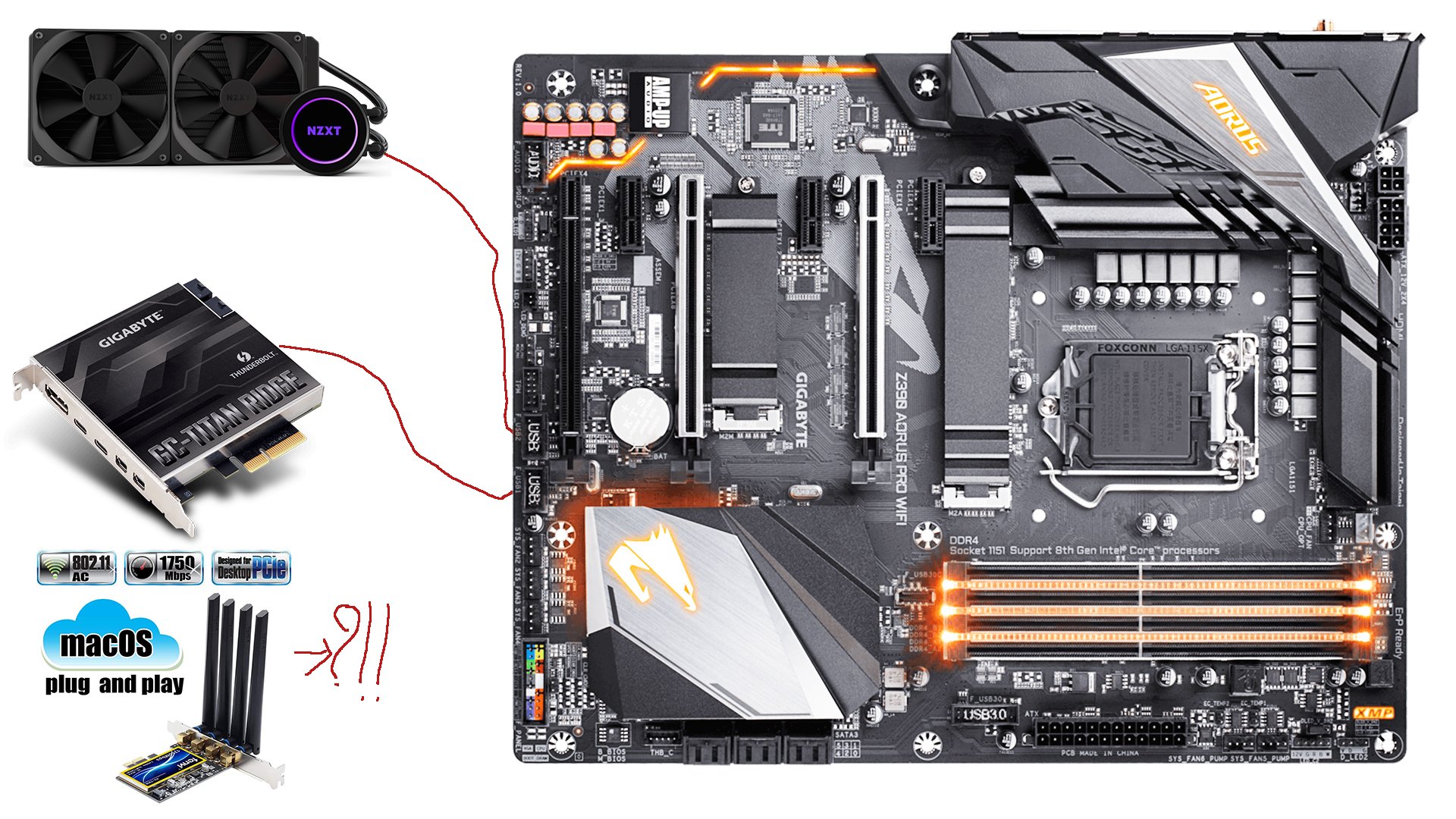

Olas Posted April 26, 2020 Share Posted April 26, 2020 Hello dear brothers, I would like to connect a fenvi card via a USB port on Motherbord z390 aorus pro wifi but all USB ports are used as follows: 1- NZXT KRAKEN X62 in F_USB2 2- GC-TITAN RIDGE in F_USB1 3- Where to connect fenvi card usb cable on motherboard ????? Or what is the solution Thank you for your cooperation Link to comment https://www.insanelymac.com/forum/topic/339980-audiogods-aorus-z390-pro-patched-dsdt-mini-guide-and-discussion/page/110/#findComment-2719352 Share on other sites More sharing options...
AudioGod Posted April 26, 2020 Author Share Posted April 26, 2020 (edited) 2 hours ago, Olas said: Hello dear brothers, I would like to connect a fenvi card via a USB port on Motherbord z390 aorus pro wifi but all USB ports are used as follows: 1- NZXT KRAKEN X62 in F_USB2 2- GC-TITAN RIDGE in F_USB1 3- Where to connect fenvi card usb cable on motherboard ????? Or what is the solution Thank you for your cooperation Three things you can do. 1, disconnect the Kraken and use that header 2. Buy a internal usb hub (your have to try multiple makes as some won’t work and some will) 3. use a external usb2 port instead using a different cable to connect the Bluetooth to the usb2 type A port. any of the above will work but be careful if you go the internal usb hub route and steer clear of anything like that made by Corsair. 6 hours ago, kernel_void said: Hi everyone, I'm using the f12d BIOS version with unlocked MSR and opencore with ssdt for the rx5700xt but I'm having trouble with sleep / awake placed in an image to better describe the problem. Thanks panic(cpu 0 caller 0xffffff8003e4c32a): Kernel trap at 0xffffff7f89873fb3, type 14=page fault, registers: CR0: 0x000000008001003b, CR2: 0x00000000000001dc, CR3: 0x000000000b3fb000, CR4: 0x00000000003626e0 RAX: 0xe6f55b7955e20060, RBX: 0x0000000000000003, RCX: 0x0000000000010002, RDX: 0x0000000000000001 RSP: 0xffffff839f7e3e20, RBP: 0xffffff839f7e3ea0, RSI: 0x0000000000000001, RDI: 0xffffff80453ed440 R8: 0x0000000000000001, R9: 0x0000000000000002, R10: 0x0000000000000000, R11: 0xffffff804463bac0 R12: 0xffffff804546c000, R13: 0x0000000000000000, R14: 0x0000000000000003, R15: 0x0000000000000000 RFL: 0x0000000000010202, RIP: 0xffffff7f89873fb3, CS: 0x0000000000000008, SS: 0x0000000000000010 Fault CR2: 0x00000000000001dc, Error code: 0x0000000000000000, Fault CPU: 0x0, PL: 0, VF: 1 Backtrace (CPU 0), Frame : Return Address 0xffffff839f7e3880 : 0xffffff8003d215cd 0xffffff839f7e38d0 : 0xffffff8003e5a3c5 0xffffff839f7e3910 : 0xffffff8003e4bf7e 0xffffff839f7e3960 : 0xffffff8003cc7a40 0xffffff839f7e3980 : 0xffffff8003d20c97 0xffffff839f7e3a80 : 0xffffff8003d21087 0xffffff839f7e3ad0 : 0xffffff80044c2c7c 0xffffff839f7e3b40 : 0xffffff8003e4c32a 0xffffff839f7e3cc0 : 0xffffff8003e4c028 0xffffff839f7e3d10 : 0xffffff8003cc7a40 0xffffff839f7e3d30 : 0xffffff7f89873fb3 0xffffff839f7e3ea0 : 0xffffff7f8985086e 0xffffff839f7e3ee0 : 0xffffff800442eb6d 0xffffff839f7e3f30 : 0xffffff800442d43e 0xffffff839f7e3f70 : 0xffffff800442ca36 0xffffff839f7e3fa0 : 0xffffff8003cc713e Kernel Extensions in backtrace: com.apple.driver.AppleIntelCFLGraphicsFramebuffer(14.0.5)[3A72441D-C2C5-3828-A5AB-B0EE077B7918]@0xffffff7f8981d000->0xffffff7f89a4ffff dependency: com.apple.iokit.IOPCIFamily(2.9)[1B1F3BBB-9212-3CF9-94F8-8FEF0D3ACEC4]@0xffffff7f84ab3000 dependency: com.apple.iokit.IOACPIFamily(1.4)[9D1FF279-C4A2-3344-902F-E0B22B508689]@0xffffff7f84aa1000 dependency: com.apple.iokit.IOAcceleratorFamily2(438.4.5)[33DA860E-90A6-3224-A944-93FA125B054E]@0xffffff7f84e46000 dependency: com.apple.iokit.IOReportFamily(47)[337B24B2-0261-3521-8D1B-23387FC1D657]@0xffffff7f8469f000 dependency: com.apple.AppleGraphicsDeviceControl(5.1.16)[56FDE242-D4A6-3E8F-A81C-CE9BA61E3828]@0xffffff7f854da000 dependency: com.apple.iokit.IOGraphicsFamily(575.1)[D47CA481-C5E5-3F03-9B04-6634DF5F3121]@0xffffff7f84db5000 BSD process name corresponding to current thread: kernel_task Boot args: dart=0 darkwake=0 agdpmod=pikera shikigva=80 Mac OS version: 19E287 Kernel version: Darwin Kernel Version 19.4.0: Wed Mar 4 22:28:40 PST 2020; root:xnu-6153.101.6~15/RELEASE_X86_64 Kernel UUID: AB0AA7EE-3D03-3C21-91AD-5719D79D7AF6 Kernel slide: 0x0000000003a00000 Kernel text base: 0xffffff8003c00000 __HIB text base: 0xffffff8003b00000 System model name: iMac19,1 (Mac-AA95B1DDAB278B95) System shutdown begun: NO Panic diags file available: YES (0x0) System uptime in nanoseconds: 2280019482297 last loaded kext at 113953988514: @filesystems.smbfs 3.4.2 (addr 0xffffff7f85e67000, size 454656) last unloaded kext at 131747801169: >!AFileSystemDriver 3.0.1 (addr 0xffffff7f84695000, size 8192) loaded kexts: could you fill in your signature system spec so anybody who wants to help you can see your exact spec. More info is needed then what your giving out I’m afraid squire. also what ssdt for the 5700xt ????? I’m Major baffled now after reading that. try removing it and see if your sleep works without it. why on earth do you have a ssdt for a 5700xt???. now you have totally lost me and raised my interest at the same time. I take it you made your own OpenCore EFI and your not using my one? Edited April 26, 2020 by AudioGod Link to comment https://www.insanelymac.com/forum/topic/339980-audiogods-aorus-z390-pro-patched-dsdt-mini-guide-and-discussion/page/110/#findComment-2719362 Share on other sites More sharing options...
