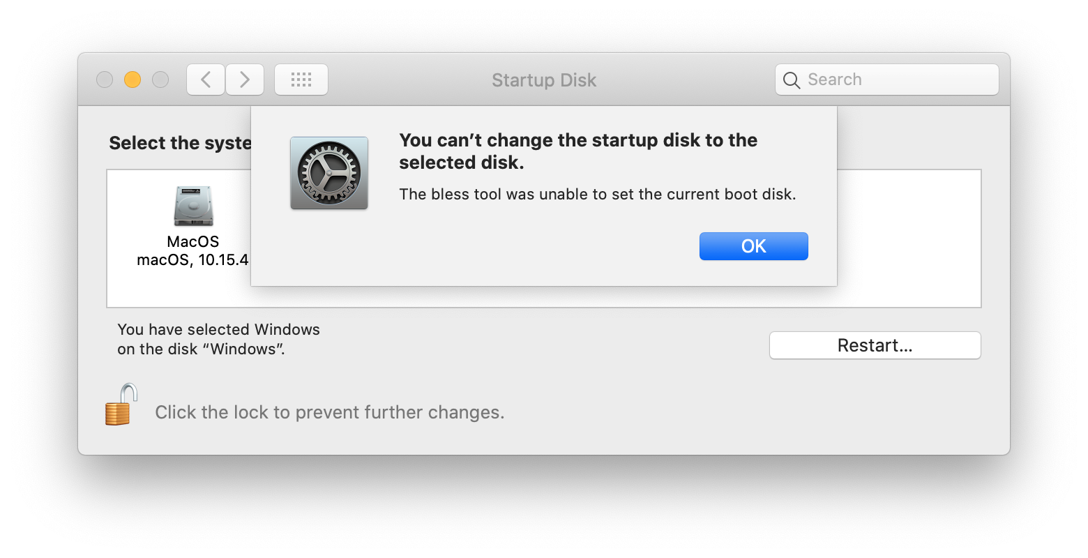

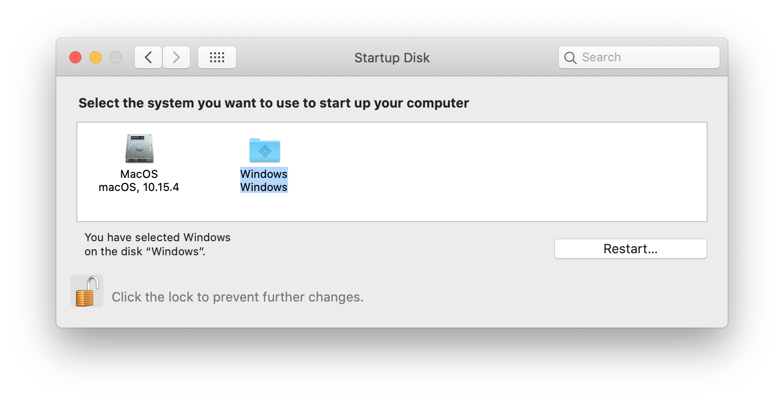

Hi @AudioGod,I switched from Clover to OC using your OC EFI OC 057 Z390 Pro EFI 19,1 060420.zip - OpenCore v0.5.7, SMBios iMac19,1 (06/04/20). All things seems to be running smooth except one issue with Windows multi-boot: I unable to set Windows startup disk from macOS "Startup Disk" tool. I able to see and select Windows option in UI, but when I press "Restart" button I got the error: "The bless tool was unable to set the current boot disk"(please look at attached snapshots). Windows installed on separate SSD formatted as GPT for UEFI booting. EFI partition present on Windows disk. I already reset NVRAM after switching to OC. All other multi-boot stuff seems to be working fine:
1. I able to set macOS as startup disk in macOS "Startup Disk" tool
2. I can boot into Windows or macOS via OC boot picker without issues
3. From Windows BootCamp tool I can set macOS or Windows as startup disk without issues and OC boot selected OS
So the issue happens only when trying to set Windows as startup disk from macOS "Startup Disk" tool. It is quite annoying because the only way to set Windows as default OS for booting is manually select it first in OC boot picker, and after that set Windows as startup disk via Windows BootCamp tool. Under Clover I don't observe this issue.

Hmmmmm that’s strange, I personally always set it via the bootpicker myself.
im not sure tbh if that’s a flaw in 0.5.7 or something else.
just tried it now and it worked for me but I’m testing 0.5.8 currently so it’s not a fair comparison.
il jump back to 0.5.7 in a little bit and see if it works for me and let you know straight away buddy.
is windows on it’s own disk?

3 minutes ago, AlexeyNikitin said:
@AudioGod, Yes, Windows installed on separate SSD formatted as GPT for UEFI booting
I shall try it on my end and report back to you my findings in the next 20 mins or so buddy. Won’t be long :)
Edited by AudioGod
Do you have Paragon NTFS for Mac installed or something similar? The Bootcamp drive wasn't showing up at all at my hack and disabling Paragon NTFS fixed it. Maybe it's the same software causing issues to you @AlexeyNikitin
I just checked Windows disk with DiskUtility and it give me the next error:
This disk doesn’t contain an EFI system partition. If you want to start up your computer with this disk or include it in a RAID set, back up your data and partition this disk. : (-69767)
I run diskutil list and see that EFI partition present on Windows disk, but it is not on a first place(Windows Recovery partition on a first place):

May be this is a cause of the issue?
