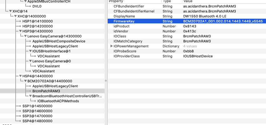

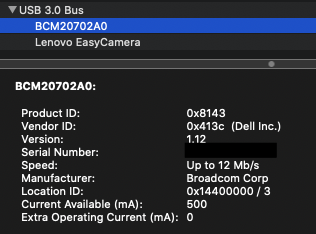

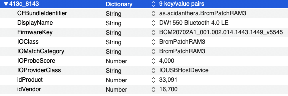

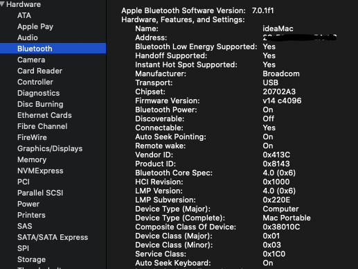

@headkaze:
My DW1550 consisted BT is USB\VID_413C&PID_8143\, tried your method as below
all kexts from your repo (v.2.5.0) into /L/E
- BrcmBluetoothInjector.kext
- BrcmFirmwareData.kext
- BrcmPatchRAM3.kext
But not working ( BT turns on, but firmware is v14 c4096 = not loaded)
Checking kextstat -i |grep -i brcm :
... as.lvs1974.AirportBrcmFixup (2.0.4) 88D30B81-6FB9-3109-9692-B3E7192CF04A <42 18 13 8 6 5 3 2 1>
... com.apple.driver.AirPort.BrcmNIC (1400.1.1) E7D99C63-B581-3CFF-B979-8EEA0D08BAE0 <84 83 82 81 18 13 8 7 6 5 3 1>
... com.apple.driver.AirPort.Brcm4360 (1400.1.1) 5B3F9150-E4F1-3E8D-AED6-A8C541B67479 <84 83 82 18 13 8 7 6 5 3 1>
... as.acidanthera.BrcmFirmwareStore (2.5.0) E0839E7B-E8F1-30F0-9447-DDEA68AFAA0B <6 5 3>
... as.acidanthera.BrcmPatchRAM3 (2.5.0) A6812F3E-DF9B-36F3-966B-FE592C6EBFDA <158 27 6 5 3 1>
BrcmPatchRam3.kext loaded???
Checking BrcmPatchRAM3, my BT module is implemented:
But why FW not loaded?
w.r.t. USB port limitation/reassignment, my model doesn't need extra USB ports(BT is on HS04), thus no extra SSDT-USB.aml, is that OK?
please help.
BTW: how do you define the value for IOProbeScore, e.g. I saw you have sometime 3000 or 4000:
          <key>IOProbeScore</key>
            <integer>4000</integer>
Does it need a recompiling or just edit the org. BrcmPatchRAM2.kext/info.plist?
many thanks!

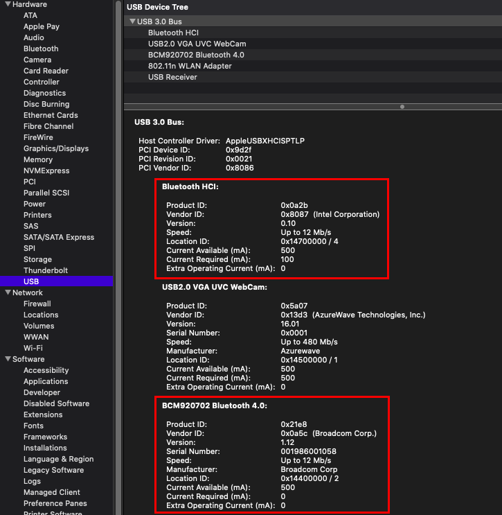

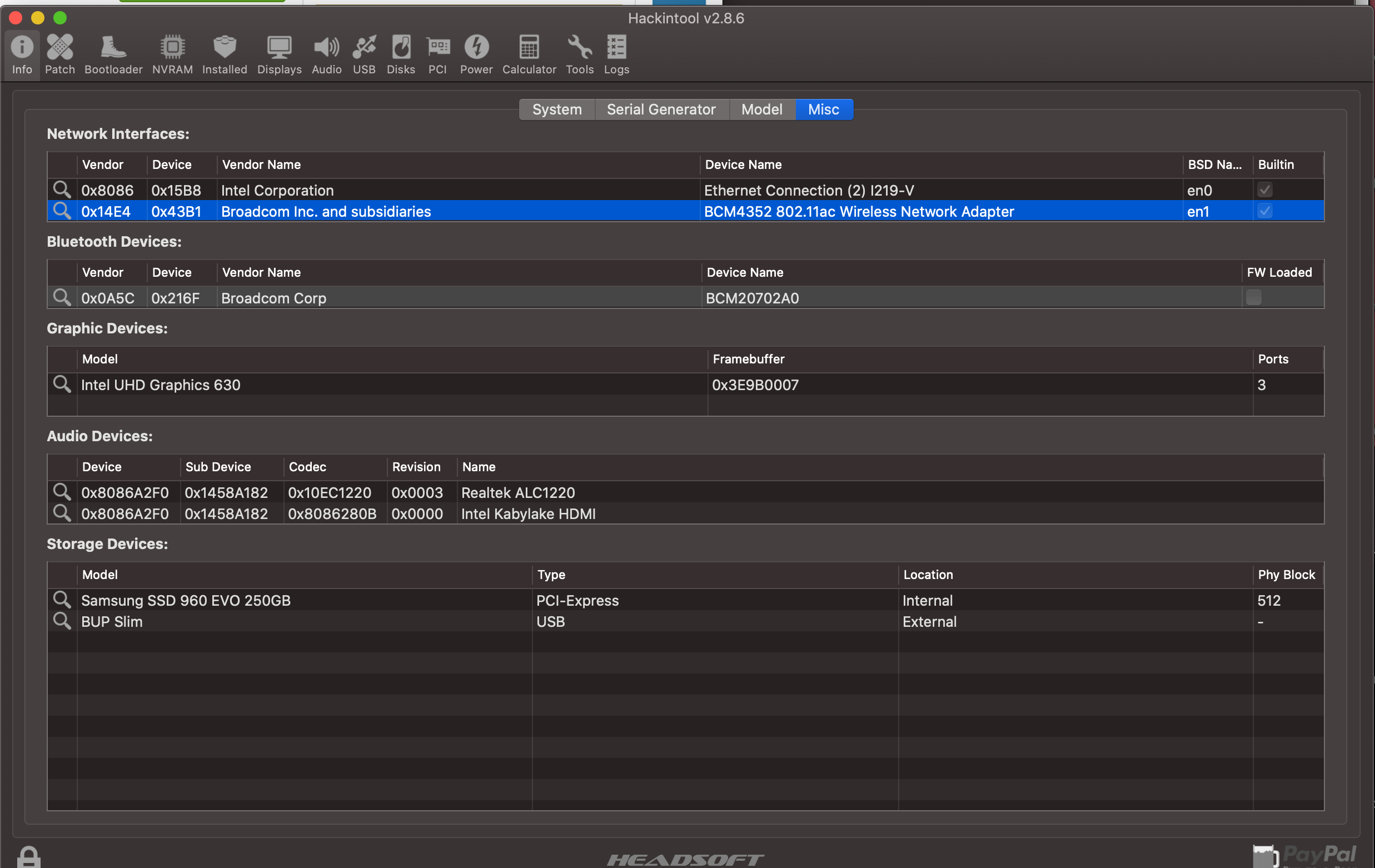

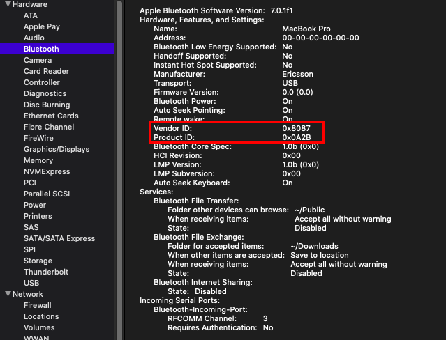

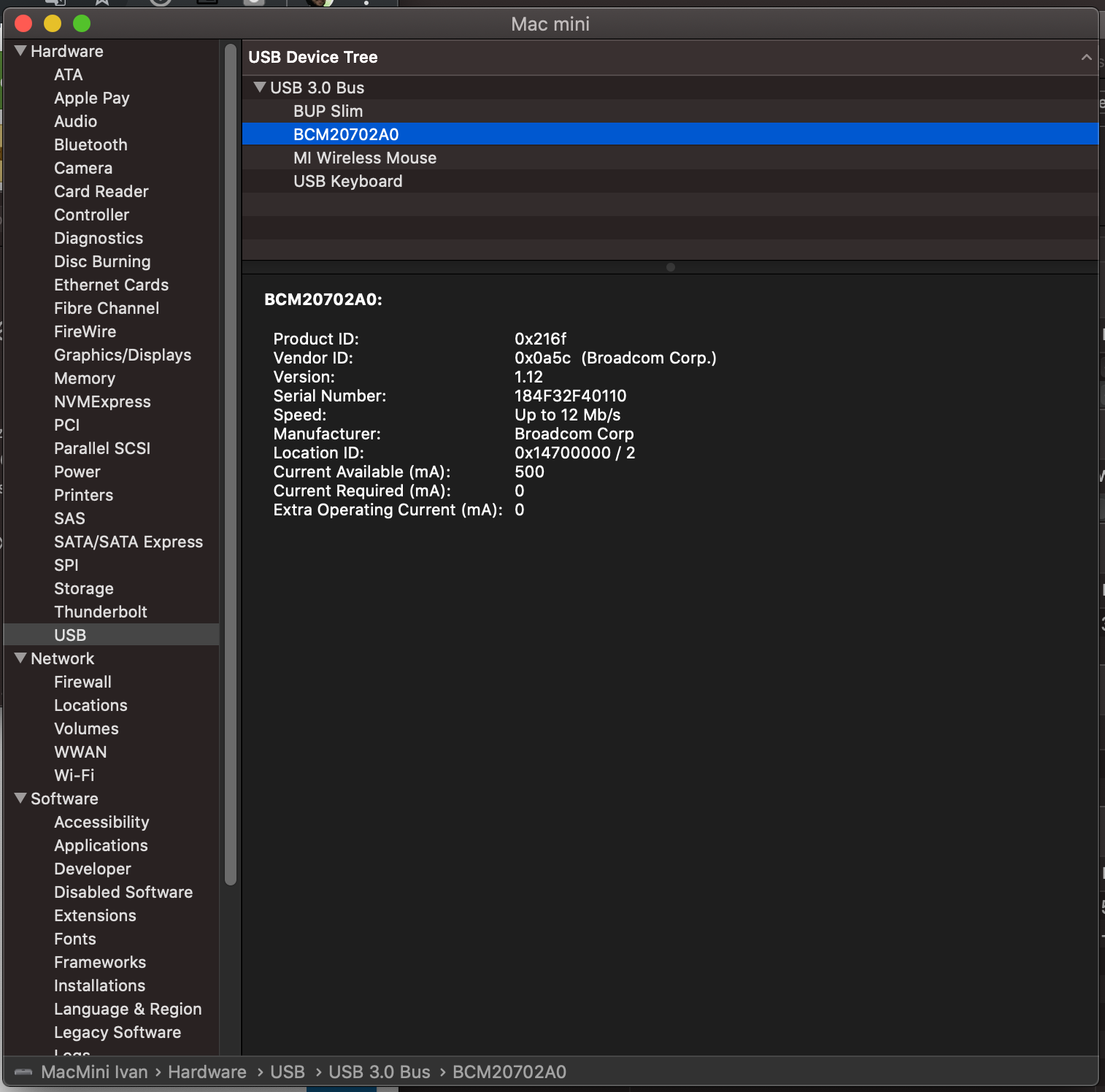

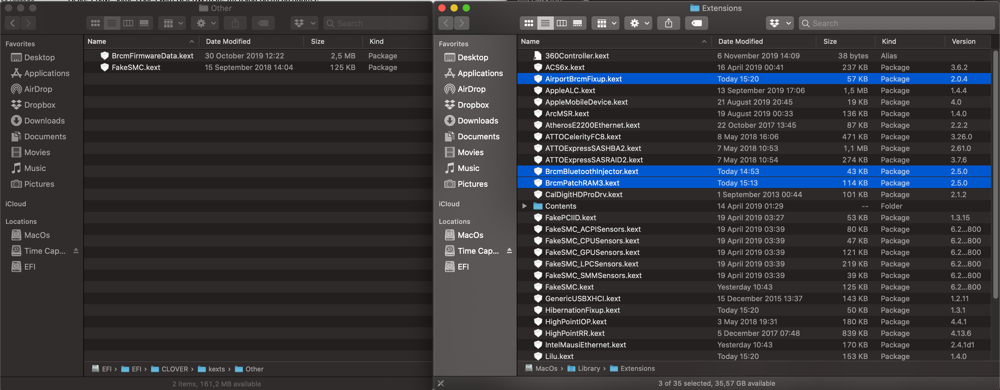

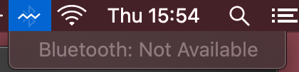

Hi guys,
My bluetooth stopped working from nowhere since yesterday when I was using mojave. I updated to Catalina and did exactly what the first post says (even my bt chipset, my vendor and product ids are the same but I still get "Not available" in bluetooth. I also get no FW Loaded in hackintool using brcmpatch3 (I manage to get it checked using brcmpatchram2 but it made no difference).  Wifi is normal though..
I have the bt module shown on USB on system report but the bluetooth section is blank.
Does someone have any idea? I see a lot of people getting it to work and I'm being afraid it could be a problem in my board. :(
On 12/5/2019 at 8:59 PM, ivan_htp said:
Hi guys,
Check what you have in /Library/Extensions
Mount root partition in write mode. Remove bluetooth related kexts, rebuild cache, reboot. Install three kexts, rebuild cache and reboot. See if that helps.
Kexts are:
BrcmPatchRAM3.kext
Edited by sash11

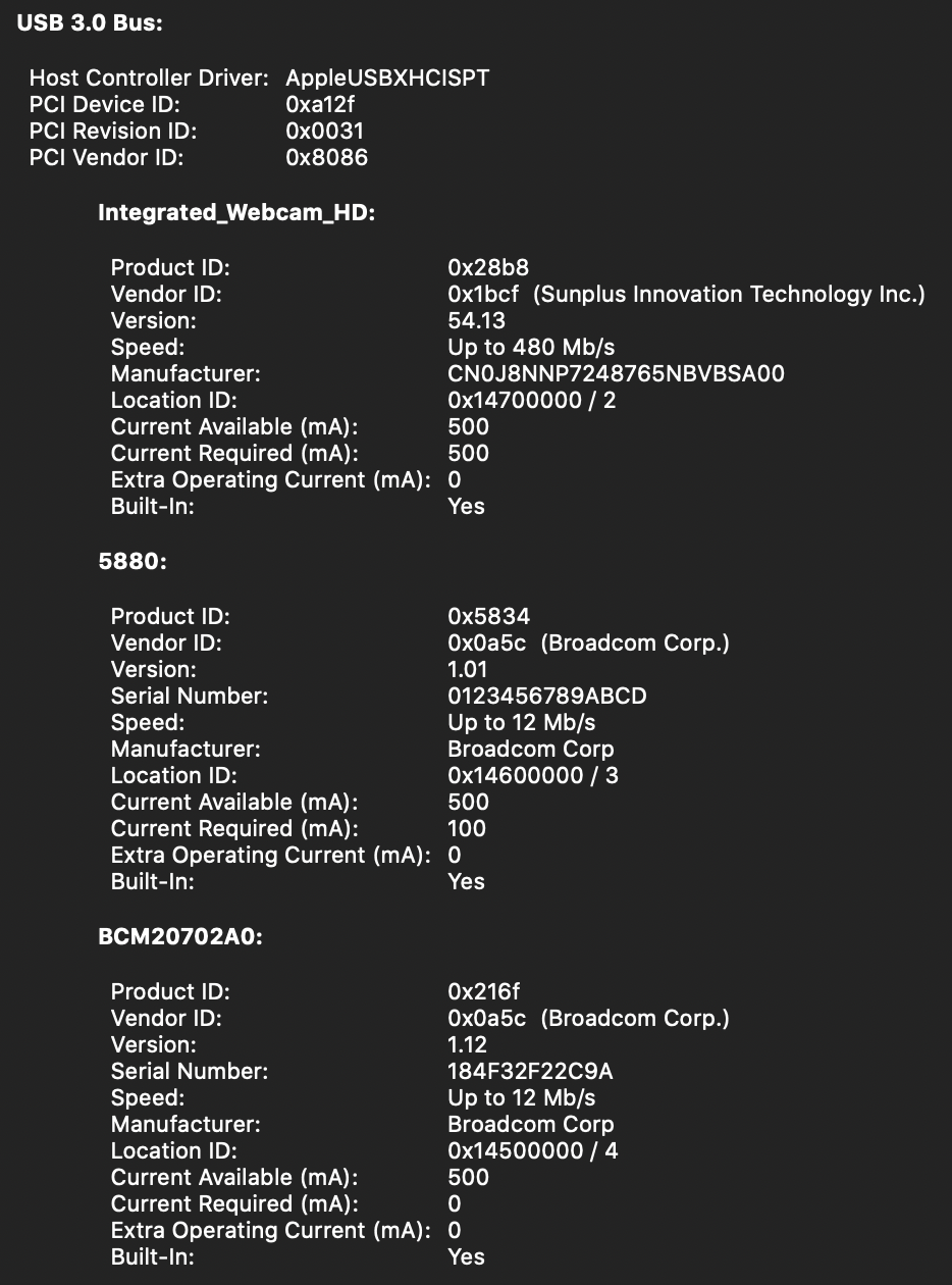

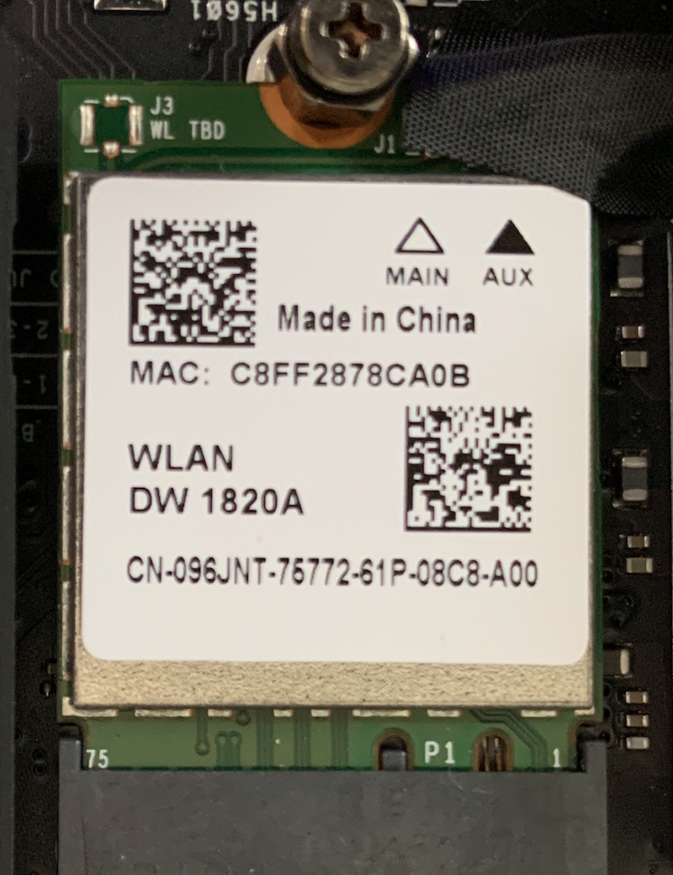

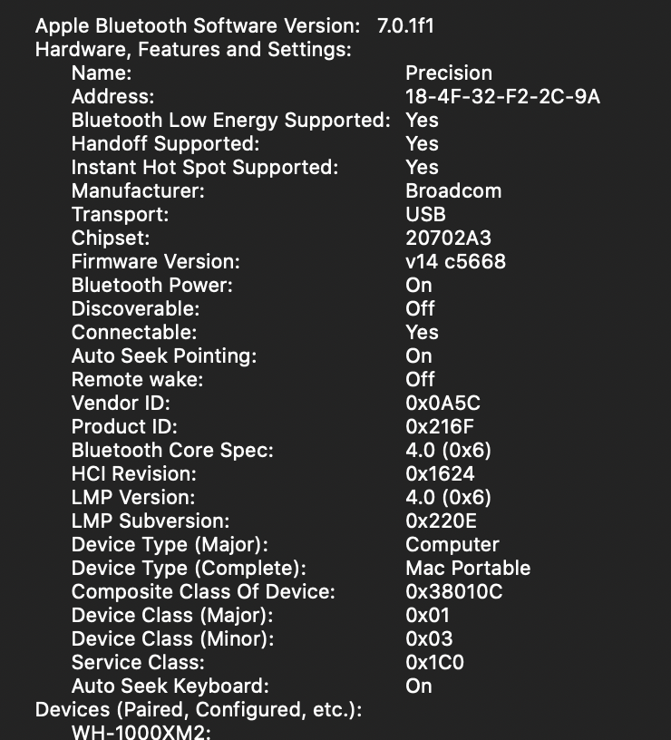

Hey guys, I am currently running macOS 10.15.2 with a DW 1820A (CN-096JNT) (Image attached) and cannot get Bluetooth to connect to devices (Handoff and Continuity appear to work though)
I currently have the following Kexts installed:
  • AirportBrcmFixup.kext (2.0.4)
  • BrcmBluetoothInjector.kext (2.5.0)
  • BrcmFirmwareData.kext (2.5.0)
  • BrcmPatchRAM3.kext (2.5.0)
here is a log of last boot that shows that the firmware upgrade is not needed.
❯ log show --last boot | grep -i 'brcmf\|brcmp'
2019-12-13 08:45:00.810589+1300 0x2e1      Error       0x0                  105    0    kextd: (IOKit) [com.apple.kext:kextlog] Unable to determine realpath for /Library/Extensions/BrcmFirmwareData.kext - failing.
2019-12-13 08:45:01.102734+1300 0x2e1      Error       0x0                  105    0    kextd: (IOKit) [com.apple.kext:kextlog] Unable to determine realpath for /Library/Extensions/BrcmFirmwareData.kext - failing.
2019-12-13 08:45:01.176524+1300 0x2e1      Error       0x0                  105    0    kextd: (IOKit) [com.apple.kext:kextlog] Unable to determine realpath for /Library/Extensions/BrcmFirmwareData.kext - failing.
2019-12-13 08:45:01.197461+1300 0x2e1      Error       0x0                  105    0    kextd: (IOKit) [com.apple.kext:kextlog] Unable to determine realpath for /Library/Extensions/BrcmFirmwareData.kext - failing.
2019-12-13 08:45:01.207153+1300 0x1a3      Default     0x0                  0      0    kernel: (BrcmFirmwareData) BrcmPatchRAM: Loaded compressed embedded firmware for key "BCM4350C5_003.006.007.0222.4689_v8785".
2019-12-13 08:45:01.207398+1300 0x1a3      Default     0x0                  0      0    kernel: (BrcmFirmwareData) BrcmPatchRAM: Decompressed firmware (12582 bytes --> 31740 bytes).
2019-12-13 08:45:01.207621+1300 0x1a3      Default     0x0                  0      0    kernel: (BrcmFirmwareData) BrcmPatchRAM: Firmware is valid IntelHex firmware.
2019-12-13 08:45:01.307830+1300 0x1a3      Default     0x0                  0      0    kernel: (BrcmPatchRAM3) BrcmPatchRAM: [0a5c:6412]: USB [C8FF2878CA0C v274] "BCM2045A0" by "Broadcom Corp"
2019-12-13 08:45:01.314413+1300 0x1a3      Default     0x0                  0      0    kernel: (BrcmPatchRAM3) BrcmPatchRAM: [0a5c:6412]: Firmware upgrade not needed.
2019-12-13 08:45:01.314506+1300 0x1a3      Default     0x0                  0      0    kernel: (BrcmPatchRAM3) BrcmPatchRAM: Processing time 0.106 seconds.
System Profiler shows the following info
Name:                         	  Office Mac mini
Address:                          C8-FF-28-78-CA-0C
Bluetooth Low Energy Supported:   Yes
Handoff Supported:                Yes
Instant Hot Spot Supported:       Yes
Manufacturer:                     Broadcom
Transport:                        USB
Chipset:                          Unknown (6e)
Firmware Version:                 v7 c4689
Bluetooth Power:                  On
Discoverable:                     Off
Connectable:                      Yes
Auto Seek Pointing:               On
Remote wake:                      On
Vendor ID:                        0x0A5C
Product ID:                       0x6412
Bluetooth Core Spec:              4.1 (0x7)
HCI Revision:                     0x1251
LMP Version:                      4.1 (0x7)
LMP Subversion:                   0x6607
Device Type (Major):              Computer
Device Type (Complete):           Mac Portable
Composite Class Of Device:        0x38010C
Device Class (Major):             0x01
Device Class (Minor):             0x03
Service Class:                    0x1C0
Auto Seek Keyboard:               On
Hackintool shows the following for the PCI info
VID  DID  SVID SDID Vendor Name                    Device Name                                        Class Name           SubClass Name        IOReg Name      IOReg IOName    Device Path
14E4 43A3 106B 0022 Broadcom Inc. and subsidiaries BCM4350 802.11ac Wireless Network Adapter          Network controller   Network controller    PCI0.RP03.ARPT pci14e4,43a3    PciRoot(0x0)/Pci(0x1c,0x2)/Pci(0x0,0x0)
Does anyone have any diagnostic steps I can take to try and get Bluetooth devices to connect?
Edited by WingmanNZ
Transport:                        USB
Bluetooth Power:                  On
Discoverable:                     Off
Connectable:                      Yes
Remote wake:                      On
Vendor ID:                        0x0A5C
Product ID:                       0x6412
i have exactly the same card/ I managed to get working, using BrcmPatchRAM2.kext. and yes, on Catalina. thru, It have some interferences with wifi.
Try Kexts from the below link. They are modified for DW 1820A. Works great on my system.
https://osxlatitude.com/forums/topic/11540-dw1820a-the-general-troubleshooting-thread/?do=findComment&amp;comment=92833
