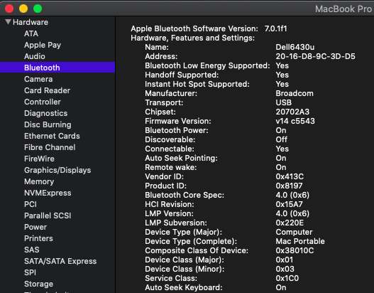

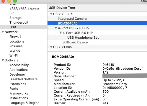

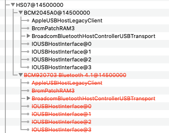

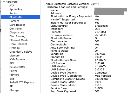

using the 3 kext with bcmPatchRam3 for DW1830, Airdrop is not stable and IOREG shows under XHC confusing BT module after wake-up from sleep:
DW1830 should be BCM20703 BT 4.1(fresh boot), but wake-up turns to be BCM2045A0!  Where to debug pls?
also System Report under USB is BCM2045A0, but under Bluetooth is BCM20703:
SysRep-BT.png.8e81d3f7fa1ac158d761ef8cb2f0dc9e.pngSysRep-USB.png.28c35a7711ebfe7903655caeb2b2fd10.png
DW1830 was working well under HS 10.13.6, so that USB port injection etc. should be correct.

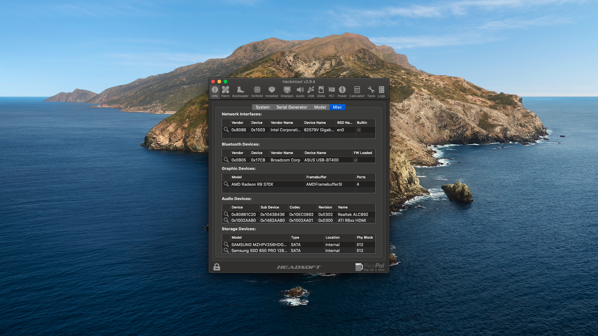

to /L/E, however, I can only get bluetooth to work after I unplug the Asus BT-400 adapter and plug it back in before it detects my magic keyboard and mouse on the login screen. Is there any fix for this?

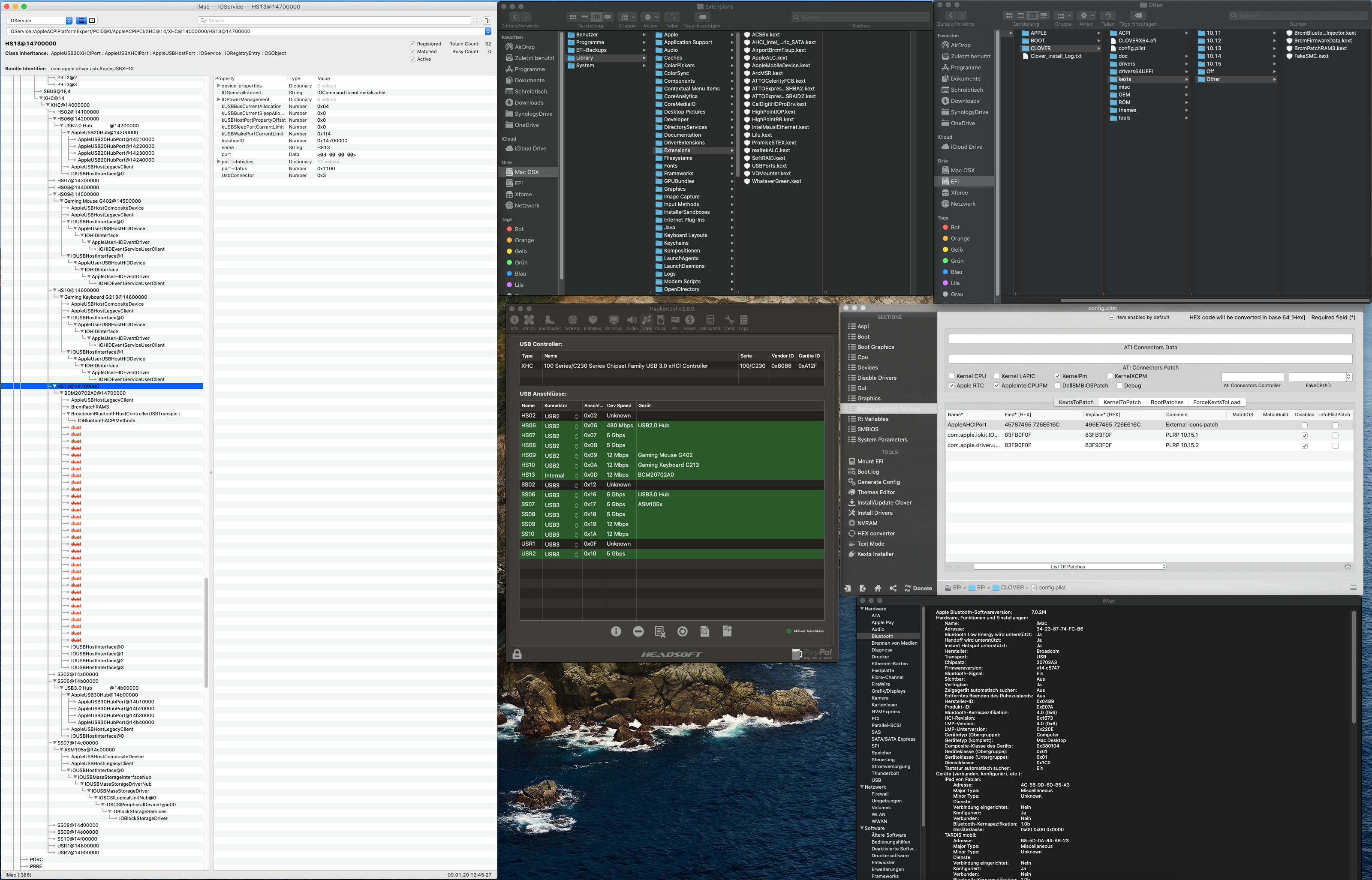

Hello,
First of all thanks for the great tutorial. Bluetooth is now working for me. I had worked with USBinjectall.kext before and the BcrmPatch3.kext did not work. After I created my own USBport.kext, Bluetooth worked. I have USBPorts.kext in L/E. The BrcmBluetoothInjector.kext, BrcmFirmwareData.kext and BcrmPatchRAM3.kext is in clover/kexts/other . My problem. Bluetooth is running, but my wired mouse hangs every 10-20 seconds. Does anyone know any advice? I have attached everything else as a screenshot.  My guess is that my USBPort.kext is not correct. My chipset is a Z170 (Skylake 6600K and the mainboard ASUS z170i Gaming Pro). I have attached the Info.plist from USBPort.kext and my config.plist. Thanks for the help.
config.plist
Info.plist

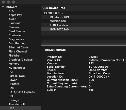

Anybody has suggestions if the firmware upgrade is successful from the logs but doesnt show up in systemInfo ?
(kernel) BrcmPatchRAM: Retrieved cached firmware for "BCM20702A1_001.002.014.1502.1764_v5860".
(BrcmPatchRAM3) BrcmPatchRAM: [0a5c:21e8]: DOWNLOAD MINIDRIVER complete (status: 0x00, length: 4 bytes).
(BrcmPatchRAM3) BrcmPatchRAM: [0a5c:21e8]: State "Firmware version" --> "Mini-driver complete".
(BrcmPatchRAM3) BrcmPatchRAM: [0a5c:21e8]: END OF RECORD complete (status: 0x00, length: 4 bytes).
(BrcmPatchRAM3) BrcmPatchRAM: [0a5c:21e8]: State "Instruction write" --> "Firmware written".
(BrcmPatchRAM3) BrcmPatchRAM: [0a5c:21e8]: RESET complete (status: 0x00, length: 4 bytes).
(BrcmPatchRAM3) BrcmPatchRAM: [0a5c:21e8]: State "Firmware written" --> "Reset complete".
(BrcmPatchRAM3) BrcmPatchRAM: [0a5c:21e8]: Device reset.
(BrcmPatchRAM3) BrcmPatchRAM: [0a5c:21e8]: Device status 0x00000003.
(BrcmPatchRAM3) BrcmPatchRAM: [0a5c:21e8]: State "Reset complete" --> "Update complete".
(BrcmPatchRAM3) BrcmPatchRAM: [0a5c:21e8]: Firmware upgrade completed successfully.
(BrcmPatchRAM3) BrcmPatchRAM: Processing time 0.885 seconds.
(BrcmPatchRAM3) BrcmPatchRAM: setPowerState: which = 0x0
(BrcmPatchRAM3) BrcmPatchRAM: setPowerState: which = 0x1

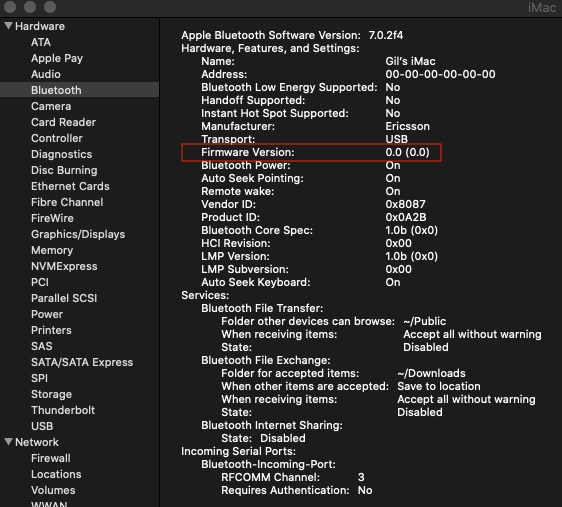

I've installed version 2.5.1 kexts BrcmFirmwareRepo.kext, BrcmBluetoothInjector.kext and BrcmPatchRAM3.kext in /L/E on my Dell Latitude E6410 with Broadcom BCM 94352HMB running Catalina.  All was good with 10.15.2, but not so after I upgraded to 10.15.3.  After upgrading to 10.15.3, I'm experiencing slow boot and delayed Wi-Fi acquisition (the same behavior I observed before I replaced BrcmPatchRAM2.kext with BrcmPatchRAM3.kext/BrcmBluetoothInjector.kext after upgrading from Mojave to Catalina).  I'd be happy to post debug files and logs, but first want to confirm that others are seeing this.
Is anyone seeing these issues after upgrading from 10.15.2 to 10.15.3?
EDIT: After the system boots and Wi-Fi is acquired, all works perfectly.
EDIT 2: It is interesting to note that there are bluetooth driver changes from 10.15.2 to 10.15.3: https://eclecticlight.co/2020/01/29/what-changed-in-the-catalina-10-15-3-update/
EDIT 3: Wi-Fi and bluetooth work perfectly after sleep / wake, with both being immediately available after wake.  This issue only occurs at Catalina 10.15.3 boot.

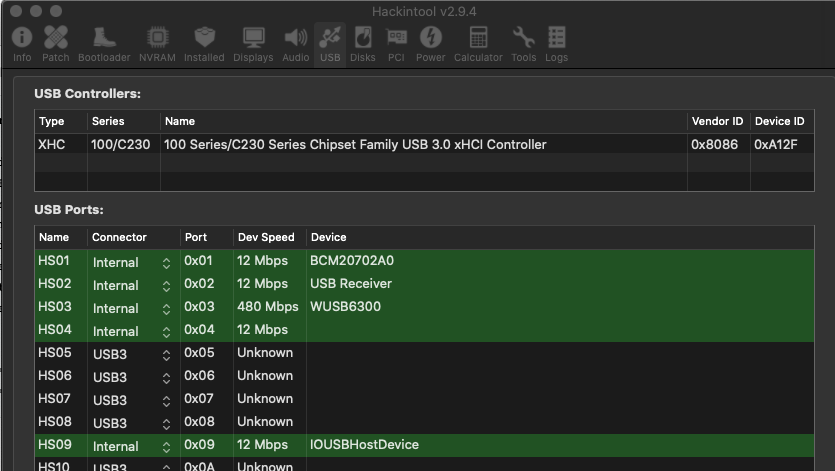

For those who are not able to get it working, if you have an internal bluetooth chip like intel, please disable that particular USB port which the intel chip uses. You can do this by figuring its USB port. Mac-> System Report -> USB and find the bluetooth device (or any other USB device) you want to disable. Note the location id.
then open a terminal and type ioreg | grep "HS" , see the output and find the matching USB port with the location id, in my case it was HS09.  Then disable it by adding a boot flag to Clover.
here is the flag in my case : uia_exclude=HS09. Then plug your dongle and let it roll.....
