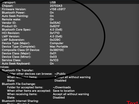

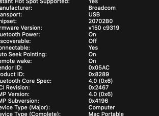

hey friends-  I have two MacBooks- one MacBook Air mid 2012 with 20702A3 on firmware v156 c5917, and a late 2013 mbp wutg a 20702B0 v 150 c9319.....is there any chance I could take one of the chips out and they might fit into either a dell ups 15 9560 or msi z390 gaming edge ac OR Asus tuff gaming z390 for factor?
or do I have to fork over the $115?  I am loving my xps with Catalina, but can't install anything and don't have USB adapter (defeats the point imo)
ty!
There is no chance you can take the chips out, to my knowledge, as everything is soldered on the MacBook's mainboard. Not sure who told you otherwise. It's not modular like Lenovo or Dell or Toshiba laptops, hence their slimmer profile.

some advice
Thanks
