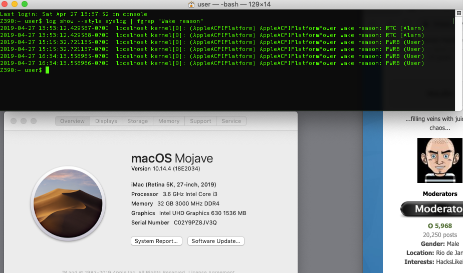

buzzworm Posted April 26, 2019 Share Posted April 26, 2019 I'm not able to sleep the machine. Screen goes off, but no sleep. I can live without it, but if you know of a fix that would be great. Link to comment https://www.insanelymac.com/forum/topic/337975-insanely-hackbeast-ga-z390m-gaming-full-dsdt-patches/page/2/#findComment-2671607 Share on other sites More sharing options...
MaLd0n Posted April 26, 2019 Author Share Posted April 26, 2019 2 minutes ago, buzzworm said: I'm not able to sleep the machine. Screen goes off, but no sleep. I can live without it, but if you know of a fix that would be great. run in terminal and paste result here log show --style syslog | fgrep "Wake reason" send me ur DSDT edited too Link to comment https://www.insanelymac.com/forum/topic/337975-insanely-hackbeast-ga-z390m-gaming-full-dsdt-patches/page/2/#findComment-2671609 Share on other sites More sharing options...
buzzworm Posted April 26, 2019 Share Posted April 26, 2019 (edited) no results DSDT.aml Edited April 26, 2019 by buzzworm Link to comment https://www.insanelymac.com/forum/topic/337975-insanely-hackbeast-ga-z390m-gaming-full-dsdt-patches/page/2/#findComment-2671612 Share on other sites More sharing options...
MaLd0n Posted April 26, 2019 Author Share Posted April 26, 2019 1 hour ago, buzzworm said: no results DSDT.aml check if work DSDT.aml.zip use power button for wake Link to comment https://www.insanelymac.com/forum/topic/337975-insanely-hackbeast-ga-z390m-gaming-full-dsdt-patches/page/2/#findComment-2671620 Share on other sites More sharing options...
buzzworm Posted April 26, 2019 Share Posted April 26, 2019 same thing. Sleeps screen only. Z390:~ user$ log show --style syslog | fgrep "Wake reason" Z390:~ user$ Link to comment https://www.insanelymac.com/forum/topic/337975-insanely-hackbeast-ga-z390m-gaming-full-dsdt-patches/page/2/#findComment-2671653 Share on other sites More sharing options...
MaLd0n Posted April 26, 2019 Author Share Posted April 26, 2019 32 minutes ago, buzzworm said: same thing. Sleeps screen only. Z390:~ user$ log show --style syslog | fgrep "Wake reason" Z390:~ user$ extract new SEND_ME, i'll check logs Link to comment https://www.insanelymac.com/forum/topic/337975-insanely-hackbeast-ga-z390m-gaming-full-dsdt-patches/page/2/#findComment-2671655 Share on other sites More sharing options...
buzzworm Posted April 26, 2019 Share Posted April 26, 2019 Here's a new send me. I created it from my current clover. Send me Z390.zip Link to comment https://www.insanelymac.com/forum/topic/337975-insanely-hackbeast-ga-z390m-gaming-full-dsdt-patches/page/2/#findComment-2671656 Share on other sites More sharing options...

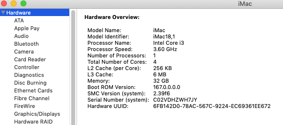

MaLd0n Posted April 26, 2019 Author Share Posted April 26, 2019 4 minutes ago, buzzworm said: Here's a new send me. I created it from my current clover. Send me Z390.zip try with iMac18,1 smbios, change in boot, press O key in Clover boot screen, have all options there Link to comment https://www.insanelymac.com/forum/topic/337975-insanely-hackbeast-ga-z390m-gaming-full-dsdt-patches/page/2/#findComment-2671659 Share on other sites More sharing options...
buzzworm Posted April 26, 2019 Share Posted April 26, 2019 tried imac18,1, didn't fix Link to comment https://www.insanelymac.com/forum/topic/337975-insanely-hackbeast-ga-z390m-gaming-full-dsdt-patches/page/2/#findComment-2671660 Share on other sites More sharing options...
buzzworm Posted April 27, 2019 Share Posted April 27, 2019 What about using newer smbios that matches my board more? iMac 19,1 -> i5 8500B ,i5 8600, i5 9600k, i9 9900k.iMac 19,2 -> i3 8100B, i5 8500B, i7 9700B. Think I need 10.14.5 for this Link to comment https://www.insanelymac.com/forum/topic/337975-insanely-hackbeast-ga-z390m-gaming-full-dsdt-patches/page/2/#findComment-2671664 Share on other sites More sharing options...
MaLd0n Posted April 27, 2019 Author Share Posted April 27, 2019 49 minutes ago, buzzworm said: What about using newer smbios that matches my board more? iMac 19,1 -> i5 8500B ,i5 8600, i5 9600k, i9 9900k.iMac 19,2 -> i3 8100B, i5 8500B, i7 9700B. Think I need 10.14.5 for this yes, 10.14.5 or 10.14.4 update for new imacs 1 Link to comment https://www.insanelymac.com/forum/topic/337975-insanely-hackbeast-ga-z390m-gaming-full-dsdt-patches/page/2/#findComment-2671666 Share on other sites More sharing options...
buzzworm Posted April 28, 2019 Share Posted April 28, 2019 Updated to 10.14.4 iMac 19,1 using build 18E2034 and sleep is working!!! 1 Link to comment https://www.insanelymac.com/forum/topic/337975-insanely-hackbeast-ga-z390m-gaming-full-dsdt-patches/page/2/#findComment-2671742 Share on other sites More sharing options...

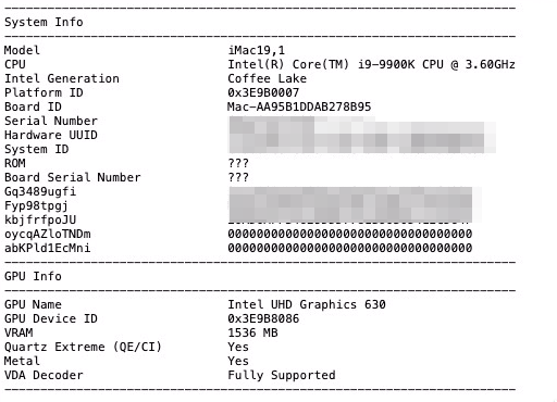

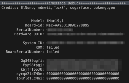

buzzworm Posted May 10, 2019 Share Posted May 10, 2019 Did the HelloWorld NVRAM test and it works. But when I run iMessageDebug it's showing ROM and Boardserialnumber as FAILED. I want to get iMessage working. Do I need fixes to DSDT or Osxaptiofix type driver to fix? Link to comment https://www.insanelymac.com/forum/topic/337975-insanely-hackbeast-ga-z390m-gaming-full-dsdt-patches/page/2/#findComment-2673223 Share on other sites More sharing options...
MaLd0n Posted May 10, 2019 Author Share Posted May 10, 2019 6 hours ago, buzzworm said: Did the HelloWorld NVRAM test and it works. But when I run iMessageDebug it's showing ROM and Boardserialnumber as FAILED. I want to get iMessage working. Do I need fixes to DSDT or Osxaptiofix type driver to fix? use hackintool, have all aoptions in app, is really nice app Link to comment https://www.insanelymac.com/forum/topic/337975-insanely-hackbeast-ga-z390m-gaming-full-dsdt-patches/page/2/#findComment-2673241 Share on other sites More sharing options...
buzzworm Posted May 10, 2019 Share Posted May 10, 2019 I see that export function, cool. I tried using the EmuVariableUefi.efi driver and OsxAptioFix2Drv-free2000.efi to help help read ROM / Boardserialnumber but it didn't help. NVRAM is working, but NOT seeing those 2 things. How do I get those ??? and 00000000 values to be filled in? What am I missing? Link to comment https://www.insanelymac.com/forum/topic/337975-insanely-hackbeast-ga-z390m-gaming-full-dsdt-patches/page/2/#findComment-2673248 Share on other sites More sharing options...
MaLd0n Posted May 10, 2019 Author Share Posted May 10, 2019 2 hours ago, buzzworm said: I see that export function, cool. I tried using the EmuVariableUefi.efi driver and OsxAptioFix2Drv-free2000.efi to help help read ROM / Boardserialnumber but it didn't help. NVRAM is working, but NOT seeing those 2 things. How do I get those ??? and 00000000 values to be filled in? What am I missing? try generate one full smbios, with clover configurator Link to comment https://www.insanelymac.com/forum/topic/337975-insanely-hackbeast-ga-z390m-gaming-full-dsdt-patches/page/2/#findComment-2673254 Share on other sites More sharing options...
buzzworm Posted May 10, 2019 Share Posted May 10, 2019 Just tried generating another smbios 19,1 with clover configurator. Same results. Is iMessage working on your board? This is the last thing I need to get working on this rig. Link to comment https://www.insanelymac.com/forum/topic/337975-insanely-hackbeast-ga-z390m-gaming-full-dsdt-patches/page/2/#findComment-2673257 Share on other sites More sharing options...
MaLd0n Posted May 10, 2019 Author Share Posted May 10, 2019 5 minutes ago, buzzworm said: Just tried generating another smbios 19,1 with clover configurator. Same results. Is iMessage working on your board? This is the last thing I need to get working on this rig. i don't use it, but work, in some cases just activate with apple phone Link to comment https://www.insanelymac.com/forum/topic/337975-insanely-hackbeast-ga-z390m-gaming-full-dsdt-patches/page/2/#findComment-2673259 Share on other sites More sharing options...

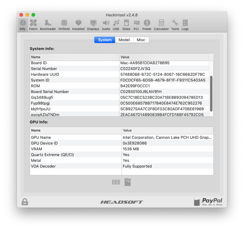

buzzworm Posted May 10, 2019 Share Posted May 10, 2019 This is always the hardest part of all my hackintoshes. Other guides on this board are using EmuVariableUefi.efi driver and OsxAptioFix2Drv-free2000.efi and their ROM / Board values appear with these drivers. If you run Hackintool on your board are these values ??? and 0000000 Link to comment https://www.insanelymac.com/forum/topic/337975-insanely-hackbeast-ga-z390m-gaming-full-dsdt-patches/page/2/#findComment-2673260 Share on other sites More sharing options...
MaLd0n Posted May 10, 2019 Author Share Posted May 10, 2019 18 minutes ago, buzzworm said: This is always the hardest part of all my hackintoshes. Other guides on this board are using EmuVariableUefi.efi driver and OsxAptioFix2Drv-free2000.efi and their ROM / Board values appear with these drivers. If you run Hackintool on your board are these values ??? and 0000000 Link to comment https://www.insanelymac.com/forum/topic/337975-insanely-hackbeast-ga-z390m-gaming-full-dsdt-patches/page/2/#findComment-2673264 Share on other sites More sharing options...
