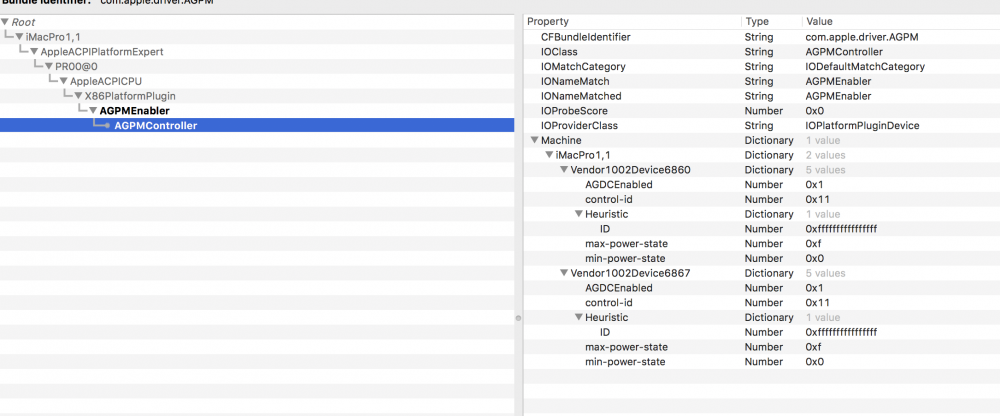

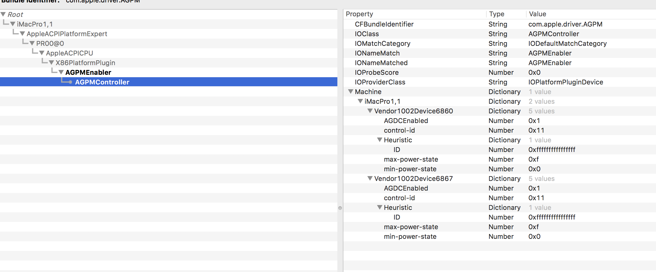

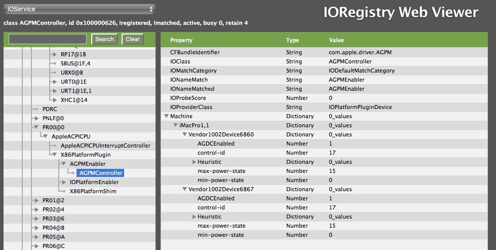

toleda Posted January 8, 2019 Share Posted January 8, 2019 (edited) On 1/6/2019 at 10:39 AM, Pavo said: But the control-id for the GFX0 device is 17, which is for mobile GPUs. discrete GPUs should be using control-id 18 Statement suggests iMacPro1,1 Vega64 and Vega56 are mobile GPUs, true? Similar question with MacPro6,1/FirePro using control-ids 16 and 17, true? Edited January 8, 2019 by toleda Link to comment https://www.insanelymac.com/forum/topic/337118-agpm-injector-kext-generator-app/page/2/#findComment-2657956 Share on other sites More sharing options...
jerryy2 Posted January 8, 2019 Share Posted January 8, 2019 It may be a combination of new things, but after installing this kext you built, I noticed an immediate graphics improvement while using photo editing software. Before, when editing 'largish' (4K - 5k, 16 - 20 MP) images, highly zoomed in, while moving in the image from one place to to another section, there would be a jerkiness or judder. Now the movement is very smooth, no flashing etc. This is using an i5-8400, AMD RX-580 setup. The combination of updates is Mohave 10.14.3 Beta (18D38a), Clover 4813 and this kext. Maybe tomorrow it will go back to as before, but for today, it is a good improvement. Thanks! Link to comment https://www.insanelymac.com/forum/topic/337118-agpm-injector-kext-generator-app/page/2/#findComment-2657965 Share on other sites More sharing options...
Pavo Posted January 8, 2019 Author Share Posted January 8, 2019 (edited) 1 hour ago, toleda said: Statement suggests iMacPro1,1 Vega64 and Vega56 are mobile GPUs, true? Similar question with MacPro6,1/FirePro using control-ids 16 and 17, true? Ok maybe I may have mis spoke on calling those "mobile" GPUs, a better way to explain it is those GPUs, while those are dGPUs they're power distribution isn't. They receive they're power in which a way that is similar in how mobile GPUs work in power distribution wise. If you look at how the MacPro4,1/5,1 control their GPUs, it is the same way that PC desktop GPUs are powered, an external power connection that isn't part of the logic board's (motherboard for PCs) power distribution. So with that being said, it seems more logical that the control-id for "desktop" designed GPU power distribution would be the same as the MacPro4,1/5,1 GPU power distribution, which is why I am saying control-id=18 make the most sense. Edited January 8, 2019 by Pavo Link to comment https://www.insanelymac.com/forum/topic/337118-agpm-injector-kext-generator-app/page/2/#findComment-2657966 Share on other sites More sharing options...
brousseau6933 Posted January 9, 2019 Share Posted January 9, 2019 5 hours ago, toleda said: Statement suggests iMacPro1,1 Vega64 and Vega56 are mobile GPUs, true? Similar question with MacPro6,1/FirePro using control-ids 16 and 17, true? Quick question toleda: I use your dagpm.kext with my build (iMac 14,2 with Radeon RX 580 - Mojave), should I modify the control-id to 18 in the kext as suggested by Pavo? It is now 17... Thanks, Patrice Link to comment https://www.insanelymac.com/forum/topic/337118-agpm-injector-kext-generator-app/page/2/#findComment-2657990 Share on other sites More sharing options...
toleda Posted January 9, 2019 Share Posted January 9, 2019 (edited) 21 hours ago, Pavo said: If you look at how the MacPro4,1/5,1 control their GPUs, it is the same way that PC desktop GPUs are powered, an external power connection that isn't part of the logic board's (motherboard for PCs) power distribution. So with that being said, it seems more logical that the control-id for "desktop" designed GPU power distribution would be the same as the MacPro4,1/5,1 GPU power distribution, which is why I am saying control-id=18 make the most sense. I have not looked at the code to identify the differences between control-id 17 and 18. However, the iMacPro1,1 clearly satisfies "external" power delivery for Vega GPUs with control-id 17. The hardware difference is the "external" power cable(s) are lines on the motherboard. May have to wait for the MacPro7,1 for proof of this hypothesis. Edited January 9, 2019 by toleda Link to comment https://www.insanelymac.com/forum/topic/337118-agpm-injector-kext-generator-app/page/2/#findComment-2658129 Share on other sites More sharing options...
toleda Posted January 9, 2019 Share Posted January 9, 2019 (edited) 17 hours ago, brousseau6933 said: I use your dagpm.kext with my build (iMac 14,2 with Radeon RX 580 - Mojave), should I modify the control-id to 18 in the kext as suggested by Pavo? dAGPM.kext enables AGPM for discrete graphics cards that are not natively supported and ensures the Heuristic ID (AMD, Intel or Nvidia) matches installed graphics. Set control-id to your preference. Edited January 9, 2019 by toleda 1 Link to comment https://www.insanelymac.com/forum/topic/337118-agpm-injector-kext-generator-app/page/2/#findComment-2658131 Share on other sites More sharing options...
brousseau6933 Posted January 9, 2019 Share Posted January 9, 2019 (edited) 2 hours ago, toleda said: dAGPM.kext enables AGPM for discrete graphics cards that are not natively supported and ensures the Heuristic ID (AMD, Intel or Nvidia) matches installed graphics. Set control-id to your preference. Thanks, I'll check if it makes a difference in performance... EDIT, 1 hour later: No conclusive difference in my particular case (iMac 14,2 - Mojave - RX 580) with: - Geekbench Open CL compute; - GFXBench Metal; - Open GL extension viewer; - Cinebench. The variations are small in a way or the other and could be attributed to normal behavior. So, I'll keep Control-id 17... Edited January 9, 2019 by brousseau6933 More data 1 Link to comment https://www.insanelymac.com/forum/topic/337118-agpm-injector-kext-generator-app/page/2/#findComment-2658147 Share on other sites More sharing options...

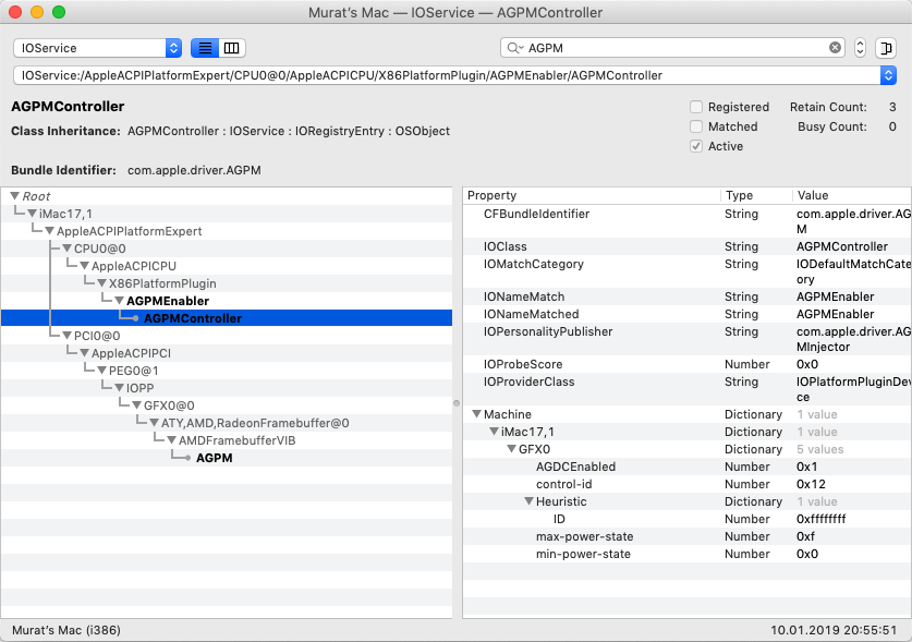

telepati Posted January 10, 2019 Share Posted January 10, 2019 (edited) Thanks, @Pavo for the app. I am using SMBIOS 17,1 before the kext control ID look like that; After adding to kext to other folders and after restart now showing 12; I think it is working. Edited January 10, 2019 by telepati Link to comment https://www.insanelymac.com/forum/topic/337118-agpm-injector-kext-generator-app/page/2/#findComment-2658350 Share on other sites More sharing options...
Pavo Posted January 10, 2019 Author Share Posted January 10, 2019 1 hour ago, telepati said: Thanks, @Pavo for the app. I am using SMBIOS 17,1 before the kext control ID look like that; After adding to kext to other folders and after restart now showing 12; I think it is working. Yes its working but as you should be aware, my app doesn't currently support using dGPU with iGPU, so as you can see, you lost iGPU properties. 1 Link to comment https://www.insanelymac.com/forum/topic/337118-agpm-injector-kext-generator-app/page/2/#findComment-2658364 Share on other sites More sharing options...

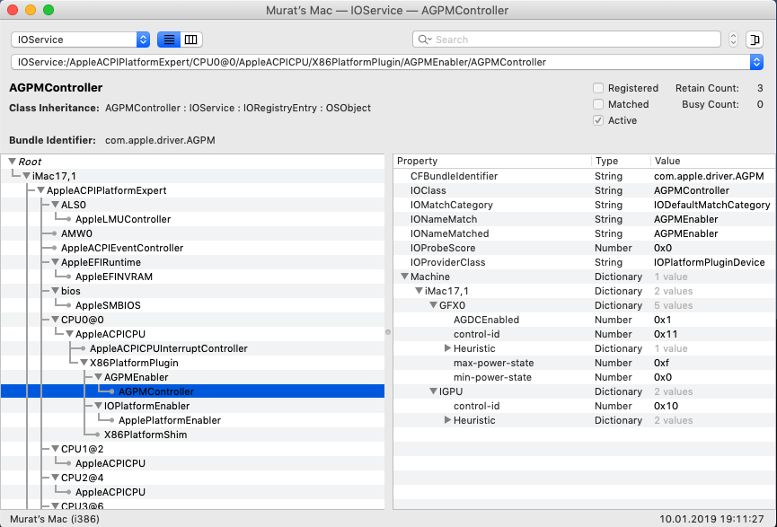

tikizondo94 Posted January 10, 2019 Share Posted January 10, 2019 (edited) So, if we are currently using Intel Qsync, will adding this kext cause any issues? I noticed my iGPU properties no longer show in X86PlatformPlugin/AGPMEnabler/AGPMController/Machine. Nevermind, Just had to add my IGPU properties to the newly greated AGPM kext. All shows normal now Edited January 12, 2019 by tikizondo94 Link to comment https://www.insanelymac.com/forum/topic/337118-agpm-injector-kext-generator-app/page/2/#findComment-2658378 Share on other sites More sharing options...
Pavo Posted January 13, 2019 Author Share Posted January 13, 2019 (edited) iGPU has been added to AGPMInjector for version 2.0. This will add iGPU AGPM properties based off what CPU type your SMBIOS selection is. If you have CSM disabled and iGPU disabled in BIOS you do not ever need to check Yes for iGPU enabled. AGPMInjector_2.0.zip Edited January 13, 2019 by Pavo 6 2 Link to comment https://www.insanelymac.com/forum/topic/337118-agpm-injector-kext-generator-app/page/2/#findComment-2658839 Share on other sites More sharing options...
