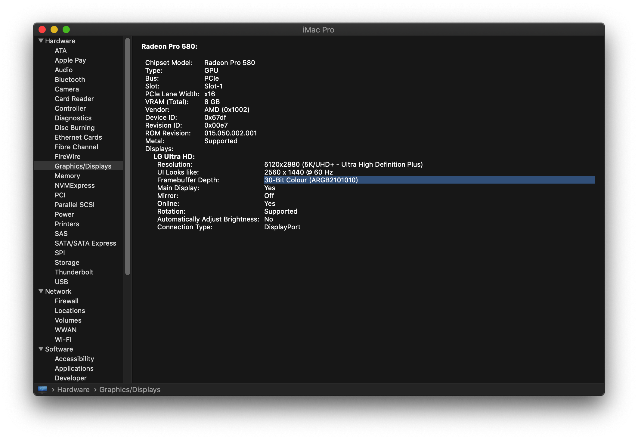

About what you said above about MacOS emulating 10-bit color depth on 8-bit monitors.
So...Windows can set 10-bit color depth...but MacOS can't...? I'm not sure I understand. And...how is Windows doing it, if the monitor can't do 10-bit colors? I'm so confused. :))
I'm assuming the issue here is the switch from 8-bit to 10-bit. But...if it comes with 8-bit from BIOS, and if the monitor doesn't do "real" 10-bit (mine says "10-bit (8-bit+FRC)"; so I'm guessing that's not real 10-bit, so that's why this happens...?)), can we make it stay 8-bit in the OS, as well?
What's happening when there is no flashing at all? Is the OS not pushing 10-bit anymore...? Or how is it possible that, with the same hardware, sometimes it flashes and sometimes it doesn't?

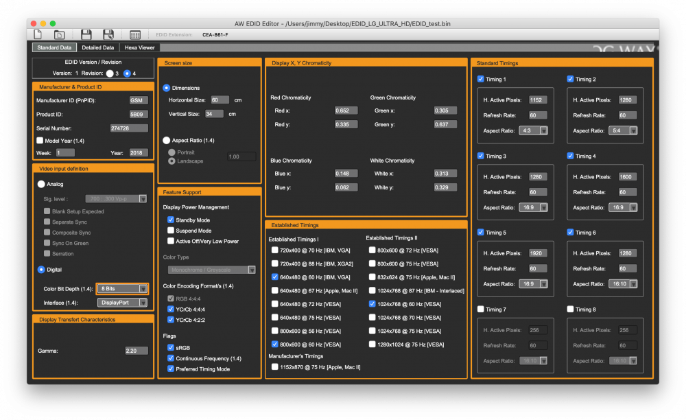

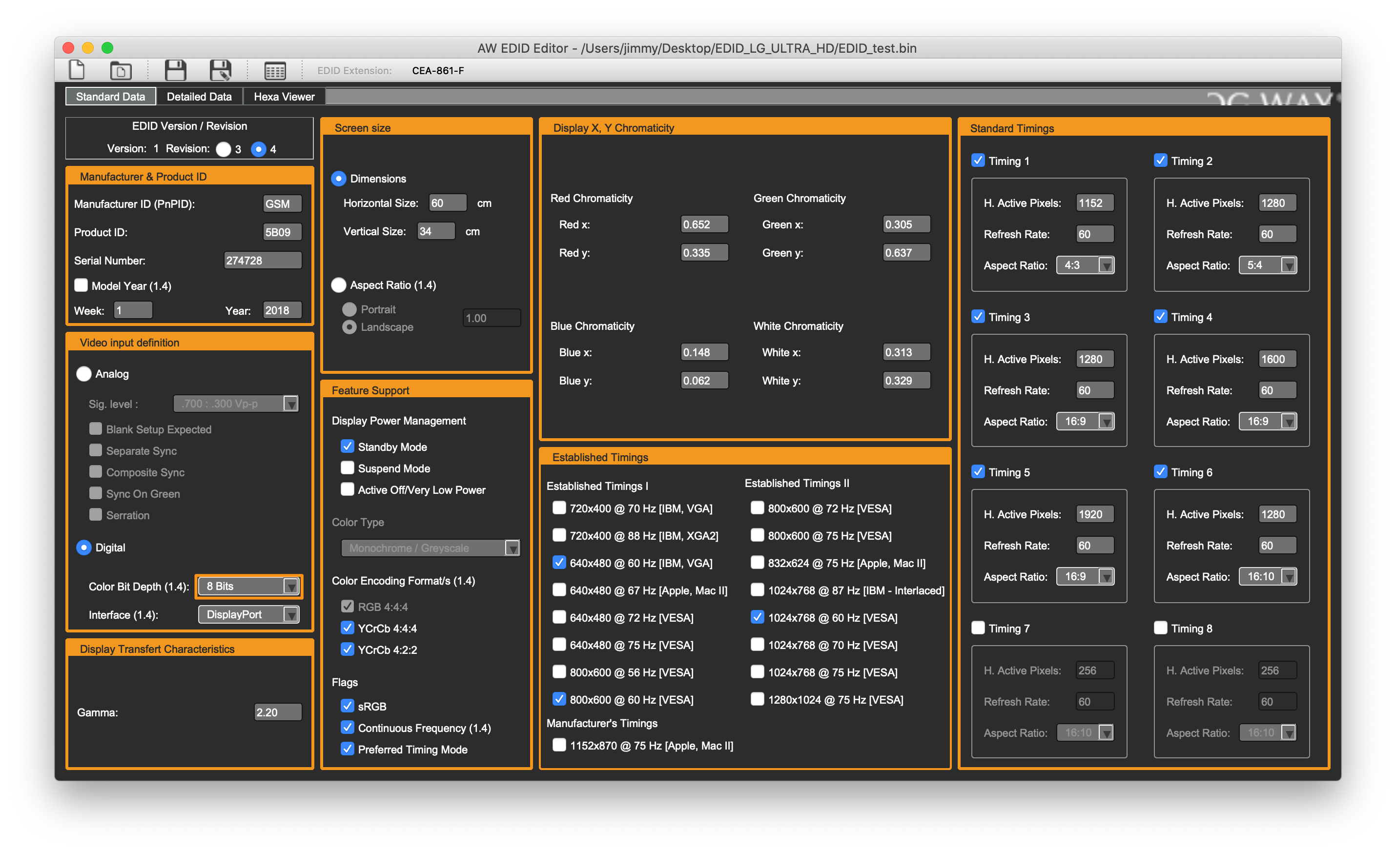

Is the Inject EDID feature working properly in Clover...? Is there any way to test that?
Cause...I extracted my EDID from Windows, edited it in MacOS using AW EDID Editor (set it to 8-bit instead of 10-bit) and added the resulted data into Clover under Custom EDID. Aaand...MacOS seems to ignore that. Still wants to use 10-bit. Ooor...maybe Inject Edid function doesn't really work right now? Which would also explain the lack of changes in my tests with different values of HorizontalSyncPulseWidth.
