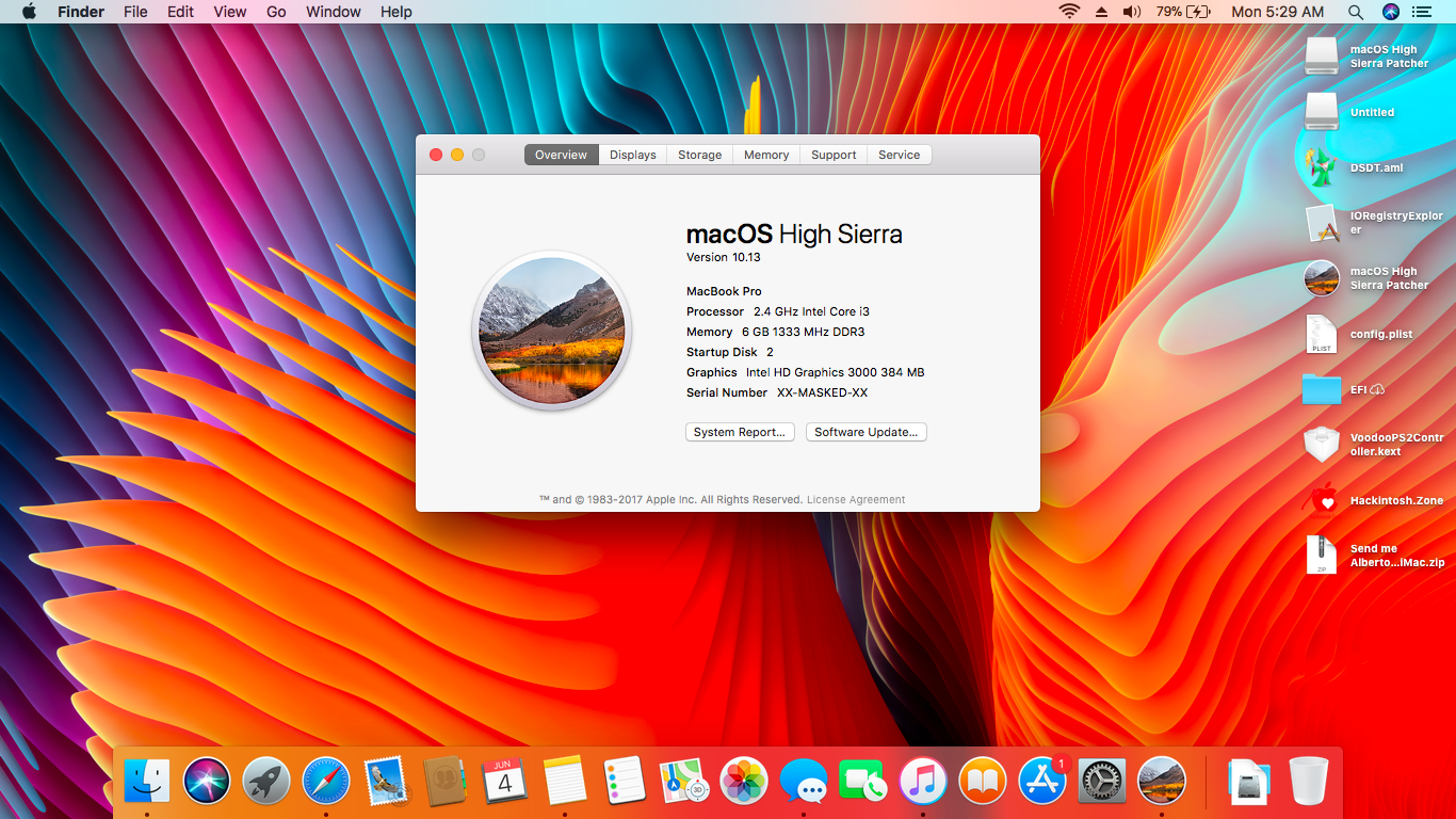

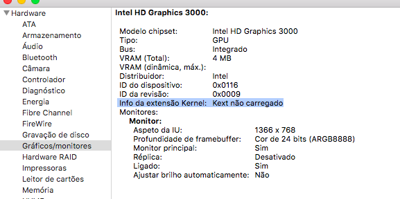

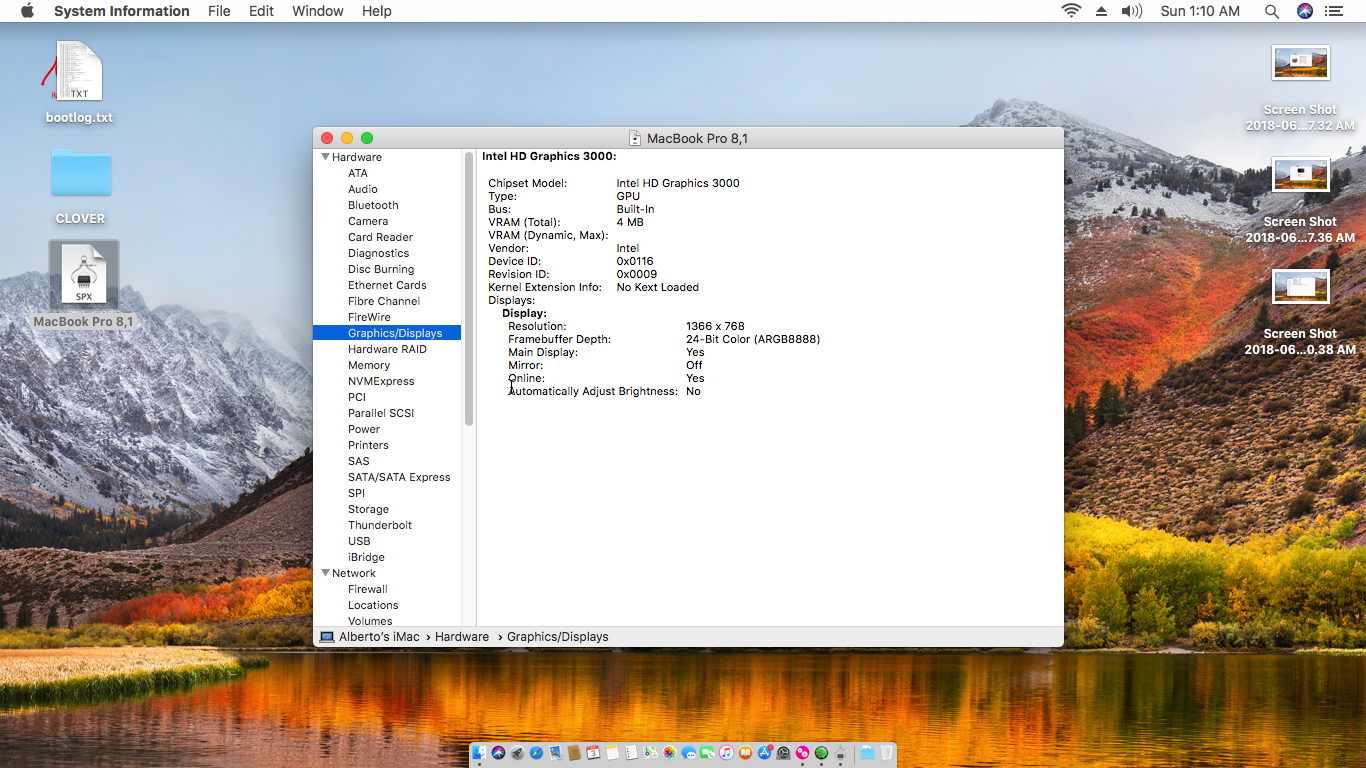

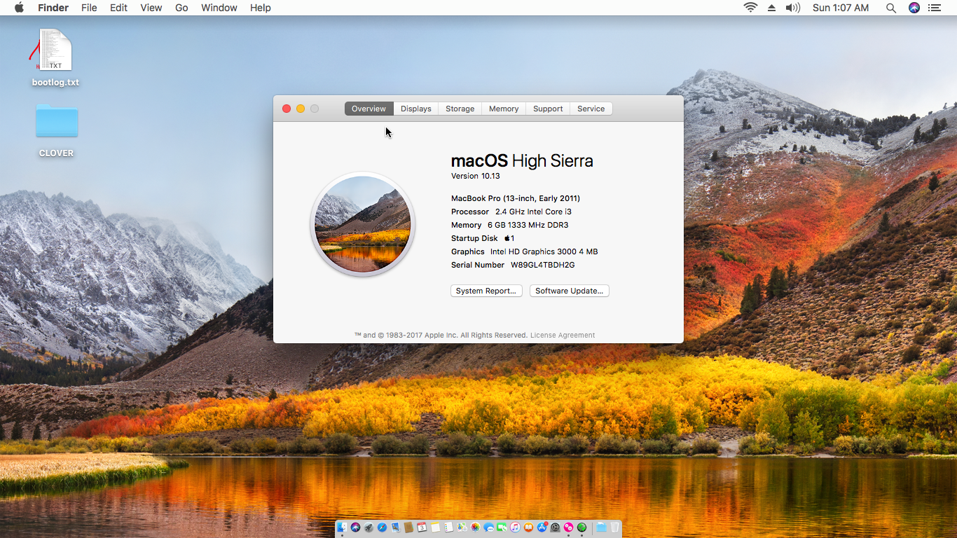

GiorgioHeins Posted June 3, 2018 Share Posted June 3, 2018 Hello everybody, it’s been a long long time since my last post here on this forum, I’m having a lot of issues trying to activate my graphic card, the system recognizes the graphic card but there’s not full acceleration, clearly shows up its name as Intel graphics HD 3000 with only 4 MB of video ram. I would like to know how I could fix this problem or a least any suggestion about it. The reason I came to this site one more time is because I have no clue how to edit or patch a DSDt.aml file, I have clover bootloader and still (seems to be easy but not for me LOL) so I don’t want to ruin the system once again. My configuration is OS macOS High Sierra 10.13 SAMSUNG series 3 NP300E5C-A0US INTEL CORE i3 - 2370M 2.4 GHz INTEL GRAPHICS HD 3000 WiFi ATHEROS AR5B95 MEMORY 6 GB DDR3 Wifi works *** Sound Works ***Ethernet Works*** Battery indicators and trackpad gestures are not working yet. Thank you guys in advance, I’ll keep myself reading and searching for any kind of solution for my laptop.. See attachment bootlog.txt CLOVER.zip DSDT.aml Link to comment https://www.insanelymac.com/forum/topic/334283-samsung-np300e5c-intel-graphics-hd3000-not-working/ Share on other sites More sharing options...

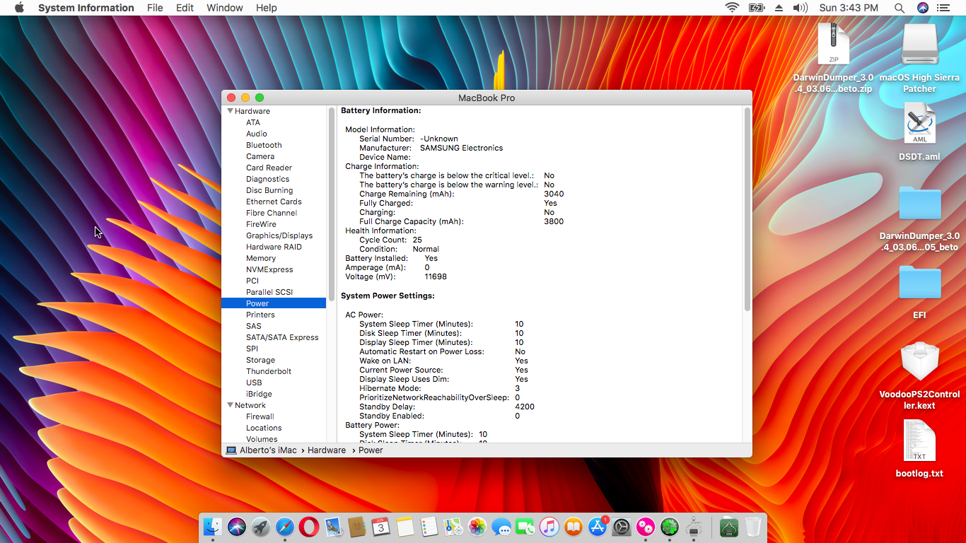

Baio77 Posted June 3, 2018 Share Posted June 3, 2018 (edited) Test this Config , and add this kext , I cleaned the config, test if the battery goes and brightness control ........ This rename is OK Archivio.zip add VoodooPS2Controller.kext.zip Edited June 3, 2018 by Baio77 2 Link to comment https://www.insanelymac.com/forum/topic/334283-samsung-np300e5c-intel-graphics-hd3000-not-working/#findComment-2616338 Share on other sites More sharing options...

GiorgioHeins Posted June 3, 2018 Author Share Posted June 3, 2018 10 hours ago, Baio77 said: Test this Config , and add this kext , I cleaned the config, test if the battery goes and brightness control ........ This rename is OK Archivio.zip add VoodooPS2Controller.kext.zip Hey bro thanks for these files, now I have the battery indicator which is great, thanks a lot for your help and support, I've done pretty much everything you guys said, but sill I have not full video acceleration, I've changed the config file, indeed the system boots so much faster than never before. Link to comment https://www.insanelymac.com/forum/topic/334283-samsung-np300e5c-intel-graphics-hd3000-not-working/#findComment-2616433 Share on other sites More sharing options...

GiorgioHeins Posted June 4, 2018 Author Share Posted June 4, 2018 2 hours ago, artur_pt said: hello try this config config.plist.zip then send new full dump good hack It feels like the systems is running a little bit faster, but once again there’s not full acceleration. Thanks for your support man I think I have to learn a lot about clover bootloader and its configurator app too. Here’s the file asked for Send me Albertos-iMac.zip Link to comment https://www.insanelymac.com/forum/topic/334283-samsung-np300e5c-intel-graphics-hd3000-not-working/#findComment-2616478 Share on other sites More sharing options...
artur_pt Posted June 4, 2018 Share Posted June 4, 2018 hello should work .. are u sure u have untouched kext for the intel ? maybe good idea .. make a new install over the one from the distro u have now the problem is not loading the kext from s/l/e try also in config I send u before not inject the intel graphics card and this https://github.com/lvs1974/IntelGraphicsFixup good hack Link to comment https://www.insanelymac.com/forum/topic/334283-samsung-np300e5c-intel-graphics-hd3000-not-working/#findComment-2616504 Share on other sites More sharing options...

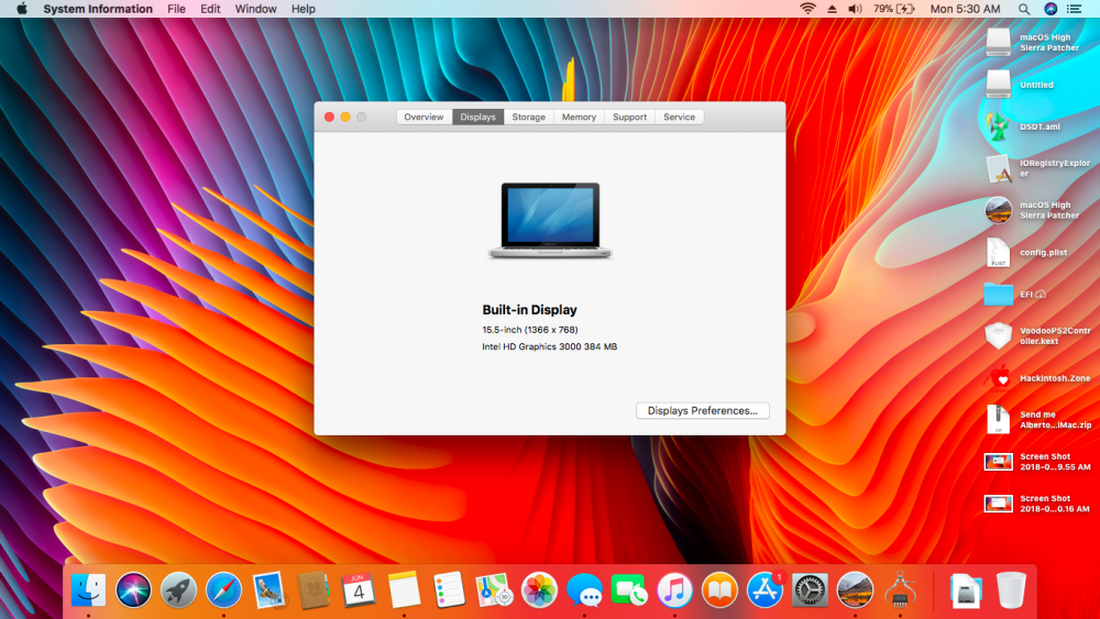

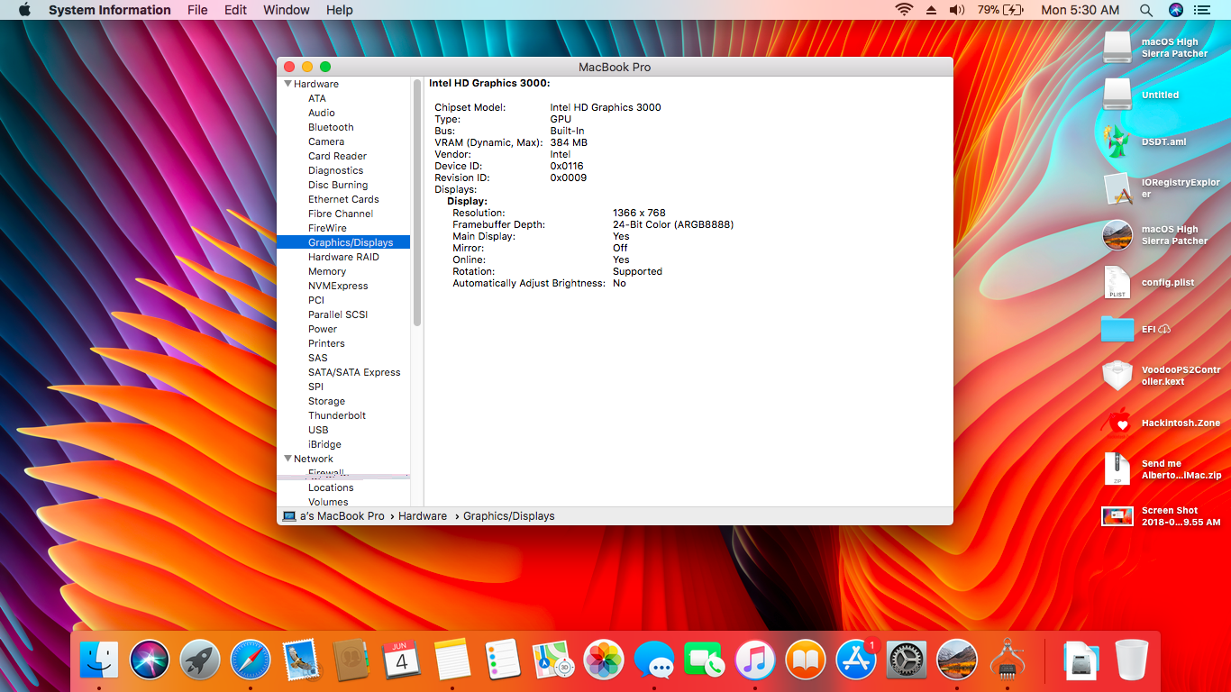

GiorgioHeins Posted June 4, 2018 Author Share Posted June 4, 2018 1 hour ago, artur_pt said: hello should work .. are u sure u have untouched kext for the intel ? maybe good idea .. make a new install over the one from the distro u have now the problem is not loading the kext from s/l/e try also in config I send u before not inject the intel graphics card and this https://github.com/lvs1974/IntelGraphicsFixup good hack Definitely you’re the best, I’ve just reinstalled macOS High Sierra 10.13 ( using the same distro) this time I did not backup the graphics kexts, I left them in their own location System/Library/Extensions, so what happened was that they system wasn’t able to load the kexts-in this case INTEL HD 3000. Now it seems to be working fine !!! Thank you for all the effort you have made to help me. Btw I’m thinking to make a new fresh install using macOS High Sierra 10.13.5 12 hours ago, Baio77 said: POST THE CLOVER FOLDER Thanks a lot man you’ve made my day too! Link to comment https://www.insanelymac.com/forum/topic/334283-samsung-np300e5c-intel-graphics-hd3000-not-working/#findComment-2616510 Share on other sites More sharing options...
