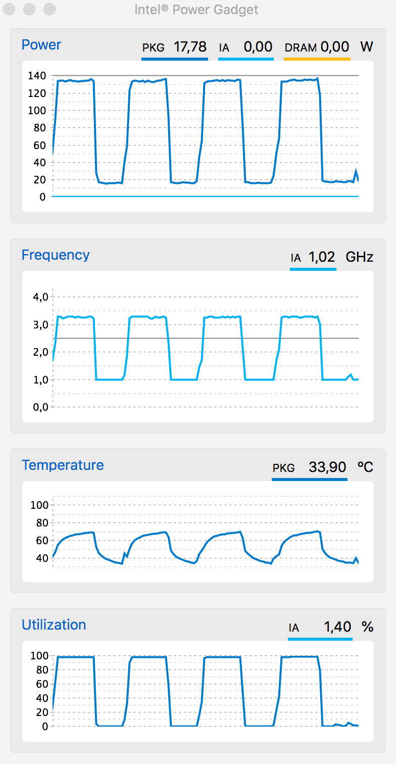

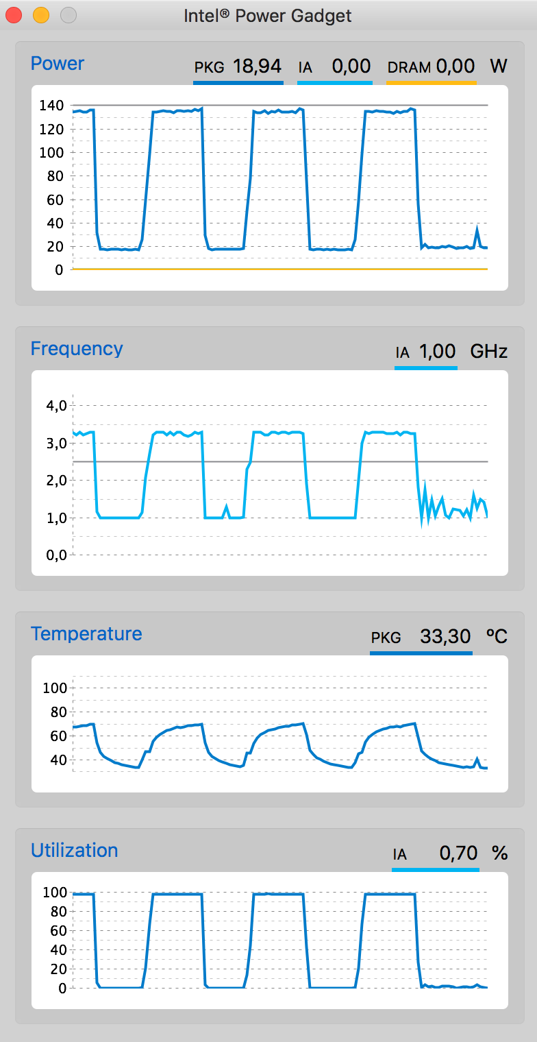

obus Posted April 24, 2018 Author Share Posted April 24, 2018 (edited) Hi @fabiosun Could you please have a look at my attached files. Now booting without the TSCAdjustReset.kext . Sleep/wake and everything is working perfect without that kext so I can run my rig without it but I'm to much "noob" to understand if this is the best way for my CPU performance. Is there a way to check this? Then I would like to ask you another thing about my MSR 0xE2 register. According to KGP's site the output from voltageshift should be something similar with: RDMSR e2 returns value 0x7e000003 but when I run this test the output is: RDMSR e2 returns value 0x402? on the other hand my bootlog and AppleIntelInfo.kext output is showing quite clear that the bios is unlocked: MSR 0xE2 before patch 00000402 MSR 0xCE 00070A2C_F3811900 MSR 0x1B0 00000000 Everything shows that my MSR 0xE2 register is unlocked but still need FakeCpuid or/alt. an old XCPM bootstrap patch together with xcpm_program_msrs (c) Pike R. Alpha for booting. I can't understand that i9-7980xe processor with the same signature 0x50654 can boot perfect without this kernel patch and without FakeCpuid when at least on the paper a more native processor like the Xeon W fail. Is there anybody else out there how could help to solve this problem. I'm just a super noob trying to put this rig together and the only skill I have is my insistence and that is not enough for this project. With TSC kext.rtf without TSC kext.rtf Edited April 24, 2018 by obus 1 Link to comment https://www.insanelymac.com/forum/topic/333229-help-installing-highsierra-on-xeon-w-2175-and-asus-ws-c422-mobo/page/12/#findComment-2611327 Share on other sites More sharing options...
obus Posted April 24, 2018 Author Share Posted April 24, 2018 On 4/23/2018 at 9:47 PM, yapan4 said: I think you are very close to this. But I have another unpleasant mention of past practice - the motherboard Gigabyte GA-X150 Plus WS. All reports showed an unlocked MSR, but without the KernelPM and AppelIntelCPUPM confidently caught KP. Like my situation with the difference that my rig is rockstable without Kp Link to comment https://www.insanelymac.com/forum/topic/333229-help-installing-highsierra-on-xeon-w-2175-and-asus-ws-c422-mobo/page/12/#findComment-2611333 Share on other sites More sharing options...

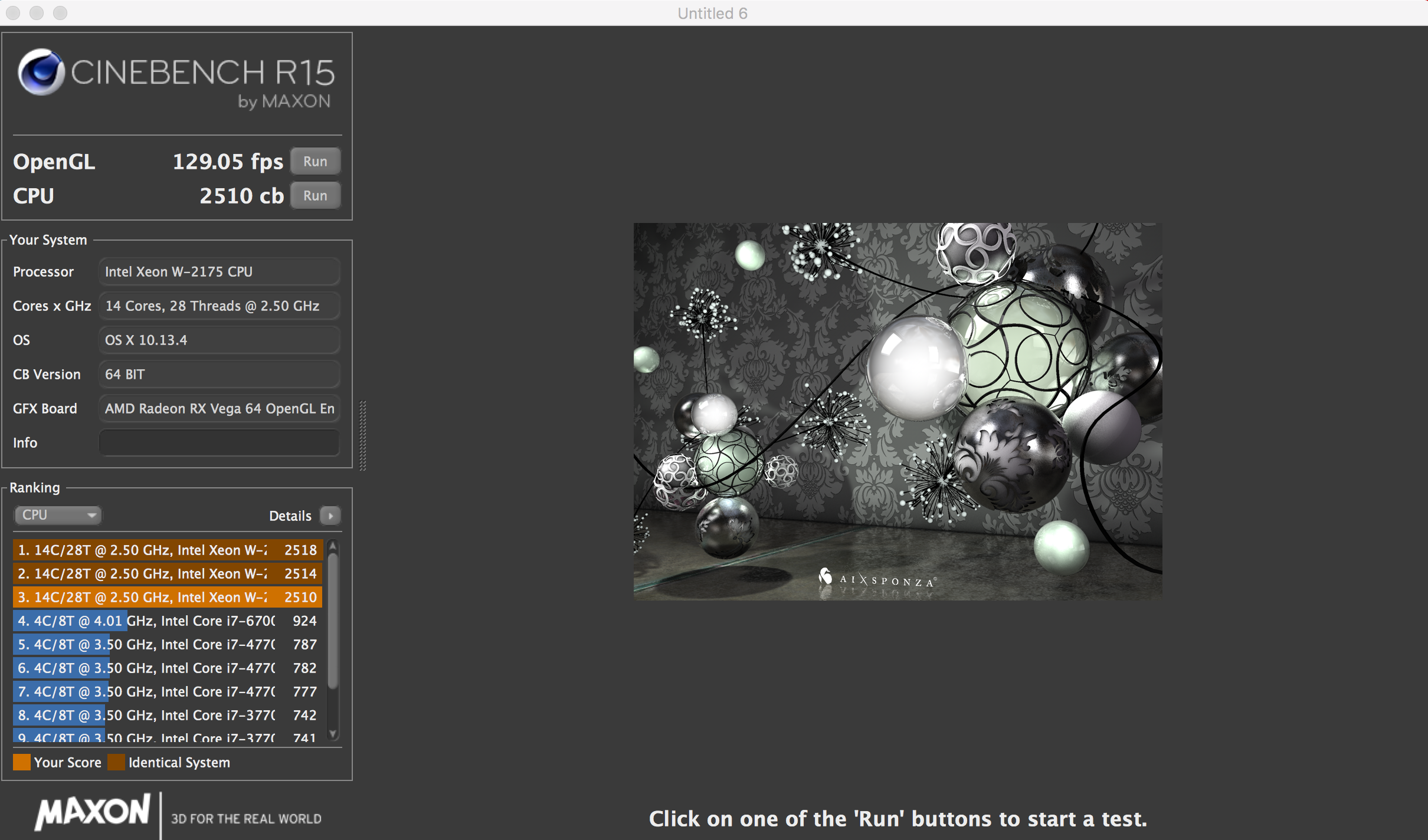

obus Posted April 29, 2018 Author Share Posted April 29, 2018 (edited) Thank's to KGP's eminent guide I now have working hot swap or "external PCI hotplugging" with my thunderbolt GC-Alpine ridge PCI express card Sleep and wake working 100 % with my LG OLED 55 inch TV and/ or my external Buffalo hard disk connected via my two thunderbolt connections on my GC- Alpine Ridge card.. Streamed (and of course downloaded) Itunes DRM protected video plays smoothly on my RX Vega 64 (this hasn't worked for me since my first rig on a Gigabyte Z68 with a Sandy Bridge core i5). Nightshift and Native Display Brightness Control working. Thank's to @fabiosun I have a patched UEFI bios (0603) with unlocked MSR 0XE2 register. System 100% stable. Edited April 29, 2018 by obus Link to comment https://www.insanelymac.com/forum/topic/333229-help-installing-highsierra-on-xeon-w-2175-and-asus-ws-c422-mobo/page/12/#findComment-2611882 Share on other sites More sharing options...

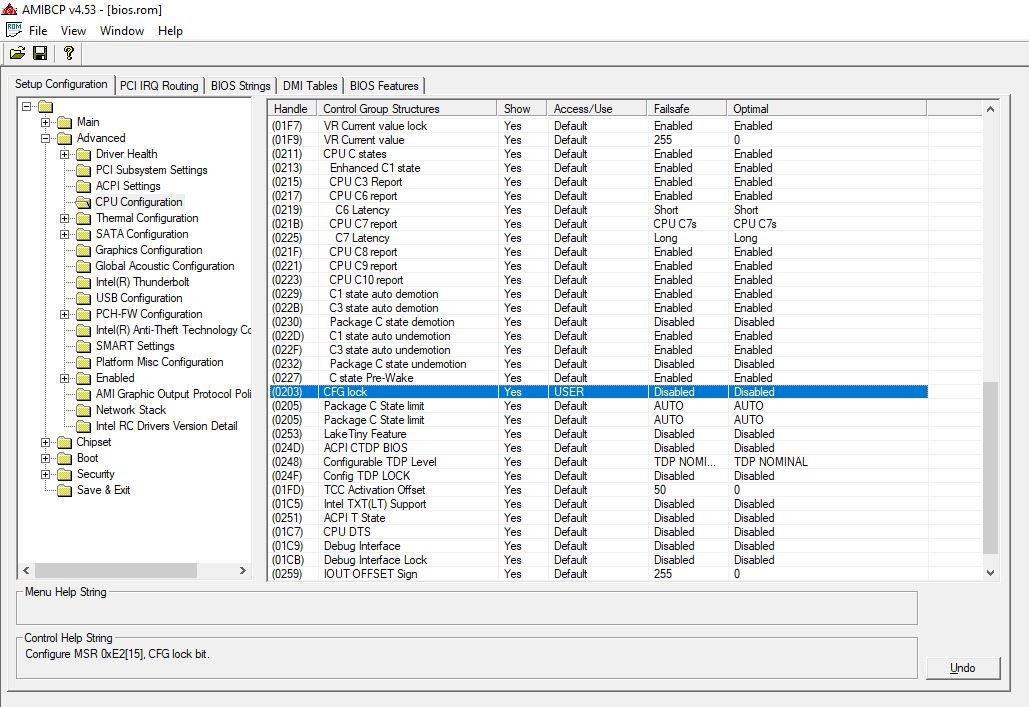

oSxFr33k Posted July 15, 2018 Share Posted July 15, 2018 (edited) I know this works great for Laptops and never tried this on a Desktop Motherboard but is it possible to unhide that menu option with Aptio Tools? If CSR lock is a hidden menu then you should be able to unhide it and that option will be available in the Bios after you flash the modified Bios? Be careful if your unsure how do to this with the Aptio Tools you can brick you MB but with FLashback you should be able to recovery your original unmodified bios. I have the tools and guide, but this motherboard may require a newer Aptio tools? If Aptio version 4 is still being used I think this will work. Does this motherboard use Aptio IV or V? Just dump your bios with AFUWin in the zipped file or equivalent such as UEFItool, and then open it with AMIBCP_v4.53 or AMIBCP_v5.0.1 and look for that menu if its there, read the guide. I used AFUWinGUI to open in the cap file and export as rom then opened in AMIBCP_4.53 and I see CFG Lock is disabled by default and set to user , you should see this option in CPU configuration for Bios 0603 for WS-C422-PRO-SE-ASUS https://www.dropbox.com/s/lqc3stl4mx0ned0/AMI Aptio Tools and Guide.zip?dl=0 Edited July 15, 2018 by oSxFr33k Link to comment https://www.insanelymac.com/forum/topic/333229-help-installing-highsierra-on-xeon-w-2175-and-asus-ws-c422-mobo/page/12/#findComment-2625996 Share on other sites More sharing options...
obus Posted July 16, 2018 Author Share Posted July 16, 2018 (edited) Hi @oSxFr33k I'm not really sure what you want me to do and why. Could you please explain/elaborate what you looking for? I already have an option in bios to enable or disable MSR 0xE2. Ok I think I know what you are looking for and I will check with AMIBCP if CFG lock is enabled or disabled Edited July 16, 2018 by obus Link to comment https://www.insanelymac.com/forum/topic/333229-help-installing-highsierra-on-xeon-w-2175-and-asus-ws-c422-mobo/page/12/#findComment-2626075 Share on other sites More sharing options...
