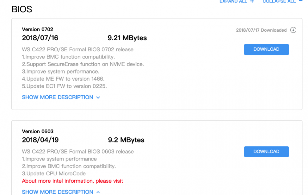

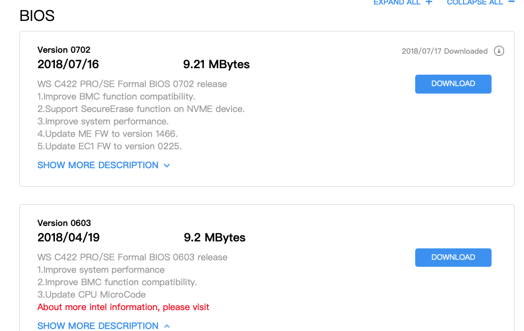

yapan4 Posted July 17, 2018 Share Posted July 17, 2018 (edited) New ASUS WS C422 BIOS v0702 released https://www.asus.com/Motherboards/WS-C422-PRO-SE/HelpDesk_BIOS/ Edited July 17, 2018 by yapan4 Link to comment https://www.insanelymac.com/forum/topic/333229-help-installing-highsierra-on-xeon-w-2175-and-asus-ws-c422-mobo/page/13/#findComment-2626262 Share on other sites More sharing options...
obus Posted July 17, 2018 Author Share Posted July 17, 2018 12 minutes ago, yapan4 said: New ASUS WS C422 BIOS v0702 released https://www.asus.com/Motherboards/WS-C422-PRO-SE/HelpDesk_BIOS/ Hi @yapan4 Will test that new bios as soon as possible. How is your new rig developing? Link to comment https://www.insanelymac.com/forum/topic/333229-help-installing-highsierra-on-xeon-w-2175-and-asus-ws-c422-mobo/page/13/#findComment-2626267 Share on other sites More sharing options...
yapan4 Posted July 17, 2018 Share Posted July 17, 2018 Hi. @obus Temporarily suspended due to financial problems. I hope I will be able to launch this fall along with the final release of 10.14 Link to comment https://www.insanelymac.com/forum/topic/333229-help-installing-highsierra-on-xeon-w-2175-and-asus-ws-c422-mobo/page/13/#findComment-2626270 Share on other sites More sharing options...
