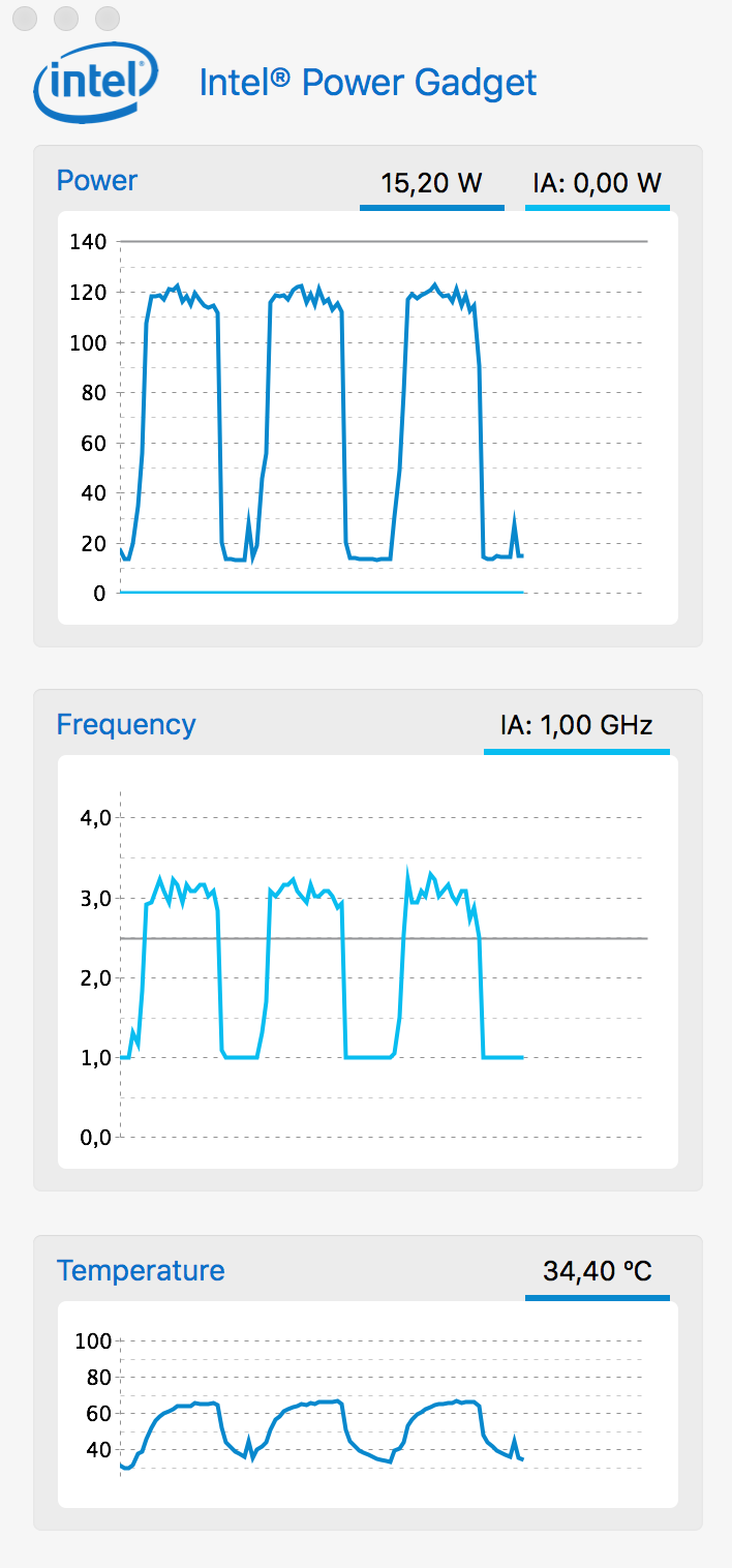

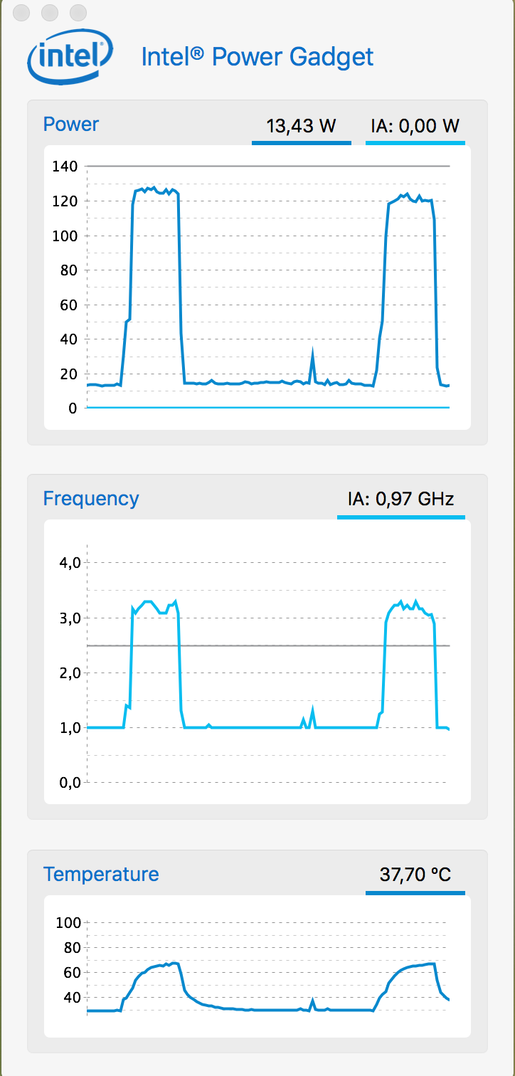

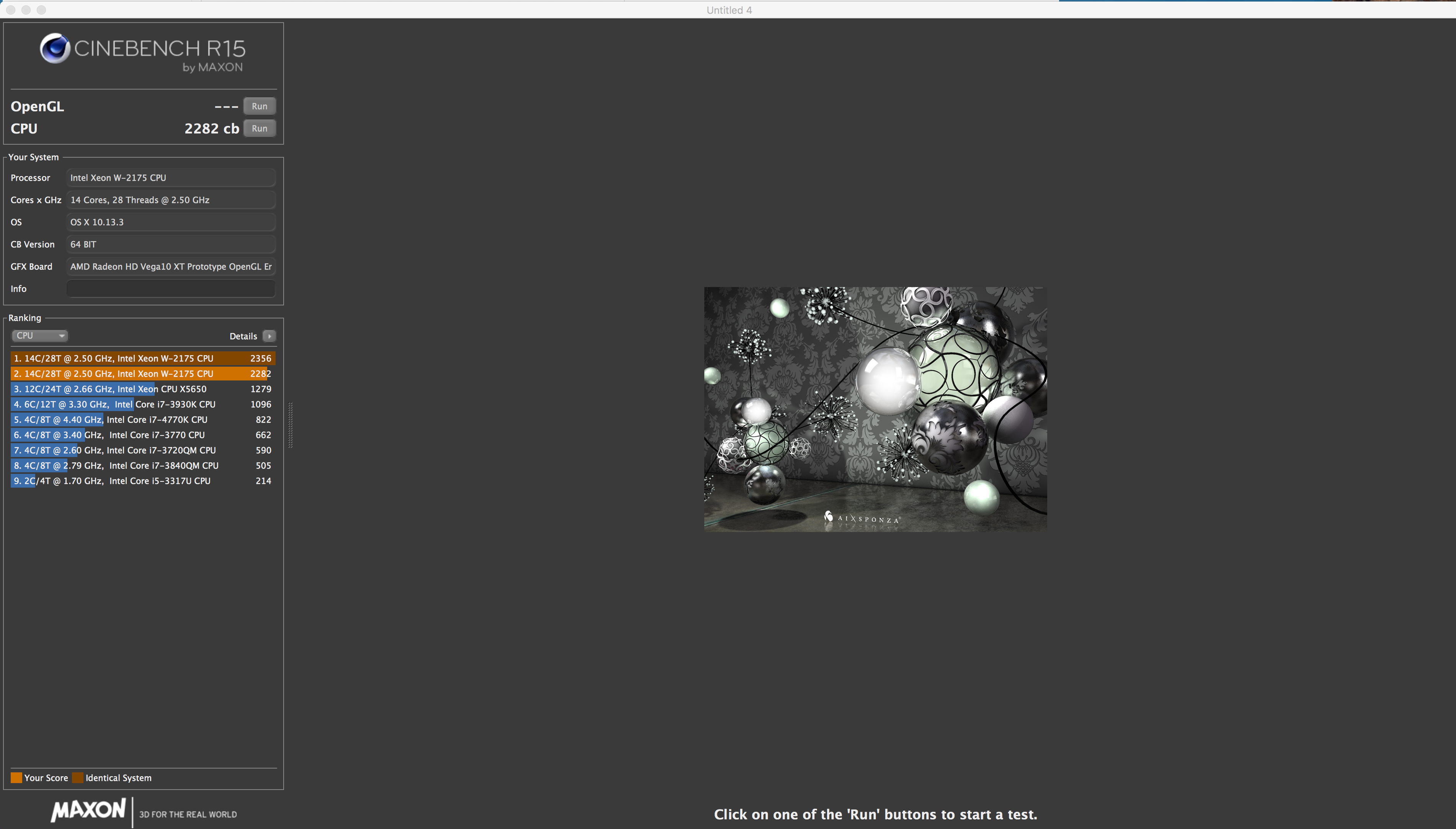

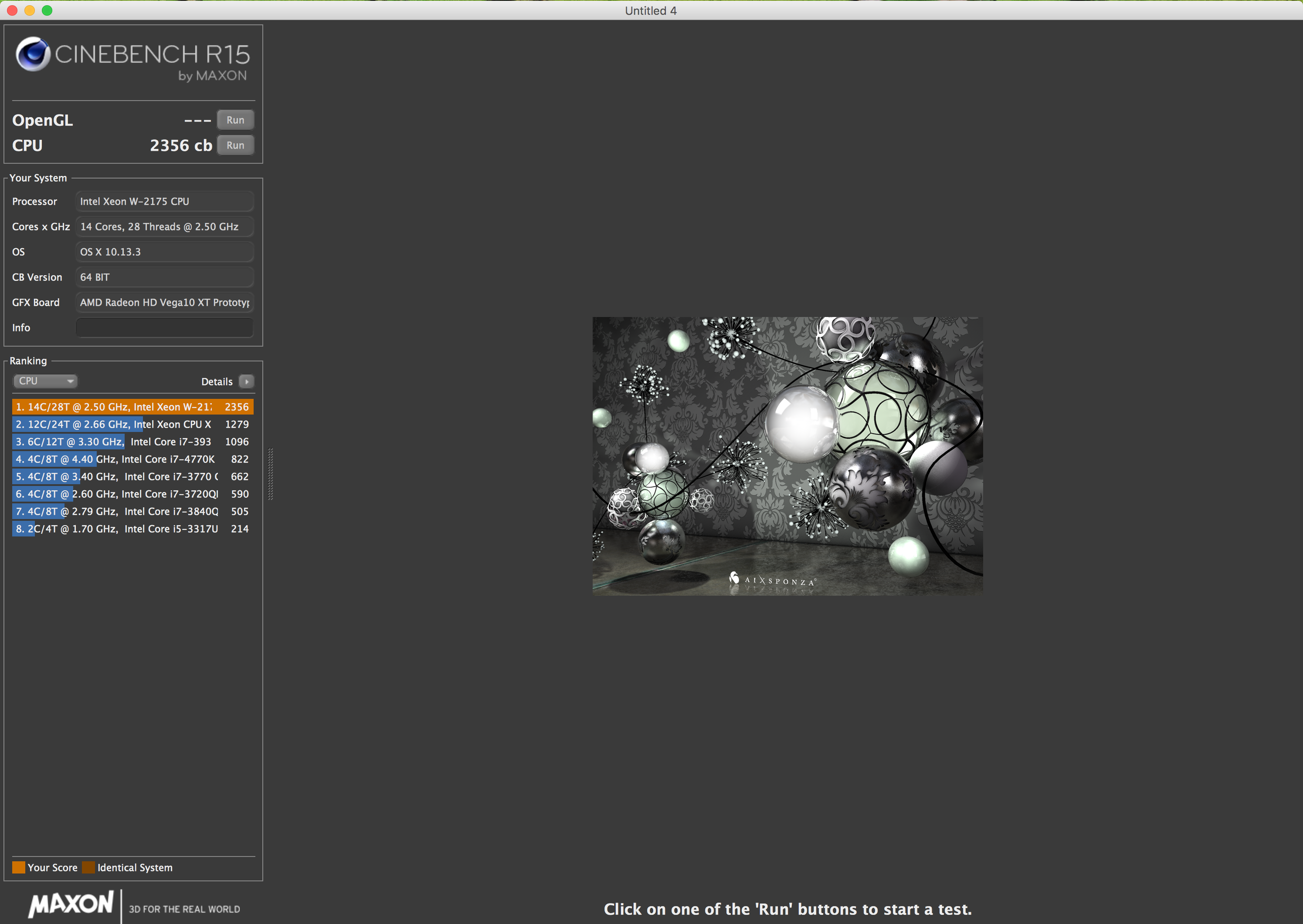

Guest Posted March 19, 2018 Share Posted March 19, 2018 (edited) could you post cinebench 15 cpu test and relative Intel power graphics gadget during your test? I think we also should refine better your EFI Maybe you can avoid some things My advice is to stay with original bios till you are sure all is working perfectly Edited March 19, 2018 by Guest Link to comment https://www.insanelymac.com/forum/topic/333229-help-installing-highsierra-on-xeon-w-2175-and-asus-ws-c422-mobo/page/7/#findComment-2604219 Share on other sites More sharing options...
obus Posted March 19, 2018 Author Share Posted March 19, 2018 17 minutes ago, fabiosun said: could you post cinebench 15 cpu test and relative Intel power graphics gadget during your test? I think we also should refine better your EFI Maybe you can avoid some things My advice is to stay with original bios till you are sure all is working perfectly Here you go. Hi @fabiosun Do you know how to get my Intel I210-AT Nic:s working? Link to comment https://www.insanelymac.com/forum/topic/333229-help-installing-highsierra-on-xeon-w-2175-and-asus-ws-c422-mobo/page/7/#findComment-2604229 Share on other sites More sharing options...

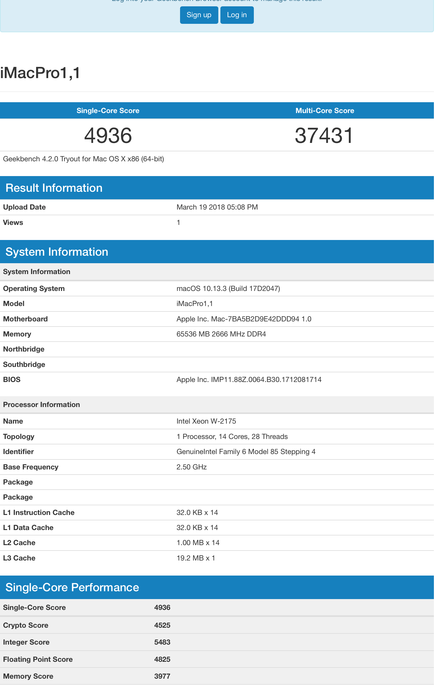

Guest Posted March 19, 2018 Share Posted March 19, 2018 thank you max frequency for all cores in turbo mode is (for your xeon)? Have you EIST and SpeedShift enabled in bios? Link to comment https://www.insanelymac.com/forum/topic/333229-help-installing-highsierra-on-xeon-w-2175-and-asus-ws-c422-mobo/page/7/#findComment-2604230 Share on other sites More sharing options...
obus Posted March 19, 2018 Author Share Posted March 19, 2018 3 minutes ago, fabiosun said: thank you max frequency for all cores in turbo mode is (for your xeon)? Have you EIST and SpeedShift enabled in bios? I don't know if it's turbo mode. How could I check that? EIST and Intel speedshift is enabled Geekbench score. Link to comment https://www.insanelymac.com/forum/topic/333229-help-installing-highsierra-on-xeon-w-2175-and-asus-ws-c422-mobo/page/7/#findComment-2604235 Share on other sites More sharing options...
Guest Posted March 19, 2018 Share Posted March 19, 2018 from your IPG graph turbo mode for all cores/thread seems to be about 3.2 Ghz base freq 2.5 Ghz turbo for single core 4.3 Ghz if so your result are good if you want to try disable only EIST in bios and post again result and IPG graph Link to comment https://www.insanelymac.com/forum/topic/333229-help-installing-highsierra-on-xeon-w-2175-and-asus-ws-c422-mobo/page/7/#findComment-2604247 Share on other sites More sharing options...

obus Posted March 19, 2018 Author Share Posted March 19, 2018 (edited) 46 minutes ago, fabiosun said: from your IPG graph turbo mode for all cores/thread seems to be about 3.2 Ghz base freq 2.5 Ghz turbo for single core 4.3 Ghz if so your result are good if you want to try disable only EIST in bios and post again result and IPG graph Turbo is enabled in bios. Eist is now disabled. Edited March 19, 2018 by obus Link to comment https://www.insanelymac.com/forum/topic/333229-help-installing-highsierra-on-xeon-w-2175-and-asus-ws-c422-mobo/page/7/#findComment-2604261 Share on other sites More sharing options...

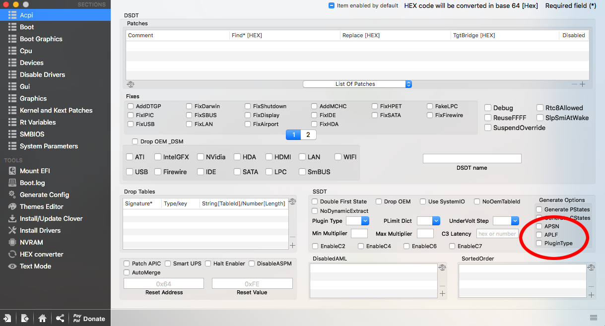

joedm ru Posted March 19, 2018 Share Posted March 19, 2018 You need to patch your bios only for unlocking MSR 0xE2 and get rid of TSC sync kext. Your CPU will work fine even if you drop all CPU-related SSDT tables and even without generated ones. Just make sure you have plugin-type added. To verify that XCPM works use command sysctl -n machdep.xcpm.mode If you see it displays '1' then you are fine. Link to comment https://www.insanelymac.com/forum/topic/333229-help-installing-highsierra-on-xeon-w-2175-and-asus-ws-c422-mobo/page/7/#findComment-2604281 Share on other sites More sharing options...
obus Posted March 19, 2018 Author Share Posted March 19, 2018 (edited) 9 minutes ago, joedm ru said: You need to patch your bios only for unlocking MSR 0xE2 and get rid of TSC sync kext. Your CPU will work fine even if you drop all CPU-related SSDT tables and even without generated ones. Just make sure you have plugin-type added. To verify that XCPM works use command sysctl -n machdep.xcpm.mode If you see it displays '1' then you are fine. Ok @joedm ru My native NVRAM is working fine with AptioMemoryFix.kext irrespective if 4G is enabled or disabled. Edited March 19, 2018 by obus Link to comment https://www.insanelymac.com/forum/topic/333229-help-installing-highsierra-on-xeon-w-2175-and-asus-ws-c422-mobo/page/7/#findComment-2604282 Share on other sites More sharing options...

obus Posted March 19, 2018 Author Share Posted March 19, 2018 11 minutes ago, joedm ru said: You need to patch your bios only for unlocking MSR 0xE2 and get rid of TSC sync kext. Your CPU will work fine even if you drop all CPU-related SSDT tables and even without generated ones. Just make sure you have plugin-type added. To verify that XCPM works use command sysctl -n machdep.xcpm.mode If you see it displays '1' then you are fine. But now I need to have FakeCpuid 0x040674 otherwise I can't boot? So you mean I can drop that as long as I have checked plugin-type? sysctl -n machdep.xcpm.mode=1 so native powermanagment is working then? Link to comment https://www.insanelymac.com/forum/topic/333229-help-installing-highsierra-on-xeon-w-2175-and-asus-ws-c422-mobo/page/7/#findComment-2604287 Share on other sites More sharing options...

joedm ru Posted March 19, 2018 Share Posted March 19, 2018 Just now, obus said: What I meant was that the input "sysctl -n machdep.xcpm.mode" in terminal gave me the answer 1. By that I draw the conclusion that native powermanagment was working. Is that correct? Yes, it is. Link to comment https://www.insanelymac.com/forum/topic/333229-help-installing-highsierra-on-xeon-w-2175-and-asus-ws-c422-mobo/page/7/#findComment-2604313 Share on other sites More sharing options...
