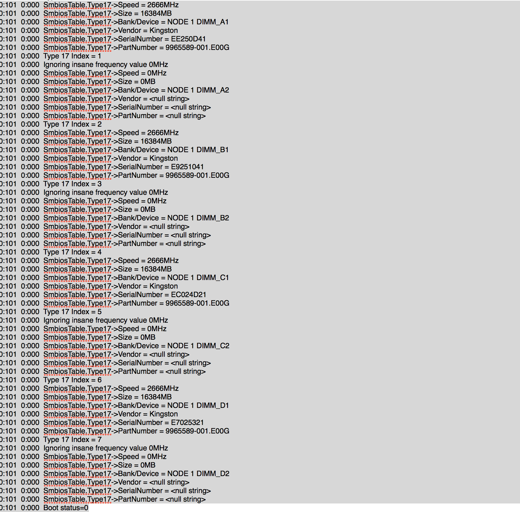

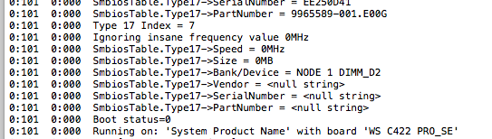

Guest Posted April 22, 2018 Share Posted April 22, 2018 @obus take a look here in your bootlog If you can try to see in bios if you read correctly all your module specs (I think in SPD section of your bios parameters) DIMM_D2 is not recognized well Link to comment https://www.insanelymac.com/forum/topic/333229-help-installing-highsierra-on-xeon-w-2175-and-asus-ws-c422-mobo/page/11/#findComment-2611054 Share on other sites More sharing options...
obus Posted April 22, 2018 Author Share Posted April 22, 2018 (edited) 1 hour ago, fabiosun said: @obus take a look here in your bootlog If you can try to see in bios if you read correctly all your module specs (I think in SPD section of your bios parameters) DIMM_D2 is not recognized well @fabiosun It's funny because that slot isn't used. I have 4 x 16 gb in slot D1 , C1, A1 , and B1. Nothing in D2? It looks right in my last attached bootlog. I have tested a little and now I don't need FakeCpuId if I replace that with a kernel patch (XCPM bootstrap patch: Find: 89D804C4 3C227722 -> replace:89D804CD 3C227722) I still need "xcpm_program_msrs (c) Pike R. Alpha" to boot. Any thoughts about that? I've read something about this in KGP:s Skylake-thread where your name was involved. Edited April 22, 2018 by obus Link to comment https://www.insanelymac.com/forum/topic/333229-help-installing-highsierra-on-xeon-w-2175-and-asus-ws-c422-mobo/page/11/#findComment-2611075 Share on other sites More sharing options...
Guest Posted April 22, 2018 Share Posted April 22, 2018 (edited) 29 minutes ago, obus said: @fabiosun It's funny because that slot isn't used. I have 4 x 16 gb in slot D1 , C1, A1 , and B1. Nothing in D2? It looks right in my last attached bootlog. I have tested a little and now I don't need FakeCpuId if I replace that with a kernel patch (XCPM bootstrap patch: Find: 89D804C4 3C227722 -> replace:89D804CD 3C227722) I still need "xcpm_program_msrs (c) Pike R. Alpha" to boot. Any thoughts about that? I've read something about this in KGP:s Skylake-thread where your name was involved. Ciao Obus Fakecpuid can be bypassed if you patch Kernel Patch to do the something fakecpuid does Goal for you should be to NOT have any patches or any fakecpuid because your CPU is one of most similar to real new Imacpro If you did all your tries correctly, maybe for now it is not possible and so you have to use some patches If you see in my signature I have a 22 cores/44 thread xeon, I have also a patched bios (and I have helped also many X299 guys to patch their "unpatchable" bios with standard method Xeon is another thing..it is not an extreme or lower..it is different (and better for me) My patched bios need fakecpuid or kernel Broadwell patch (one of this because cpu is not supported by OSX) and also msr program patch to boot And this with or without a patched bios (for MSR) So be happy..maybe you have reached the best vanilla solution for you hardware at this state of OSX/clover development In my opinion you should also find others user with a Xeon motherboard (similar to your chipset) and try solution that other guys can't .. Edited April 22, 2018 by Guest Link to comment https://www.insanelymac.com/forum/topic/333229-help-installing-highsierra-on-xeon-w-2175-and-asus-ws-c422-mobo/page/11/#findComment-2611078 Share on other sites More sharing options...

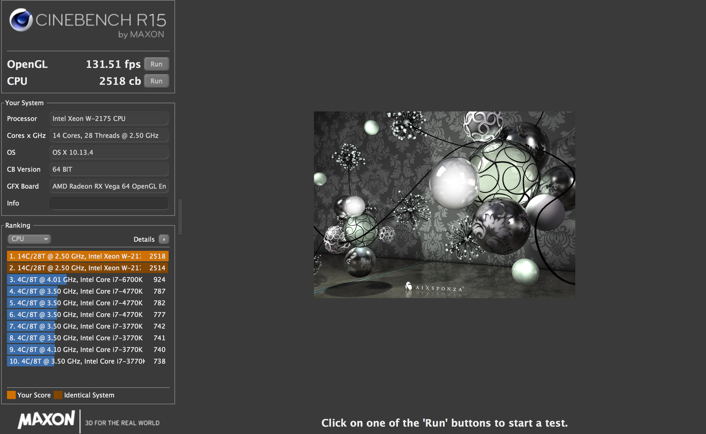

obus Posted April 23, 2018 Author Share Posted April 23, 2018 (edited) I have a weird problem with my Vega 64 liquid. I need to put my rig into sleep before I run Cinebench!!!?? if not the open GL performance is really poor like 80 to 87 fps maximum. After one sleep cycle the open GL performance increase to 131 fps as best result. The same for Unigine_Valley-1.0-Advanced. In windows Cinebech is scoring like 145 fps. Could this has something to do with my CPU? Edited April 23, 2018 by obus Link to comment https://www.insanelymac.com/forum/topic/333229-help-installing-highsierra-on-xeon-w-2175-and-asus-ws-c422-mobo/page/11/#findComment-2611136 Share on other sites More sharing options...
obus Posted April 23, 2018 Author Share Posted April 23, 2018 (edited) On 4/20/2018 at 7:17 AM, fabiosun said: With unlocked one I can program MSR 0xE2 as @SammlerG finding to have also C3 states but for general XCPM performance/condition same result here (performance/temperature) You can try to disable in clover bootmenu fakecpuid or some kernel patches if you are using it..but I don't think you achieve better results of one you show here Is your system rock solid? If so..try but stay also fine with it Hi @SammlerG I'm trying to fine tune my Xeon W-2175 and @fabiosunn have helped me to unlock my mainboard . I need to get rid of my two kernel patch if that's possible. I don't need any FakeCpuId after putting in this old hasswell XCPM bootstrap patch but my processor should be supported natively with native HWP (Intel SpeedShift Technology) CPU Power Management, exactly like the Skylake-X processor according to KGP:s excellent guide. Do you have any input? config.plist Edited April 23, 2018 by obus Link to comment https://www.insanelymac.com/forum/topic/333229-help-installing-highsierra-on-xeon-w-2175-and-asus-ws-c422-mobo/page/11/#findComment-2611143 Share on other sites More sharing options...
