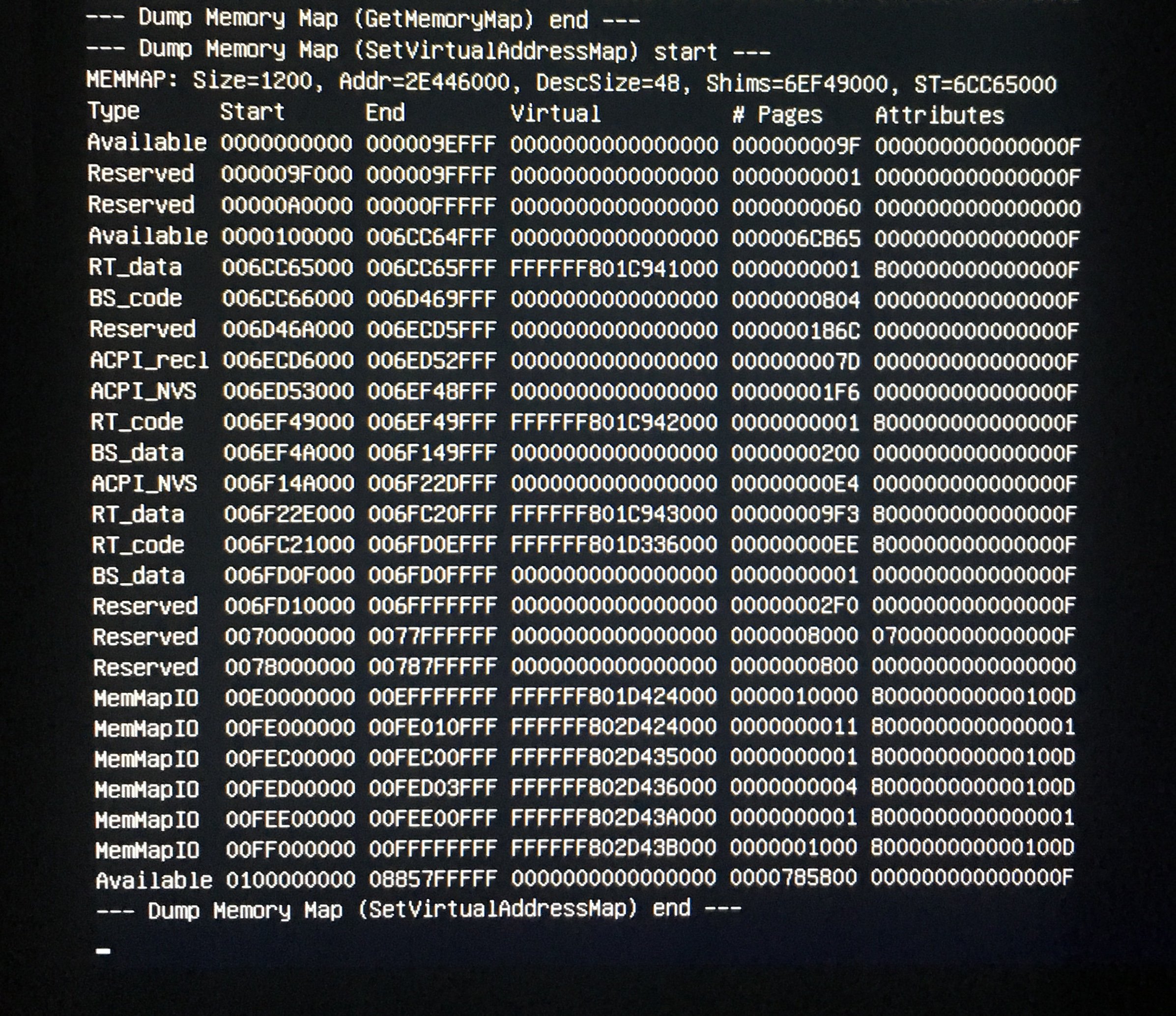

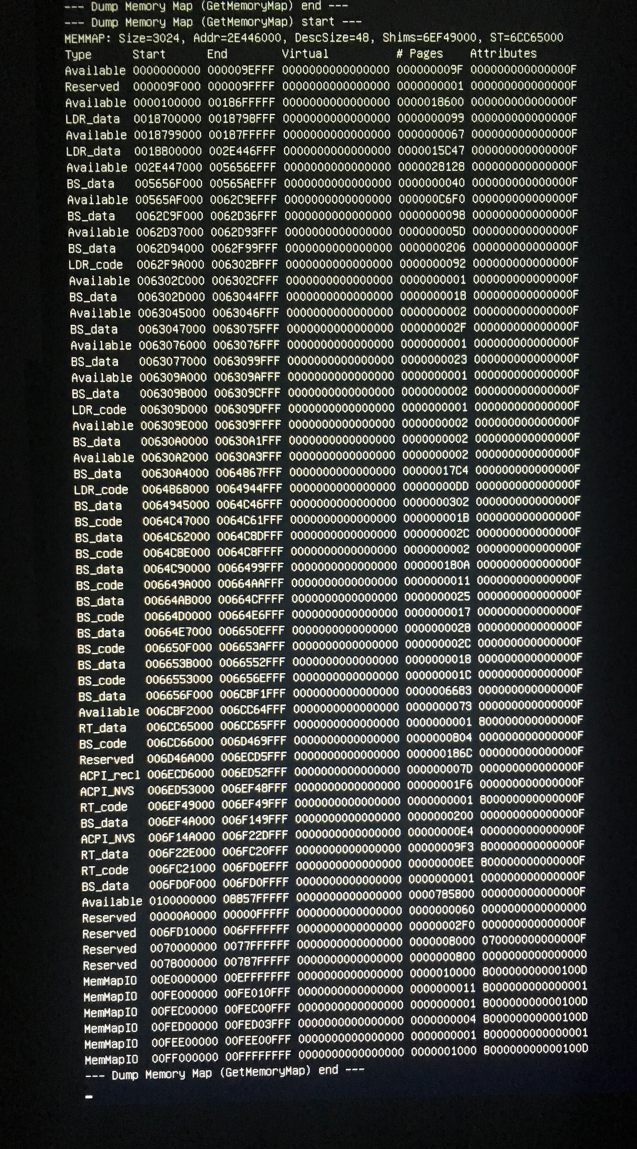

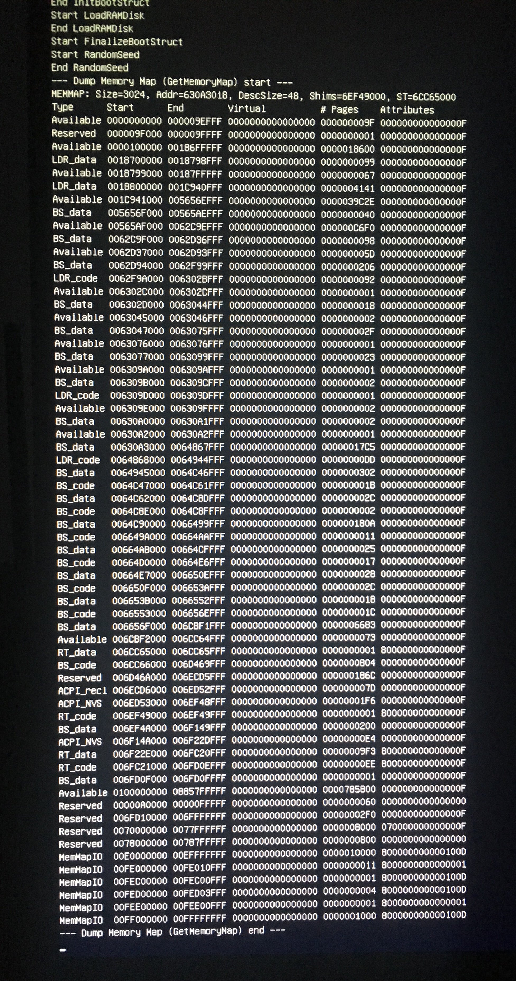

Just for reference, here is the memory map from my system:
Spoiler
As outputted from shell: memmap.txt
And by AptioMemoryFix:
IMG-6393.thumb.jpg.b154fe9b40677a7f405ac4568f42839a.jpgIMG-6395.thumb.jpg.e825de98103c5e301de637df0b9b86ca.jpgIMG-6397.thumb.jpg.5156a238bee566728419e1d59dcf82fa.jpg

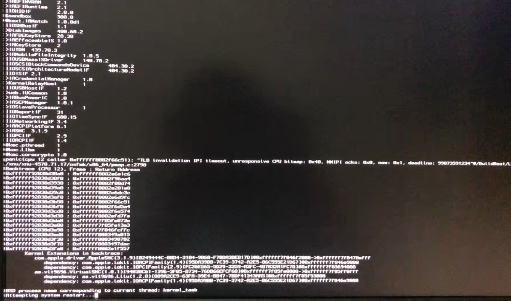

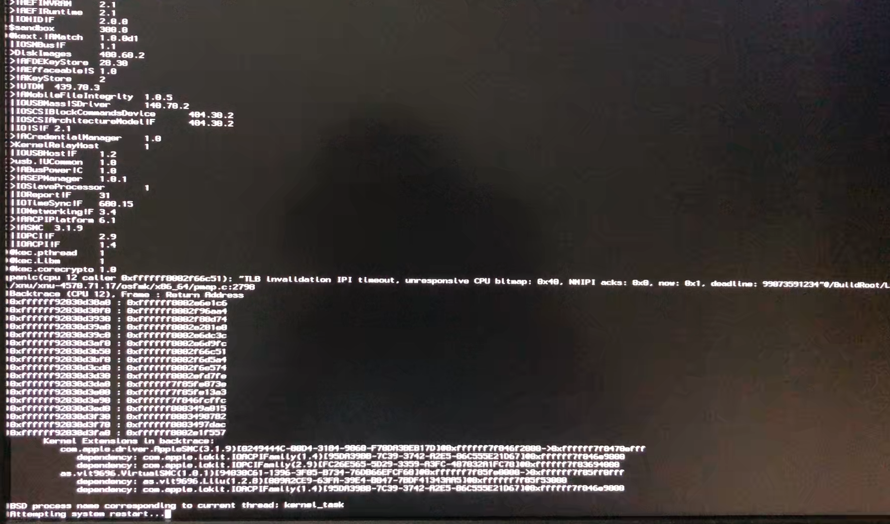

I think I know why AptioMemoryFix is causing this problem and AptioFix1 and EmuVar fixes the issue. Because the shims/setvariable runtime are located in physical memory that is not the kernelspace (since they are prevented from being relocated by boot.efi) and from Pene's panic you can see the vm map is being destroyed. This panic is being caused by the translation lookaside buffer (TLB), which is responsible for the virtual to physical address translation, waiting to be invalidated on all cpus. Which means that the shims/setvariable runtime no longer have a valid virtual address translation because they are gone from the memory map and TLB cache. This is a problem since these panics are happening not on cpu 0, where any calls to the EFI runtime should be taking place, that cpu is probably stuck in a loop trying to hit the TLB cache as you can see happens from the pmap_flush_tlbs function which is probably called when a miss occurs (or another function because there is a page fault, i didn't look close enough to what code actually is invoked when this happens) but this probably takes much longer than the timeout deadline or the vm map is locked preventing the lookup/page fault from even attempting to figure out which page information to cache in the TLB.
EDIT: I believe this would happen with AptioFix2 as well without EmuVar. However, this will probably result is a page fault for trying to write in write protected memory instead.
EDIT2: AptioFix2 and EmuVar may give the same panic though since the native nvram would not be used and there would be no page fault for write protection.
EDIT3: Also, yes, setvariable is only called at shutdown/reboot when the information has changed. The man page for nvram says:
Changes to NVRAM variables are only saved by clean restart or shutdown.
EDIT4: Pene's other panics provide much more information that lead me to believe that this is indeed the case, as the second image appears to show the problem pretty well the interrupt fails, also the third image has a pretty good message of "no mapping exists for frame pointer".
EDIT5: EFI runtime doesn't have to be called from cpu 0 if the os has a locking mechanism to prevent multiple accesses at once, which it must since it's called from different cpus in each of the panics.
Edited by apianti
While this theory does sound interesting, I am afraid it is not correct. UEFI Memory map does include both shims and and other areas, so it is not correct to assume that the virtual address is unmapped, as it is reserved by XNU.
The panic literally means that one of the cores stalled within UEFI runtime, and while the rest of the system reached userspace unmapping, the UEFI runtime thread still did not finish its job.
Most likely it is infinitely waiting for SMI.
Did you read the functions that Pene's panic backtrace? Because I went through them and the place where it is panicking is exactly because it has destroyed the vm map and is flushing the TLB, waiting on the other cpus to also flush their TLB. This is a race condition and why there are multiple panics. If it's in an SMI, then there would be no possibility for this panic to happen because an SMI prevents any other core from running not in SMM:
Operations in SMM take CPU time away from the applications, operating system kernel and hypervisor, with the effects magnified for multicore processors since each SMI causes all cores to switch modes.
Therefore it would have to either have returned, never entered, or the panic would be that there was a timeout for the SMI and would have the text "NMIPI for unresponsive processor: interrupt watchdog for vector ...".
Edited by apianti
