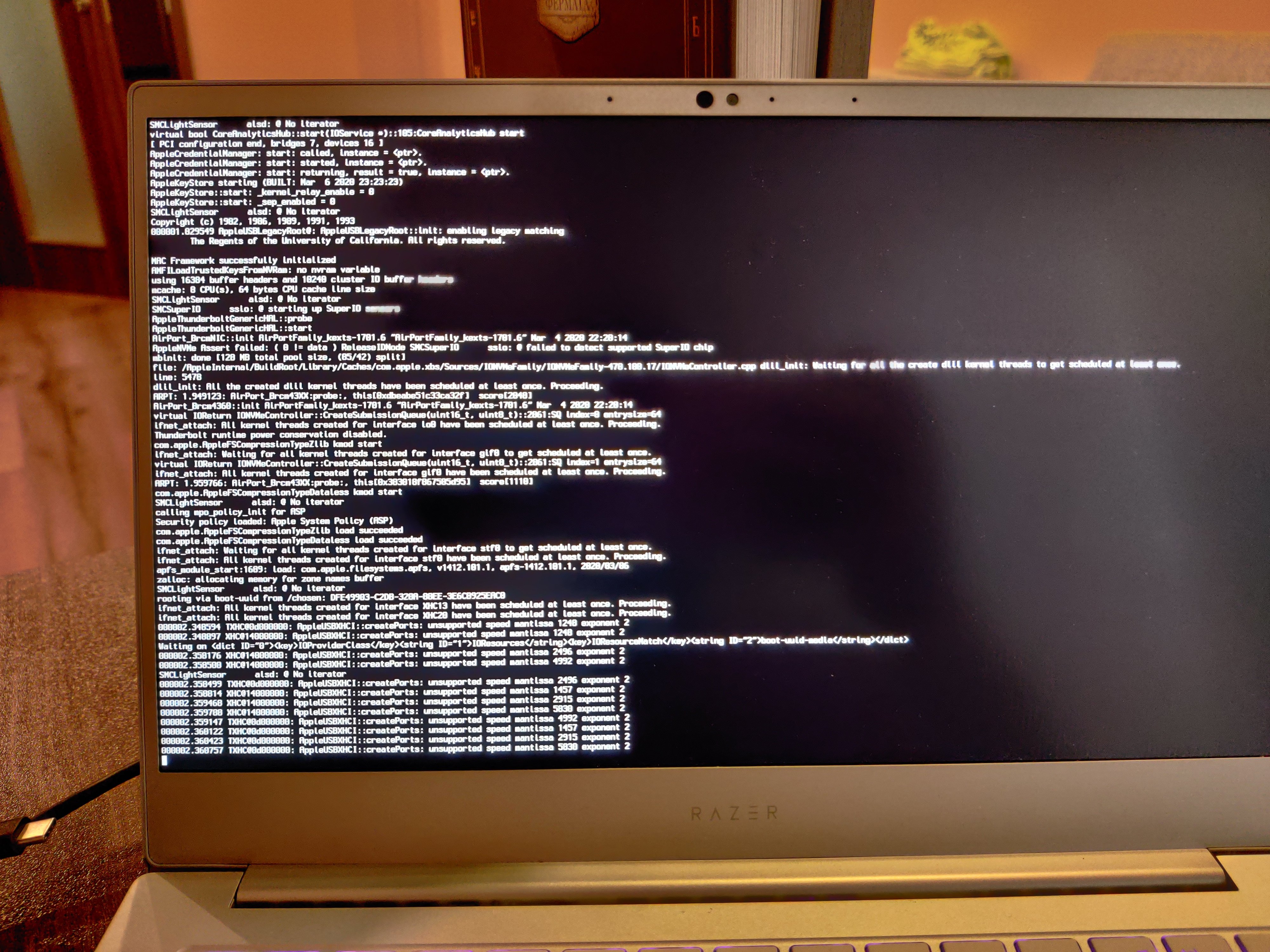

zyt Posted April 14, 2020 Share Posted April 14, 2020 (edited) Hello guys, Another lost soul here. Following a wip guide I was able to "almost boot the installer". After this screen I end up with Stop sign and scrambled text. It seems that Catalina doesn't recognize my USB controller. Correct PCIID is injected via kext. I have attached my EFI folder and boot log. My hardware: Razer Blade Stealth Mercury Wihte(The version w/o dedicated gpu) CPU: IceLake i7 1065G7 GPU: Intel Iris Plus Graphics G7 RAM: 16GB(onboard) HD: Samsung PM981/PM961 nvme Motherboard Chipset: Intel 495 Audio Codec: ALC298 Ethernet Card: N/A Wifi/BT Card: DW1560 EFI.ZIP opencore-2020-04-13-193150.txt Edited April 14, 2020 by zyt Link to comment https://www.insanelymac.com/forum/topic/331381-aptiomemoryfix/page/24/#findComment-2717442 Share on other sites More sharing options...

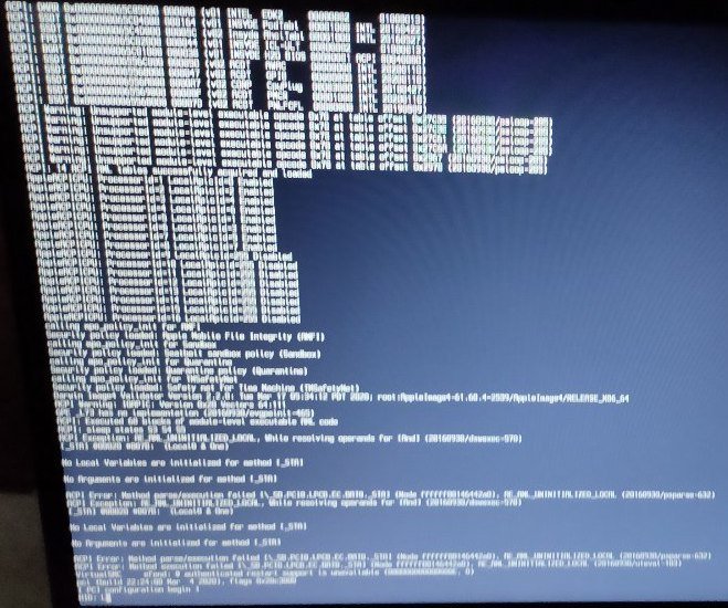

TUNIN96 Posted April 22, 2020 Share Posted April 22, 2020 Hello guys, I have a Lenovo ideapad s145 with i7 1065g7 too and I'm using open core. It gets stuck here. Any tips to solve it? Thank you guys. I uploaded my efi folder. EFI.zip Link to comment https://www.insanelymac.com/forum/topic/331381-aptiomemoryfix/page/24/#findComment-2718772 Share on other sites More sharing options...

apianti Posted May 24, 2020 Share Posted May 24, 2020 That topic seems to be gone, but there is one thing that changed massively between ice lake and it's predecessors. The USB controller moved from the chipset and is now integrated into the CPU as thunderbolt controller (USB 4.0). You appear to have an issue with USB in you last picture that you posted earlier (it's the last kext and what I think probably caused the kernel to panic inside itself doing something for that driver). I think you may need to patch some of those drivers, maybe the usb and probably the ice lake specific ones. What those patches are, I have no idea. I also see that you have an ACPI error about something not having an implementation. I wonder what that is? Is it important? Link to comment https://www.insanelymac.com/forum/topic/331381-aptiomemoryfix/page/24/#findComment-2723634 Share on other sites More sharing options...
joevt Posted May 24, 2020 Share Posted May 24, 2020 On 4/14/2020 at 11:26 AM, zyt said: Hello guys, Another lost soul here. Following a wip guide I was able to "almost boot the installer". After this screen I end up with Stop sign and scrambled text. It seems that Catalina doesn't recognize my USB controller. Correct PCIID is injected via kext. I have attached my EFI folder and boot log. My hardware: Razer Blade Stealth Mercury Wihte(The version w/o dedicated gpu) CPU: IceLake i7 1065G7 GPU: Intel Iris Plus Graphics G7 RAM: 16GB(onboard) HD: Samsung PM981/PM961 nvme Motherboard Chipset: Intel 495 Audio Codec: ALC298 Ethernet Card: N/A Wifi/BT Card: DW1560 EFI.ZIP opencore-2020-04-13-193150.txt Similar errors found on non-IceLake motherboard 1.5 years ago: The motherboard was bootable, so the problem is not those USB XHC speed mantissa and exponent values but something else? (exponent 2 = Mb/s) Maybe consider enabling more logging with pci and io bootargs. pci=0x41 io=0x333F Link to comment https://www.insanelymac.com/forum/topic/331381-aptiomemoryfix/page/24/#findComment-2723661 Share on other sites More sharing options...
joevt Posted May 24, 2020 Share Posted May 24, 2020 Try booting/installing from a USB 2.0 flash drive or a USB 3.x flash drive connected to a USB 2.0 port or USB 2.0 hub. Link to comment https://www.insanelymac.com/forum/topic/331381-aptiomemoryfix/page/24/#findComment-2723663 Share on other sites More sharing options...
