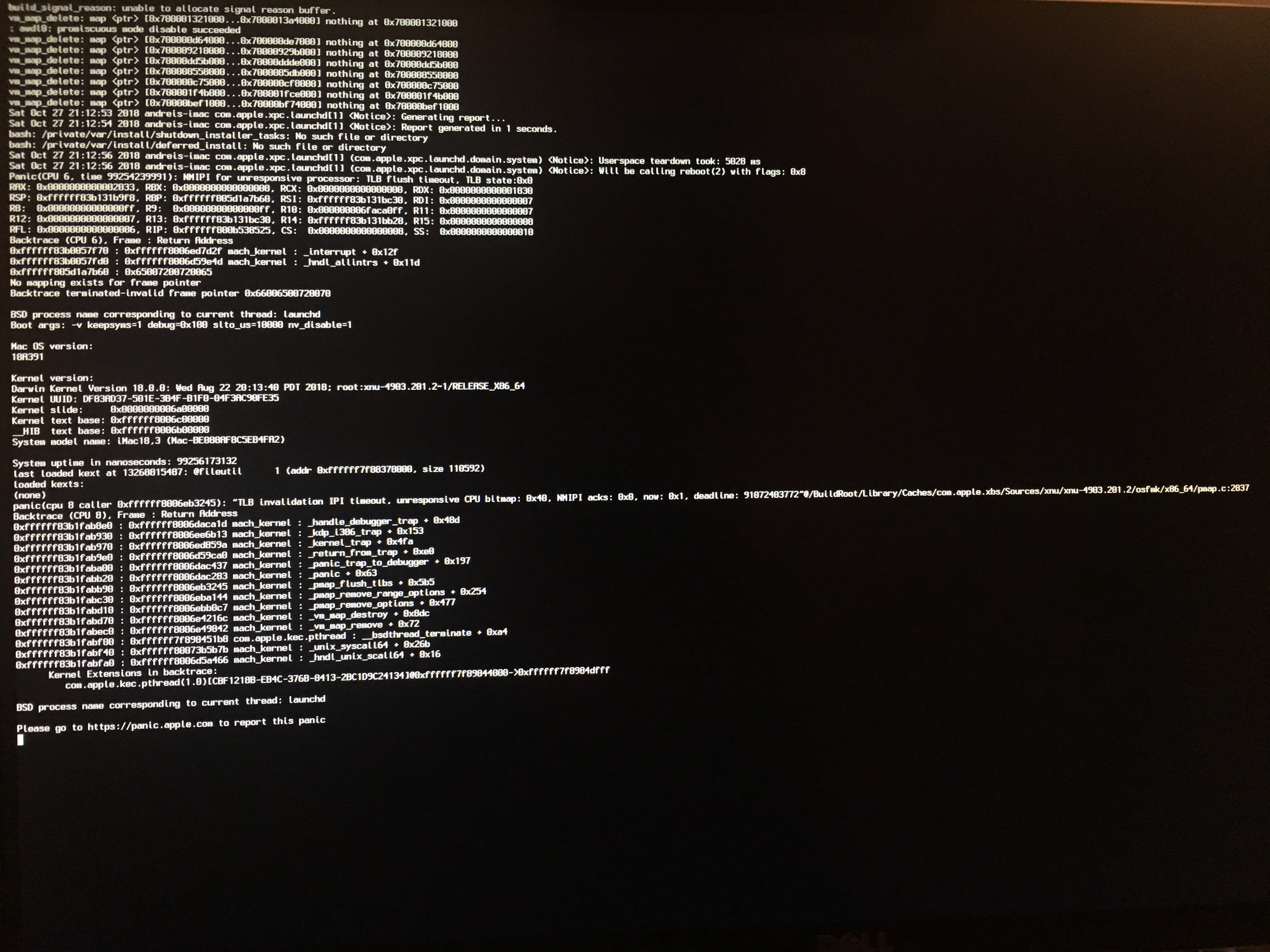

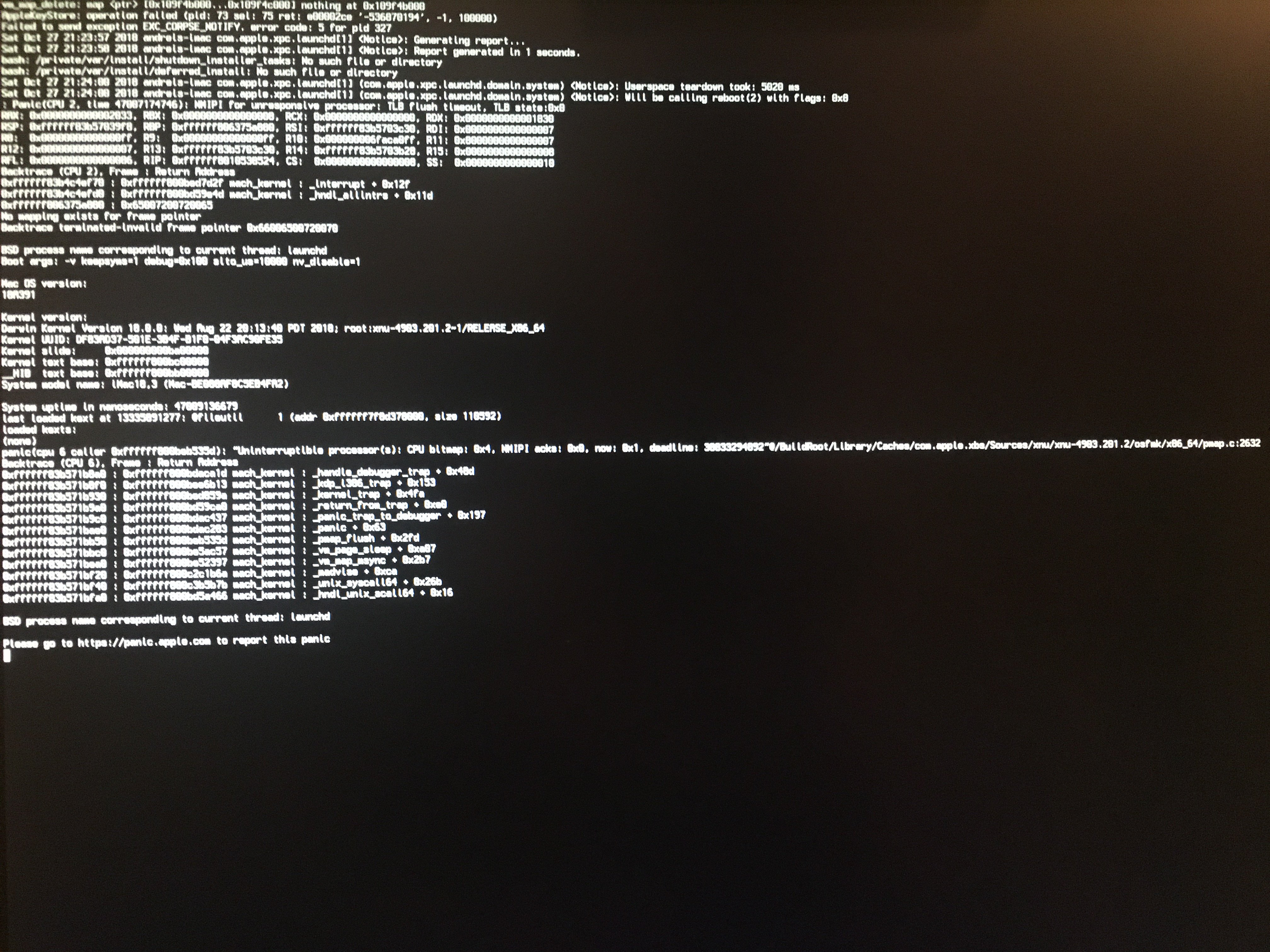

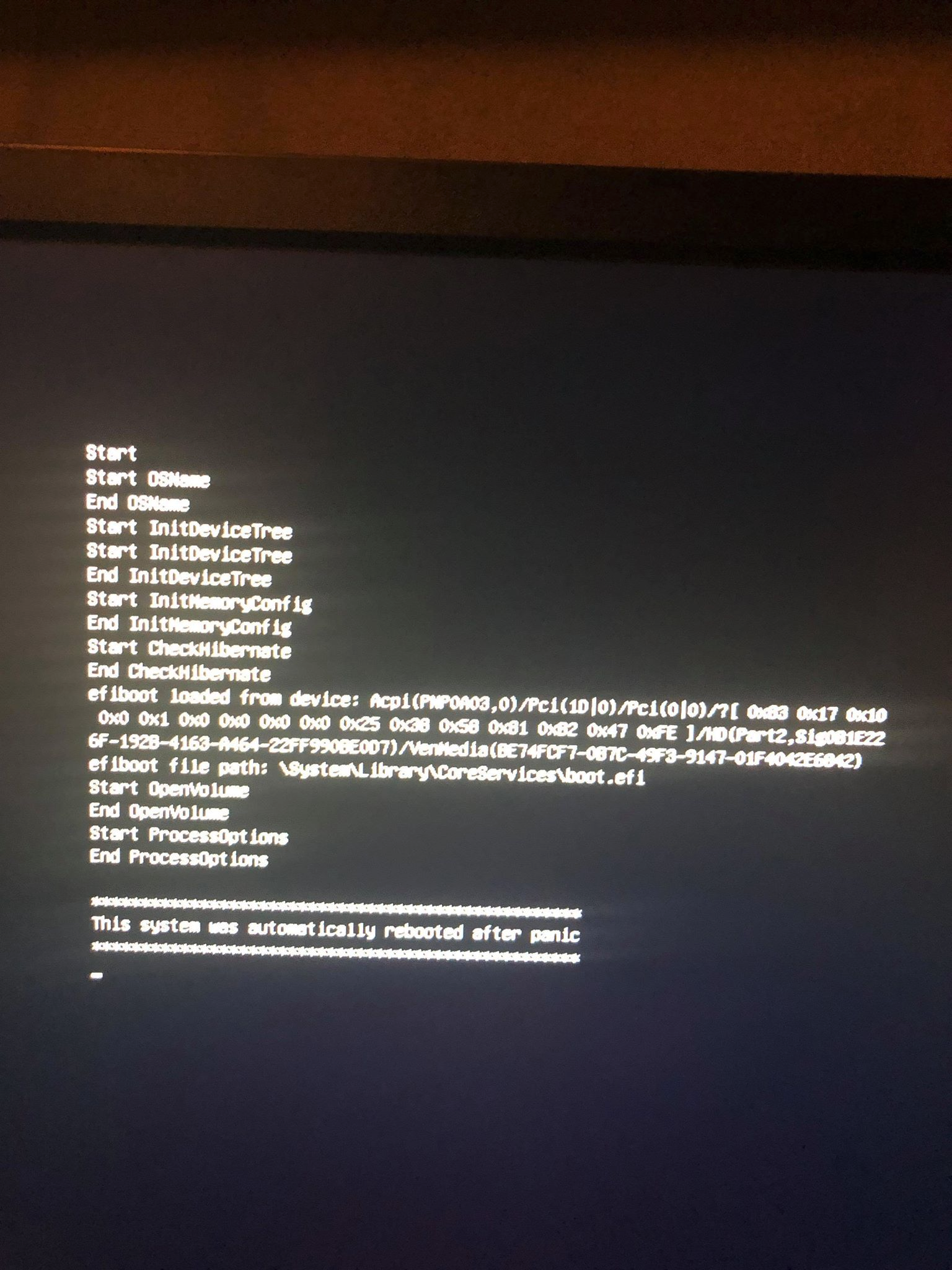

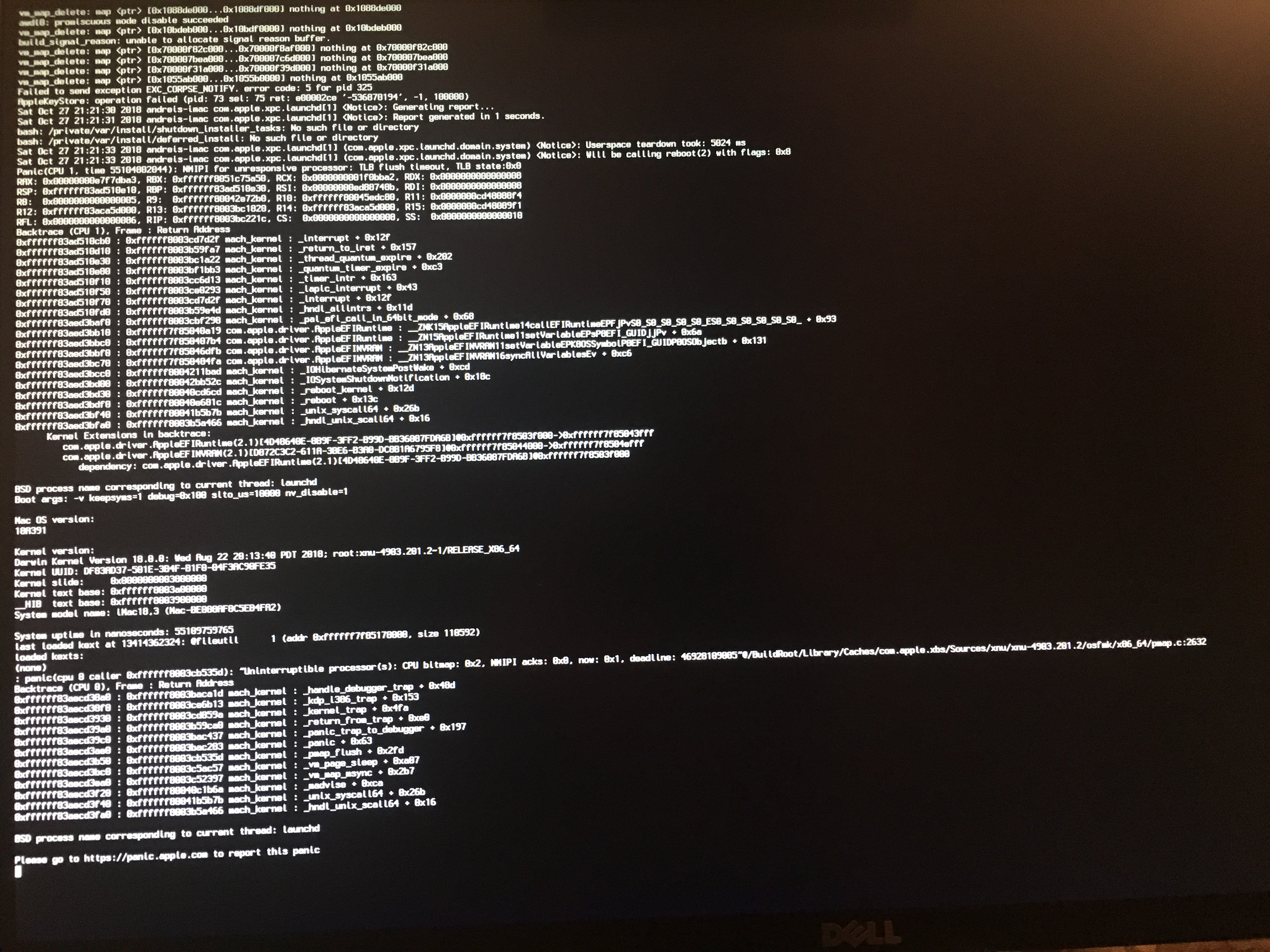

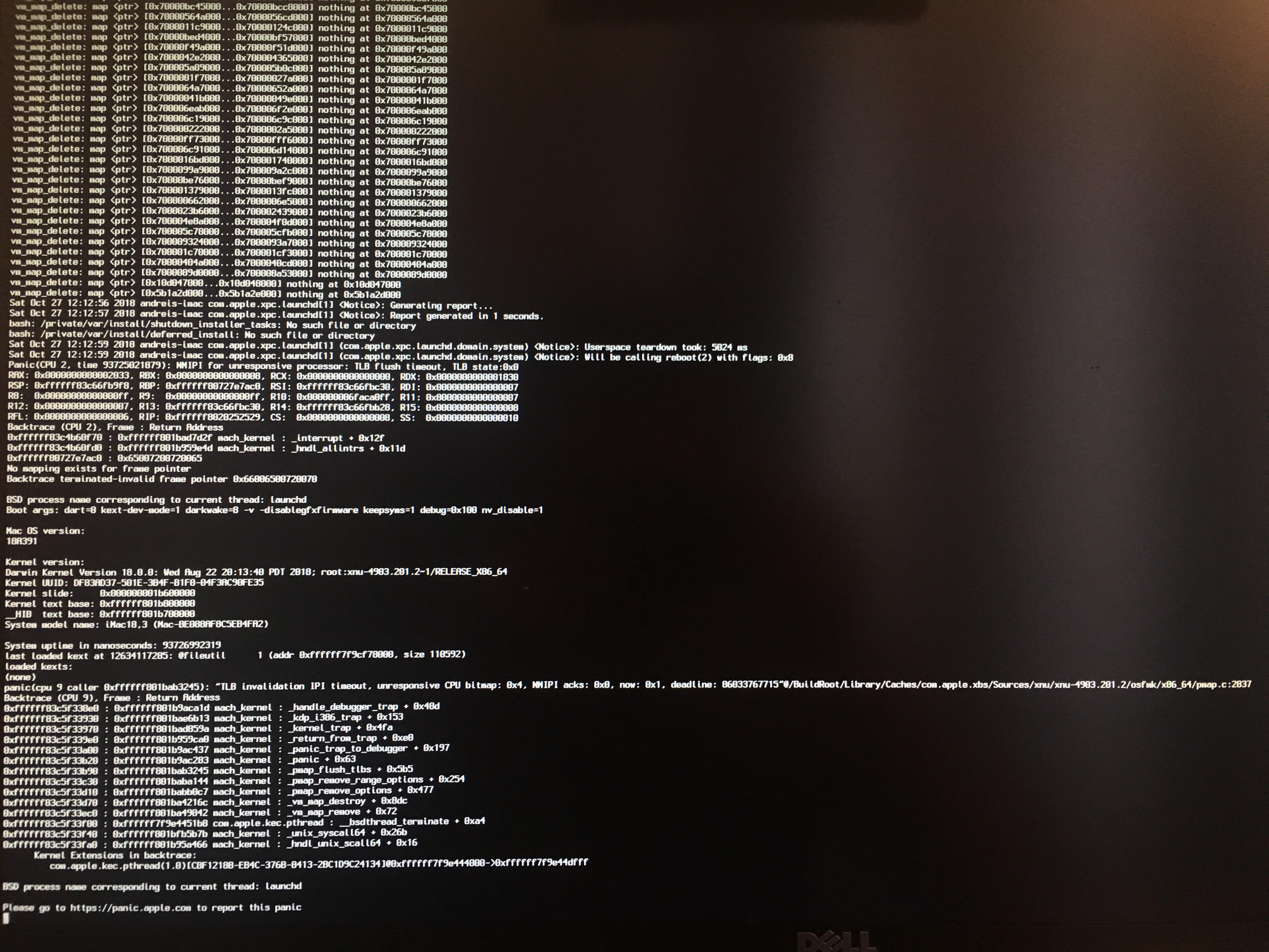

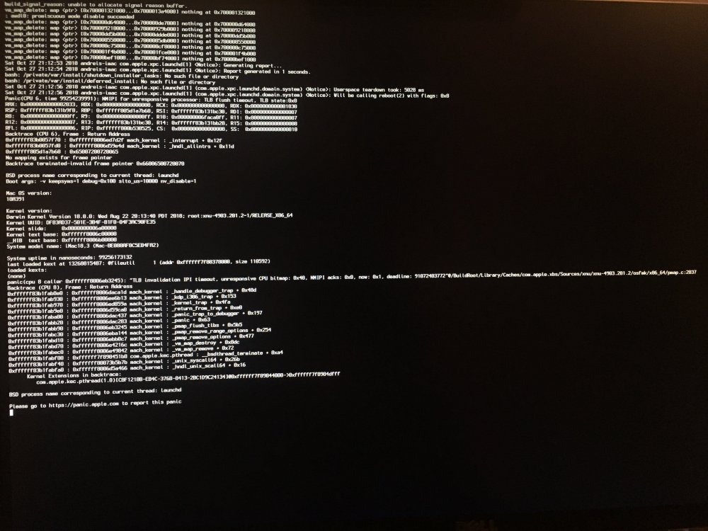

And about the panic details - I guess it was mere luck that I managed to see it, as once again it freezes before I get to see it.
By the way, did you notice in the previous screenshot the multiple vm_map_delete: .... nothing at <address>? Is that normal?
Well, the guard prints at vm_map_delete are most likely work in progress for improving the vm_map unexpected situation detection. It is very unlikely that it has anything to do to us.
I believe without debug=0x100 you should be able to see the panic, but I suppose it could be the same.
I found out that what allowed me to view the panic before was actually the nv_disable=1 argument. So I have now a reliable method to see panics.
Here are some panics when using slto_us=10000:
Edited by Pene
Good to have. Well, the second picture makes it very clear. XNU kernel invokes APTIO RuntimeServices SetVariable code, and then this code never returns.
