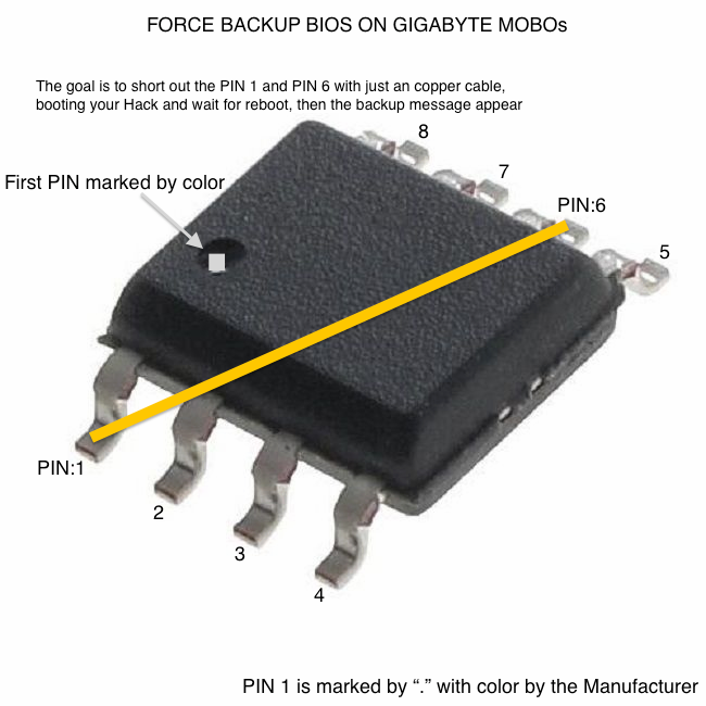

For flashing the 128 Mbit chip here's the files and how to:
1- Make USB Bootable with RUFUS soft and choose DOS files from the attached zip
2- Copy a whole of files inside the provided zip and paste them into that USB you just created
3- Save a backup ROM using @BIOS
4- Rename your Ozmosis BIOS ROM to bios.bin and copy paste it to the USB
5- Reboot and press F12 to select booting from USB, wait until all the steps finished
FPT files are for GIGABYTE Z170 only
fpt_DOS-Z170.zip

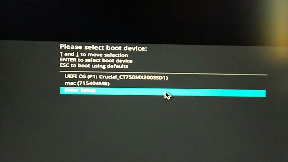

* Your hd must be the first bootable: Disk0
1- Register drivers:
a- From F12 boot menu select (UEFI OS)
b- fs0:
c- cd efi
d- bcfg driver add 1 HfsPlus.efi "HfsPlus" [choose what driver to add after HfsPlus as a second 2 and third 3 etc...] You can choose at any time to change that order from bios setup

Quick look-up for GIGABYTE BIOS CHIP:

But the problem using UEFITool instead after flashing, Ozmosis keep rebooting the Machine, as reported some friends users!
@derInselfan here's your MoBo rom with all Ozm stuffs, replace the raw module of the body of OzmosisDefaults with the one you use, according to your hardware, if you have i5 change that FakeSMC stuffs with the appropriate from FakeSMC i5 given above on this guide!
