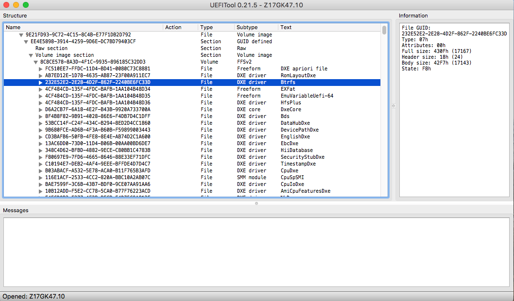

bigwit Posted January 18, 2018 Share Posted January 18, 2018 I've another mobo Asrock z170 game k4, I have tried myself, but cannot work! It not have enough rom to insert Ozm files, so sad! Could U have a look? thx 1 Link to comment https://www.insanelymac.com/forum/topic/331264-ozmosis-for-100-series-skylake-cpus-and-up/page/2/#findComment-2571325 Share on other sites More sharing options...
CMLNT Posted January 18, 2018 Share Posted January 18, 2018 I use UEFItool 0.21.5 will lose the UEFI partition. But I use Windows 0.22.1 will not lose any uefi partition But ozmosis does not run on ASRock Z170 game K4, can not see the HFS installation partition. I also use MMtool can not run - delete the unwanted FFS ozmosis into it. I do not know why no I now bought a Z170Xgame 7 for testing 1 Link to comment https://www.insanelymac.com/forum/topic/331264-ozmosis-for-100-series-skylake-cpus-and-up/page/2/#findComment-2571460 Share on other sites More sharing options...
ammoune78 Posted January 18, 2018 Author Share Posted January 18, 2018 I've another mobo Asrock z170 game k4, I have tried myself, but cannot work! It not have enough rom to insert Ozm files, so sad! Could U have a look? thx Here's: Z17GK47.10.zip I use UEFItool 0.21.5 will lose the UEFI partition. But I use Windows 0.22.1 will not lose any uefi partition But ozmosis does not run on ASRock Z170 game K4, can not see the HFS installation partition. I also use MMtool can not run - delete the unwanted FFS ozmosis into it. I do not know why no I now bought a Z170Xgame 7 for testing Can you try inserting Btrfs + ExFat + EmuVariableUefi-64 + HfsPlus on the top of the nested volume like the picture above?: Link to comment https://www.insanelymac.com/forum/topic/331264-ozmosis-for-100-series-skylake-cpus-and-up/page/2/#findComment-2571532 Share on other sites More sharing options...
CMLNT Posted January 18, 2018 Share Posted January 18, 2018 Here's: Z17GK47.10.zip Can you try inserting Btrfs + ExFat + EmuVariableUefi-64 + HfsPlus on the top of the nested volume like the picture above?: Oz.png HFS partition can not see the installation file After closing the CSM it can identify clover or winpe Link to comment https://www.insanelymac.com/forum/topic/331264-ozmosis-for-100-series-skylake-cpus-and-up/page/2/#findComment-2571544 Share on other sites More sharing options...
ammoune78 Posted January 18, 2018 Author Share Posted January 18, 2018 HFS partition can not see the installation file After closing the CSM it can identify clover or winpe Can you try this one? Z17GK47.10.zip Link to comment https://www.insanelymac.com/forum/topic/331264-ozmosis-for-100-series-skylake-cpus-and-up/page/2/#findComment-2571556 Share on other sites More sharing options...
